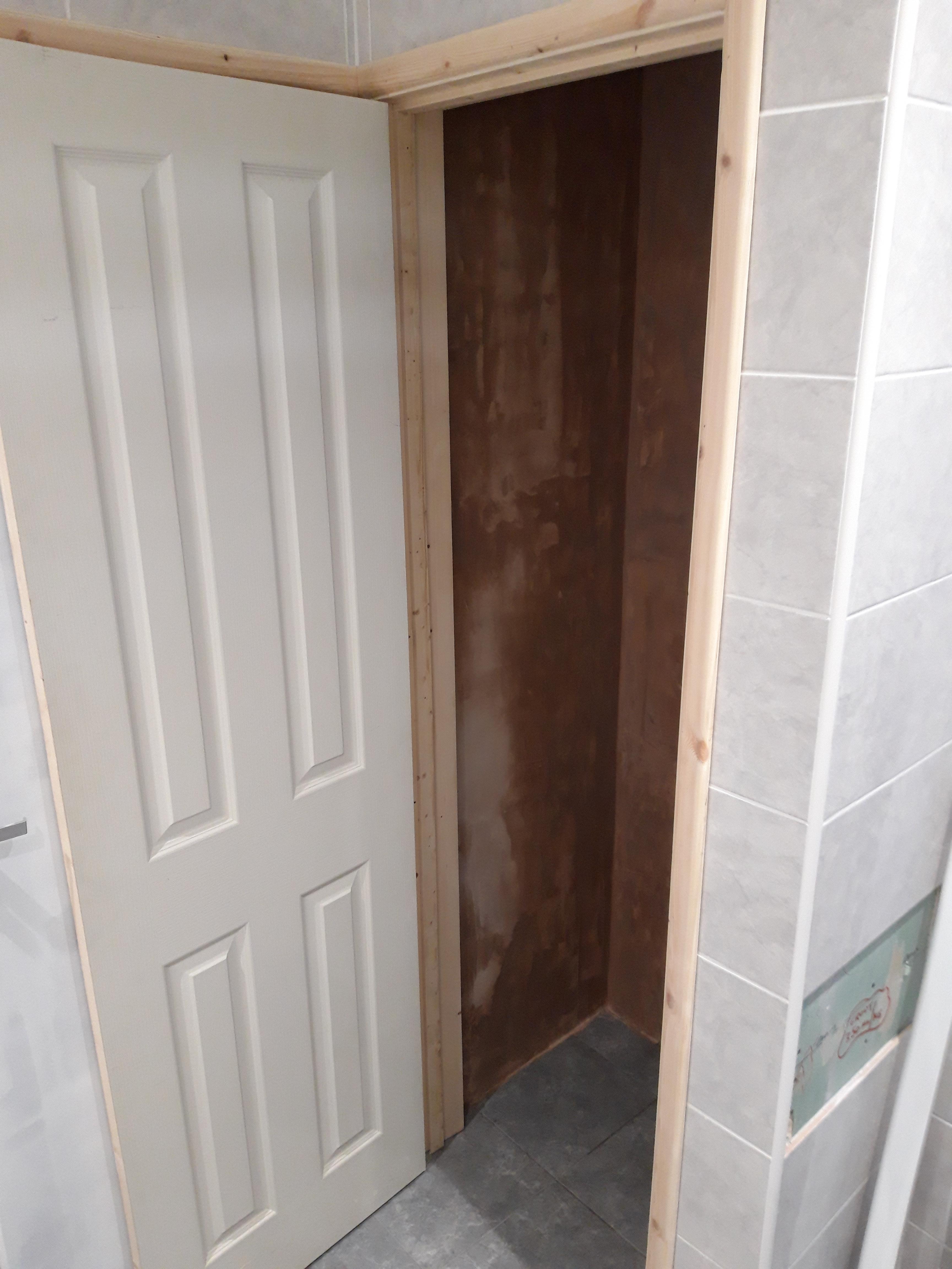

@nod, these two walls in this cupboard I've to plaster, roughly an area 3.5m2. Now I know I shouldn't even ask but I've half a bag of multi left over from when I did the ceiling and half wall back in August...2018. Stored inside with the bag folded over then shoved in a black bin liner. Could I use it? Would adding some cream of tartar work on "old" plaster? I just HATE waste and LOVE pushing boundaries of what's possible!
As the answer is probably NO, I've already bought a new bag! xD
If no good I'll sprinkle on the over site of a neighbour's shed base to get rid.
Cheers

1 minute ago, PeterW said:
Chuck it in the bin..!! It will go off in minutes ..!
So...what you're really saying is TWO  sachets of cream of tartar? :ph34r:

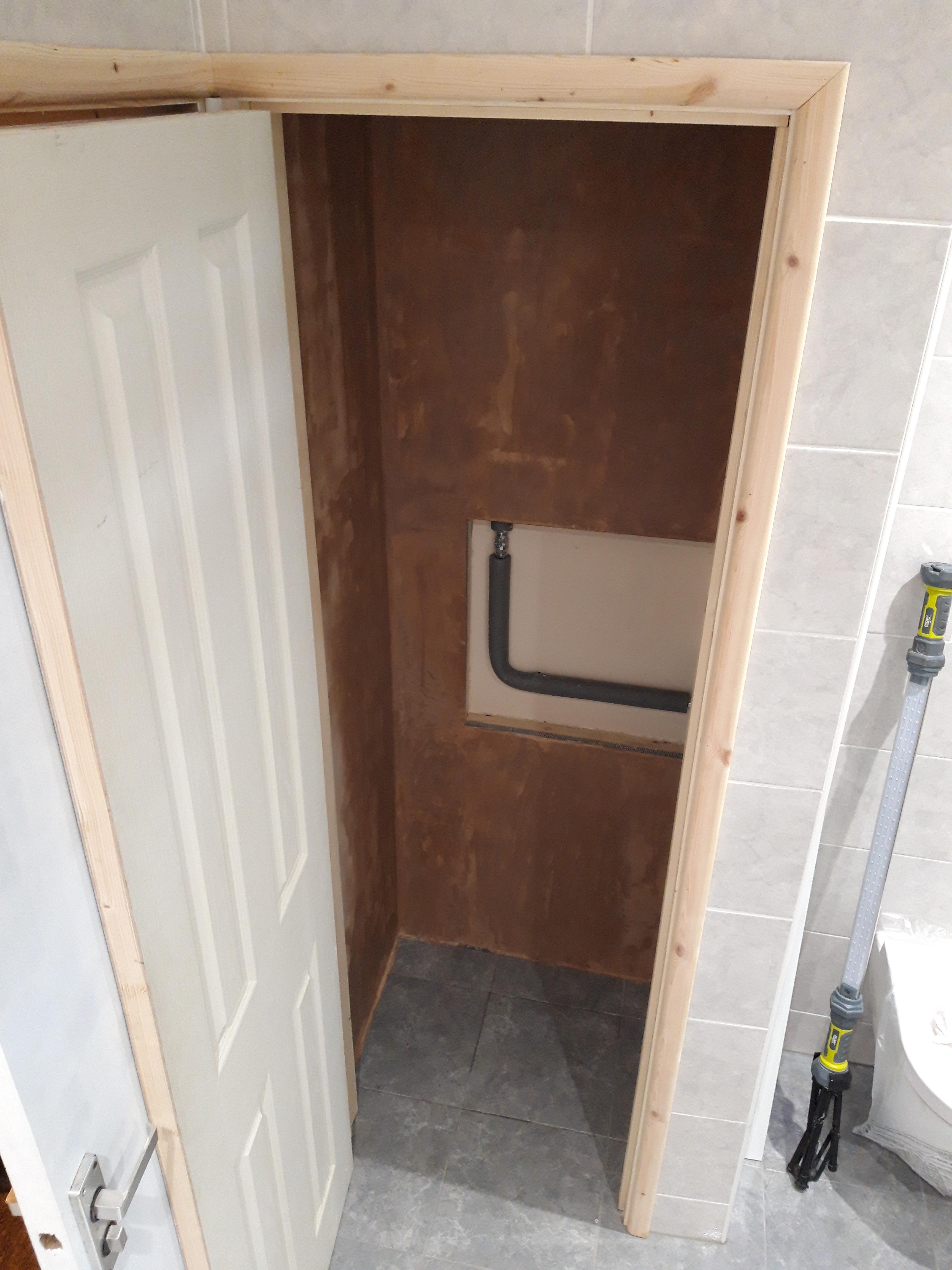

@nod, that 6" vertical strip on the left is where a tapered edge butts up to a square cut edge. I've meshed over it but should I fill first with Easy Fill before plastering? Ta.
20190521_180719
Edited by Onoff
No
You can simply skim over
Its worth mixing a few handboards full and coating tapes and beads before you mix your skim
1 hour ago, nod said:
No
Ta.
Cream of tartar...me being super slow...
Is there a per kilo amount you can add if only mixing small quantities?
For the cupboard ceiling and thin strip above the door I mixed 2.5kg of multi to 1.2l water and slung in a teaspoon of cot.
1 hour ago, Onoff said:
Ta.
You probably won’t need it on a small amount
We put a tablespoon full in a five bag mix
Ta. I've read too much cot can cause the plaster to crack. I'll do the wall where the pipe/valve is tonight and the opposing bit above the door. Got to grab one of those internal corner trowels. Mate who I borrowed one off is away.
Well the cupboard ceiling has dried like a ploughed field! ? Tf for Easy Fill.

4 minutes ago, newhome said:
What you doing in there? Just paint to finish?
Easy Fill first! ?
Then Leyland Super Leytex followed by Dulux Trade Diamond Matt.
