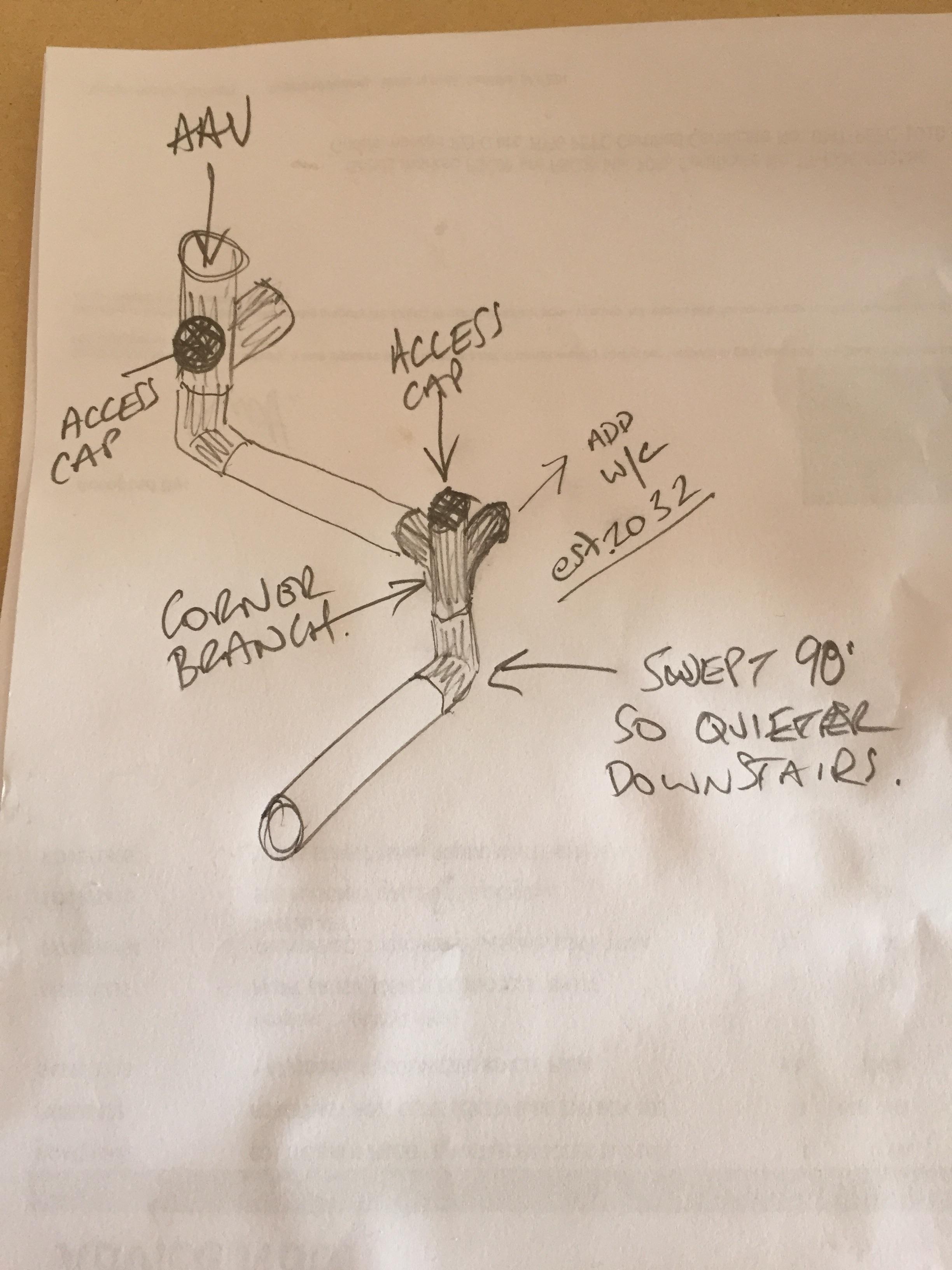

On 28/04/2018 at 19:22, Onoff said:
Cheers.
So I could ditch the branch for a 90deg bend laid on it's side and that would be OK?
Why is a branch such a stalling point, does "stuff" get thrown into the unused branch and compacted? Or is it not enough of a sweep? If that's the case a normal 90 is no good either!
So for clarification the 112.5 branch in it's side could cause a "log jam"? It's approx 1.5m from the aav stack.

On 28/04/2018 at 17:00, Nickfromwales said:
You need a bend and then the branch, or the branch then the bend. Don't use the branch to make a 90o turn in the run as it's a stalling point and a big no-no.
This?
2018-05-01_09-34-09
Personally I would swap the bottom bend and branch, so the branch is vertical, if need be make it a 4 socket rather 3 socket branch
That's a good shout but the"future" run would slip nicely between the underside of the dormer floor joists and top of the downstairs ceiling floor joists. If I turned the branch vertical and lifted it up I'd lose that run option.
1 hour ago, Onoff said:
This?
2018-05-01_09-34-09
Nope :D
Youve still got the products of arse combustion hitting the flat back of that branch ;)
Needs to be a Y branch with a 45 in it to send things round't bend lad.
@bassanclans idea would work and you could use a corner branch to make things easier down the line.
20 hours ago, Nickfromwales said:
Make the first branch an access / inspection branch and have a rodding eye on top of the corner branch.
Sketch pls?
Nope :D
Sketch pls?

41 minutes ago, Onoff said:
Sketch pls?
Sketch pls?

27 minutes ago, Nickfromwales said:
Thanks. The "problem" is that the "ADD W/C" run wants to go straight thru the 9"x6" perimeter beam - the one where the old white junction box is screwed to:
20180425_161507
