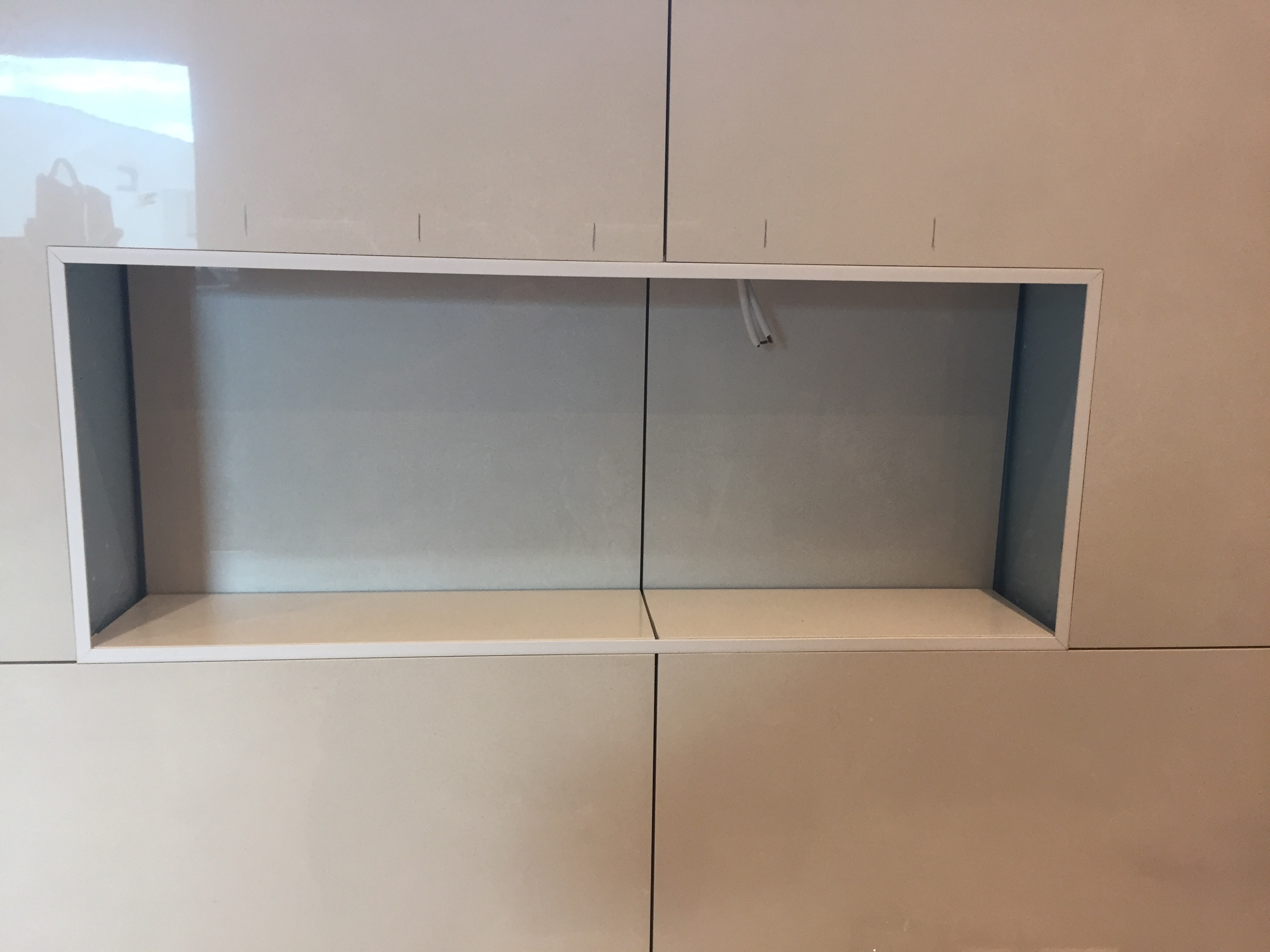

Nickfromwales Posted July 20, 2017 Share Posted July 20, 2017 Pointless doing the whole wall tbh, and more to cut out for the pockets. Lay that panel horizontally and do two full passes if it's long enough, and you'll have enough gap under the cistern to put some off cuts in as catchers to stitch the two boards together where they but together. Freeby ply looking good, and within budget . Ill post some pics later of pocket shelves WiP . 1 Link to comment Share on other sites More sharing options...

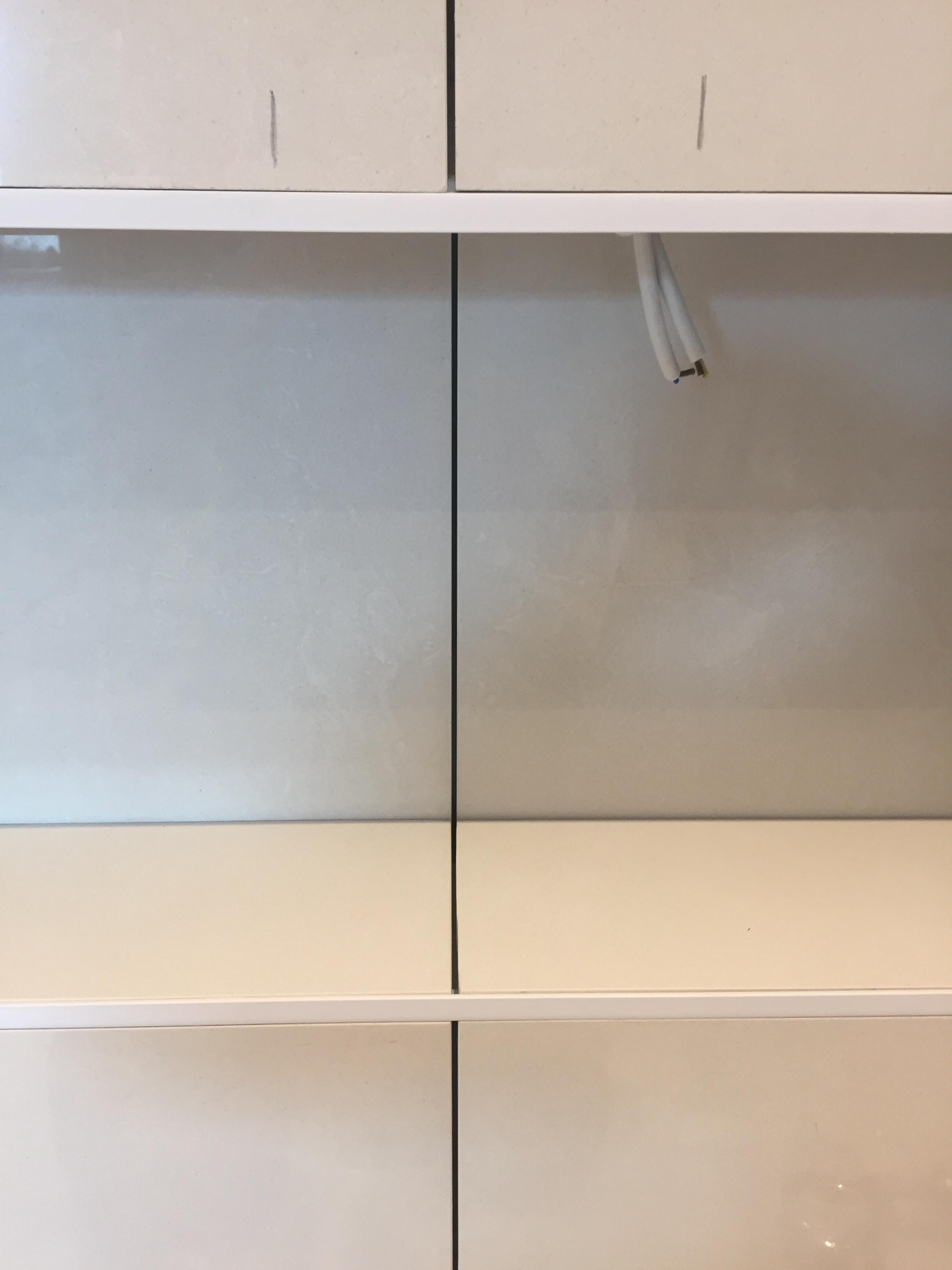

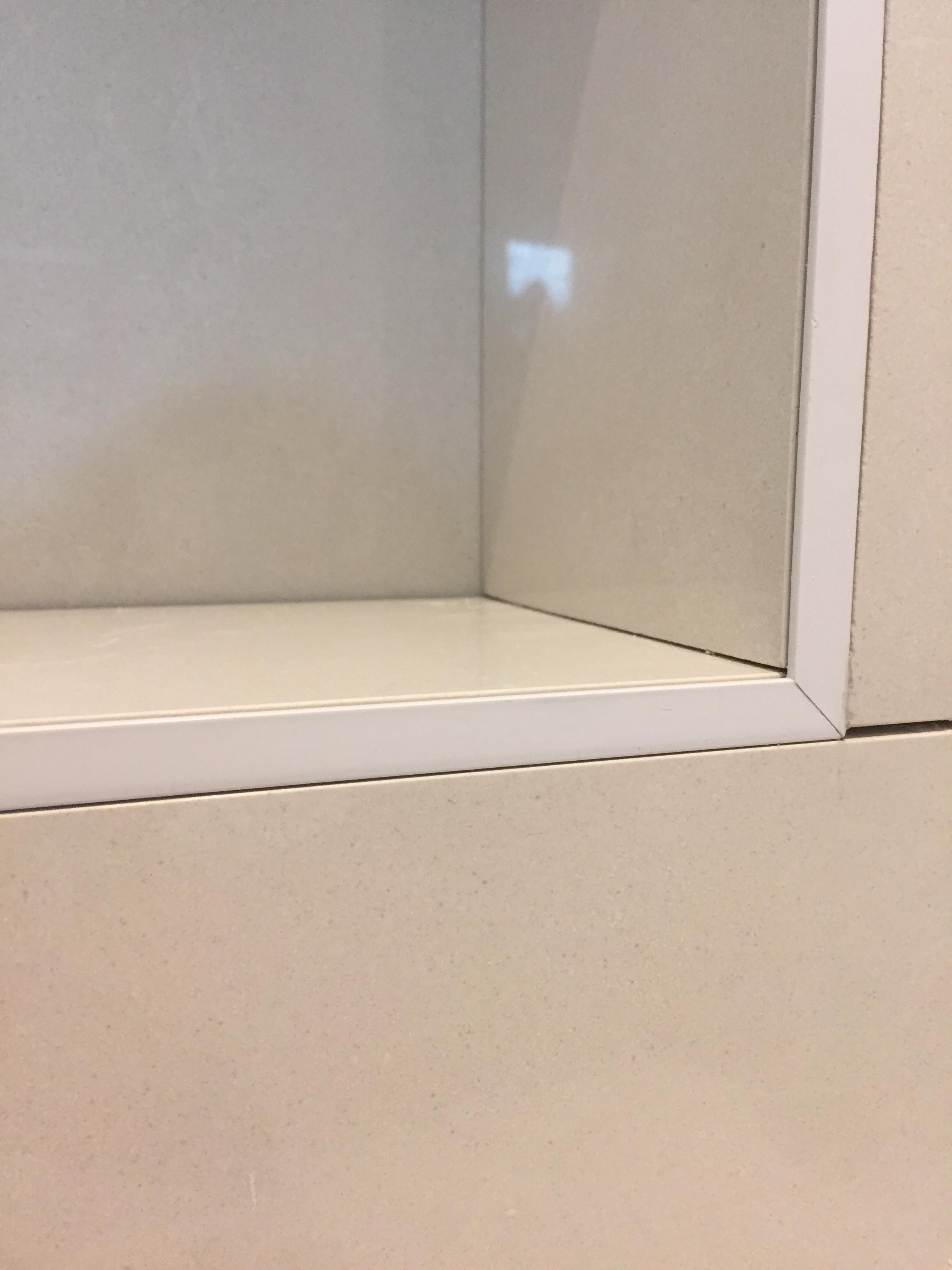

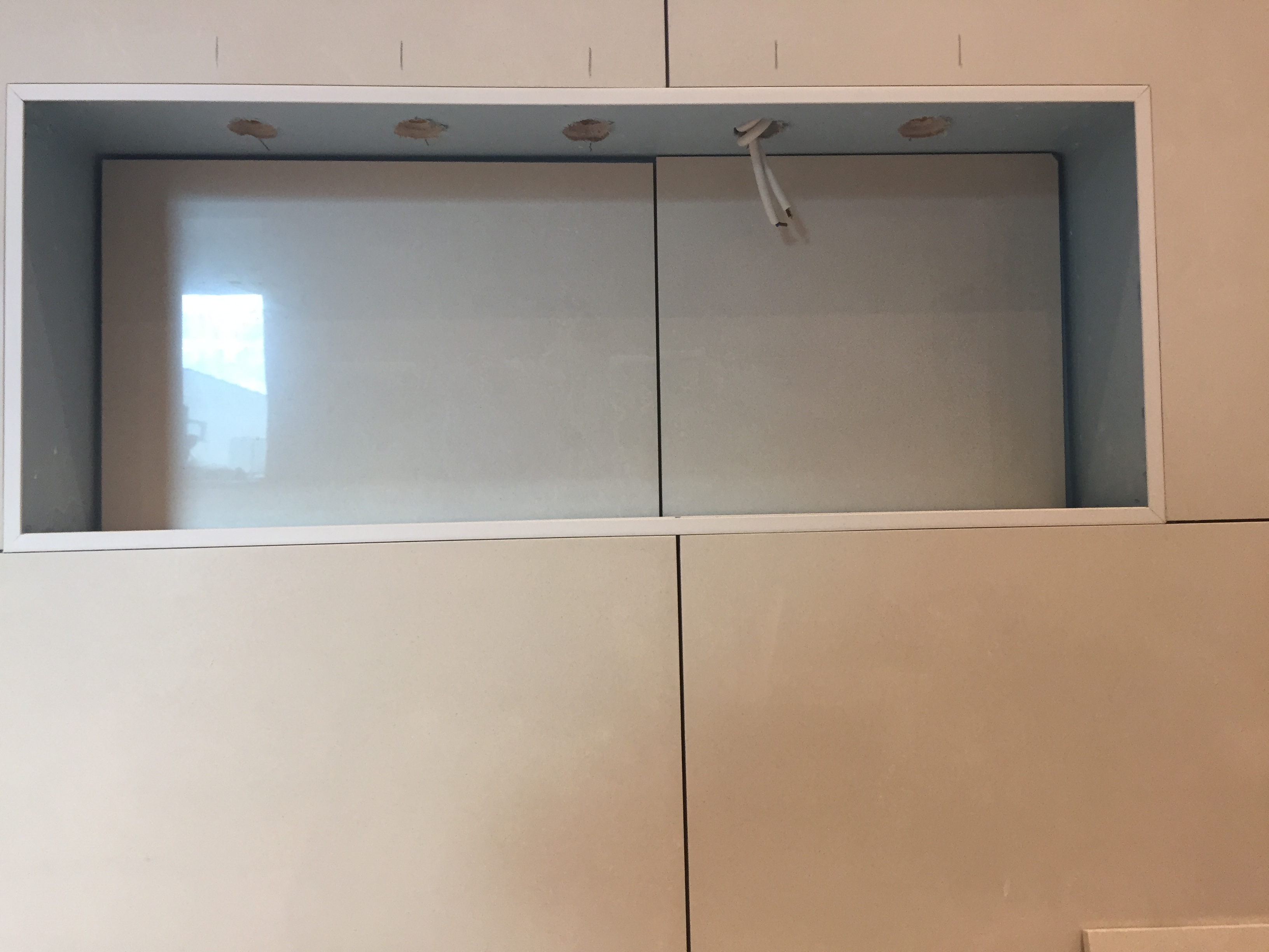

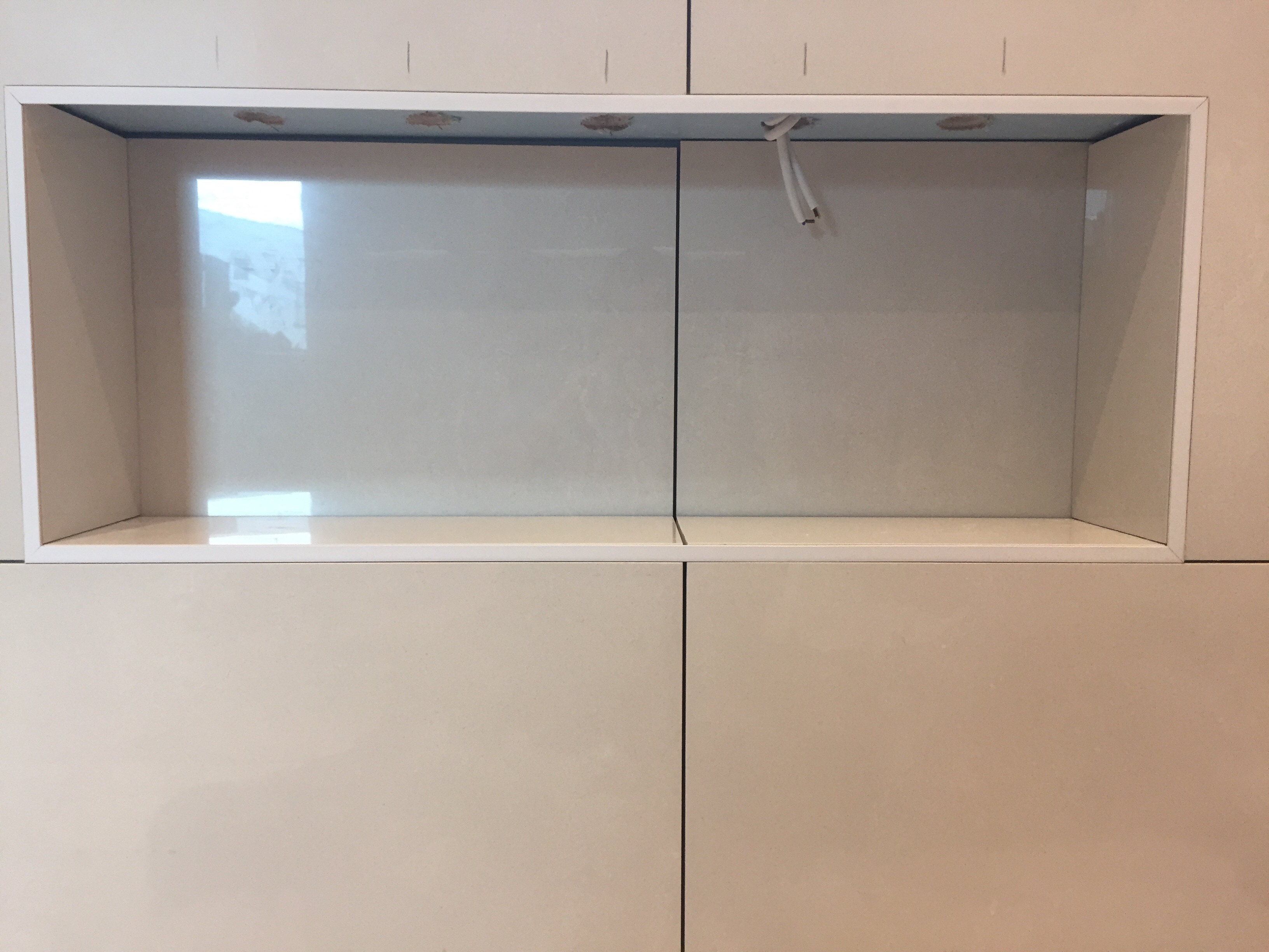

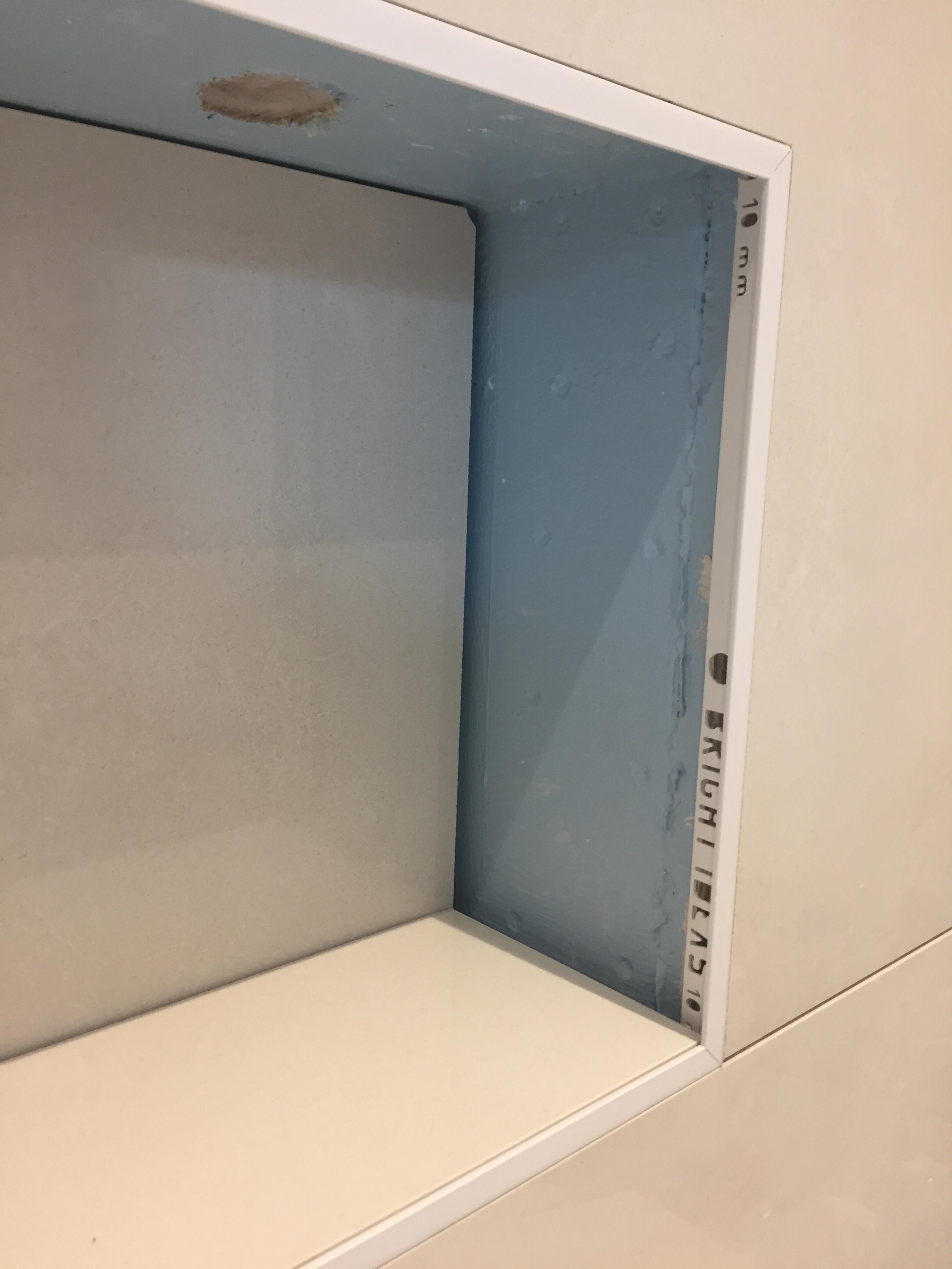

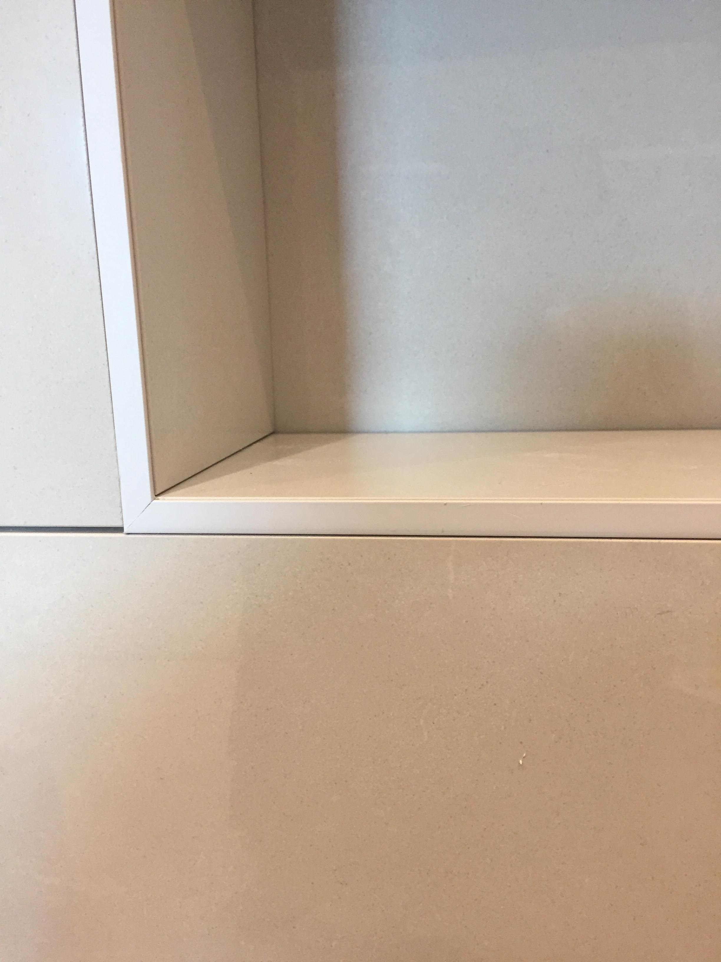

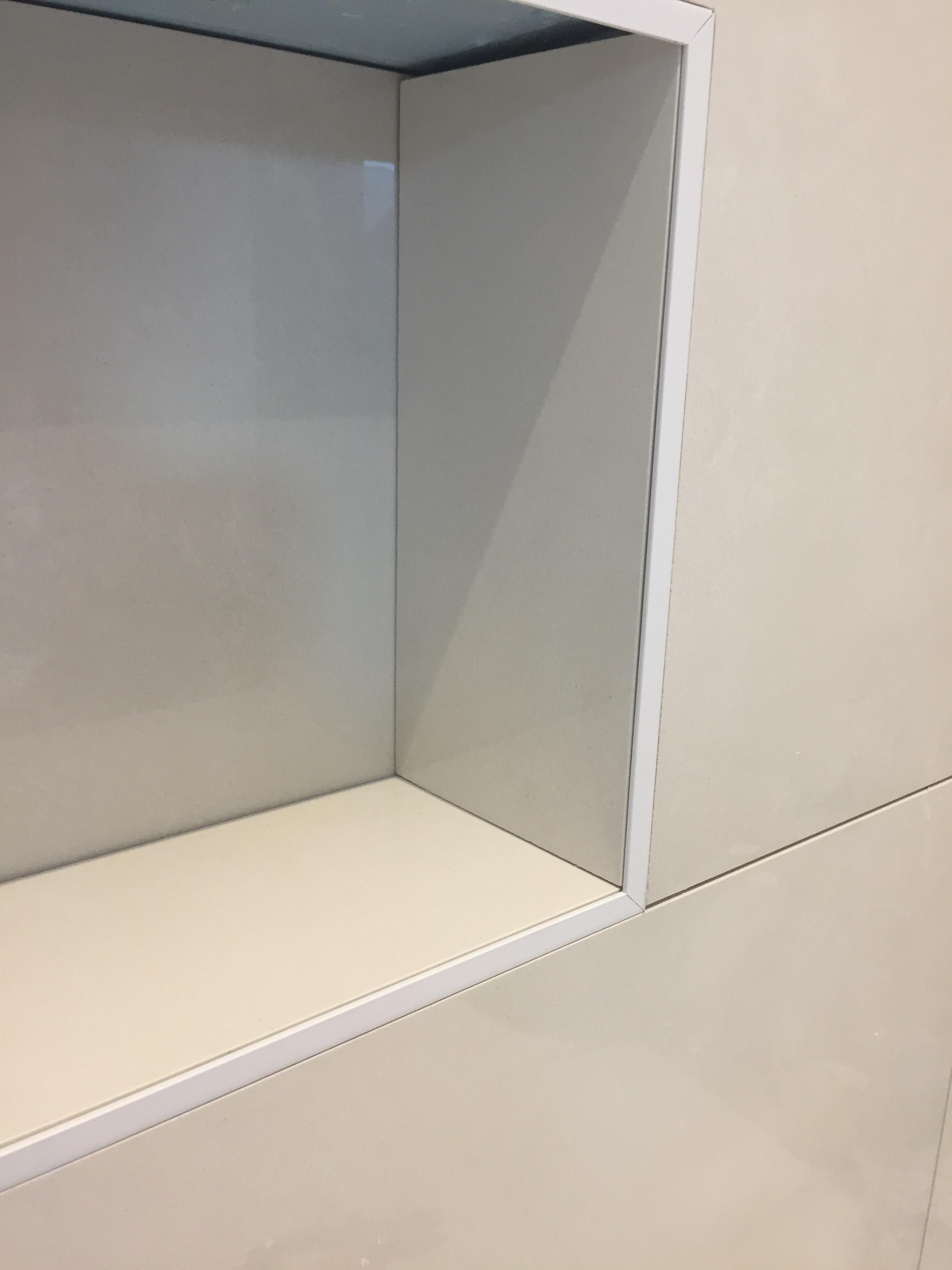

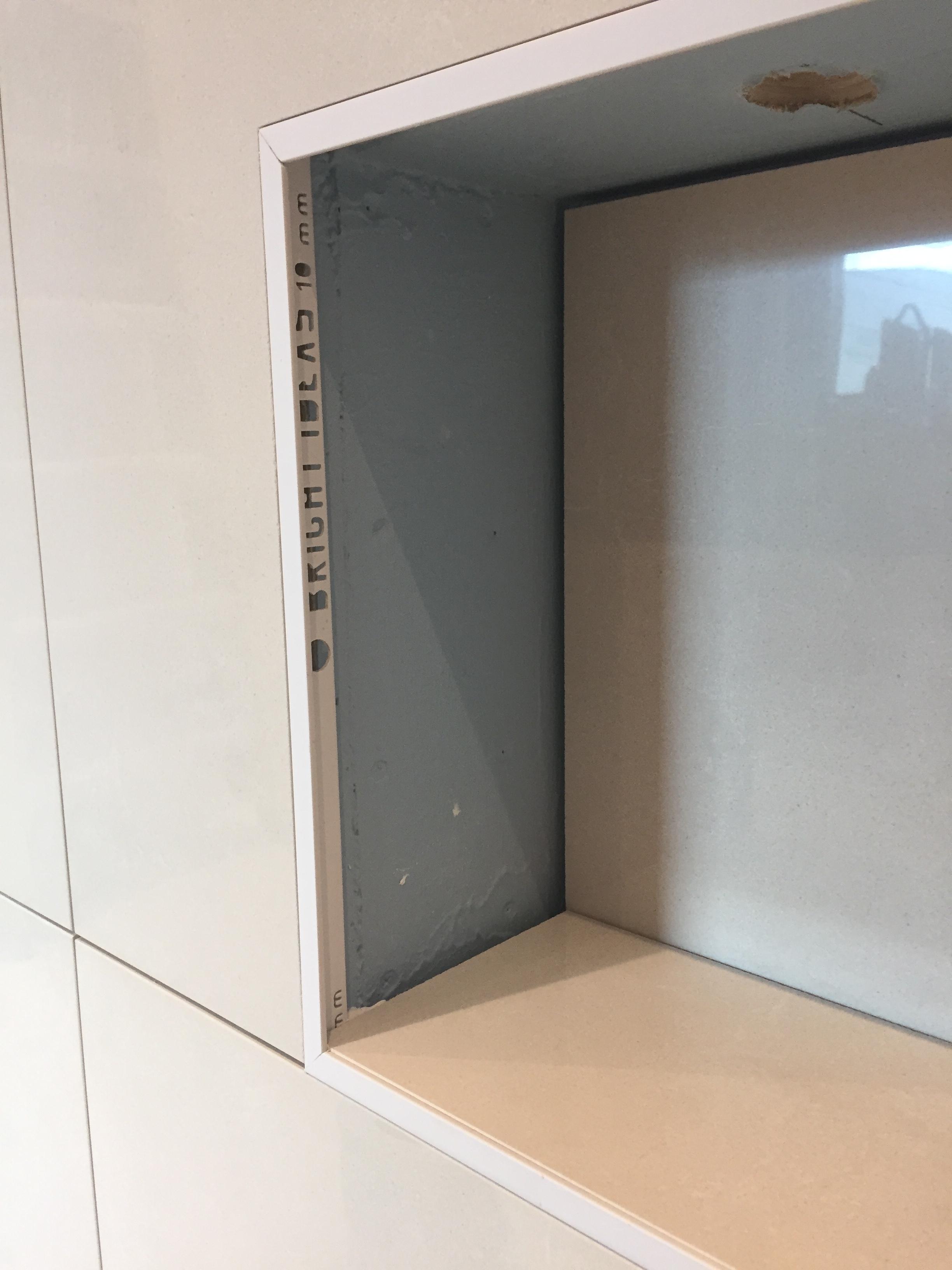

Nickfromwales Posted July 20, 2017 Share Posted July 20, 2017 Frame the tiled wall first with your trim of choice. Then tile the back of the pocket, and don't let that set hard before you tile the bottom of it. You have to be able to slide the rear tiles left / right a little to match the grout line running through, so these need to be done in the same set and then left to go off. Cut outs for accent lighting already done and cable in ? Left and right hand cuts go in next. These pics show the trim detail a bit better. I glue these on with mitre bond and activator spray. Don't use to much glue, and keep it away from the face edge or it oozes out of the gap. Less is more. % 5 Link to comment Share on other sites More sharing options...

Onoff Posted July 20, 2017 Author Share Posted July 20, 2017 2 hours ago, Nickfromwales said: Arise.......you are worthy...... Just slow Some impressive work there! My pockets will be illuminated with LED strips. I'm mulling over arched tops to the pockets... I've printed out your setting out "how to post" from 11 April and pinned it to the wall! Link to comment Share on other sites More sharing options...
