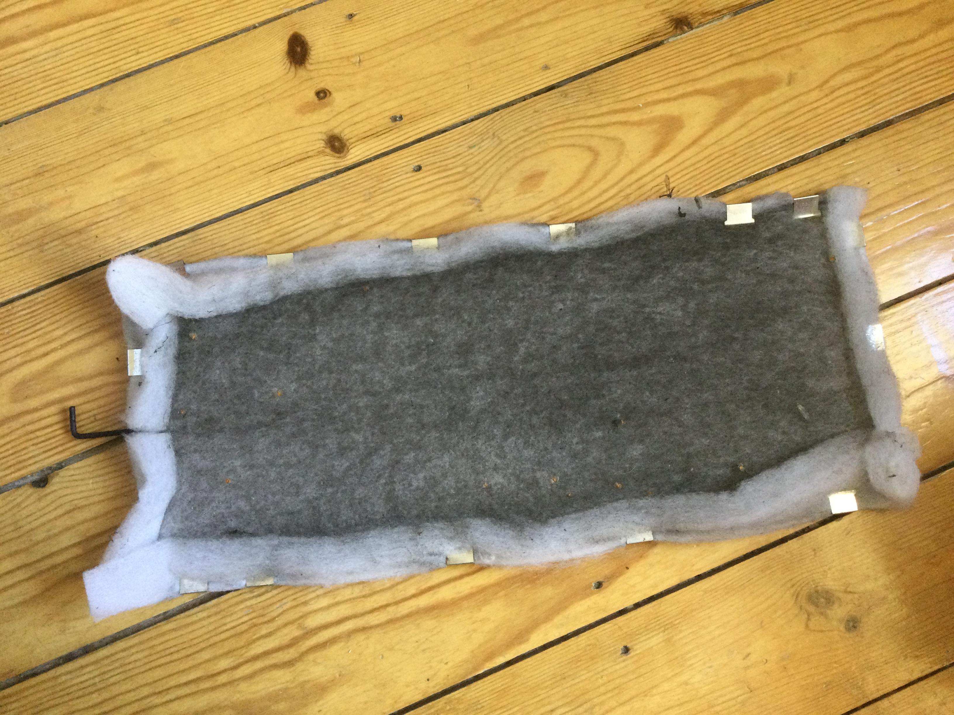

RobLe Posted June 12, 2022 Share Posted June 12, 2022 Our VA sentinel kinetic plus bh averages at 100m3/hour. When we’re in it’s more, when we’re out it’s less, it goes up and down based on humidity and CO2. The filters get changed every 3 or 4 months - that’s when it starts nagging. I pull out the old filters, take the fabric off the metal frame, clip on a new bit of fabric with ‘supaclip’ clips. Piccy of an old one about to be changed: Link to comment Share on other sites More sharing options...
joe90 Posted June 12, 2022 Share Posted June 12, 2022 58 minutes ago, RobLe said: Piccy of an old one about to be changed: Wow, is that dirt? Just goes to show what you would be breathing/cleaning. Link to comment Share on other sites More sharing options...
SteamyTea Posted June 12, 2022 Share Posted June 12, 2022 33 minutes ago, joe90 said: Wow, is that dirt? Just goes to show what you would be breathing/cleaning. Till you light the fire. Link to comment Share on other sites More sharing options...
joe90 Posted June 12, 2022 Share Posted June 12, 2022 31 minutes ago, SteamyTea said: Till you light the fire. Well it’s interesting that my filters are still clean after two years even with the fire lit during winter 🤷♂️ Link to comment Share on other sites More sharing options...
SteamyTea Posted June 12, 2022 Share Posted June 12, 2022 2 minutes ago, joe90 said: Well it’s interesting that my filters are still clean after two years even with the fire lit during winter 🤷♂️ Do you have filters on the outlets then? More seriously, if they are clean, there may not be enough flow though them. Does the local farmer plough, rake and harvest crops? Link to comment Share on other sites More sharing options...
