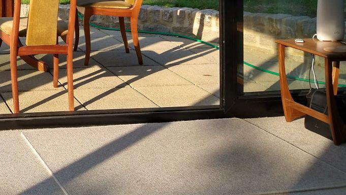

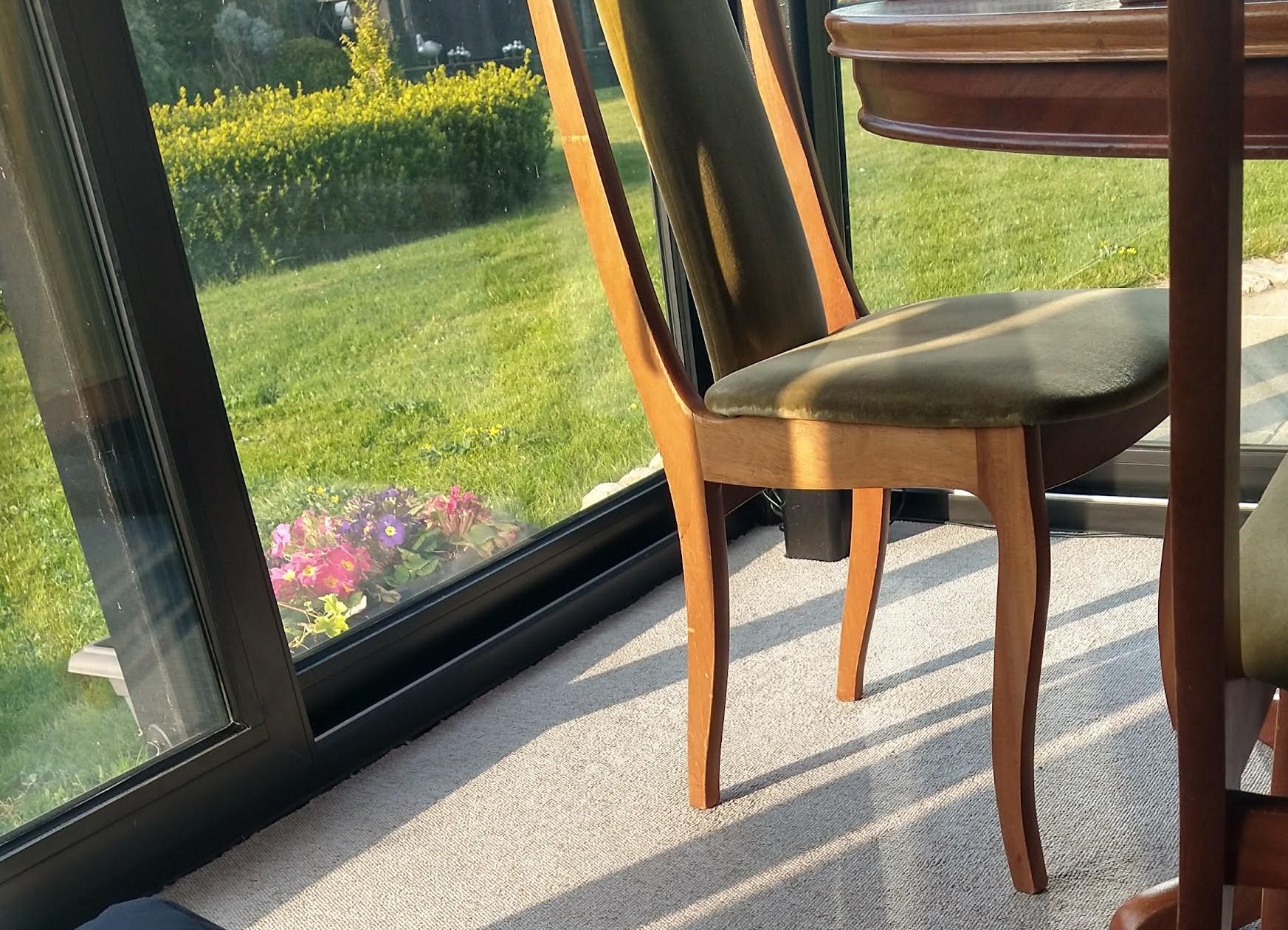

IanR Posted March 26, 2022 Share Posted March 26, 2022 (edited) Best floor ever... ...for living spaces. Carpet and low-tog underlay works for me in bedroom spaces, with UFH. Edited March 26, 2022 by IanR Link to comment Share on other sites More sharing options...

Radian Posted March 26, 2022 Share Posted March 26, 2022 There's something you didn't mention and it was a major factor in why we chose a low tog carpet for our garden room with UFH: With the bare screed floor the sound in the room was awful. I found it difficult to hold a conversation because of the reverberation from all the hard surfaces. We were planning to use tiles but ditched that idea in the light of this experience. It was a fairly cheap synthetic carpet but they're very easy to maintain. One thing that was a little experimental is that we didn't use an underlay. It was simply stuck down. Despite what the carpet fitters were saying I'm glad we did. There's more than enough 'give' underfoot and for a room located between tiled kitchen and patio it didn't seem right to have a really spongy floor. Low tog underlays do exist and if this was a lounge it would be a different matter. Link to comment Share on other sites More sharing options...

crispy_wafer Posted March 26, 2022 Share Posted March 26, 2022 1 hour ago, IanR said: Best floor ever... ...for living spaces. Carpet and low-tog underlay works for me in bedroom spaces, with UFH. I love this, quite unique too, something I really want to investigate when the time comes. Link to comment Share on other sites More sharing options...
