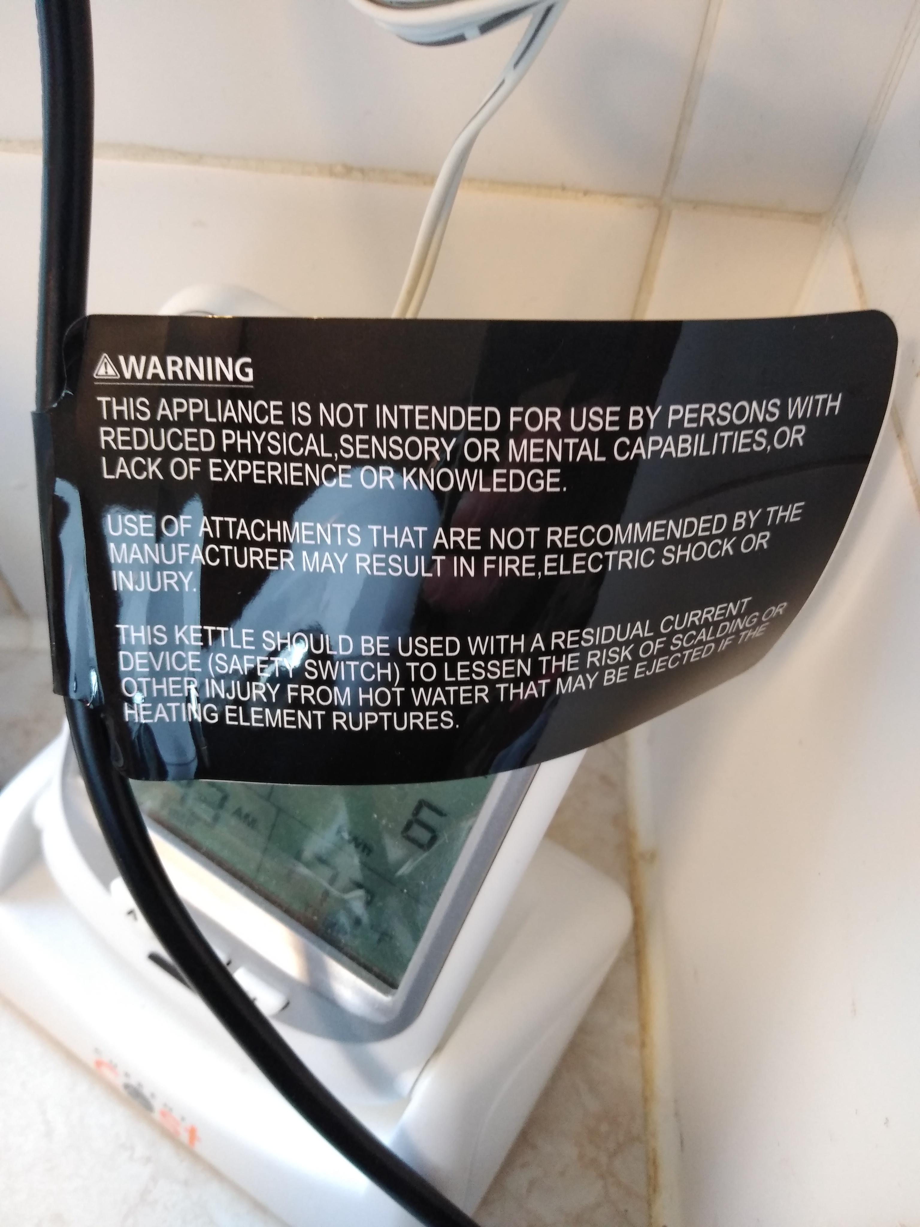

SteamyTea Posted April 11, 2022 Share Posted April 11, 2022 Just seen this label on the lead. Seems only suitable for normal people. Link to comment Share on other sites More sharing options...
markc Posted April 11, 2022 Share Posted April 11, 2022 RCD for scald protection? Anyone ever had an element rupture? Is it painful? Link to comment Share on other sites More sharing options...
