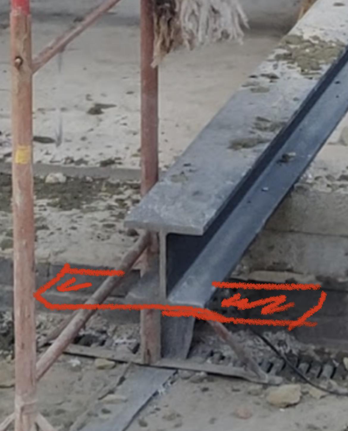

Should I ask my builders anything about this steel work install?
I am no expert, but i would be telling the builder to halt work until the SE has been to site so see the steels and either say they are okay, or tell the builder what remedial work needs doing.  Simply tell them they do not appear to be in accordance with the plans so you want it checked.

8 minutes ago, PeterW said:
Ok so that was a single beam ! That is seriously heavy to move but they have done it.
The end of the beam you have taken a photo of is wrong though and needs correcting. The engineer needs to see that too.
Also, the beam inside that crosses over the room (Beam A on your plan) doesn’t appear to have the plate on the end as described - there should be a 600mm long steel plate to form a “T” at each end but I can’t see it on the photos, just a concrete block. That will create a point load on the steel and on the masonry.
This is the beam that is installed right up where the joists are. Is that a T or an I shape or neither?
on the end / under the end should be a plate like this - forgive the crap drawing as I’m on the phone..!!
It is designed to spread the load of that beam along the brickwork
Thanks that makes more sense and that ties back to what it says on the plan which refers to a "12mm plate" and the way the notch has been cut for the join to the larger beam.

So the crap notch beam has a 12mm plate on the top of it to hold the two skins of wall that are above. Basically this is to be able to use a narrower (cheaper) structurally strong beam with a thinner profile and then add some more width to the top to take the thicker wall.
Likewise, when you want to spread load you add plates that go perpendicular which stop what is called point loading on the brickwork which could crush it, especially if it’s not engineering bricks or padstones.

When this gets replaced, which I think your SE will tell you to, check with your builder whether the fabricators need to allow the replacement beam to finish top or bottom flush with the beam its connecting to. It looks like you're running a 203 dp beam into a 254 dp beam so detail A is wrong as it shows a 203 to 203 detail and it all looks nice and flush but in reality you won't get that as the beams are different depths.

On 15/03/2022 at 21:29, notreadyforthis said:
The beam where there appears to have been a cut is interesting as it didn't get delivered like that.
That beam has been compromised then. Look at your SE drawings and check every detail, if any of it do not match, at all, tell the builder you want him to have a meeting with the SE and that any expenses shall be agreed beforehand between the builder and the SE or you make your own arrangement to withhold some monies at the end of the build to cover the SE visit and any report.

I asked my building regs supplier to check the steel beam fabrication and install and they referred it to their in-house structural engineer. They’ve come back with a one liner “No adverse comments to make” which I take it to mean they don’t take any issues with what’s been done.
My earlier comment which said that the beam has been cut by the builders was incorrect. On closer inspection of photos taken from when the beams were delivered I could just about make out the rough cut for the notch. Also it seems the drawings in the plans were early sketches and not what the fabricator worked from. The fabricator worked from the calculations provided by the structural engineer which comes from a separate document. I’ve since reviewed this document and have been able to match up the beam specifications (size and span at least) to what has been produced.
