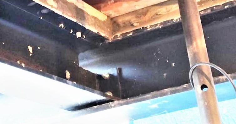

Should I ask my builders anything about this steel work install?
Not really knowing much about building works in general, thought it would be worth posting some pics for you all to see in case anything stood out either in a good or a bad way. Attached should be images of the steel work that has been installed in my living space on the first floor. It's great that we've gotten to this stage as we can see how big the opening will be for the sliding doors. On seeing the gap above the steel (now filled in with brick and cement), I did wonder whether the designers could have pushed the steel up further to accommodate a taller opening but too late for that now!

I would urge you to get this reviewed by an SE say before you go any further. I can't see quite enough from the photos but..
That connection in picture two where one beam is framing into the web of the beam that seems to extend outside is highly questionable. It looks like someone has made a mistake and been cutting, altering the connections on site. The bolts look like M12 diameter, possibly undersized.. not just to carry the vertical loads but also to prevent other things from twisting. The beam has an unexpectedly large notch.
You have some top plates on the steels but the spacing of the welds looks quite large.
Also, you seem to have a couple of beams in the depth of the floor above. This coupled with the steel section sizes suggests you are holding up a fair bit of load and that the load is not always centred over the beams.

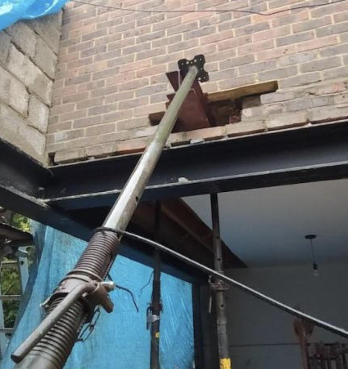

In picture three the beam seems to extend outside so can't see how it is all supported. I know it's not finished yet but it looks like the works are quite extensive. I would at some point expect to see much more tying together of the steels, timbers and masonry so that the overall assembly is stable and safe globally.
The padstone supporting the steels seem to be cast in place. This is often acceptable and can be advantageous at times, have done this on my own house for example as it can really help tie the brickwork below together. However I would also want to have a look at these in closer detail.
Sorry about the above but I would get this checked out professionally by an SE for example.

Steel plates are fine, padstones exellent, the concrete ‘lump’ between the two steels in the first two pics is horrid. And the notch is in my view unacceptable. I used to make a slot in the web of the steel with the plate on it such that it perfectly fitted over the web.
engineer now needs to sign off the notch

I wonder why the webbing was cut away so much more than necessary to mate the two beams together?
I just Increased the exposure of this photo to get a better look...
IMG_20220312_173824-2.thumb.jpg.6aa9a2be09f49b2ac4749125cd144340.jpg.efcf29a819b390fce727b767af5d2a96.jpg
Taken to extremes (for the purposes of visualising the issue) if the notch had gone all the way down the web then the only element that would resist bending is the flat plate forming the bottom of the "ɪ"
Agreed, that looks very wrong. to cut out so much of the beam rather than just the top flange where they clash, and to have such a small cleat connection at the bottom,
Also the connection being at the bottom puts more twist into the big beam than is necessary.
The steels do not look 'under-designed' so it might  be ok but needs checking immediately, before they build it out of sight.

So Detail A is definitely not as built ..! It shows a top and bottom flange cut and a pair of L brackets that have 4 No. bolts through the web. That has been done using a welded plate on the end of a hacked out (gas axe most likely) notch that does not meet spec.
Who ordered and supplied the steels ..? They don’t meet your specification.
Do you have another page with Detail 3 on it as I don’t think that is to spec either.

Oh and this is about as dangerous as it gets … That is the worst way to load an acro prop, and it could have brought the side of your house down ..!! If HSE saw that they would come down on him like a proverbial ton of bricks ..!

That is not to spec so the joint is not correct and not structurally sound. It means there is excessive stress in the joint and it could catastrophically fail without warning. The notching could have created a stress point in the steel that will also weaken it.
That could be repaired on site with a pair of angle brackets either side but would need the engineer to sign off on it and provide new calculations. The current install also puts load on the bottom flange of the larger beam which is not as designed so this needs recalculating.
I'm not entirely sure if that acro is doing anything at the moment and they just haven't got around to clearing it. A few days after the steel beams went in, they started taking them out and they were leaning like in the picture but they definitely weren't before. I assume they haven't got around to tidying it away?
it is holding up the end of a steel pin (the bit through the wall) that weighs probably 90-100kg. If it slips, it will fall and kill or seriously injure the person it hits. It’s dangerous - to the point I wouldn’t go on site if they were left like that even wearing a hard hat !

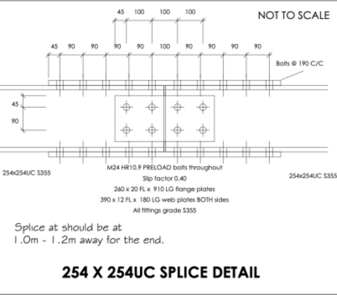

Somewhere in the large front beam there should be a join (unless they have used one very heavy single beam) and it should have a join in it that has a number of bolts in it like in this picture.
The top and bottom flat sections should have 20mm thick by 900mm long with 20 Bolts in each plate. Either side of the flange (the upright of the beam) should be a plate with 8 bolts through it.
The splice also should be no nearer than 1m to a wall.
 Each pin has a second acro on it if it makes any difference or would you still say that's unsafe? I ask not to challenge but to understand so I can go into a conversation with the builder better informed.
