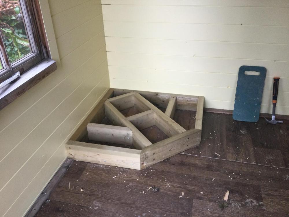

  • BC aren't to know about this job/ no need them aware of it.   Here's my base..

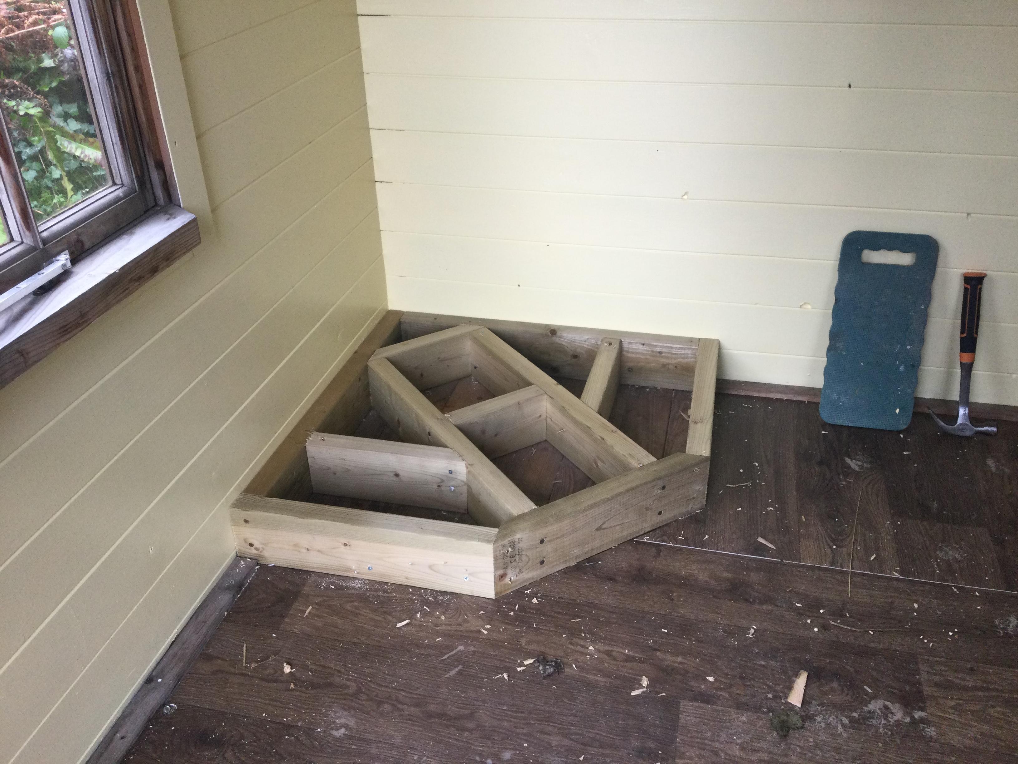

Ive got my 5x2 timber today, to make my plinth frame tmrw. Ply top then slabs on for a hearth.. will be 7" H or so.
Its stupidly low as you can see as it is, so defo needs a step up.

Here's my base..
Looking good zoot ?, you have come a long way.
Hi John. One nog's a fraction not straight. The shame. But making up for it with a marine ply top!
If I go pave slabs ontop, seems likely/ cheapest.. would it be mortar to use on the ply? Fwiw Ive pva sealed the ply top.
Thanks zoot.
Looking great!
I wonder if you could just butt the slabs together with an intumescent, adhesive mastic?

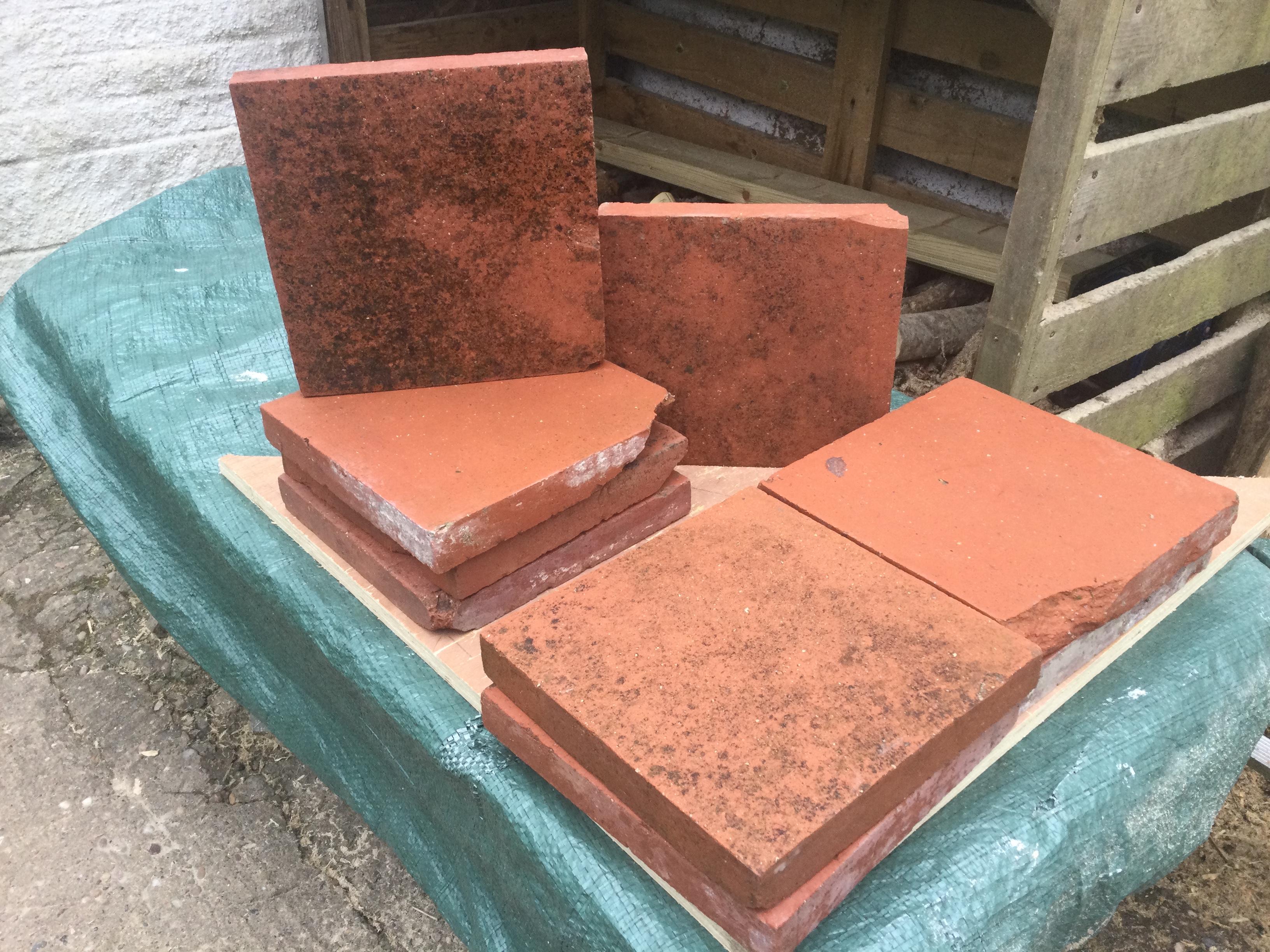

What I have in mind now, is same tiles as my porch/ 1" thick jobs. Will save me £20 on 4 pave slabs which won't look too nice. Im one short but will have to compromise.
A faff of a job grouting etc which I hate. But with new this idea in mind, would it be usual way, tile adhesive/ grout onto the ply?

Great that's a plan, ie no nails & grout.. mind you now can possibly use 4 old terracotta 440mm pavers, but my quarry tiles would look better, a visual link to my stove hearth in main room, & porch too.. but infuriatingly I'm 1 short.

You see Im wondering if my alternate idea, using standard thickness tiles (8 mm or so) which I found enough of here & teracotta couloured... might not be suitable from a heat pov.
The quarry porch ones Im 1 short of, are much thicker giving me the ideal heat barrier,  plus the added height I want too.

Could someone remind me what I could do, to clean off this ( rock solid stubborn) black staining on my quarry tiles?
If it's damn expensive, then just for say 5... it wouldn't be worth it. Is there any possible 'cheap' way to get then presentable?
Thanks, zoot.
Put in dishwasher. Or simply soak one in in some washing powder in hot water. Report back.

I only had vinegar & sandpaper. It sort of worked!
Ok tiles all cut. Now can I just use a cement mortar for the bed/ adhesive layer? Im sure my marine ply is solid enough/ no flex at all. I just bought the wrong " nails " tube stuff it seems/ crap, so I need to crack on.
Mortar is all i have: heavy brick tiles mind you, outside pretty frosty.. not such a bad idea?

Its called "151 hard as nails". Not "no nails". Its got crap reviews ' wont stick anything ' etc.
Peter Im reading up that quarry tiles are better laid on mortar, building site info etc. 3:1 with a tiddle of antifrost plasticiser-?
