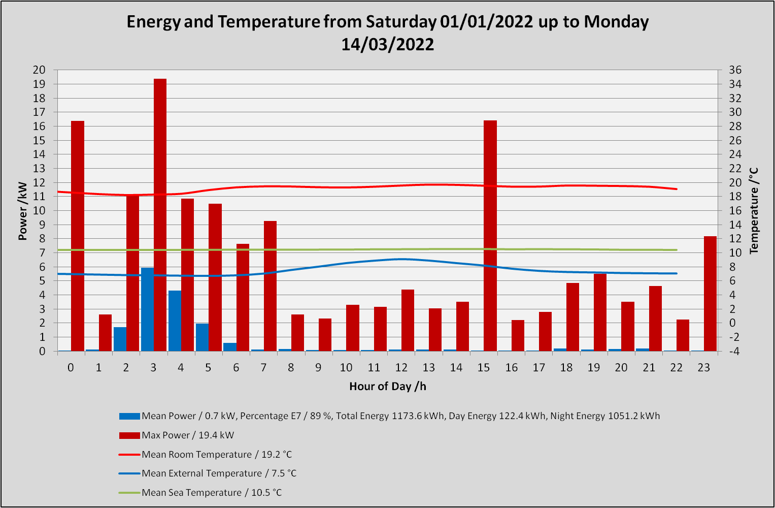

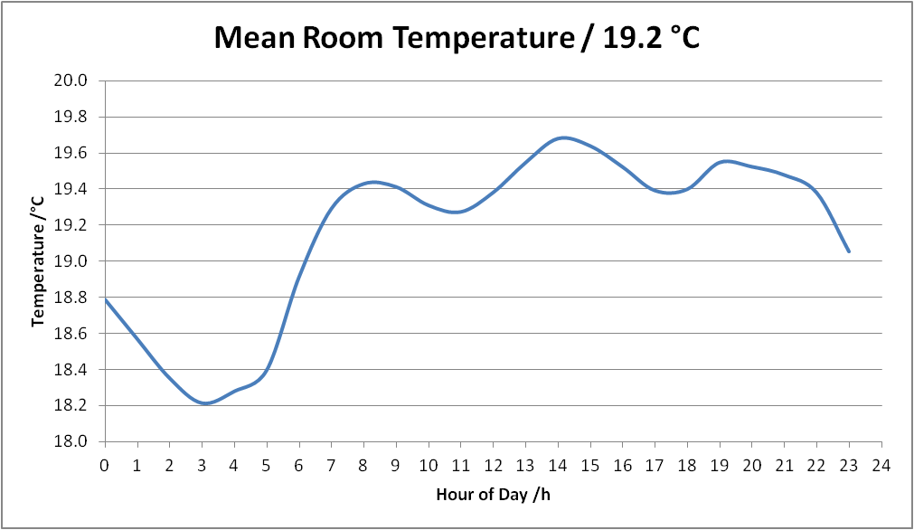

SteamyTea Posted September 4, 2022 Posted September 4, 2022 (edited) On 04/09/2022 at 19:18, Onoff said: I have this vague recollection it was less than it takes to boil a kettle? Expand Do you man the power taken to run a kettle ~2.8 kW, or the energy to boil a kettle full of water ~0.16 kWh. I had a quick look at the first 72 day of this year, daily mean of 16.3 kWh, then looked at the 72 days from June 1st, 3.1 kWh. So 3.1 kWh/day for DHW and everything else (ish). So to heat my 48 m2 house takes, on average 13.2 kWh/day. 72 days is 2448 hours [950.4 kWh] works out at a mean power of 423 W, or 9W/m2. The mean room temperature was 19.2°C, mean external temperature 7.5°C, a delta of 11.7°C. The mean room temperature is a little lower than I aim for [20°C], but the hourly profile is pretty good now [delaying the start of heating helps]. With my new draught proofing measure this year, I expect to see a reduction in usage and an increase in temperature to close to the target. Below is a more detailed profile. Edited September 4, 2022 by SteamyTea 1
