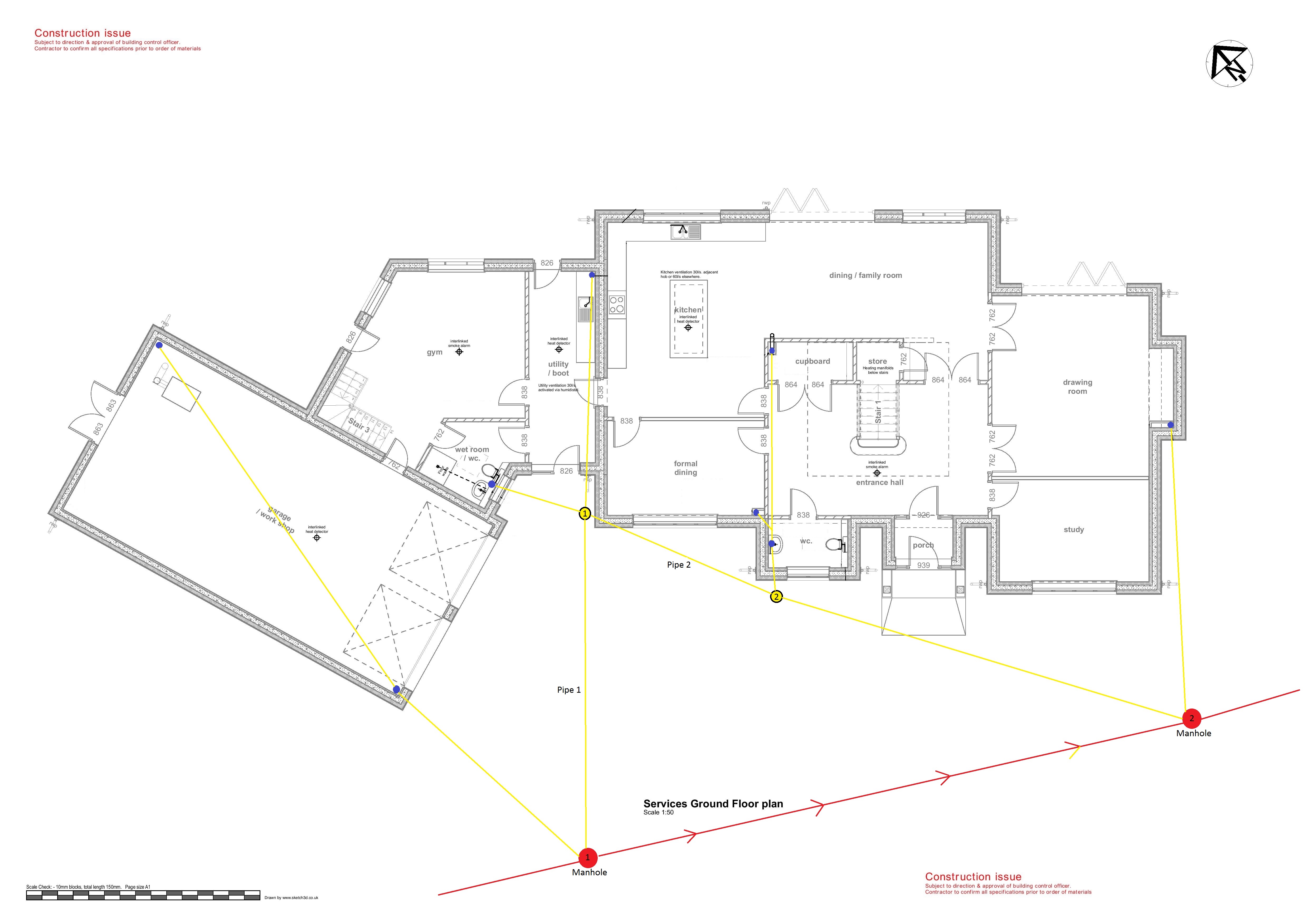

Vijay Posted April 21, 2017 Posted April 21, 2017 I think I've sorted a drainage plan but before I run it past the BCO, could I have any thoughts on it. The blue dots are all the points where they rise through the floors and the yellow lines are the pipe runs. There are already 2 manholes (large red dots) where the pipes are already run and connected into the mains sewage. I have 2 inspection chambers (yellow dots) which then run onto the 2 manholes. I could run IC1 to either manhole (pipe 1 or 2), would it make a difference?
Barney12 Posted April 21, 2017 Posted April 21, 2017 I am FAR from an expert but I dont think this works: Chambers have an "inlet" and an "outlet" at the lower level. These are fed by 2 or 4 inlets at a higher level. You seem to have runs crossing. Do you even need this pipe? Hope that provokes thought. I'm no expert.
bassanclan Posted April 21, 2017 Posted April 21, 2017 I think inspection chamber 1 should be moved down a bit, so pipe 2 doesn't doesn't cross the line of foundations. Get rid of pipe 1, I assume pipe 2 will get less traffic over it and be easier to get at if you need to in the future. Are you swapping the gf wc basin and loo locations?

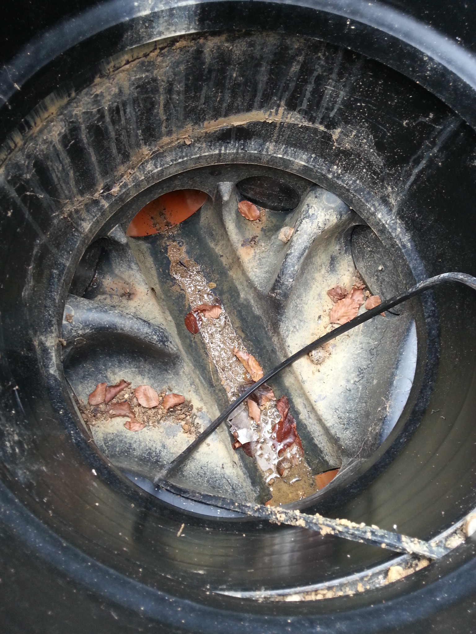

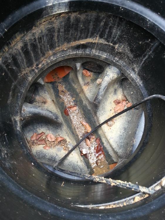

Vijay Posted April 21, 2017 Author Posted April 21, 2017 Hi Barney12, I've only looked at he manholes that were installed (red dots) and I didn't see why they they couldn't have as many as 5 inlets and 1 outlet (pic attached), 1 would run straight through and another 4 from the sides? I would use EITHER pipe 1 or 2, so wouldn't need both
Vijay Posted April 21, 2017 Author Posted April 21, 2017 4 minutes ago, bassanclan said: I think inspection chamber 1 should be moved down a bit, so pipe 2 doesn't doesn't cross the line of foundations. Get rid of pipe 1, I assume pipe 2 will get less traffic over it and be easier to get at if you need to in the future. Are you swapping the gf wc basin and loo locations? I've confirmed with the BCO that he's happy for pipes to be within foundations as long as they are supported above with a lintel, but I'd happily move that IC a bit to find the best position on site. Yes, pipe 2 would get less traffic but I wondered if it was better so split things up between the 2 manholes as they are joined by 6" pipework. Yep, I didn't see the sense in having the loo on the other side of the drainage and having pipe running around the walls, sow they will be swapped over
MikeSharp01 Posted April 21, 2017 Posted April 21, 2017 Cripes - its been so long since one had a drawing room! I guess the best thing is to define the rules and then work it out from there. Here is what I have been using as rules, that I can recall. 1. Keep the falls correct as per BR. 2. Do not have underground joins - IE only join flows at access chambers so you can rod through in case of a blockage. 3. Have straight runs to access chambers - max flows to one chamber looks to be about 5 see HERE 4. Do not split flows out - you will end up with, for want of a better word, muck building up on the split and eventually it will block. 5. keep runs under the house to a minimum and always straight. 6. Employ correct practice when passing through slabs / foundations to allow for differential movement, structural integrity and any possible settlement. 7. There are special rules for dwellings with many toilets that ensue you don't create a backup if everybody flushes at once! (usually the minimum size pipe allowed) Think that is everything
Vijay Posted April 21, 2017 Author Posted April 21, 2017 Mike, I'm common from London, so I don't have a drawing room, there's only front and back rooms to me lol I didn't think about number 2, I'll have to look at the length of drainage pipe. What do you mean with number 4, don't split flows out?
oranjeboom Posted April 21, 2017 Posted April 21, 2017 12 minutes ago, Vijay said: Mike, I'm common from London, so I don't have a drawing room, there's only front and back rooms to me lol I didn't think about number 2, I'll have to look at the length of drainage pipe. What do you mean with number 4, don't split flows out? Number two's are the most important aspect when it comes to sewerage I would say! No.4 = You are splitting your outflow into two paths at IC1 in this case. This has the potential to reduce flow of water via either route and increase debris settlement at the point of the split. I think that's what @MikeSharp01 is referring to.
PeterW Posted April 21, 2017 Posted April 21, 2017 Always combine - never split ..!! Unless you have a perfect split with a matched flow then you will end up with blockages if you try to split a drain. Only reason for doing it is on big installations (i.e. Hospitals, hotels) and then it's done using weir tanks which are all specialist design and installation items.
Vijay Posted April 21, 2017 Author Posted April 21, 2017 I'm not splitting at IC1, it will be EITHER pipe 1 or 2, not both. The reason both are shown is there is an option and wondered which would be best
Vijay Posted April 21, 2017 Author Posted April 21, 2017 6 minutes ago, oranjeboom said: Number two's are the most important aspect when it comes to sewerage I would say! Especially if you drink Guiness so I've been told!! lol
MikeSharp01 Posted April 21, 2017 Posted April 21, 2017 2 hours ago, Vijay said: Mike, I'm common from London, so I don't have a drawing room, there's only front and back rooms to me lo Sorry @Vijay its an in joke with me which is the result of something a friend said to me many years ago, suffice it to say they built an extension on their cottage which included a drawing room because it had been a long time since one had had a drawing room.
Vijay Posted May 2, 2017 Author Posted May 2, 2017 Just to update this post, the BCO is happy with the plan and happy for IC1 to go to either manhole 1 or 2

Triassic Posted May 29, 2017 Posted May 29, 2017 I'd not be happy with the poorly jointed riser ring in the photo above, it's not inserted properly, I'd want to get that sorted out as part of the job.
