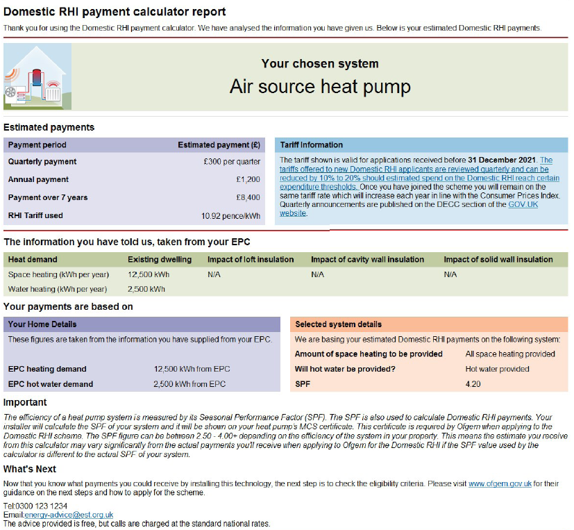

26 minutes ago, Ferdinand said:
My annual space heating demand (from my gas bill minus a bit for hot water and cooking) is about 12500 kWh / 201 sqm = approx 62 kWh/sqm/yr.
You may be surprised, roughly £8,400 from RHI over 7 years.
From https://renewable-heat-calculator.service.gov.uk/StartCalculation.aspx
Just make sure you change the default SPF (SCOP). I've set it to 4.2, which is easily achievable. A higher grant is available if you choose an ASHP with a higher SCOP.
