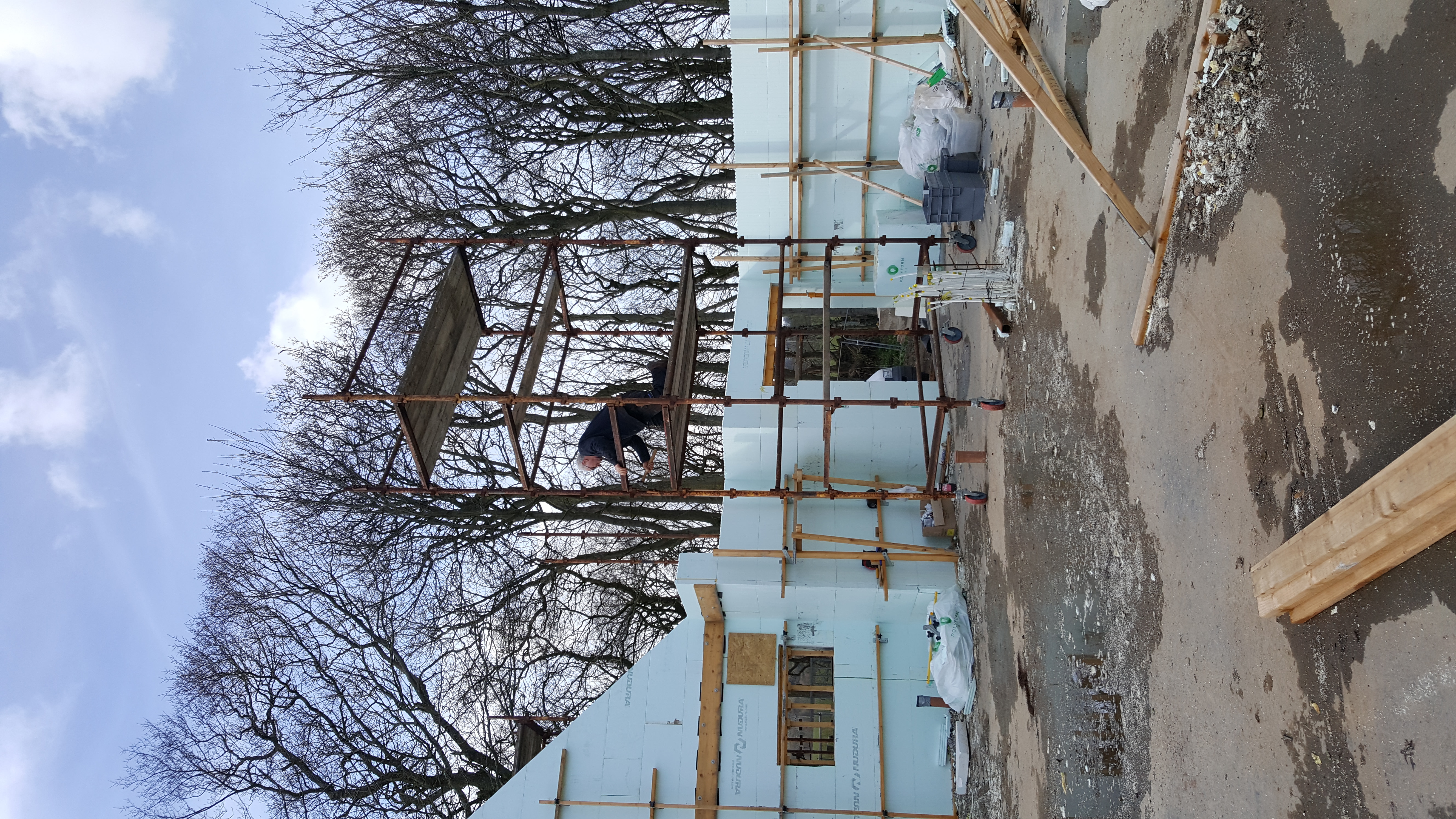

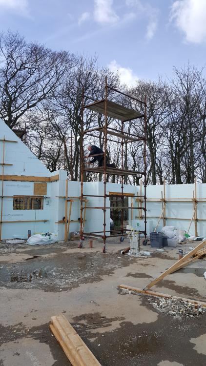

Sorry, this is a very delayed update, as I didn't get around to painting the garage until yesterday.
The cheap'ish pressure sprayer works very well indeed.  There's a very slight knack in getting the pressure setting right, but overall it's not too fussy, so you can be up and spraying well after around ten minutes.  It is blindingly quick; it will empty a 5 litre can of paint in around 10 minutes.  The finish is very good, much better than I can get with either a brush or a roller.  It sprays thicker emulsion more easily than thinned emulsion.
I made the mistake of thinning down the first mist coat, and it really wasn't needed.  It applies a LOT more paint than you can get on with a brush or roller, and runs don't seem to be a problem at all.  The only limit on how thick a coat you apply is really the finish, it noticeable degrades if you go too mad.  The big advantage of being able to apply more paint in a single pass is that you need fewer coats.  Two coats of white was absolutely fine and just a single coat over the green finished ceiling boards was enough, really, the second coat didn't make the finish any more opaque, just gave a better surface.
Spraying a 2.35m high ceiling from floor level was a doddle, with no need for any extension on the nozzle.  I reckon I sprayed the whole 6m x 4m ceiling in around 5 to 6 minutes, including taking time to go around into the corners.  Painting a garage isn't a great test, especially as the wall lining is OSB, but I reckon the smooth ceiling boards were pretty close to plasterboard in terms of smoothness, and the finish looks good enough to me.
The main downside of the thing is the time it takes to clean it after use.  After spraying 10 litres of paint in around twenty minutes, I then had to spend about half an hour washing the thing out and cleaning and drying the gun parts, then lubricating the pump ready for the next time I use it.  The other key point is that you have to mix the paint really, really well.  Mixing by hand with a stick isn't good enough, it really needs a paint mixer paddle on a drill.  Time spent mixing the paint is well spent, as if there is one lumpy bit it will block the pick up pipe filter, which then has to be cleaned and the system re-primed.
There is very little over-spray, so there's no need to go mad with masking, but there is a fair bit of dry bounce back if you don't keep the gun dead square and at the right distance from the surface.  This bounce back is just like white dust, the paint particles are so fine that they dry in the air, but they do settle on any horizontal surface.  They don't stick, though, so if you haven't put dust sheets down you will have a fair bit of cleaning up to do afterwards. You can spray right up to the edges of doors, windows etc, just by using a large bit of stiff card, with a straight edge, in your spare hand, as a movable mask.  It's not like air spraying at all, in that the paint pattern from the gun is very well defined, with almost no over-spray.
Overall I think this was a good buy.  I hate painting, with a vengeance, so might well have ended up paying someone to do this job otherwise, and that would have cost at least as much as this spray system.  For anyone looking to paint a large area I would highly recommend thinking about buying or hiring one of these units.  Mine was pretty cheap, and looked new to me, and cost less than a day's labour for a decorator.  Add in that there are no consumable costs, like rollers, trays, etc, and it looks even better value.
As a final point, there is a safety issue that should be mentioned.  These things run at pressure-washer type pressures, and can inject paint through your skin if you're daft enough to put you hand in front of the gun.  The consequences of that could be very serious indeed, so best to wear gloves and be aware of the danger.
