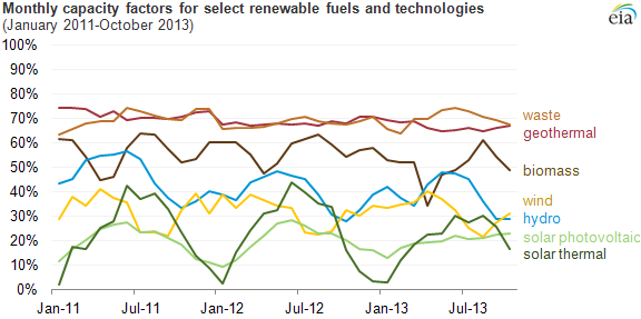

AliG Posted September 20, 2021 Posted September 20, 2021 12 hours ago, epsilonGreedy said: You say offshore wind is more dependable which is true however the availability capacity of offshore wind is still well below 50%. For most of the past month wind power has contributed 10% of its BBC Headline installed capacity. It is worth noting that installed capacity is very misleading figure to use when talking about wind power. Expected capacity factor for onshore and is around 30% and for offshore wind is around 50%. This is averaged over a year. The 30% average would tend to be around 20% in summer when there is less wind and 40% in winter. Thus wind turbines recently have been maybe producing around 50% of their expected output, not the 10% number that the media will use to make things sound worse (which they love to do) The expected cost of wind energy is based on these capacity factors and the headline capacity is somewhat irrelevant. It is just the maximum output. In the same way, my 5kw solar array generates around 3500-4000kWh a year. It has a capacity of 43800kwh 24hrs x 365days x 5kw, so it runs at less than 10% of capacity. Of course as it cannot generate electricity during the night, for example, then the capacity number is again not really relevant.

epsilonGreedy Posted September 21, 2021 Posted September 21, 2021 11 hours ago, AliG said: It is worth noting that installed capacity is very misleading figure to use when talking about wind power. ... The expected cost of wind energy is based on these capacity factors and the headline capacity is somewhat irrelevant. It is just the maximum output. Which is the point I have been trying to make for months if not years. The problem is there is a collusion between climate change activist organizations like the BBC and the wind industry to fool the general public into thinking we are making more progress with renewables than is the case. I am fed up with BBC journalists claiming that a new windfarm will supply all the electricity for a city like Edinburgh when the truth is that on a few days each year when there is half a gale blowing across Scotland the new wind farm will briefly provide the city with all its electricity. 11 hours ago, AliG said: Thus wind turbines recently have been maybe producing around 50% of their expected output, not the 10% number that the media will use to make things sound worse (which they love to do) This is another trap people fall into. Perhaps there is a glossy brochure from a wind turbine manufacturer that claims their latest mega turbine operates at 50% capacity at a choice spot in the north sea, however the renewables industry has been operating long enough for it to be assessed on what it delivers today. Today those figures are something like 27% availability for onshore and 38% offshore. On any day or week the actual figure can drop to 5% or 10% as the current crisis illustrates. When Mrs Jones of Trawsfynydd lights her candle in the middle of a blackout this winter is offers no comfort to tell her "don't worry dear, in 30 years times when all the existing turbines have been replaced availability to have climbed to 50%.
