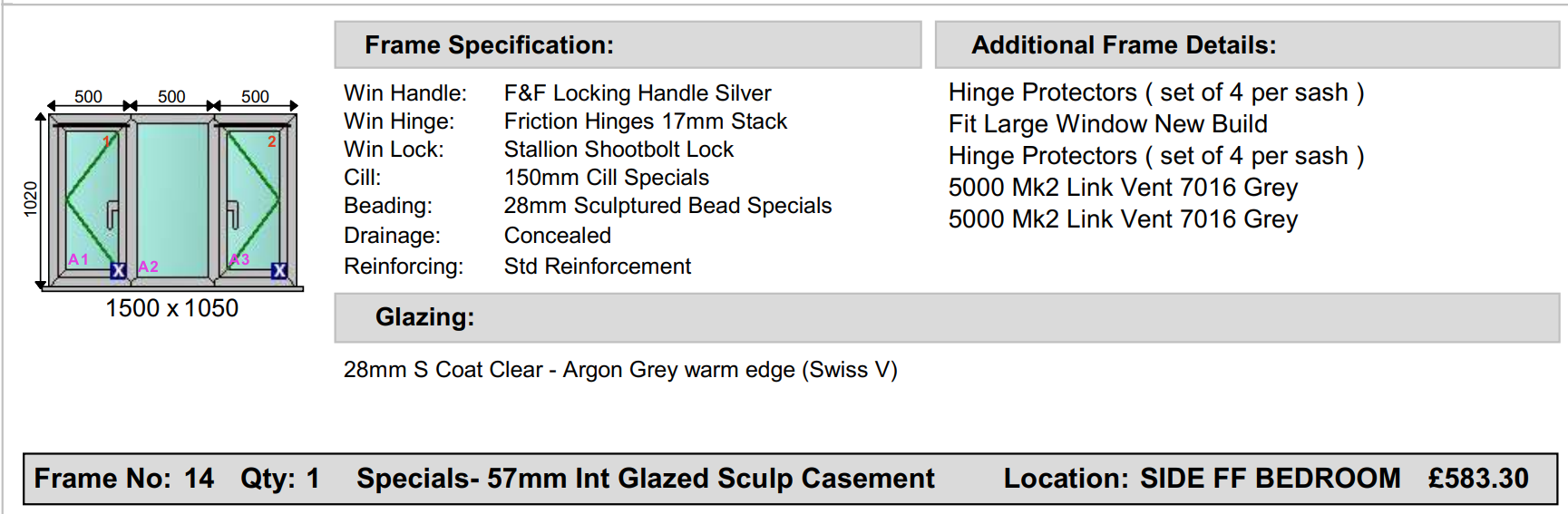

crispy_wafer Posted August 5, 2021 Author Posted August 5, 2021 Quick reply One window is a specialist job, no question about that, and am will absolutely pay for fitting on that, and that does require a lift etc. The rest of the windows are your run of the mill std casement upvc type affair largest being 1900*1050 down to 600*1050 - 12 windows in all, then a back door and 2 sets of french doors. Maybe I'm being a tight arse, and expecting champagne for beer money. Happy to be told to reign expectations in, that's the market rate, and actually a decent deal... Example
James Newport Posted August 5, 2021 Posted August 5, 2021 12 months ago a 2m wide PVC window with that same configuration cost me £225 for supply only, including VAT. Took a guy a couple of hours to fit it.

NewToAllOfThis Posted August 7, 2021 Posted August 7, 2021 On 31/07/2021 at 16:34, Oz07 said: I've never had a problem with plasterboard boxes but a lot don't like them. @ProDave is in the trade and think he is happy with them. I've never heard of these being fitted before boarding/2nd fix surely it defeats the object? On 05/08/2021 at 14:01, crispy_wafer said: Quick reply One window is a specialist job, no question about that, and am will absolutely pay for fitting on that, and that does require a lift etc. The rest of the windows are your run of the mill std casement upvc type affair largest being 1900*1050 down to 600*1050 - 12 windows in all, then a back door and 2 sets of french doors. Maybe I'm being a tight arse, and expecting champagne for beer money. Happy to be told to reign expectations in, that's the market rate, and actually a decent deal... Example
Russell griffiths Posted August 7, 2021 Posted August 7, 2021 1500x 1000 is a small window in my book, when they get to 3000x 1600 then they get a bit heavy, window fitting must be the most overcharged job going.
