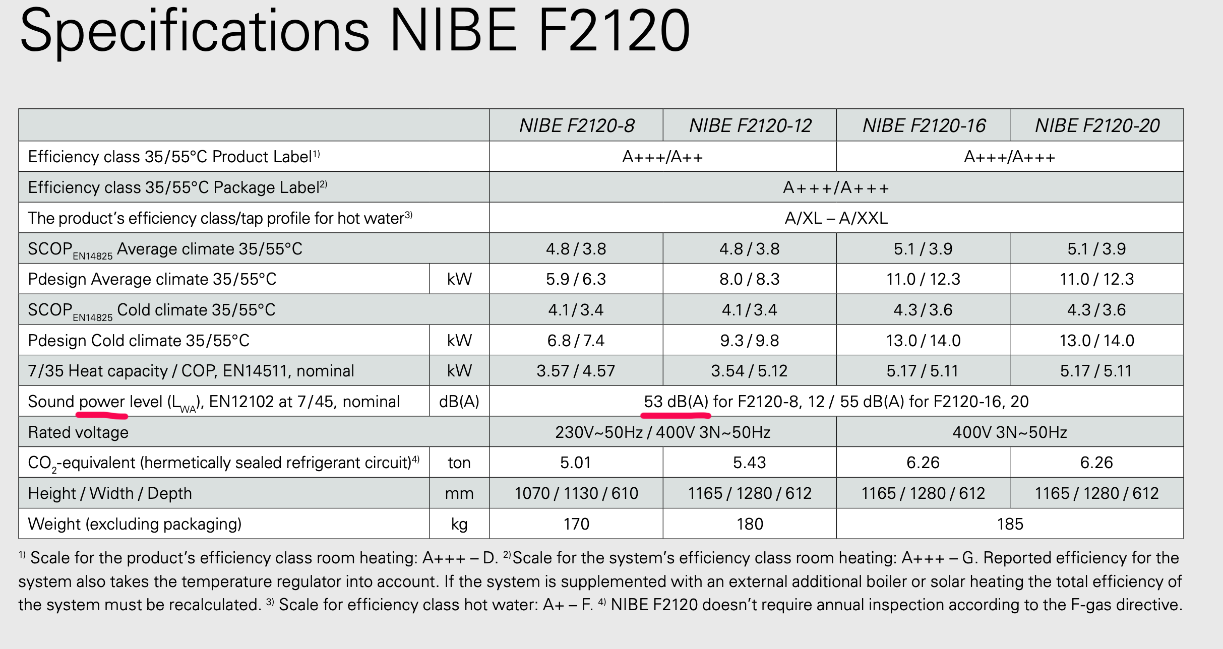

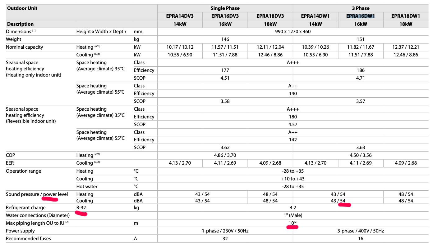

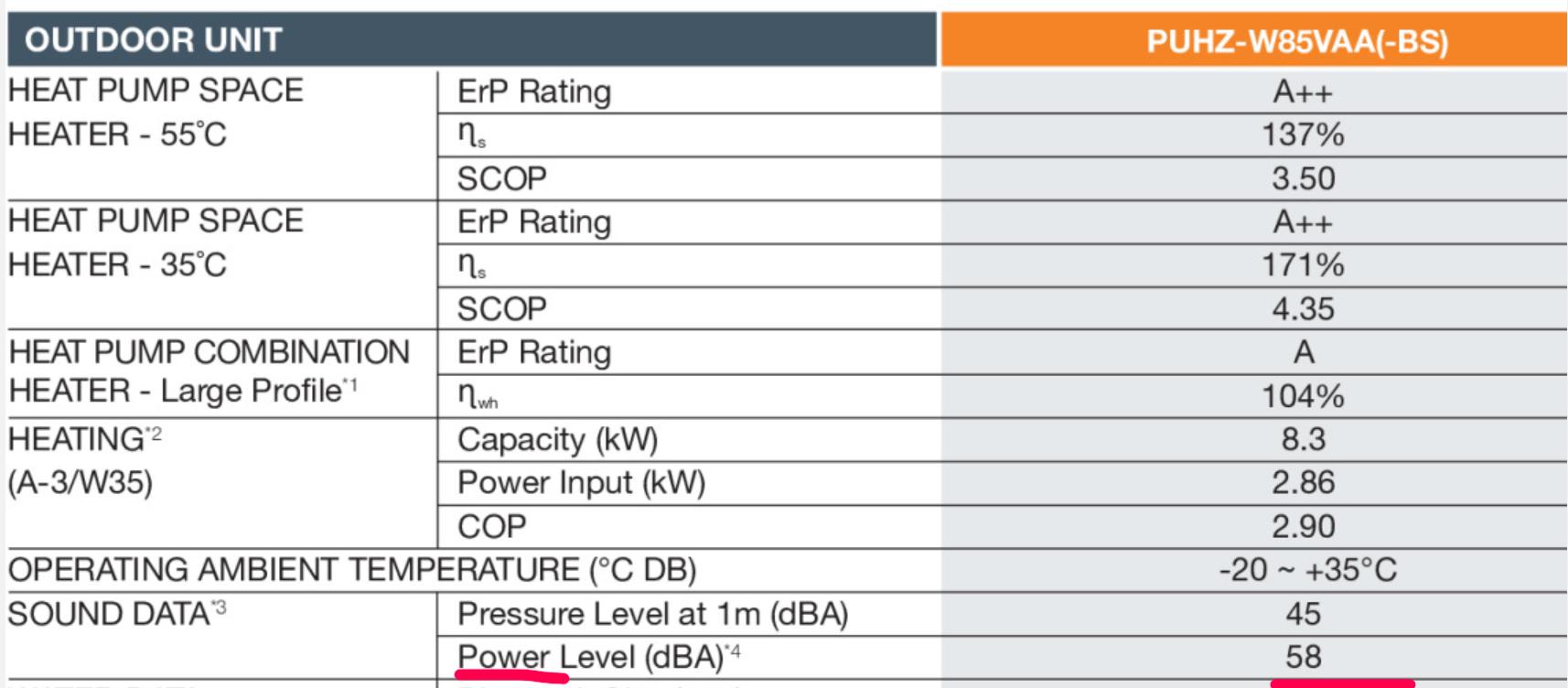

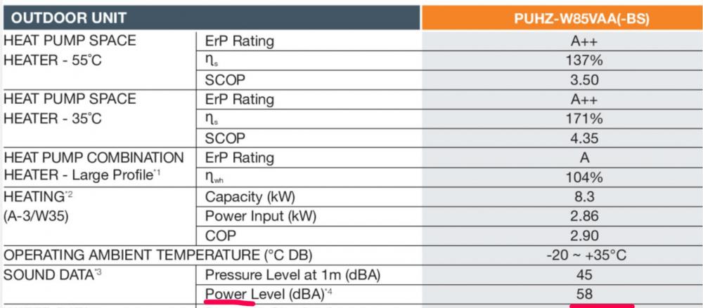

puntloos Posted July 31, 2021 Share Posted July 31, 2021 Have we collectively figured out what the quietest ASHP is (both external AND internal?) - @zoothorn had a bit of a nightmare but the topic to me sounded more like the cylinder and connected pumps were at fault, not the ASHP itself? My preference is indeed 'within regulations' (but if I place my ASHP in the place indicated it's going to be 7m away from the nearest window so even oldcrap jet engine ASHPs might fall below 43dB(regs) at 7m..) Clearly it has to be inverter-based, and ideally new-ish so it can be switched from heating to cooling through the control system not with 'manual dip switches' (which I think is EcoDan's case.. not the end of the world but eh.. still somewhat annoying) Link to comment Share on other sites More sharing options...
puntloos Posted July 31, 2021 Share Posted July 31, 2021 Just checking in and noting that the Mitshubishi marketing board is perhaps a bit more enthusiastic than Nibe's Nibe F2020: Ultraquietecodan: Link to comment Share on other sites More sharing options...
SteamyTea Posted July 31, 2021 Share Posted July 31, 2021 4 hours ago, Tony K said: Why would that be insufficient for UFH UFH runs at a higher temperature than ambient, and you can treat the ground as an infinite heat sink, with a mean heating season temperature of about 8°C. You also have a lot of floor area. Remember that U-Value is W/m2K, so a lot of area at a higher temperature means greater power going though it. So imagine a wall of 10 m2 and an inside air temperature of 20°C and an outside air temperature of 2°C, if the U-Value is 0.15 W/m2K, the losses will be 27W. Now imagine a 10m2 bit of floor, that is at 30°C and the ground is at 8°, with the same U-Value, the losses will be 33W. Link to comment Share on other sites More sharing options...
Gone West Posted July 31, 2021 Share Posted July 31, 2021 2 hours ago, puntloos said: Nibe F2020: IIRC that's the one my neighbours had and I couldn't hear it behind a 2m high solid fence and it was 2m the other side of the fence. Link to comment Share on other sites More sharing options...
puntloos Posted July 31, 2021 Share Posted July 31, 2021 (edited) 38 minutes ago, Gone West said: IIRC that's the one my neighbours had and I couldn't hear it behind a 2m high solid fence and it was 2m the other side of the fence. I also hear good things on Nibe's control system.. but.. it uses R410A rather than R32 so the carbon footprint is pretty large. For now I suppose it might be my frontrunner but the ecodan is a close second. But then I found the Daikin - seems to be the best of most worlds. R32. Quietest. Just... 10m max pipe.. (to be fair this is the only brand even mentioning pipe length) Given that I (plan to) have 3 phase I figured it would have benefits to use it for the ASHP.. but as far as I can tell the COP of the single-phase is actually better. Why would you ever want the 3phase one? @pocster - from your evil eye image, it looks like you have this one. Do you know if it's easy to reverse cooling? Any downsides I should be aware of? How quiet are the indoor/outdoor parts day to day? Hot water is limited to 35C? Edited July 31, 2021 by puntloos Link to comment Share on other sites More sharing options...
