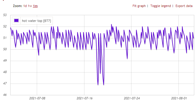

2 hours ago, IanR said:
I know you don't want to hear it, but an ASHP works perfectly for a family of 5, and as the tank temp seldom drops below 47°C, I'm turning mine down a bit to push the COP up further.
Please offer some data/figures to show how it doesn't work, rather than conjecture.
yes i can see a graph showing minimal hot water pull.
Really? you'll have to explain how you worked that out.
Your bias is making you jump to incorrect conclusions. What you are seeing is an ASHP reacting to DHW usage.
Ian, turn on the hot tap for  20 mins full bore and both you and I know the heat pump will have no chance on keeping up. More so in the winter when there is less heat in the air when its needed most.
Now that's not to say at all, that your system as used, could be an acceptable feature for your circumstance.
It is however a retrograde step when compared to limitless, paid for on demand proper hot water.
Not sure what "20 mins full bore" would prove or dis-prove. What matters is if the heating and DHW system is designed for the worst case use in the house it's installed in.
Unless our winter temps drop to -20°C for long periods, winter has no effect on the ability to produce hot water, just the efficiency it can do it at.
Ian, the 20 minutes was an example of how long it would take to exhaust your tank after which you have zero hot water.  I guess depending on your tank size, pipe diameter and flow this could be quicker or slower. The end result however being them same.
