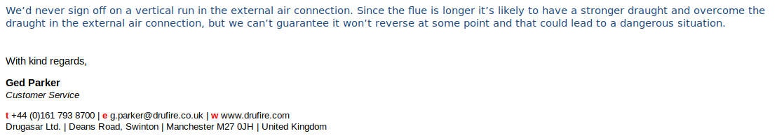

Adsibob Posted April 15, 2021 Share Posted April 15, 2021 So I've now heard back from Schiedel. The only option they can offer us for a standalone stove is to go for either a Sirius or a Sirius 3G. Both options described in the attached brochure. This is not really the look we had intended, though we are trying to see if it will work. The main issue is the stove is really quite high. But if it reviews well, we could probably be persuaded as it does solve a lot of issues for us, given how far our stove location is from an external wall to link up the direct air supply. @dpmiller I'm curious to know which stoves you opted for. It's a shame Schiedel don't sell their Permeter Smooth Air Chimney technology for use with any direct air supply stove. Does anyone know of a competitor who does? @Trw144 do you know? 940003846_Sirius_Stove_System_Brochure_16-12-20.pdf Link to comment Share on other sites More sharing options...
