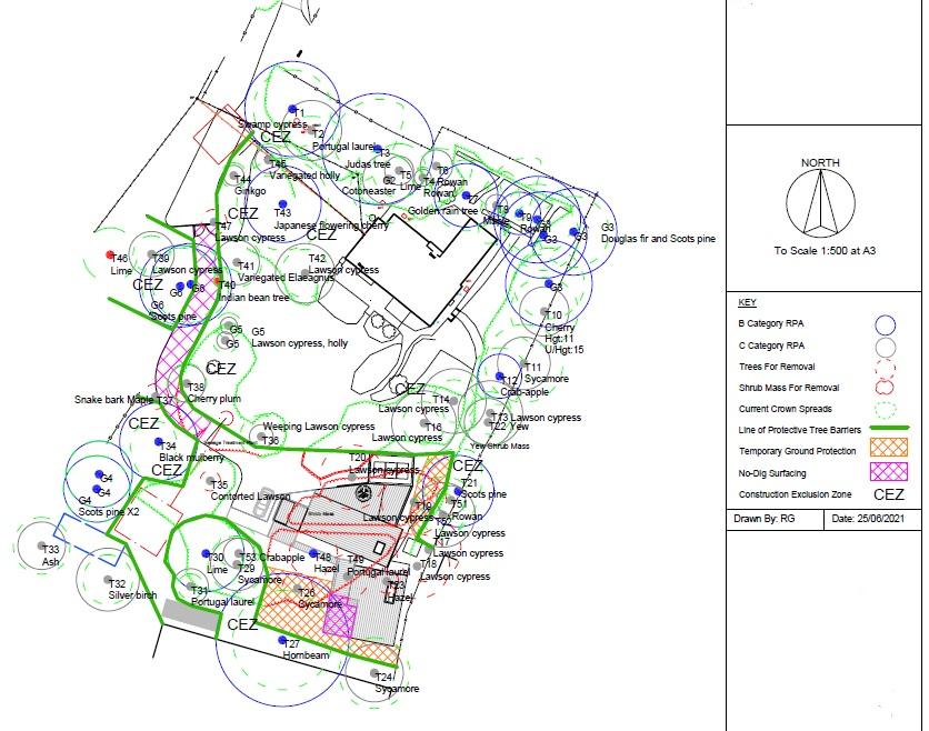

Mulberry View Posted July 16, 2021 Share Posted July 16, 2021 Our plot is quite complex and our scheme retains quite a few trees. We're just trying to get to grips with our Tree Protection Plan, it makes me regret working to hard to save trees to be honest, but it's part of what we love about the plot. By my calculations, we need upwards of 70 Heras panels, that's life I guess. The current conundrum is the access driveway, which is shown to require 'no-dig surfacing'. Anyone had similar requirements? What I don't understand is whether we need to be installing our long term driveway sub-structure now or if it's a temporary measure that's needed while we build. It seems to read as though we have to put a permanent geocell structure in place now and a 'sacrificial layer of stone' laid over another geotextile membrane while construction is taking place, to be scraped off at the end. Furthermore, the TPP states that no excavation can take place within the purple hatched area, so it looks like we are going to have to get creative regarding bringing the water main in. The only 2 options I can see are moling, or going across the garden for the existing bungalow, which I'm not that keen on. Talk about throwing us straight in at the deep end!! Link to comment Share on other sites More sharing options...

Haylingbilly Posted July 16, 2021 Share Posted July 16, 2021 on the plan the purple hatched area relates to a no dig drive - can you find a route for the water that will not disturb any routes that their tree office will accept? looks like there are some route options that you could explore and if you do need to touch a root protection zone make sure it is a c category tree... 1 Link to comment Share on other sites More sharing options...
Temp Posted July 16, 2021 Share Posted July 16, 2021 If you put any hardcore down go for mot type 3 rather than type 1. Type 3 is water permeable. My builder used type 1 and tree officer not happy. 1 Link to comment Share on other sites More sharing options...

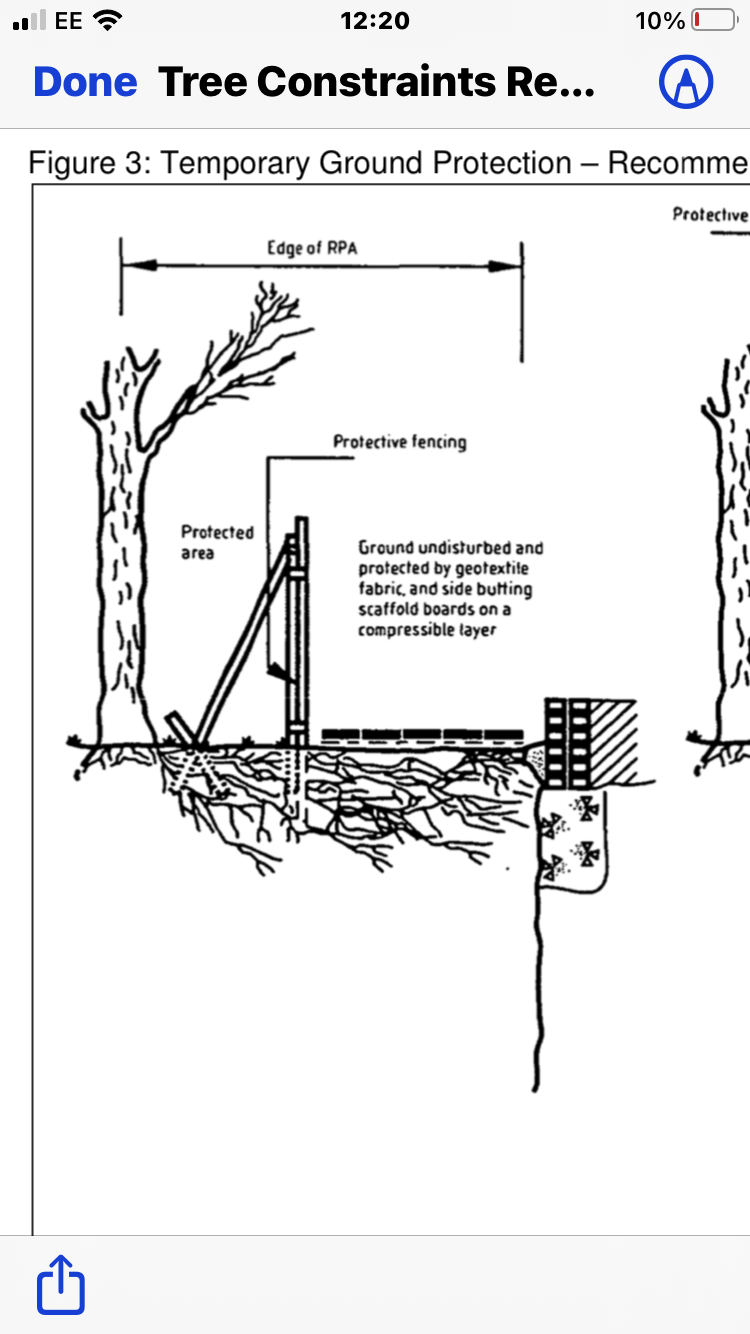

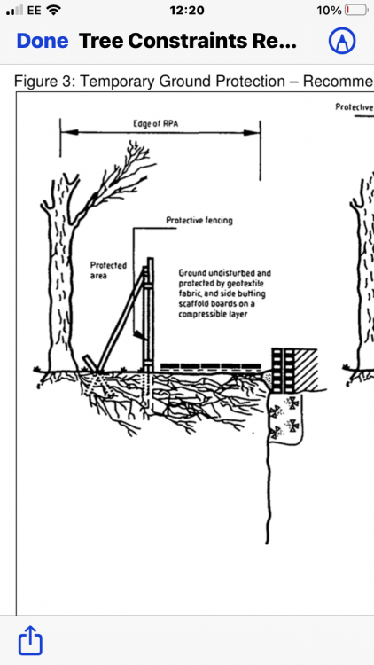

Temp Posted July 16, 2021 Share Posted July 16, 2021 (edited) 7 hours ago, Mulberry View said: The current conundrum is the access driveway, which is shown to require 'no-dig surfacing'. Anyone had similar requirements? What I don't understand is whether we need to be installing our long term driveway sub-structure now or if it's a temporary measure that's needed while we build. I was in a rush earlier.. We have clay soil and our builder put down a temporary "road" where the driveway was going and up the side of the house. Unfortunately he used MOT 1 (in our case dusty limestone) which set up like concrete. Worked great as hardcore and the base for tarmac or gravel but its not considered water permeable enough for use near trees. Hence type 3 recommended. I would consider putting some down in your turn around area to provide a temporary surface for unloading, parking etc Where you have no dig driveway there are systems for reinforcing grass/gravel in both plastic and concrete versions. https://terram.com/case-studies/geocell-no-dig-driveway-for-tree-root-protection-st-albans/ However not sure if either type will survive an hgv. I'm thinking Mot 3 for now then something like that on top later? Ideally discuss with tree officer although their suggestions can sometimes be impractical. Edited July 16, 2021 by Temp Link to comment Share on other sites More sharing options...

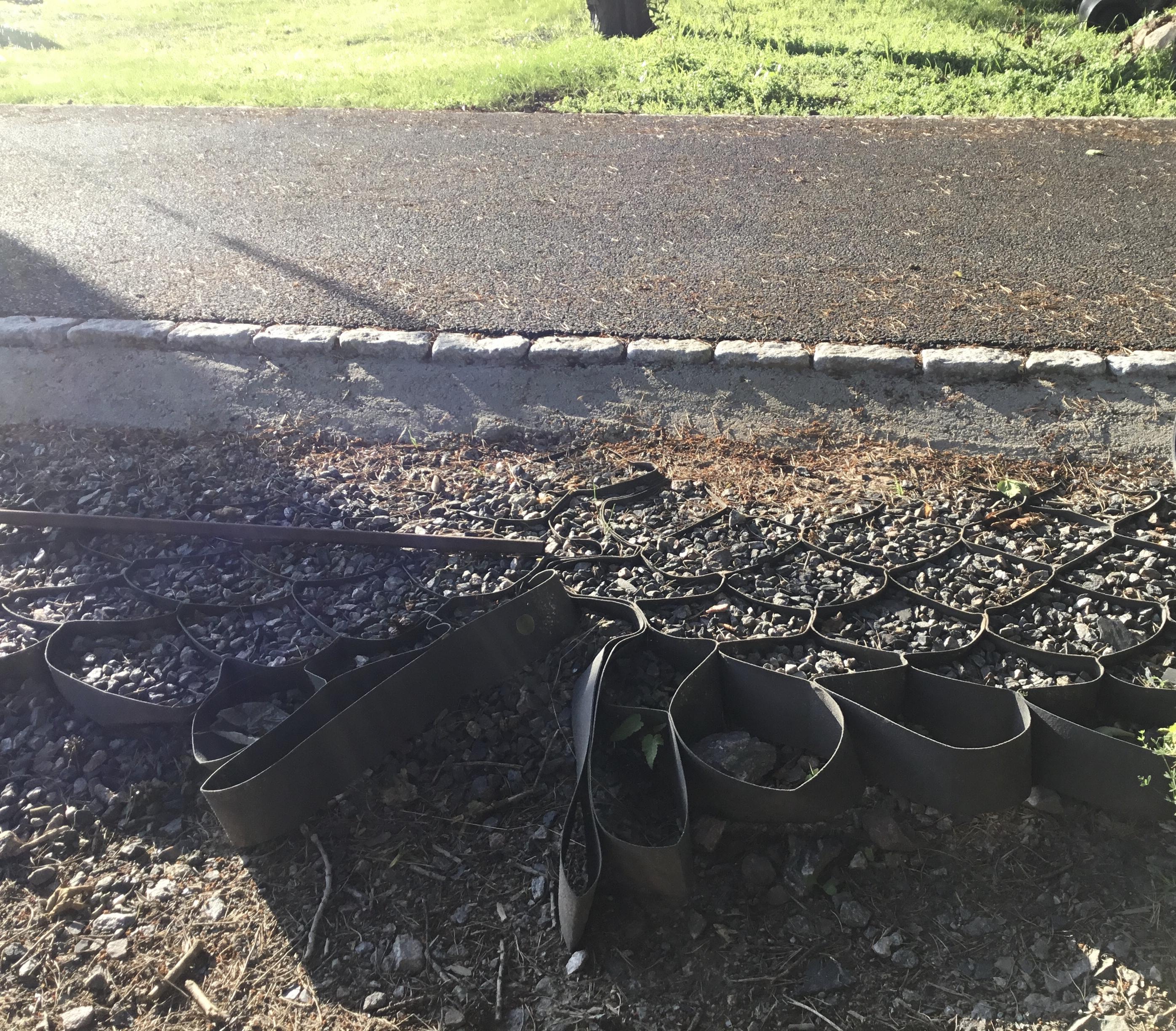

Bozza Posted July 16, 2021 Share Posted July 16, 2021 This is a no dig driveway, which we had to put in because our plot has loads of trees too. We’ve yet to backfill one side of it, which is handy as you can see what it entails. The tarmac is permeable. It meets the requirements for tree root protection, etc. Trees were a nightmare for our build, but we worked round that problem. Literally. 1 Link to comment Share on other sites More sharing options...
Ferdinand Posted July 16, 2021 Share Posted July 16, 2021 Not thorough enough. They left a gap in the middle ?. Link to comment Share on other sites More sharing options...
