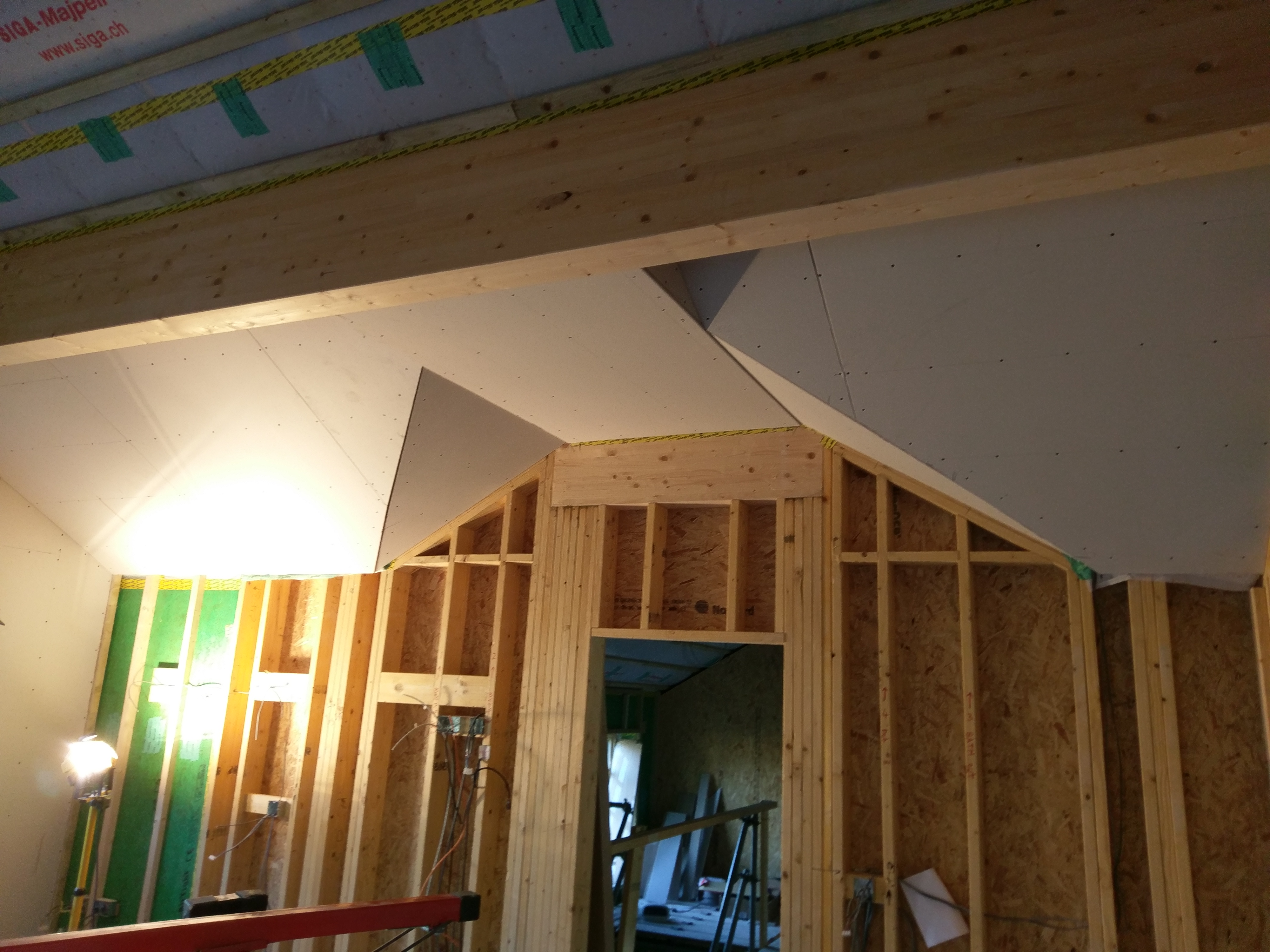

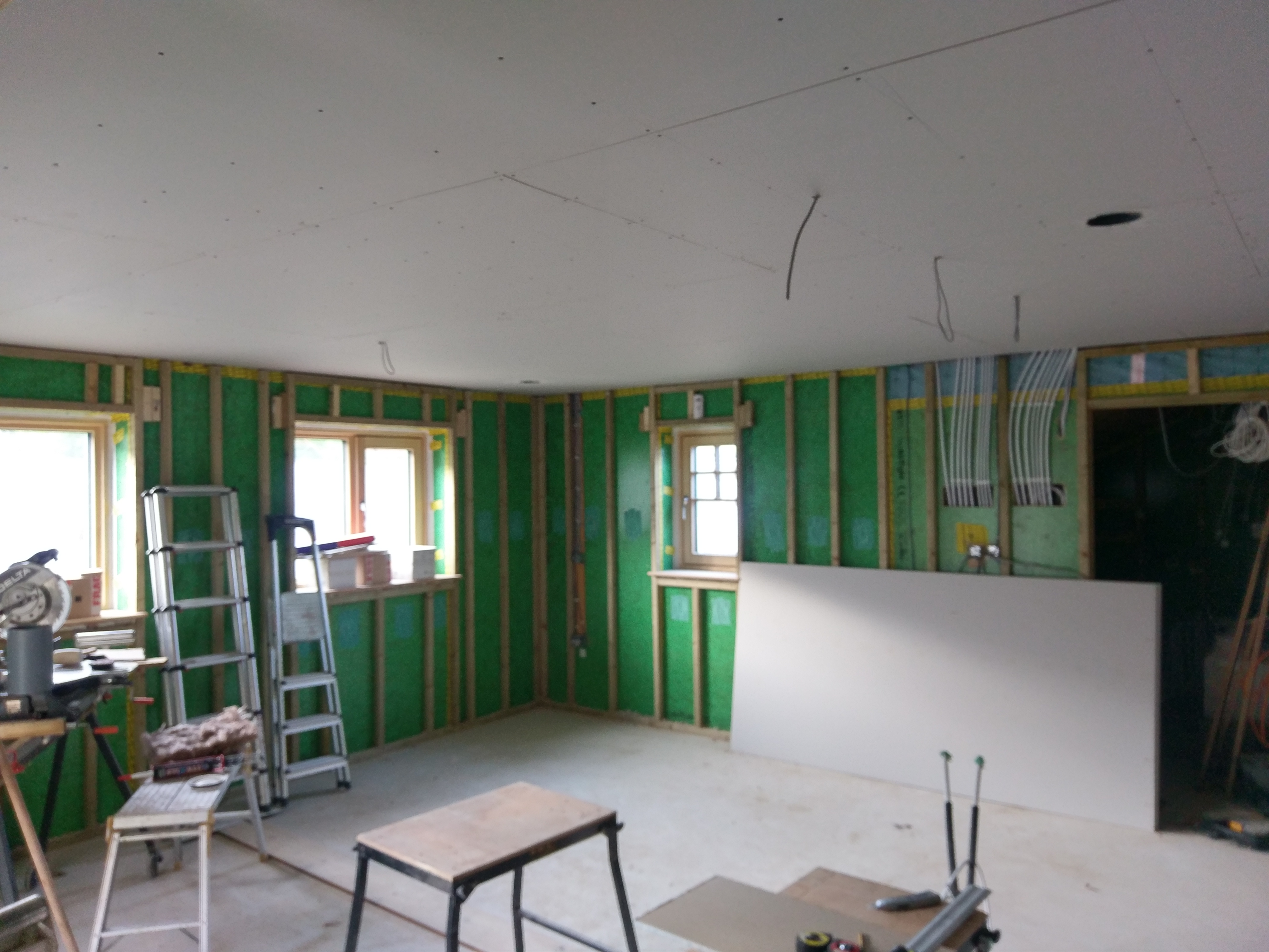

dogman Posted January 6, 2018 Author Posted January 6, 2018 I have been a bit busy over the last few weeks having finished first fix, plumbing and electrics. Plumbing went okay, although one of the AAV's had a small leak so the pressure test on the foul drain kept failing. Once replaced it held 50mm of water without problem. Had a major with the electrician who walked off the job at the end of first fix as he got a major contract for 10 houses. As we had no formal written contract we were stuck. As all the cables were in, none of the electricians would entertain the work other than as a final testing and inspection. After a bit of negotiation with the building control officer and we can go down that route. Upside is that i have saved a couple of quid as all i have paid for are materials so the final test will be the only labour charge. Plasterboard is about 60% completed and the plasterer is following us room to room. So far we have used 240 sheets including some sound and fire board. we have stuffed rock wool into all the walls and floors and will be pleased when finished as i hate the stuff. Its been a bit of a challenge to board the high points as the plasterboard lifter did not quite reach and i am still working out how to reach the roof of the galleried landing The next issue according to my wife is the colour of the sofa. not sue why when i still have to plumb the plant room 2 1

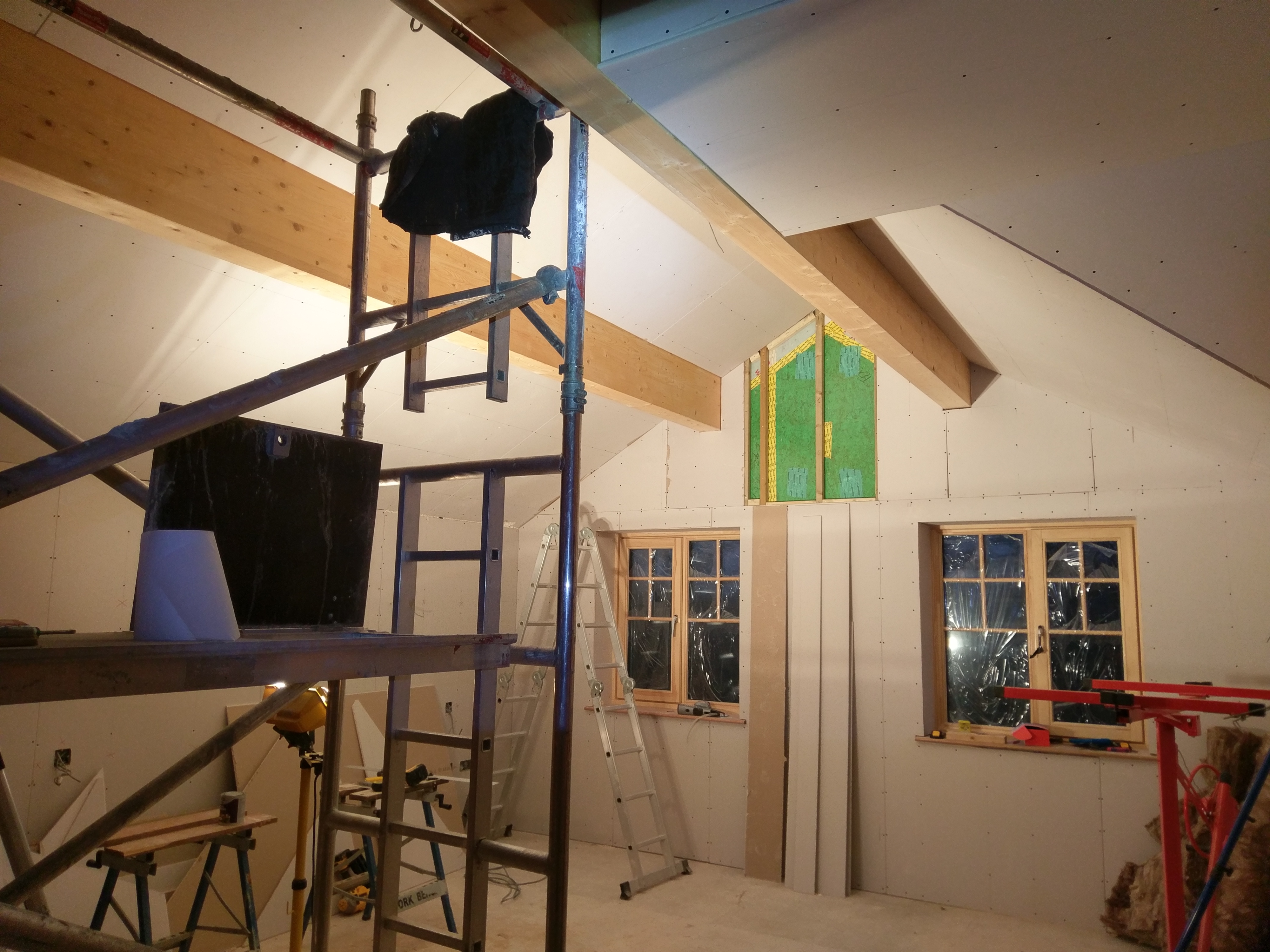

Barney12 Posted January 6, 2018 Posted January 6, 2018 The only choice we had for the high parts of the ceilings was two men on a tower and another on the ground to pass the boards up. It was a bloody faff but there was no other way.

Luckylad Posted January 6, 2018 Posted January 6, 2018 Boarding looks nice and neat, would be a pleasure to go over. Although I would double up the scrim on the small pieces on the gable
Moira Niedzwiecka Posted January 6, 2018 Posted January 6, 2018 Looking great. Some really interesting angles in the vaulted ceilings. We have the same. We weren't sure what it would look like until actually built. How wide is your service cavity between the airtight smartply & the plasterboard? Is this what you have stuffed with rockwool? What insulation is within your timber frame? I am really interested to know as I have been thinking of doing the same.
dogman Posted January 6, 2018 Author Posted January 6, 2018 Kitchen is from Howdens. Most is here but their design and invoicing details are an absolute mare. The brochure. invoice, plan and delivery notes all have different codes. All the bathrooms have been chosen including a bath covered in copper I have left it all to her other than a check to see if i can actually fit it. 2 hours ago, Moira Niedzwiecka said: How wide is your service cavity between the airtight smartply & the plasterboard? Is this what you have stuffed with rockwool? What insulation is within your timber frame? Roof is 25mm cavity, walls 48mm. theses are left clear its the internal studs and the floor void i have filled with rock wool. Its a real pain but helps stop a lot of the echo and resonance in the house. We went with cellulose blown insulation
dogman Posted January 6, 2018 Author Posted January 6, 2018 6 hours ago, Luckylad said: Boarding looks nice and neat, would be a pleasure to go over. Although I would double up the scrim on the small pieces on the gable Plasterers said the same and have so far done a really nice job( oher than one dropping a float full of bonding on the others head it went everywhere and needs to be cleaned off)
ProDave Posted January 6, 2018 Posted January 6, 2018 Why do you need a coat of bonding on plasterboard? Ours is skimmed with a single coat of multi finish.
Luckylad Posted January 6, 2018 Posted January 6, 2018 Some people use bonding to round out the ceiling or simply just for dubbing out . i just use multi finish for both the above to save throwing any away. im not a fan of bonding because it can take a long time to dry and can bubble, requiring it to be scraped when hard
