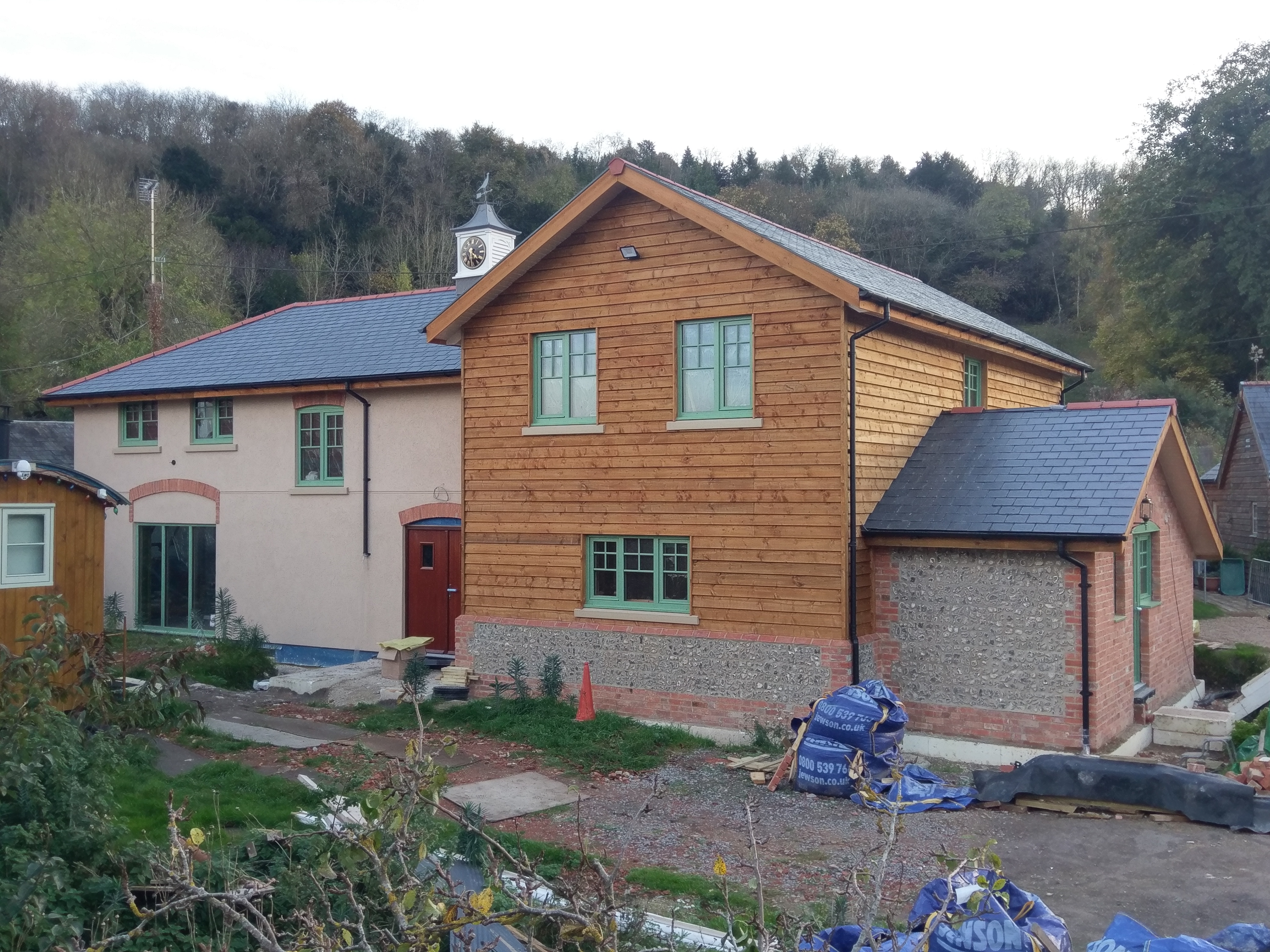

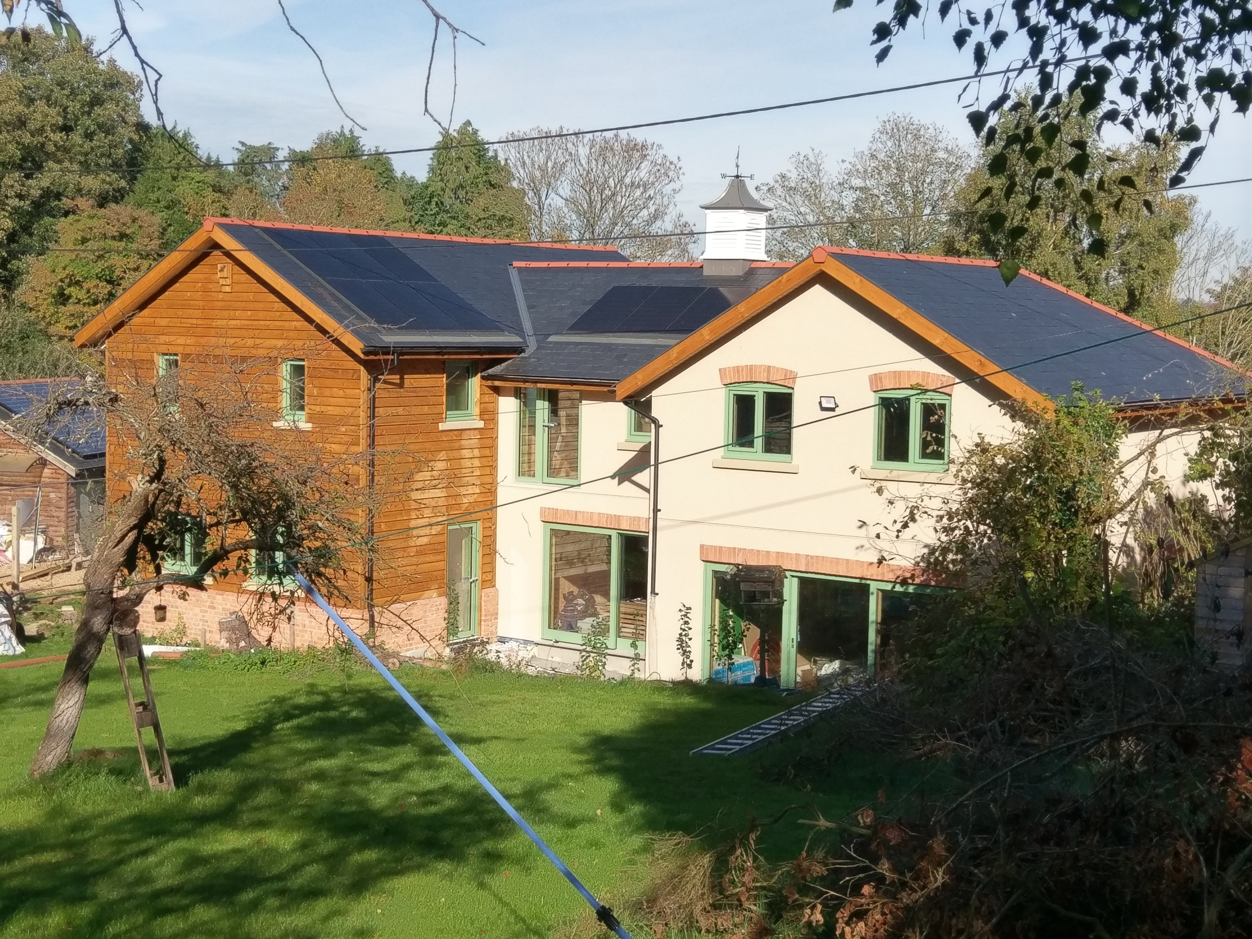

dogman Posted October 30, 2017 Author Posted October 30, 2017 Scaffold down at long last. still need to have the oak porch and oak balcony fitted 5
Declan52 Posted October 30, 2017 Posted October 30, 2017 Very nice looking indeed with the mixture of materials but for me the one really outstanding feature is the wind vane/ clock housing on the roof. Never seen that on a house before. Really catches your eye on both pictures.
jamiehamy Posted October 30, 2017 Posted October 30, 2017 Wow, incredible! Really stunning and very different. You must be chuffed!
dogman Posted October 30, 2017 Author Posted October 30, 2017 It was quite a day as it appeared out of the scaffold. 57 minutes ago, Declan52 said: Very nice looking indeed with the mixture of materials but for me the one really outstanding feature is the wind vane/ clock housing on the roof. Never seen that on a house before. Really catches your eye on both pictures. The property that was removed was an old coach house and stable block. We have tried to reflect this is the design. There is a pair of large fake oak doors being fitted the the front window to look like the old carriage entrance.
Oz07 Posted October 30, 2017 Posted October 30, 2017 2 hours ago, Declan52 said: Very nice looking indeed with the mixture of materials but for me the one really outstanding feature is the wind vane/ clock housing on the roof. Never seen that on a house before. Really catches your eye on both pictures. Didn't notice till you said! Small pictures on these phones! nice looking drum!
Tennentslager Posted October 30, 2017 Posted October 30, 2017 Super tidy...lots of 'face' type aspects which I like. Brick curved lintels look like eyebrows and the rooflines are nicely juxtaposed. Very nice.
Weebles Posted October 31, 2017 Posted October 31, 2017 Looks fantastic - what a transformation in only a few months.

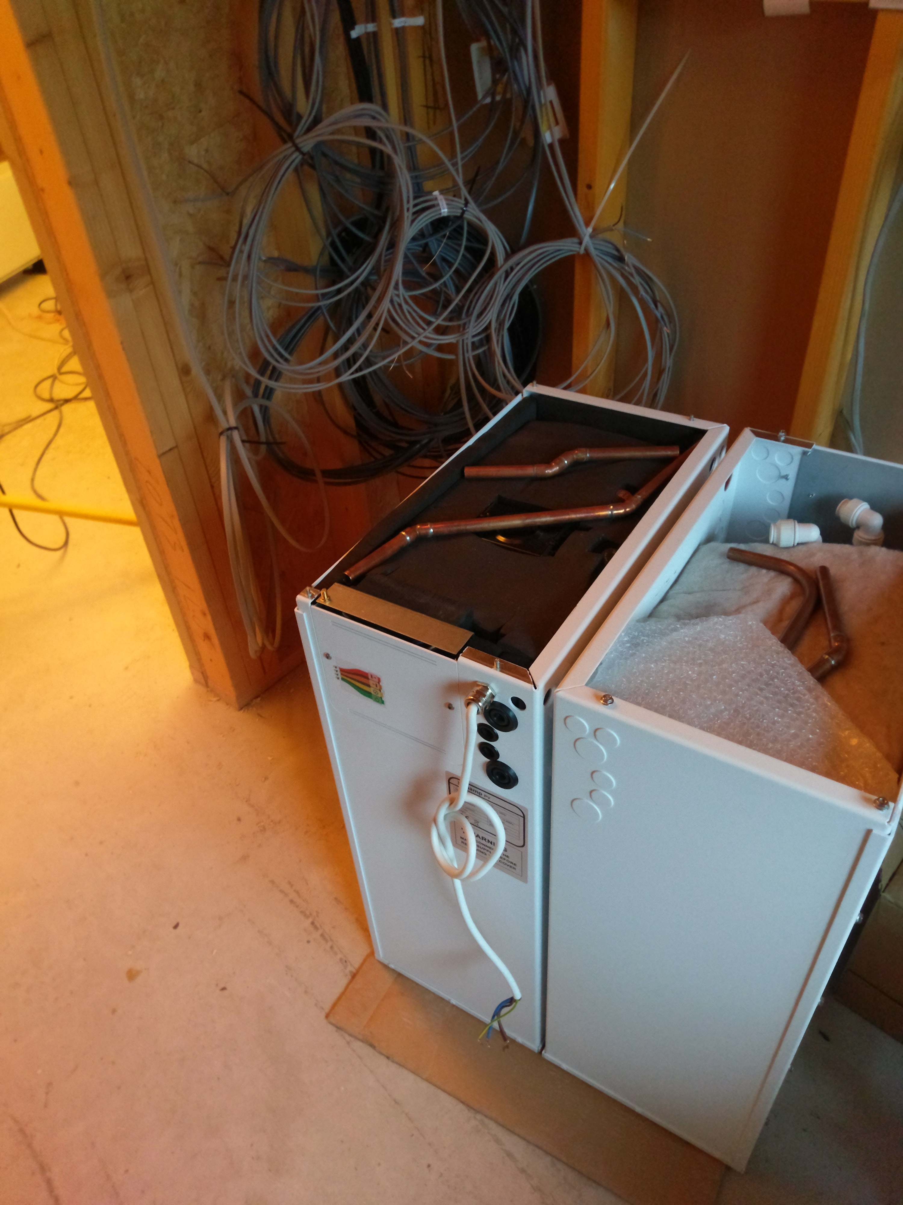

dogman Posted November 7, 2017 Author Posted November 7, 2017 First fix started and i will say its going well. My SunAmps arrived today. Need day off to rest, they weigh a tonne. well 170kg actually Shown with tops off 1

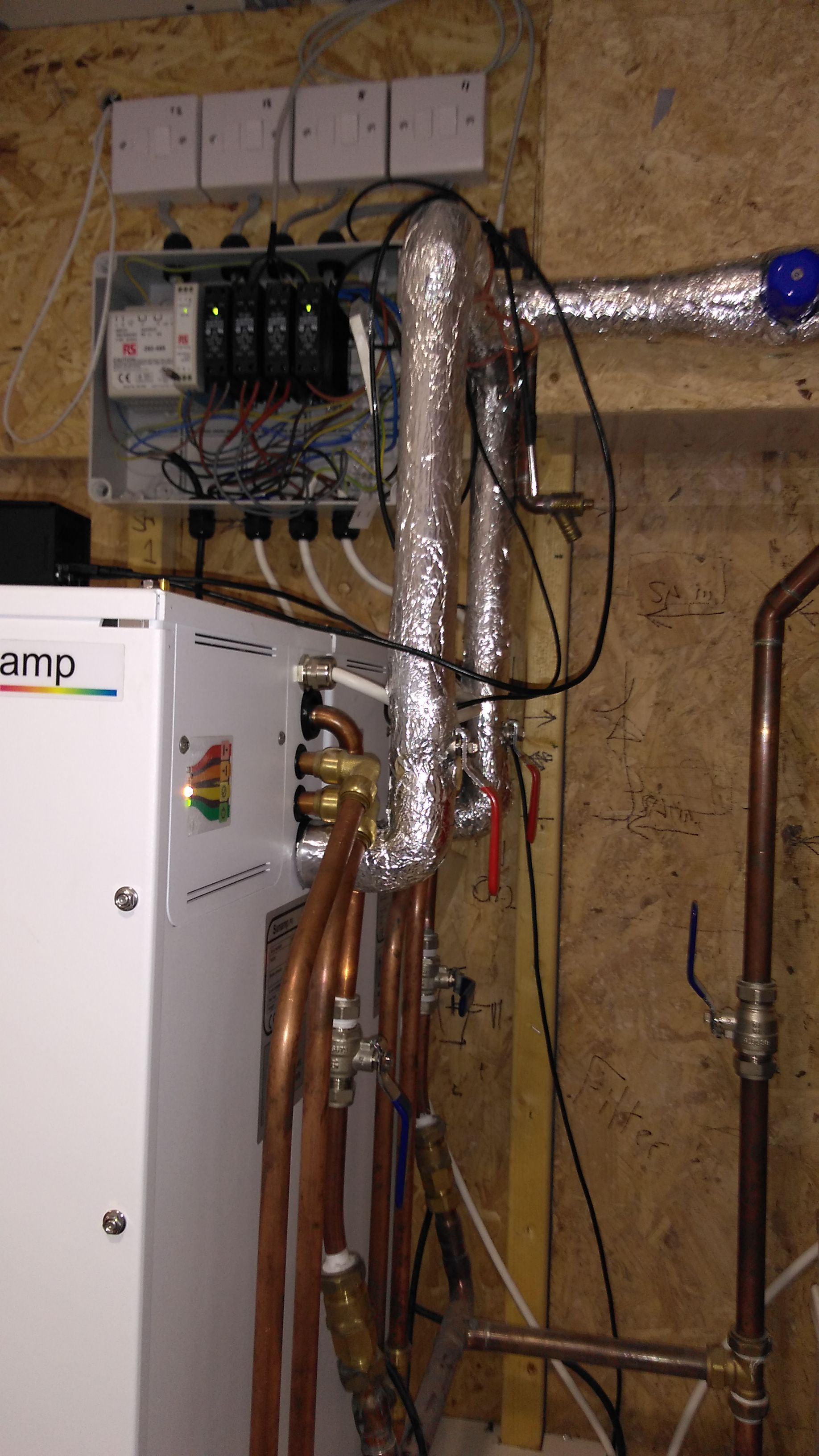

TerryE Posted November 8, 2017 Posted November 8, 2017 Here's mine. The relay box is open at the mo, and the thermo cables need tidying. But the 4 SSDs cost about the same as the rest of the computers and electronics. As I said, I am overdue writing up my system, but the heating and DHW is run by a battery backed RPi3 and 2 ESP8266 FEPs handling 4 relays, 14 thermostats, 2 flow meters, 1 pressure transducer and 1 PWM fan. The HA is handled by another RPi3 with HDD running Node Red.
dogman Posted November 8, 2017 Author Posted November 8, 2017 @TerryEYou obviously got two independent units. Ours is one plus an expansion
TerryE Posted November 9, 2017 Posted November 9, 2017 18 hours ago, dogman said: @TerryEYou obviously got two independent units. Ours is one plus an expansion Yup, but they didn't sell the expansion module when I bought mine. I also like the redundancy, anyway.
Nickfromwales Posted November 9, 2017 Posted November 9, 2017 4 hours ago, TerryE said: Yup, but they didn't sell the expansion module when I bought mine. I also like the redundancy, anyway. And twice the DHW flow rate if the cold mains will allow it. .

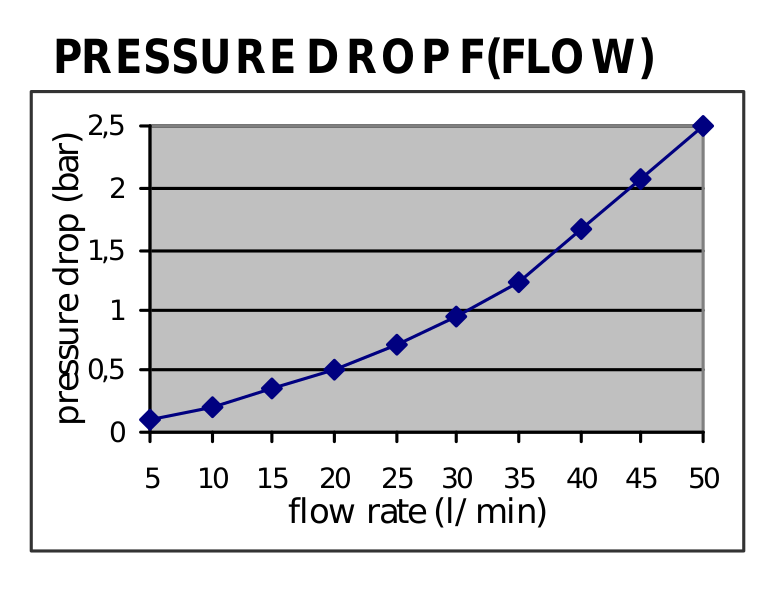

TerryE Posted November 9, 2017 Posted November 9, 2017 4 hours ago, Nickfromwales said: And twice the DHW flow rate if the cold mains will allow it. . Yes, paralleling up the SunAmps has a lot of advantages, though at the moment (before moving in) I only have one on at a time. But the biggest throttle on my flow rate is my water softener which drops the pressure almost 1 bar if we have two high flow taps (e.g. two showers) on the go together. Our mains is pretty steady at 3.2 bar, so one of the possible "to do" items is to add a PRedV in parallel across the Harvey, set at 2.4 bar say, which will allow water to bypass the Harvey in these rare high-demand cases so we might end up with a 50:50 hard/soft mix, very occasionally. Yes this will allow some hard water into the system, but given that under normal circumstances the PReV won't cut in and the system will be being flushed with softened water, this shouldn't be a problem. But that is better than no being able to have two decent showers going when the occasion demands. But I am waiting to do full load commissioning tests before considering this any further. 1
jack Posted November 9, 2017 Posted November 9, 2017 3 hours ago, TerryE said: Yes this will allow some hard water into the system, but given that under normal circumstances the PReV won't cut in and the system will be being flushed with softened water, this shouldn't be a problem. But that is better than no being able to have two decent showers going when the occasion demands. But I am waiting to do full load commissioning tests before considering this any further. I spent far too much time reading about water softeners before we chose one, and I definitely recall saying that occasional use of hard water (eg, if your softener temporarily runs out of salt) make no difference at all. Indeed, installing a softener will allegedly slowly break down existing deposits over time. Harveys make a big deal about their twin tank system ensuring that softened water is always supplied, but I don't think it's that big a deal. Re: the pressure drop, what size flex connectors did they supply? Mine was supposed to come with 22mm "full bore" connectors. The flex connectors supplied each had a 10-11mm diameter restriction at each end. I rang the supplier and told them that they'd supplied me with the connectors for the smaller kit. They sent new ones, but of course, it turns out that's what they actually supply. My plumber was frankly a bit of a dick about it, and tried to say that he'd been put in an awkward position with his supplier, but didn't have much to say when I asked him whether 11mm seemed like "22mm full bore" to him. In the end, we binned the flex connectors and connected it with Hep2O instead. 1
Jeremy Harris Posted November 9, 2017 Posted November 9, 2017 I binned the pipes that came with our softener, too, for the same reason. I found some 19mm bore flexis that fitted, and 19mm is around the bore of 22mm pipe, so they are effectively full bore. Quite why Harvey sell these with such small bore pipes as standard is a bit of a mystery.
jack Posted November 9, 2017 Posted November 9, 2017 7 minutes ago, JSHarris said: Quite why Harvey sell these with such small bore pipes as standard is a bit of a mystery. I know, it's mental. 11mm internal diameter is less than a third of the internal area of 22mm pipework. I don't know what the practical impact on flow rate and pressure would have been, but best case it would likely have been noisy.
TerryE Posted November 10, 2017 Posted November 10, 2017 I think that this comment has been raised before, but I bought proper 22mm flexible couplers for mine. But the main issue is the internal ion exchange unit inside comes at a pressure drop cost, particularly as the flow ramps up. I came across this in one of the Harvey data sheets: At a nominal aggregate 35 l/min with this and the DoubleCV, SunAmps, TMV, etc., I suspect that the flow will pretty marginal for showers and the 2nn floor. But TBH, I've still to do his test.
