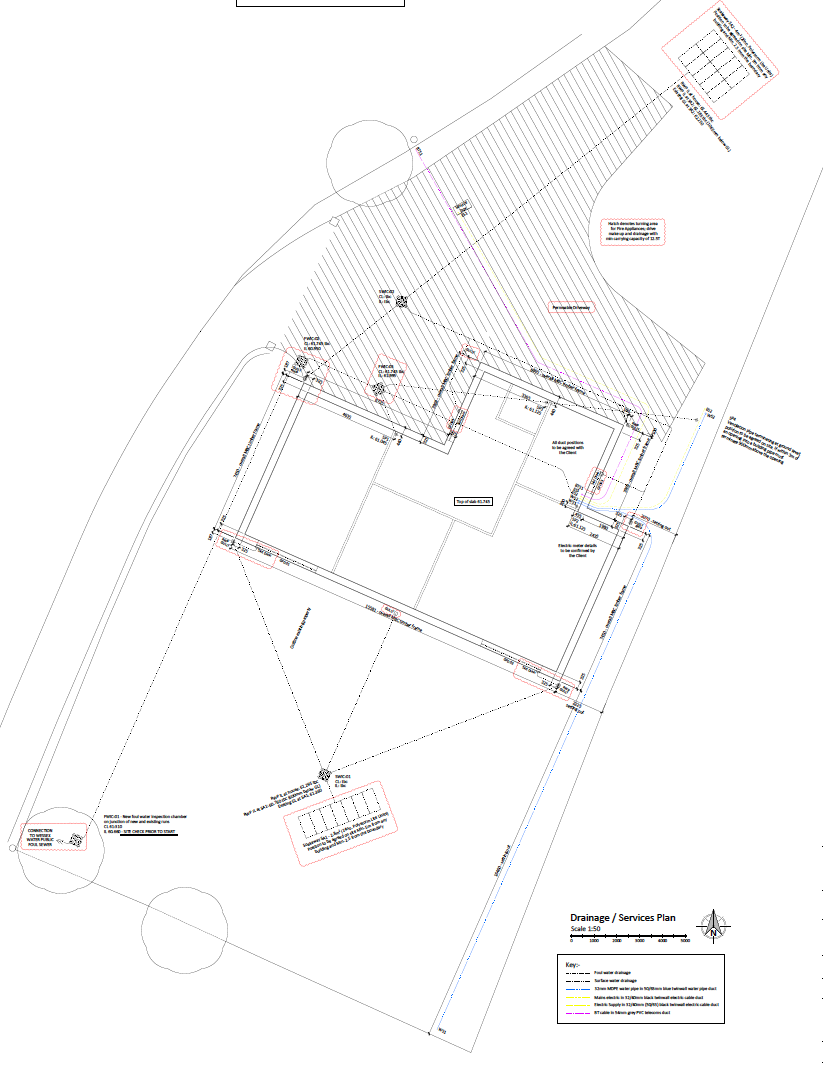

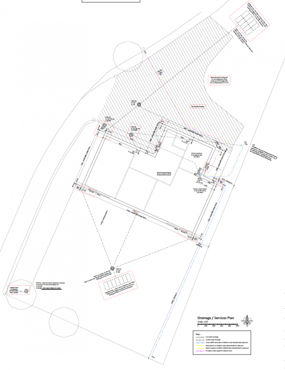

Russdl Posted February 18, 2019 Share Posted February 18, 2019 Just reviving this thread as it's sort of relevant for us. We are going to have a turning circle for the fire brigade on our plot (wether we like it or not) and the hatched area on the drawing below is what has been accepted by BCO. It will of course be very useful in permitting lorries to turn around during our build as the the narrow access track will preclude lorries turning anywhere else or reversing out. My plan at the moment is: 1. Put down a sub base that will take the construction traffic. 2. Once major construction is finished, dig up what is required in order to lay the drains. 3. Top up with 150mm Type 1. 4. Finish off the drive with 40mm of gravel in a stabilisation grid. What have I missed? Also: a) Any problems with my plan/order of doing things? b) How deep should I make the sub base for the construction traffic (were are on chalk after digging down a wee bit)? c) On the drawing it says that the driveway should have a minimum carrying capacity of 12.5 tonnes, how do I know if I've achieved that? Link to comment Share on other sites More sharing options...
Ferdinand Posted February 19, 2019 Share Posted February 19, 2019 (edited) Not sure if relevant, however if you did your drains first you could plumb your welfare hut in temporarily and save on weekly suck-out for the loo. Would also reduce traffic. Edited February 19, 2019 by Ferdinand Link to comment Share on other sites More sharing options...
