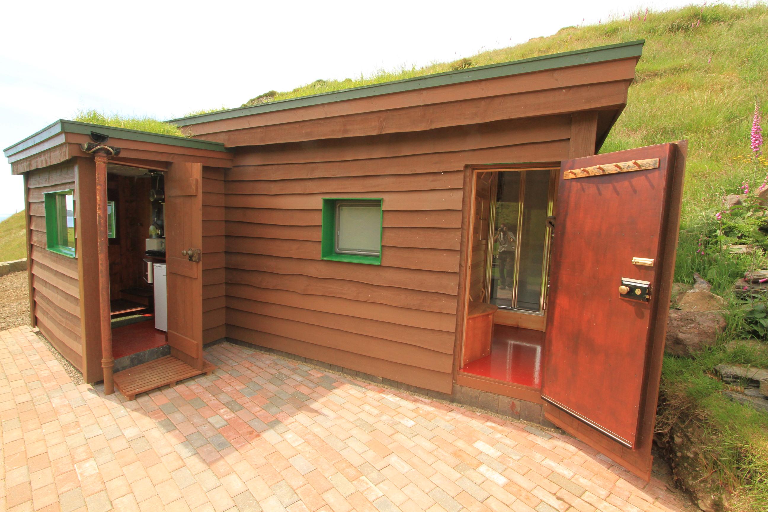

Cpd Posted March 27, 2021 Posted March 27, 2021 8 minutes ago, eandg said: is that a wider issue with larch experienced by others or perhaps some defective supply? I clad my cabin with Scottish grown larch 7 years ago, I paint it every few years to keep it looking smart with Cuprinol and the larch is as good as the day it went on, there is absolutely no movement that would be cause for concern and no distortion at all, I really could not be happier and it’s definitely my go to material for exterior use. I used minimal fixings - single row of ss ring shank nails along the centre of each board and ss screws in window work etc. I did all the work myself and was very carful with grading the timber and making sure that the overlaps were sitting down really snug on the board below it, using a draw knife to shave off protruding edges. The painting could be an issue for a bigger property but then you would just use a much better quality paint rather than the budget Cuprinol ducks back that I used for £10 for 5 litres. 1
