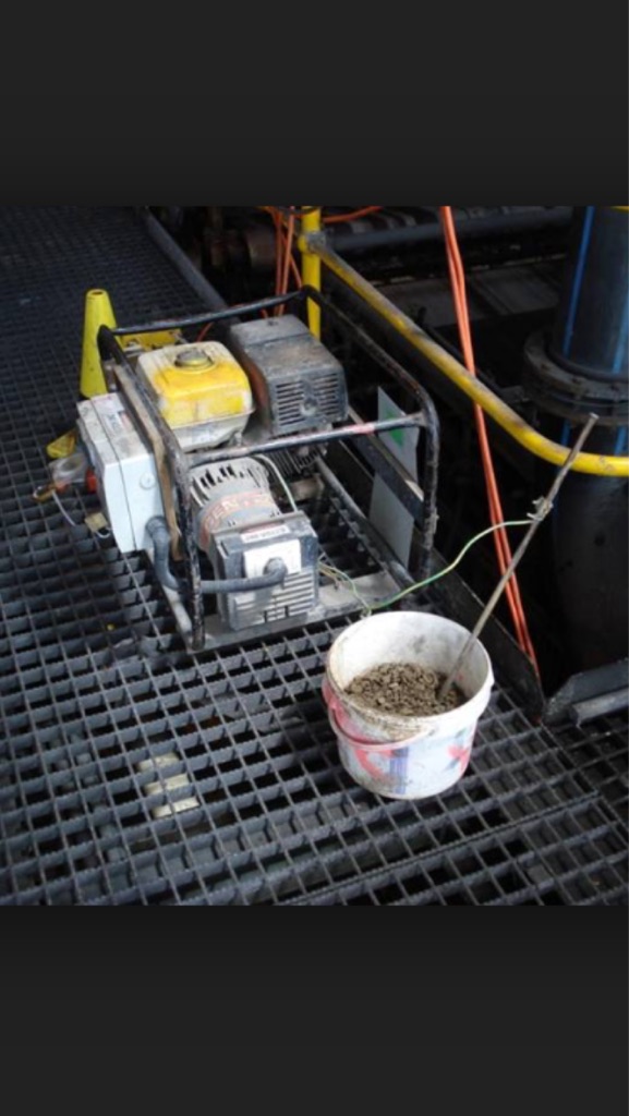

Steptoe Posted February 16, 2017 Share Posted February 16, 2017 The biggest problem with having a Genny for back up is how do you separate the earthing systems , and how are you going to earth the Genny to the house, you can't use the DNO earth with a Genny, 2 totally different system types. Needs very careful consideration. Link to comment Share on other sites More sharing options...
Onoff Posted February 16, 2017 Share Posted February 16, 2017 (edited) I'm TT! This never gets old: Edited February 16, 2017 by Onoff Same photo twice 1 Link to comment Share on other sites More sharing options...

ProDave Posted February 17, 2017 Share Posted February 17, 2017 9 hours ago, Onoff said: I'm TT! 9 hours ago, Onoff said: This never gets old: Ah the old "portable earth" A classic case of having a very slight idea of what you should do, but without understanding how it might work, and how that one definitely won't. But seriously, if your DNO can provide a genny that can power your whole house free of charge, and installed the same day, I would not bother.If yours is an isolated failure (i.e your neighbours still have power) then it's probably a cable fault. the only times we get a power cut is during a storm when trees come down (all overhead here) and then the outages are measured in thousands of homes (then there's not enough DNO generators to go round) the longest we were off was 3 days, and we just kept the WBS goiong 24/7 for heat, cooked on gas, and used the camping gaz lights. Frankly I would not want a generator thundering away and having to keep re fueling it for several days. Link to comment Share on other sites More sharing options...
