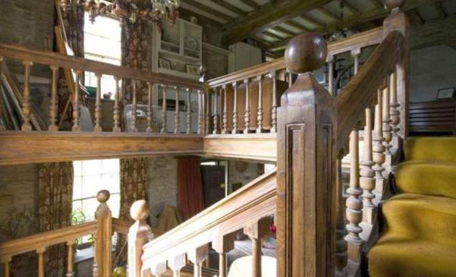

I lived with the one below for several decades. It is a magnificent bruiser of a thing - Jacobean oak and pine with a gallery but sooooo comfortable. The shallow angle allowed my parents to keep going upstairs comfortably for a few extra years. Originally it had about 28 layers of paint from the Victorians onwards and we had two slaves architectural students who spent a whole summer restoring it.
There were 18 steps between floors, which were a little shallower than usual and I think the angle was under 35 degrees. Suggest go for roughly that.
And a generous half landing with a window seat, or space for a resting chair, is good :-). But that is more difficult in a modern setting.
