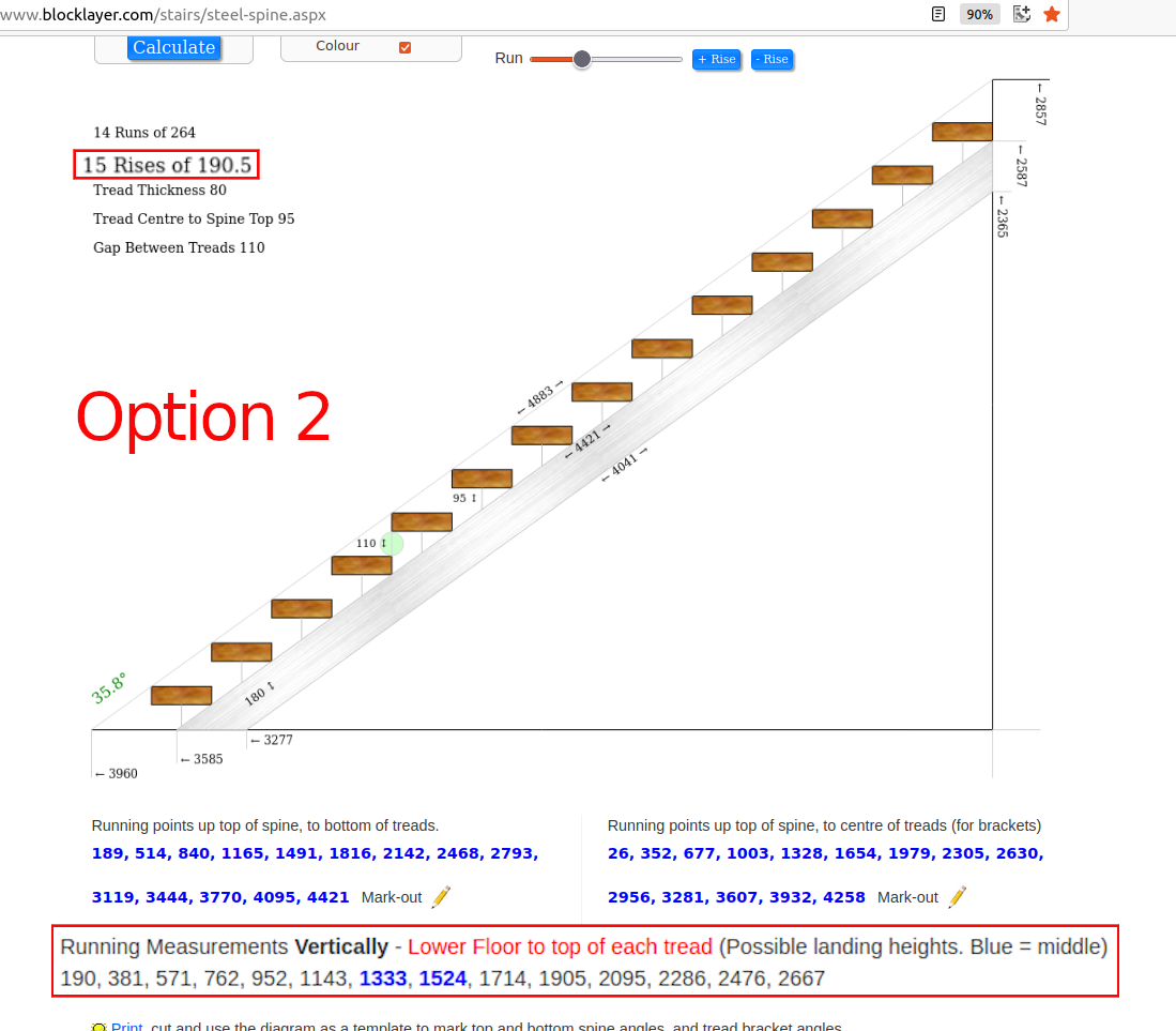

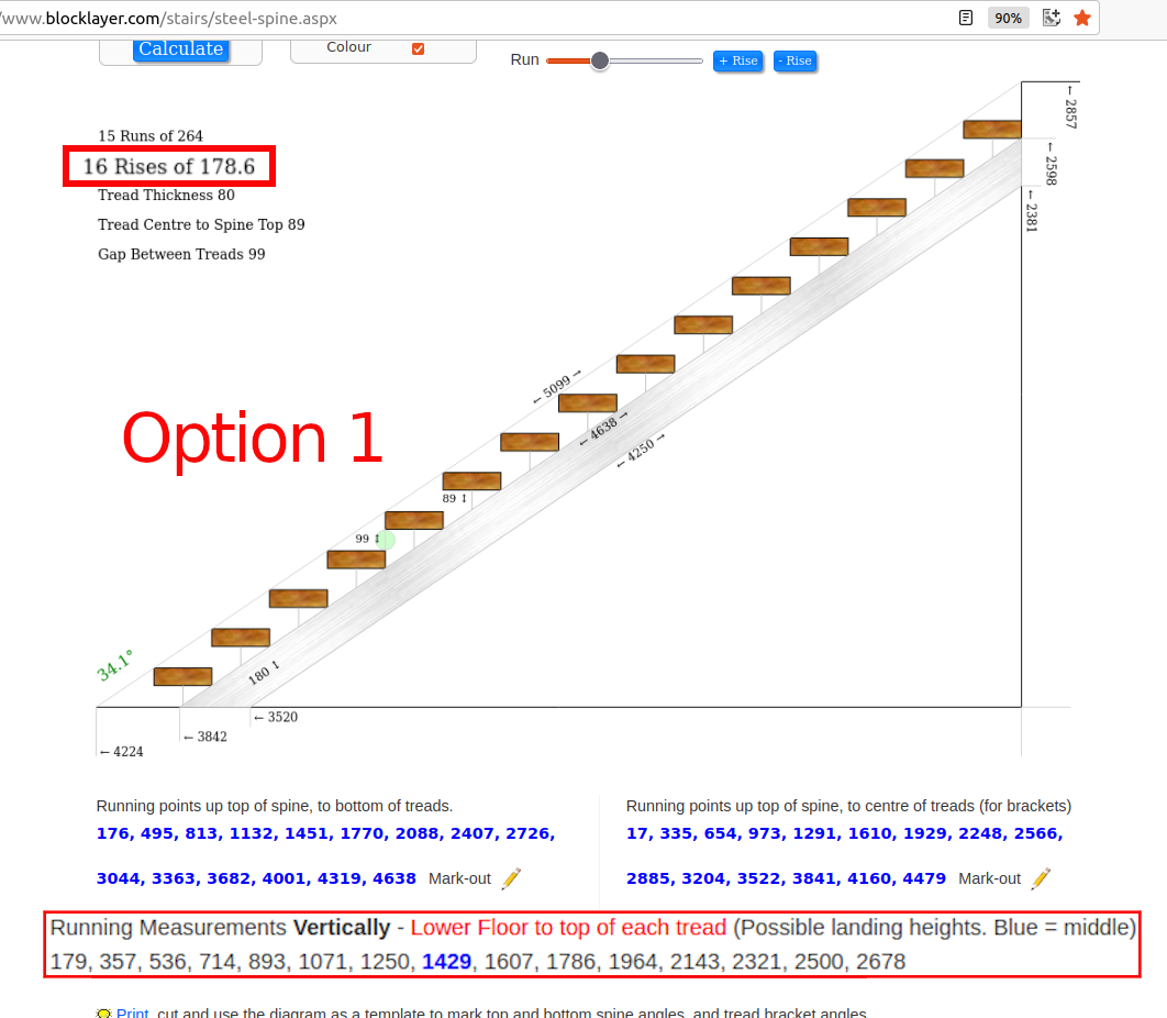

I used https://www.blocklayer.com/stairs/steel-spine.aspx to calculate it advised to do some rises at 178mm and some at 179mm, this gives me 34.1 degrees, I am not sure but it feels a little horizontal to me am i right? the other option i get is 1 step less and rises varying between 190 & 191mm resulting in 35.8 degrees, i think the degree here is fine but i think 190mm is a little on the steep side, no? my current stairs are 184mm rise by 260mm going and are pretty comfortable, after works the total height will be 27mm higher then now, I don't mind adding another stair for comfort but going from 184mm to 190mm rise seems i will loose the comfort, please advise if you think I am wrong.
I wont make the staircase wider then 900mm as my hallway is 2500mm wide and do not want to take away to much from the width. my current stairs are 840mm and I had no problem taking up furniture.

if 36 degrees is shallow what am i doing wrong here? according to what i found in the forums 264mm going is not much and 178mm rise is not very shallow, i am confused
the calculator does give me a .6mm (178.6mm) for each rise but it then lists the height each step should be along the run and in that lists there are no partial mm and if calculated some are 178 and some 179.
with regards to the tolerances you are right I might have some play there.
the 900mm is the tread, i get the point.
here are the 2 options from the calculator, i highlighted the relevant in red

I measured my current one again, its old carpet and a toddle loose so its not possible to get accurate measurements, however the stairs vary between 260-264mm (inc nosing) going and 182-188mm rise, (bottom and 1st step from qt landing are 193mm) the big difference between this and the one i plan to build is the current one is carpeted therefore i think its a soft landing whereas the new one will be wood, I am not sure if this makes a difference and if i should therefore lower each a few mm?
The top stair is 190mm, no 1 has ever tripped (since i replaced the carpet on the landing (increasing the height) ~9 months ago) maybe because there is a visual difference (see image)
the other issue i found is when measuring at first I did not really pay attention to the nosing as the carpet on the rise looked like its only a few mm in from the top small enough to be ignored, however now that i measured nosing to nosing i found that my nosing is around 22mm giving me an actual going of 242mm vs what i thought before to be 264mm.
according to the calculator if i were to use the nose to nose measurement at 242mm and rise at 189.5 it will result and a 38.1 degree, i cannot use the same for the new steps as total rise will be slightly more, to achieve 38.1 degrees I can use 244 going (no nosing) and 191.1 rise (R*2+G=626.2) th4 going will be very close to the current only the rise will be more, not sure if going with a rise of 191.1mm will be comfortable.
