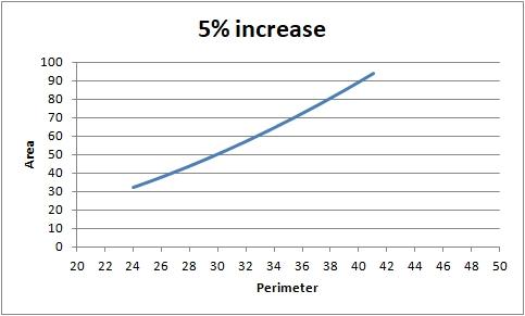

SteamyTea Posted February 25, 2021 Share Posted February 25, 2021 (edited) 38 minutes ago, ToughButterCup said: Because it takes effort to do that. Not really. Estate agents measure internally. Not a big ask for them to add some of the dimensions together. As an aside, I thought I would plot the ratio of perimeter to area when increase the perimeter size by 5%. The basic shape is a rectangle with depth twice that of width. This makes the m2 price cheaper for large houses. Edited February 25, 2021 by SteamyTea Link to comment Share on other sites More sharing options...
