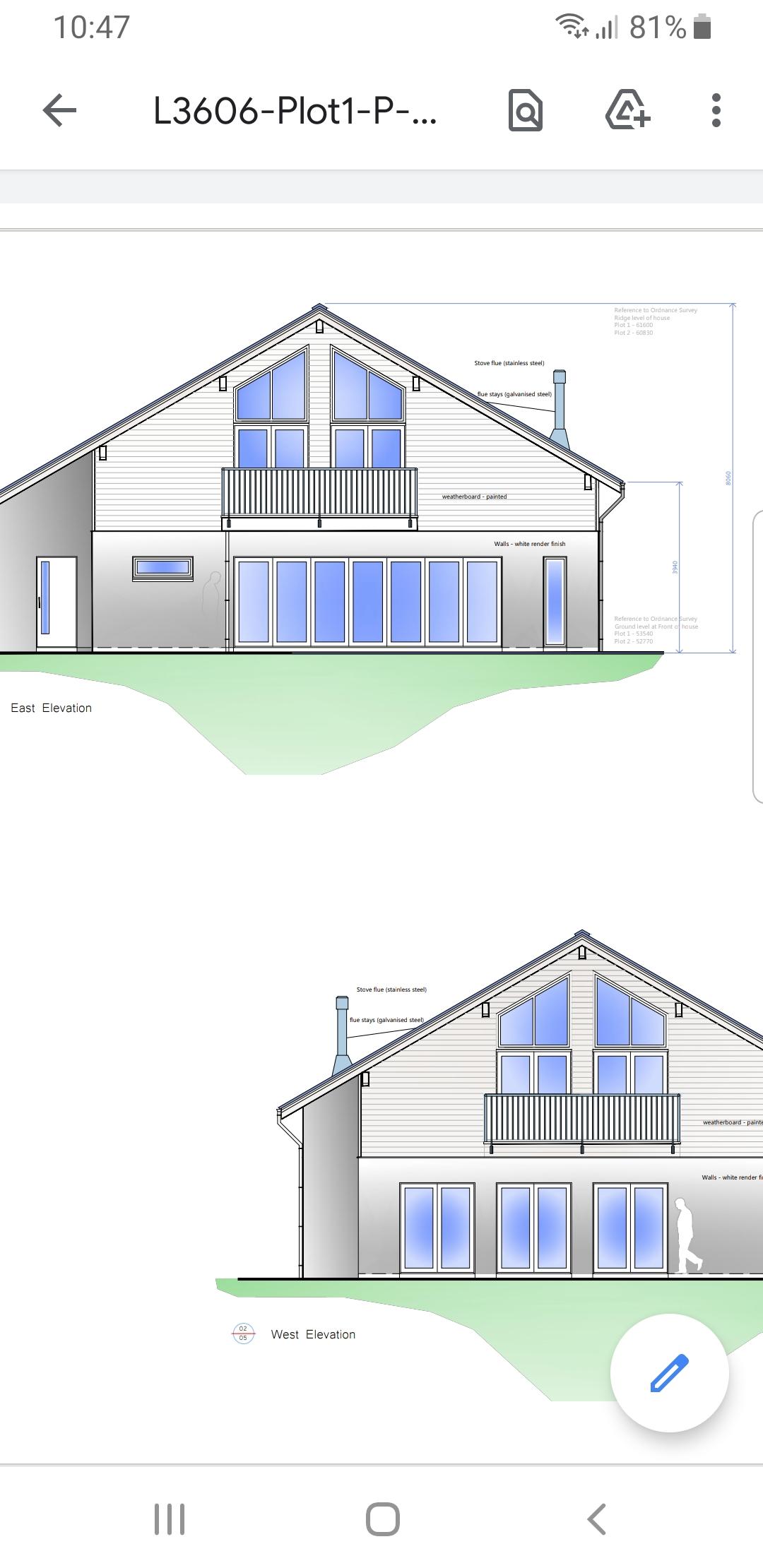

Wood89 Posted February 24, 2021 Share Posted February 24, 2021 I haven't posted for a while as most plans on hold due to covid! Looking at finding out a realistic house build cost I have a plot in mind with utilities included and planning permission for a 4 bedroom 1.5 storey house in north of scotland plot costing 85k with ground floor plan 174.18m2 and first floor 139.5m2. I see a lot of posts people say rule of thumb is budget £2500 per square meter.. which my calculations think we would never be approved for a self build mortgage that large! but I have joiners plumbers and electricians to hand in the family who would happily help for very low costing with internal work so more costings for materials, groundwork and erection of the house itself so its water tight. Myself and my husband both have first time buyer ISA however I think you can only use the bonus on a house to the maximum value of £250k ...is a 250k self build even possible??? Link to comment Share on other sites More sharing options...
AliG Posted February 24, 2021 Share Posted February 24, 2021 I think a lot of people with high specs and doing no work themselves are coming in at around £2000 a square metre. However, looking at cost estimators and knowing that people don't need the highest spec possible £1750 might be a reasonable figure to use nowadays. It also depends what you are including in that figure. You can easily spend 5% of the build cost on landscaping. A big driveway alone can be very expensive. Architects and other professional fees can run as high as 10% of the cost. Plumbing and electrics labour won't be that big a part of the build costs, I'd guess around 3-4% but every saving helps. Joinery would be more if they could put in the plasterboard etc, but that's a lot of work to be doing unpaid. If they simply gave you a good price again you are maybe looking at a couple of percent saving. This would also depend a bit on your build method. 1 Link to comment Share on other sites More sharing options...

Evs Posted February 24, 2021 Share Posted February 24, 2021 Its definitely possible but you have to do a lot of it yourself and spend time shopping around for the best prices. Internal spec can vary hugely and can obviously have such effect on the total build cost. The plans you show have a lot of glass and bifolding doors which is not cheap so that will take a big chunk of the budget. In regards to your help to buy isa, my fiance and I used our help to buy isa’s for our self build. It went on purchasing the plot, as long as neither of you have ever had a mortgage or house in your name before then you can use the isa towards the plot purchase. 1 Link to comment Share on other sites More sharing options...
