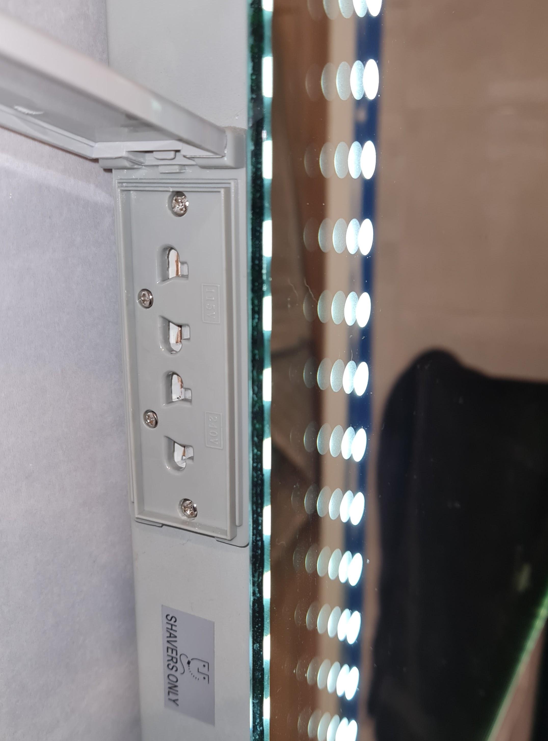

ToughButterCup Posted February 14, 2021 Share Posted February 14, 2021 1 hour ago, Russell griffiths said: ... I managed to exercise complete restraint and he had a lucky escape. ... No Russ, you had a little victory over yourself. The best sort. 1 hour ago, Russell griffiths said: ... [ I ] want to put one in every bathroom for hairdryers curling tongs and other stuff [ I ] need to make [me] look less ugly. Here's a start .... I know its for shavers , but (one at a time) you'll still be able to get your legs up high enough to reach the shaver won't you? This particular mirror has a heating element in it to de-fog the glass. Which kind of hints at the possibility of connecting a hair drier (?) Link to comment Share on other sites More sharing options...

PeterW Posted February 14, 2021 Share Posted February 14, 2021 4 minutes ago, ToughButterCup said: This particular mirror has a heating element in it to de-fog the glass. Which kind of hints at the possibility of connecting a hair drier (?) Really low power - think ours has a heater pad and LED lights and is rated at 45w max. Link to comment Share on other sites More sharing options...

dpmiller Posted February 15, 2021 Share Posted February 15, 2021 20 hours ago, ToughButterCup said: No Russ, you had a little victory over yourself. The best sort. Here's a start .... I know its for shavers , but (one at a time) you'll still be able to get your legs up high enough to reach the shaver won't you? This particular mirror has a heating element in it to de-fog the glass. Which kind of hints at the possibility of connecting a hair drier (?) And caution here, some of the cheaper mirrors don't have an isolating transformer for the shaver socket... Link to comment Share on other sites More sharing options...
ToughButterCup Posted February 15, 2021 Share Posted February 15, 2021 4 hours ago, dpmiller said: And caution here, some of the cheaper mirrors don't have an isolating transformer for the shaver socket... I'll have a look.... Link to comment Share on other sites More sharing options...
Bitpipe Posted February 15, 2021 Share Posted February 15, 2021 On 14/02/2021 at 10:28, ToughButterCup said: No Russ, you had a little victory over yourself. The best sort. Here's a start .... I know its for shavers , but (one at a time) you'll still be able to get your legs up high enough to reach the shaver won't you? This particular mirror has a heating element in it to de-fog the glass. Which kind of hints at the possibility of connecting a hair drier (?) We have those in each bathroom - standard 240v electrical connection is to the rear of the mirror / cabinet and they sit above the sinks so outside Zone 2. Exercised restraint on the bluetooth speakers and colour changing LED strips. We charge our toothbrushes in them, the de-mist function is handy also and the kids ones have clocks that they can ignore. Link to comment Share on other sites More sharing options...
