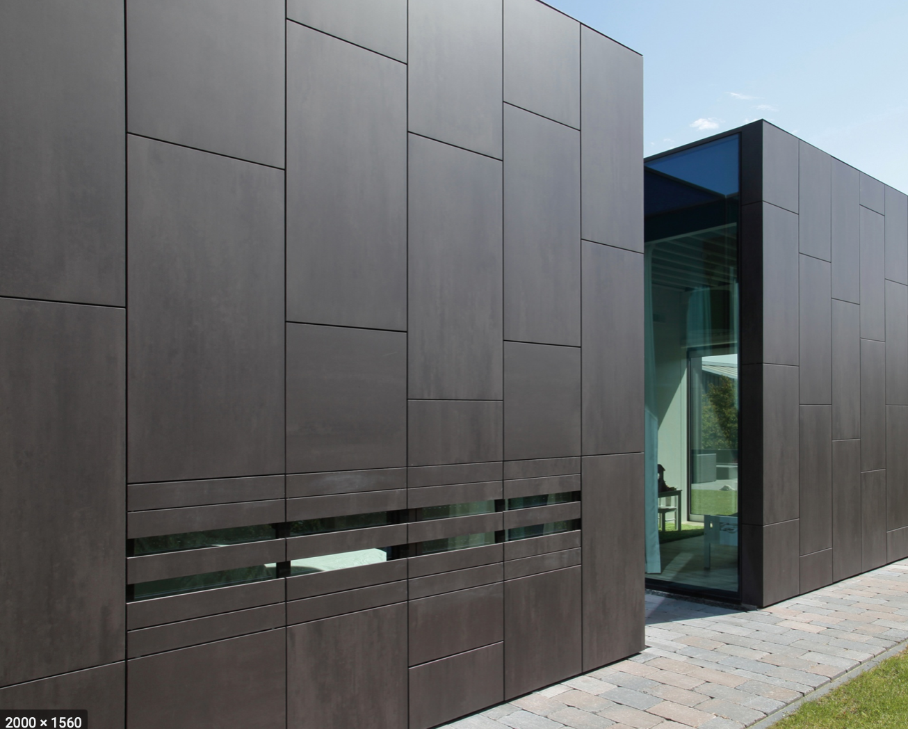

Russell griffiths Posted January 31, 2021 Posted January 31, 2021 I’m confused as well, are you intending to live in this as you build the new place. If you want cheap then stop looking at that external tile cladding, it is eye wateringly expensive. No no type of cladding should be fixed to the osb, you will need an external weather barrier membrane on top of the osb then a batten to create a void, if mot any moisture that penetrates the rain screen will touch the osb and could penetrate, the batten allows a drainage gap and also ventilation to dry any moisture that gets through. Metal sheets will be the cheapest form of cladding, as long as you stick to corrugated and avoid raised seam. Dont go smaller than 125mm for the walls 100mm of rockwool type insulation is not enough without a serious heat source and then you will be heating the garden as much as the room. You need to identify exactly what what you need this room to do then design around that.

BartW Posted January 31, 2021 Author Posted January 31, 2021 2 hours ago, Russell griffiths said: I’m confused as well, are you intending to live in this as you build the new place. If you want cheap then stop looking at that external tile cladding, it is eye wateringly expensive. No no type of cladding should be fixed to the osb, you will need an external weather barrier membrane on top of the osb then a batten to create a void, if mot any moisture that penetrates the rain screen will touch the osb and could penetrate, the batten allows a drainage gap and also ventilation to dry any moisture that gets through. Metal sheets will be the cheapest form of cladding, as long as you stick to corrugated and avoid raised seam. Dont go smaller than 125mm for the walls 100mm of rockwool type insulation is not enough without a serious heat source and then you will be heating the garden as much as the room. You need to identify exactly what what you need this room to do then design around that. Yes, so as above, I should have been clearer. we are going to build at Graven Hill. But we are also buying a house at Graven Hill. The house is small. The build is likely to take two years when it starts. We don’t want to give up our lifestyles because of the build. the house we are buying is tiny, but the garden at the back is 11 to 14m long, and 7m wide. we were gonna get an off the shelf shed, but they are not pretty, and we would spend around £2.5k to £3k on one. The outbuilding will have no toilet, shower. It will never be a temporary accommodation, or a guest lodge. It will always be a gym studio. Internally the remit is very simple. externally, I would like it to be nice to look at from our kitchen and bedroom black metal cladding is pretty much the cheapest and simplest solution. wood would be more in-keeping, and tile cladding would be an ambition. Why? Just because I suppose. whilst I appreciate our time at that property will be limited, I would like to be proud of it. Just like everything else in life that I do (or at least try ? ). plus, it will be three years between now and we will likely have (started and) finished the build. And that is a long time by my going. Whatever, and however we build it, will be a luxury, coming from a converted garage at the back of our flats. I am not worried about heating. I will spend an average of an hour a day there during Winter months. I have been using an electric fan heater, and that is enough to get me warm before I am too hot when I am pushing the weights. So answering @ToughButterCup’s question, cheaper than what? Cheaper than a proper robust detail with good heat insulating properties, minimal cold bridging, well planted structure would be. i identified those points. I just need some reassurances that I am not overcompromising the “build” bart

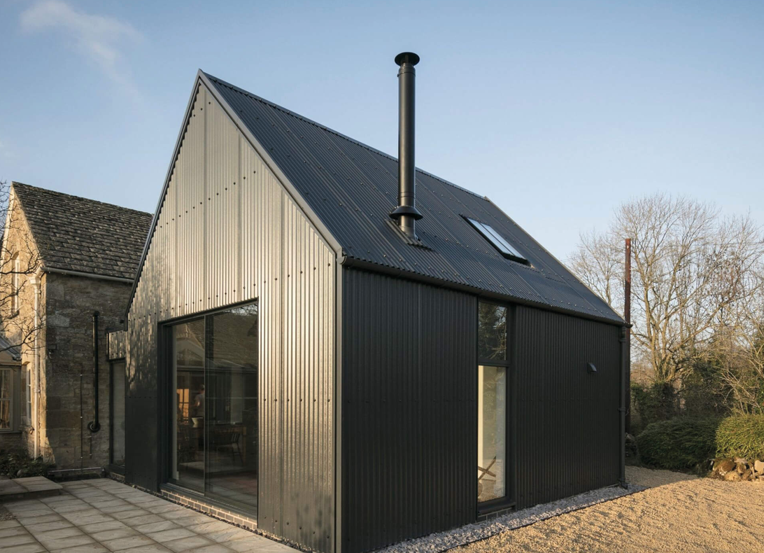

Linto Posted February 1, 2021 Posted February 1, 2021 Have you considered using SIPs to build it? Probably towards the top end of what you are talking price wise but would be a straight forward build and you could clad using what ever you fancy. Something like this
