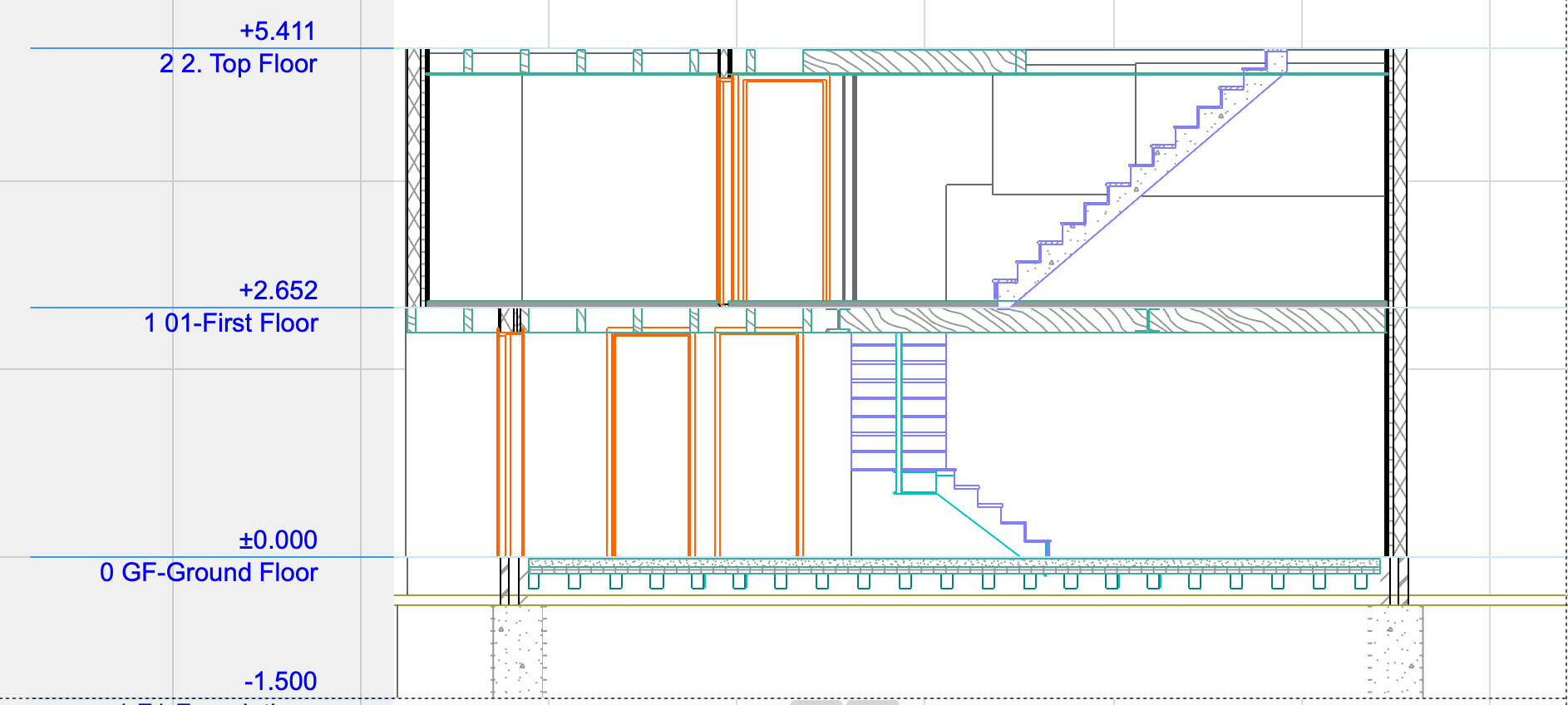

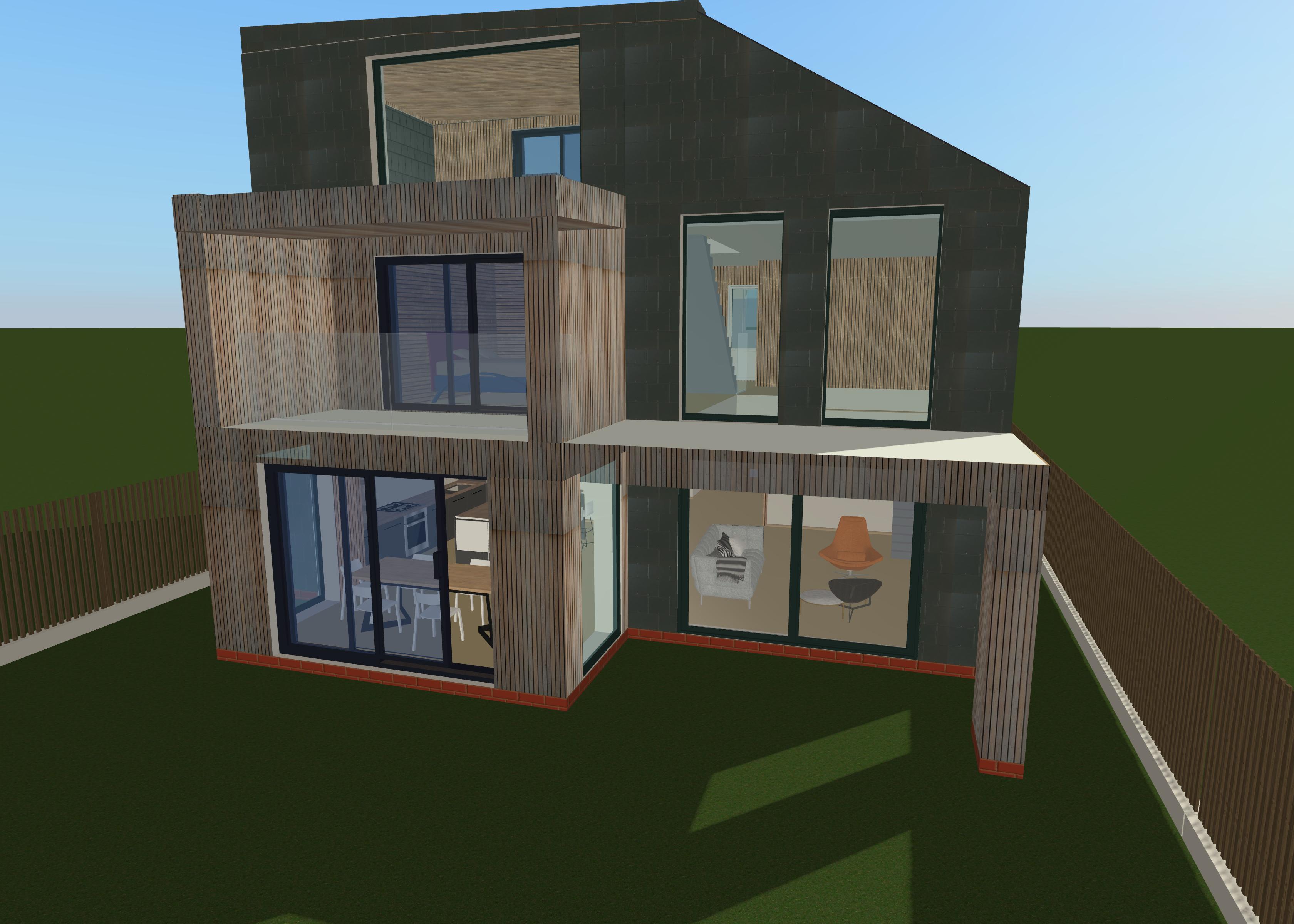

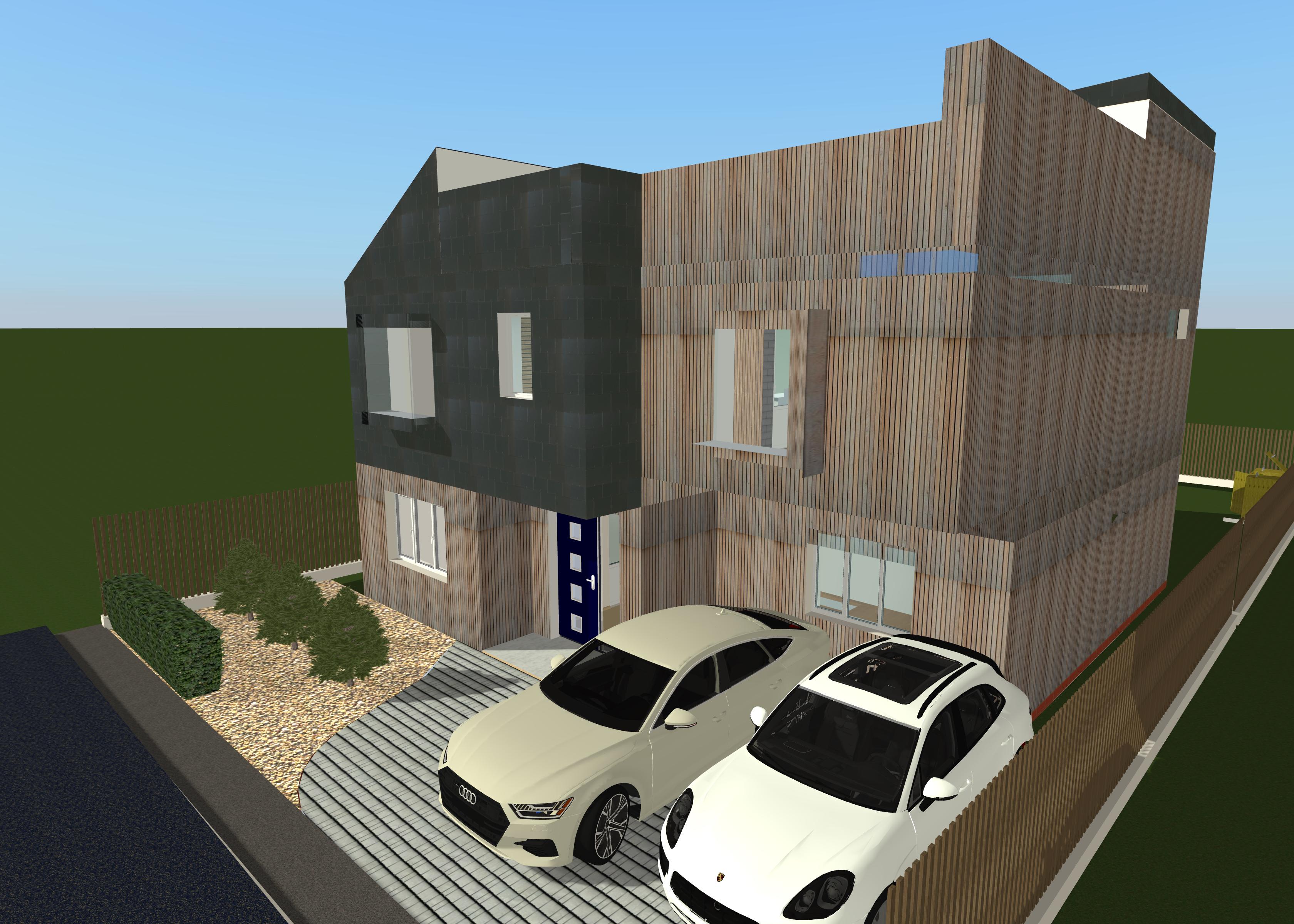

In addition to the plans, do you also have elevation and section drawing as I assume the latter helped with the design of the second floor?

Haha thanks, priorities change with age, and I am going to ensure there is enough future proofing in case it ever becomes a man cave with private terrace for private parties :P

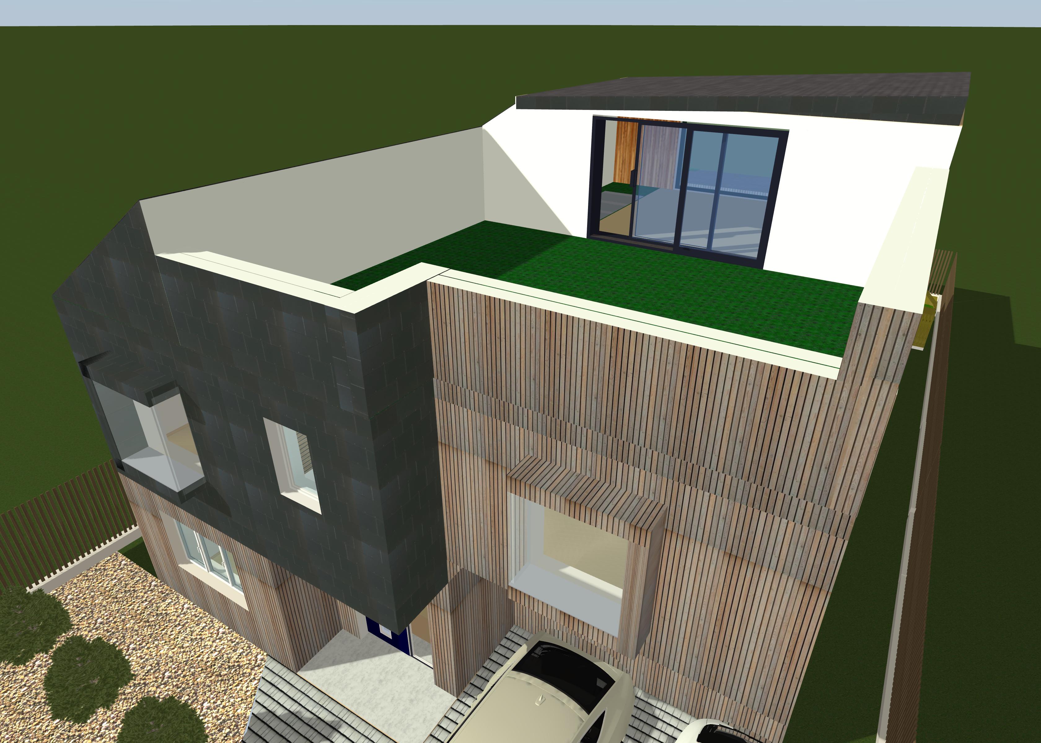

That looks good but complex to build.  The detail where you have an external terrace above the dining area will need careful consideration.

Thanks. It is in fact one of the things that are doing my head in right now. How to / where to / stop the wood cladding, what to turn it into etc. Rain water falls and all other likes. I am slowly turning these concepts into a working set of drawings. Hopefully should have it completed in a week or two (of my sleepless design nights ;) )

As mentioned above, those terraces are usually quite interesting to detail. You will either end up with a bulkhead in the rooms below or a step up onto the terraces from their respected floor levels.
How high are your ceilings as the stair from first to second floors appears to comprise 17no. risers so an overall rise of approx. 3.4m?

Yes, the thickness of the roof buildup above the dining area / below the terrace is certainly something that will need drawing up in detail. There are a few things I am considering:
- Kingspan TR26 for structural roof terraces
- thinner joists in that area
- as you stated, bulkhead dropping down over the dining area
- inverted / hybrid roof insulation design
And quite possibly a combination of all of the above.
As for the staircase, it is the very vague quality of the planning drawings that I am refining as we speak. The finished ceiling height on ground and first floors will be 2400mm. By pushing a step forward I am achieving it within 13 steps, and end up with a decent 1030mm long landing. Regs say at least as long as wide for the landing. I wonder if I may be able to get away with a narrower staircase to the top floor. At the moment I am proposing 900mm wide. Every little helps, they say, to get the room back to the Master Bedroom.
Quick snippet attached below:
1333695871_Screenshot2021-01-11at20_18_43.thumb.png.489e2118b062e01461c99dd0b5496e2b.png
1581256252_Screenshot2021-01-11at20_19_30.thumb.png.94277e5cdbb25576738180ddd7516d5a.png

I think you may need 3 spaces for that many bedrooms, but you say you have PP already.
