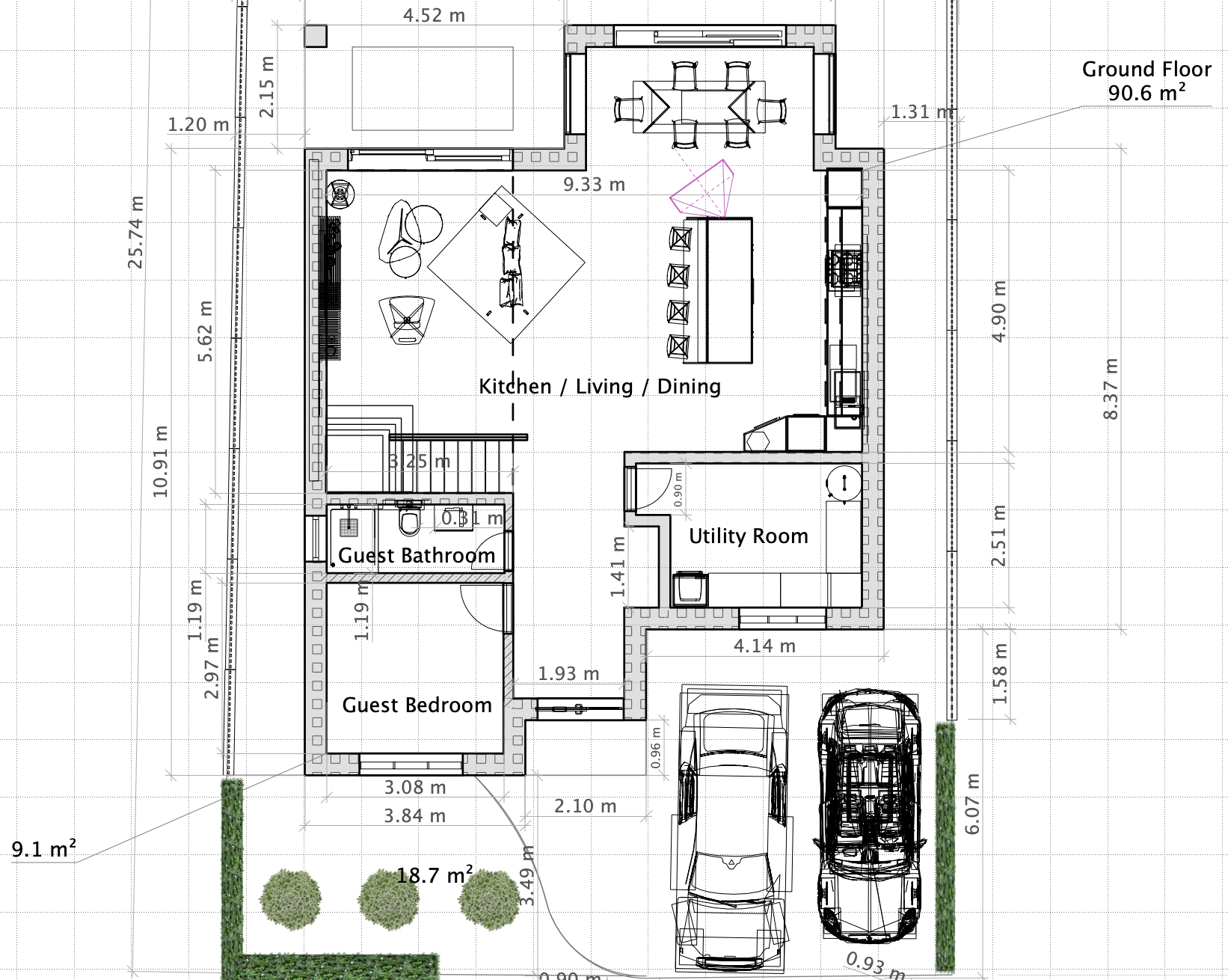

Hi everyone,
I am currently preparing drawings for Building Regs to approve, as well as the Timber Frame supplier to build off. When I was speaking to another TF supplier at the quoting stage it was mentioned that the GF WC / Shower Room will not conform to regs. I have looked at the Part M document, which makes clear references to toilets, but could not see a clear set of guidelines with it being a WC / Shower Room, or as in our case "Guest Bathroom".
Please, see a snippet of a plan for comment.
Many thanks!
Bart
1636563668_Screenshot2021-01-09at19_39_05.thumb.png.320fb077909717f2e1e858b3c5b3a33a.png
Looks like it won’t - needs an 800mm space in front of the WC plus the sink is in the way of the minimum width.
If this is English regs, just look at the Part M for a WC as this is the only ground floor WC so must be accessible.

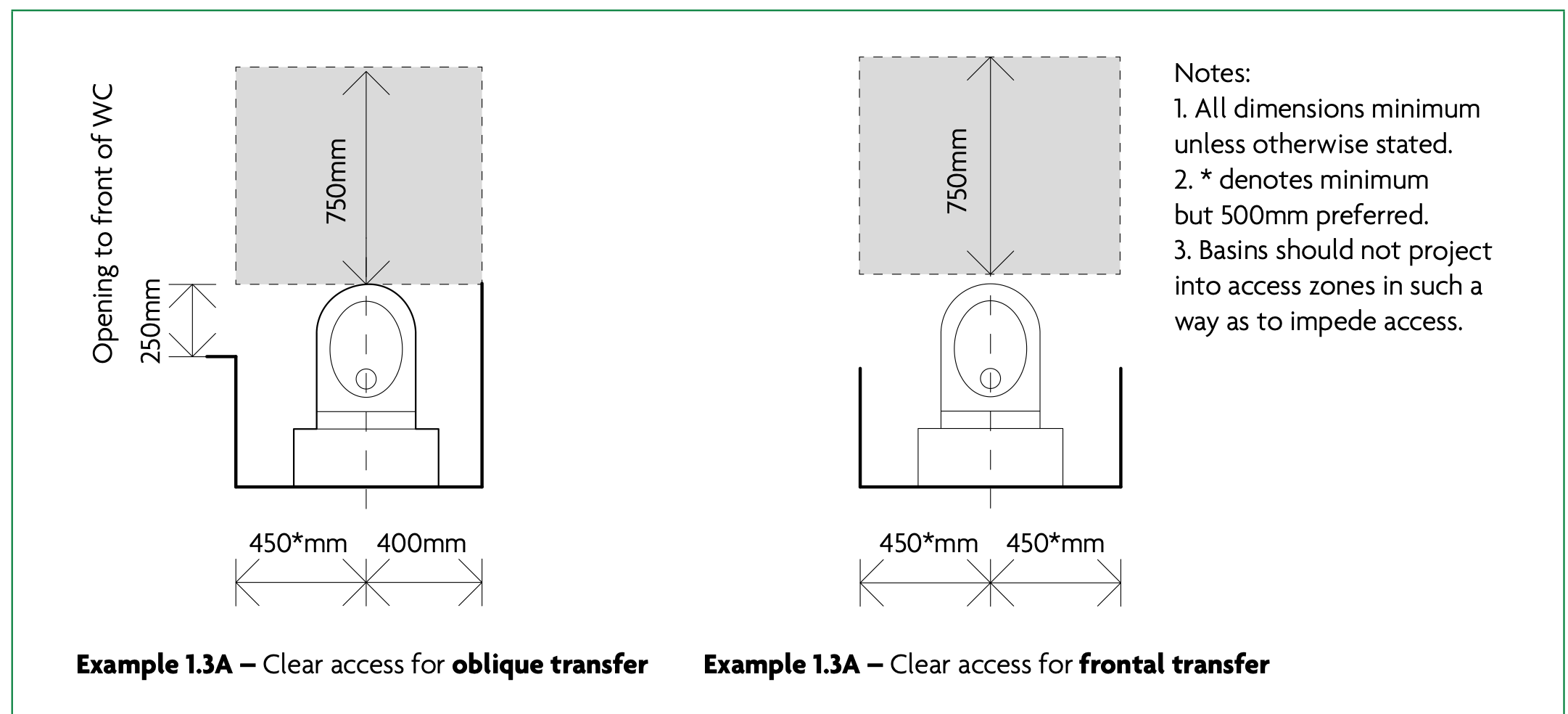

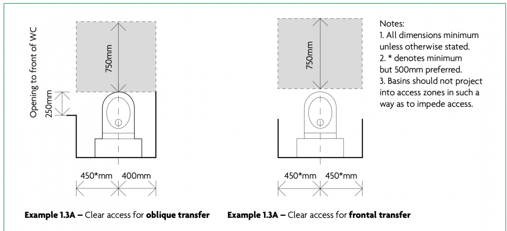

So, the Part M Regs say it needs 750mm in front of the toilet:

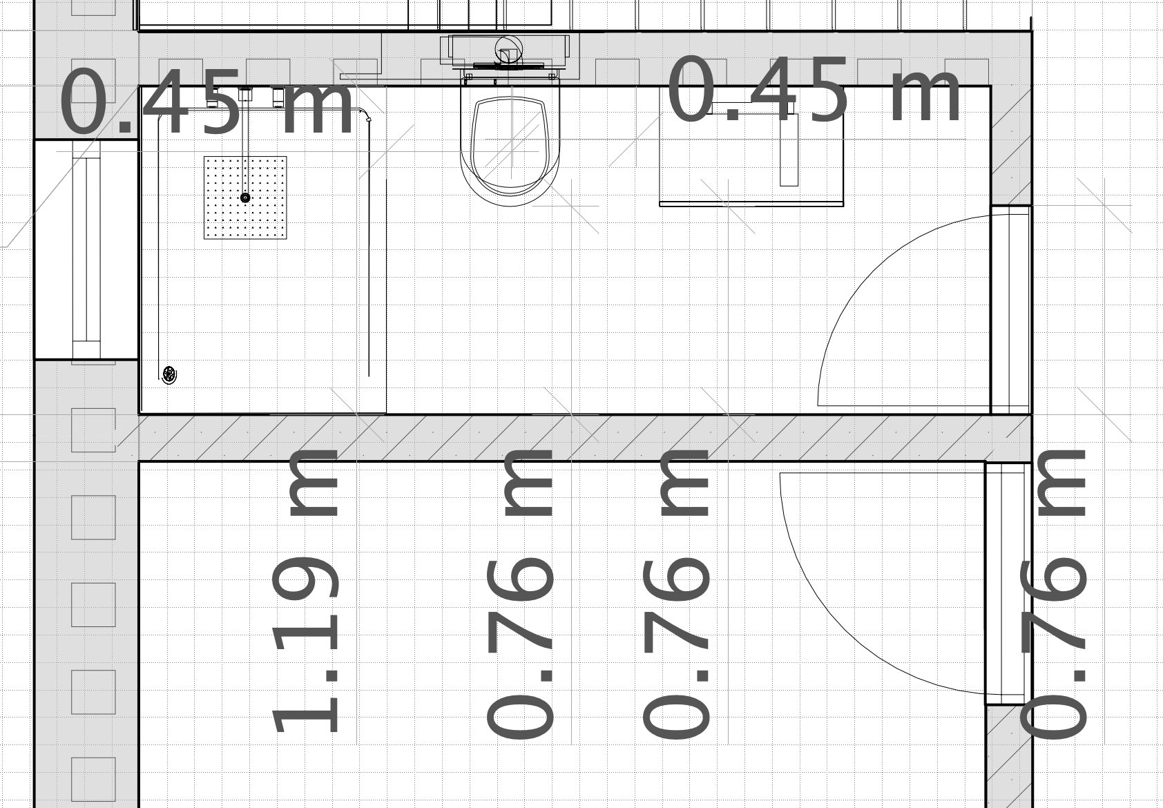

I can achieve this by thickening the staircase wall and having the cistern fully concealed:
1432299889_Screenshot2021-01-09at20_27_21.thumb.png.eefa4d71126b675f7c6fd0ed1aff9b40.png
The question is, am I reading the correct part of the regs, and interpreting it as I should?

I think you may need a wider door.  The regs specify a "clear opening width" not the width of the door. When a door can only open 90 degrees the door itself obstructs the opening reducing it by the thickness of the door and sometimes by another 10mm or so.
If you specify a room width of 760mm that only gives the builders 10mm for errors, plastering, tiles? Id be inclined to allow a bit more.

Ok - have a look at the amendments as they have better drawings.
https://assets.publishing.service.gov.uk/government/uploads/system/uploads/attachment_data/file/506376/AD_M_Corrigenda_SECURE.pdf
Next , the door has to open outward - see 1.17d
Also look at diagram 1.4b and 1.2 in the main regulations. - you need to also comply with these.

Hi I think the door has to be 900mm wide to cover wheelchair access
The door needs to provide a min. clear width of 750mm, which as per the note on Table 1.1 (Page8) achieved with an 826mm wide door. If you’re looking to have the door close or butt up to the wall, then the door will need to be made wider in order to account for the clear opening with protruding door handles, etc... But it’s still common and best practice for the door to open outwards, which gives you a little more scope for slightly narrower doors.
Your internal dimensions for the space infront of the W.C. and washbasin do upon first glance appear to comply, but do not leave much room for the varying sizes of sanitary fittings available on the market.

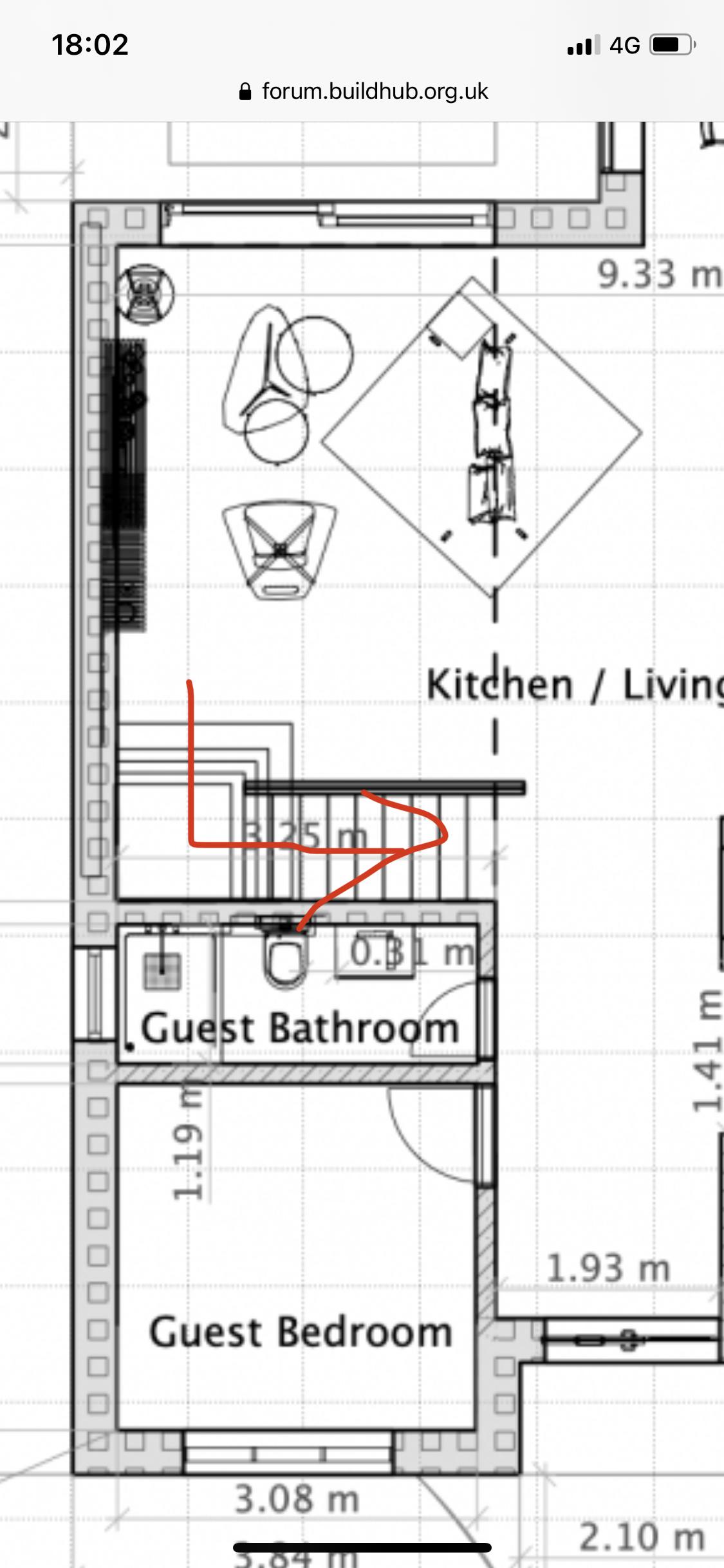

How are you planning on meeting AD B as the stair is not enclosed and opens into probably the worst ‘at risk’ area in a dwelling?
I think sprinklers may have to be a necessity, right?

To enable safe exit from the second floor via an escape window at first floor, you’d need to close off the stair at first floor level.
You’d need to check with Building Control whether they’d accept a domestic sprinkler system as opposed to a protected stair. As this is a new build, you’d probably need to check the BC requirements in conjunction with the new build warranty requirements. This is assuming a new build warranty will be taken out.
Is this house for you personally or a private client? If it’s the latter, do they mind potentially needing sprinklers? The water pressure to the dwelling should also be checked and deemed suitable.
There is quite an easy way to enclose the stair at ground floor level, which would prevent the need for sprinkles and first floor escape windows. It would involve some minor internal alterations but I can’t see them ruining the flow.

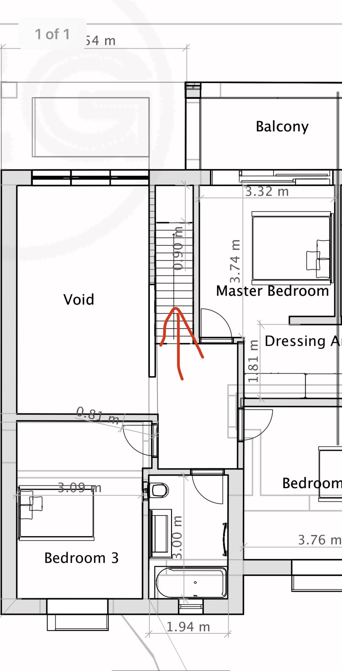

Thanks I see the plans now.  I cannot work out how the stairs work.  To make the plans easier to read it would help to have them all the same way round and an arrow on the stairs pointing up.
Hey,
the stairs from ground to first are as follows:
stairs from first to top floor as below:
Bart
I am still not understanding where the stairs from the ground floor appear on the first floor?
All I am seeing is the stairs from the first floor to the  second floor.
The first floor landing is at the base of the arrow.
