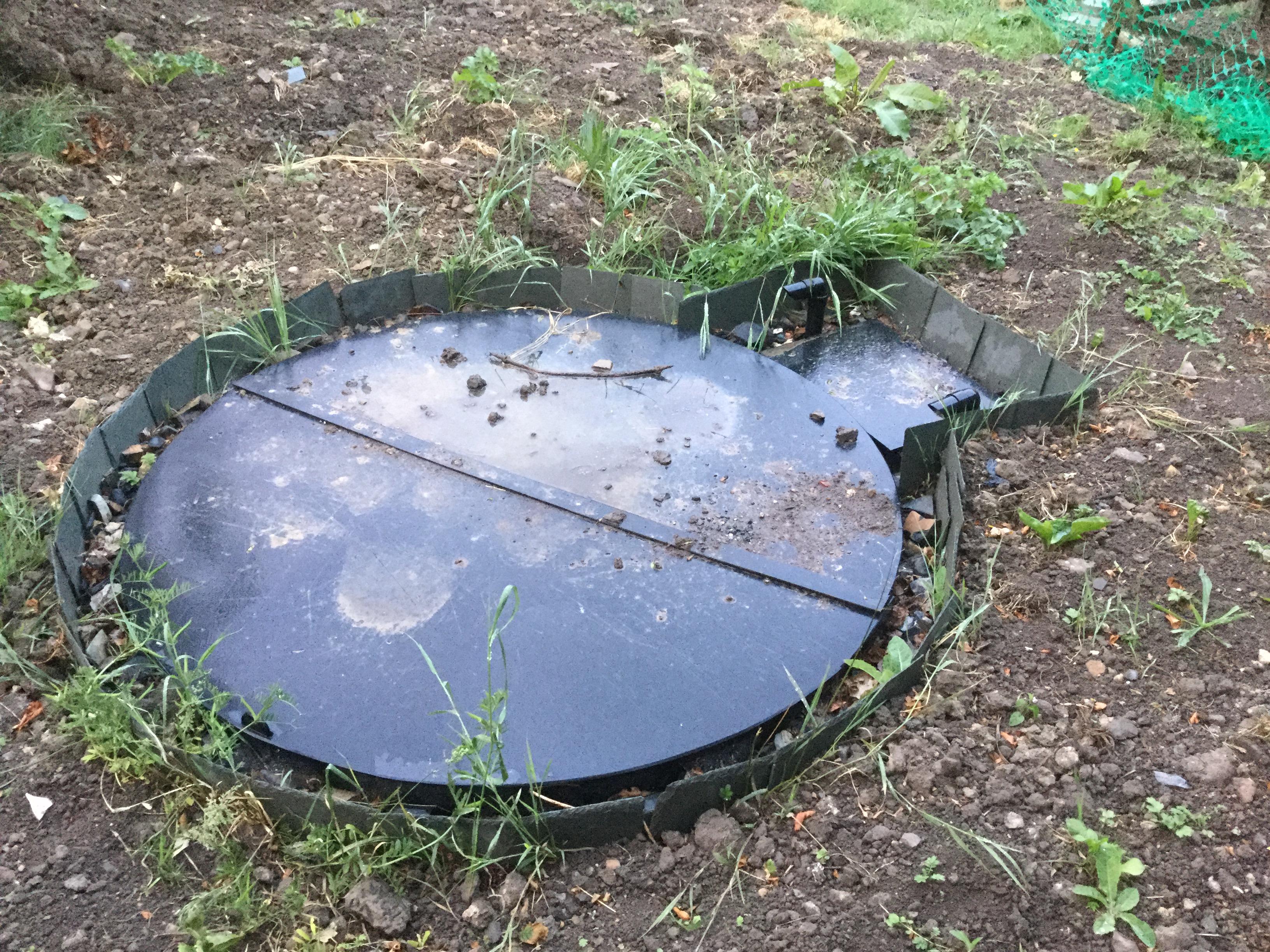

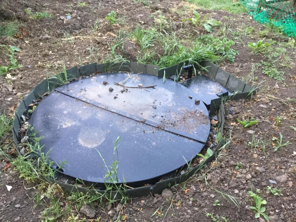

joe90 Posted September 28, 2020 Author Share Posted September 28, 2020 I went for the vortex in the end, the pump and controller came in a box to be fixed to the lid but it was sooo noisy as the lid acted as a drum. I moved the box into a hole in the ground next to the tank with a stone drain down to the rumble drain so it would not get flooded out. It’s whisper quiet now and less obtrusive being below ground level. 2 Link to comment Share on other sites More sharing options...

joe90 Posted February 2, 2022 Author Share Posted February 2, 2022 (edited) 41 minutes ago, Highland build said: Just going to have to try and disguise the green plastic box housing the aerator and control panel! I have a Vortex with a similar box and buried it next to the plant mainly to make it quiet.(picture above ). Edited February 2, 2022 by joe90 Link to comment Share on other sites More sharing options...
Highland build Posted February 2, 2022 Share Posted February 2, 2022 27 minutes ago, joe90 said: I have a Vortex with a similar box and buried it next to the plant mainly to make it quiet.(picture above ). this Graf seems to have the control panel i the box too so I think that 2/3 of the plastic box sticks up out of the ground and the aerator bit is under the ground with the pipe to blow the air into the tank. Possibly you might be able to bury the aerator bit and have the control panel in the plant I'll look into this @Barney12 Do you think having control panel remote from aerator would work? If not I'll accept the box sitting out next to the tank! Link to comment Share on other sites More sharing options...
Highland build Posted February 2, 2022 Share Posted February 2, 2022 On 28/09/2020 at 16:09, joe90 said: I went for the vortex in the end, the pump and controller came in a box to be fixed to the lid but it was sooo noisy as the lid acted as a drum. I moved the box into a hole in the ground next to the tank with a stone drain down to the rumble drain so it would not get flooded out. It’s whisper quiet now and less obtrusive being below ground level. this is very neat I's be happy with this! 1 Link to comment Share on other sites More sharing options...
