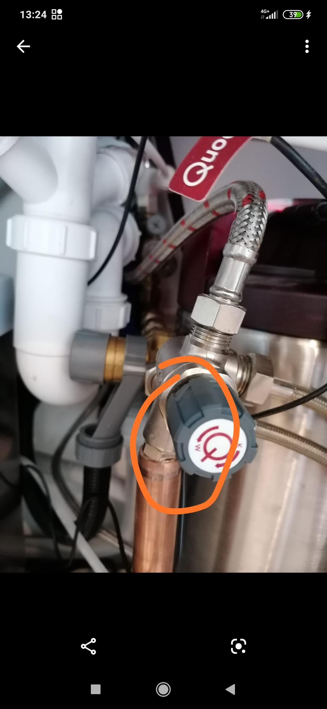

canalsiderenovation Posted December 15, 2020 Posted December 15, 2020 (edited) Quooker tap fitted, wife went to try it and it leaked. Come on, tell me this isn't normal work of a plumber. Circled what I believe is the culprit... Edited December 15, 2020 by canalsiderenovation
joe90 Posted December 15, 2020 Posted December 15, 2020 I have never plumbed a quooker tap but is it not supposed to be connected to the copper pipe? It looks awful really, get them back ASAP.

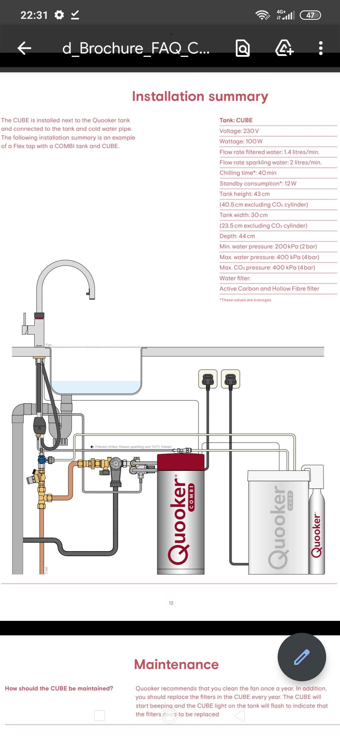

AliG Posted December 15, 2020 Posted December 15, 2020 Quookers use a lot of flex pipes in their connections. https://www.quooker.co.uk/media/wysiwyg/i/n/installation_guide_combi_e_uk.pdf This is a link to the Quooker combi installation instructions. If you look at P16, picture 3, I think that bolt in the top of the copper pipe is the one shown on the top of the mixer valve in the picture, it doesn't seem to connect to anything. Is that pipe actually connected to anything at the other end or is it being used as a strange support for the mixer valve? If it was an actual connection, water would gush out. So the leak is probably somewhere else and you still need them to come fix it, but hopefully the manual helps. 1
canalsiderenovation Posted December 15, 2020 Author Posted December 15, 2020 3 minutes ago, AliG said: If it was an actual connection, water would gush out My wife seems to think that's where it was coming from. He's coming back tomorrow. I did send him the manuals before he installed it. Seems I'm probably better off reading them myself and telling him what to do.... ? 1 1

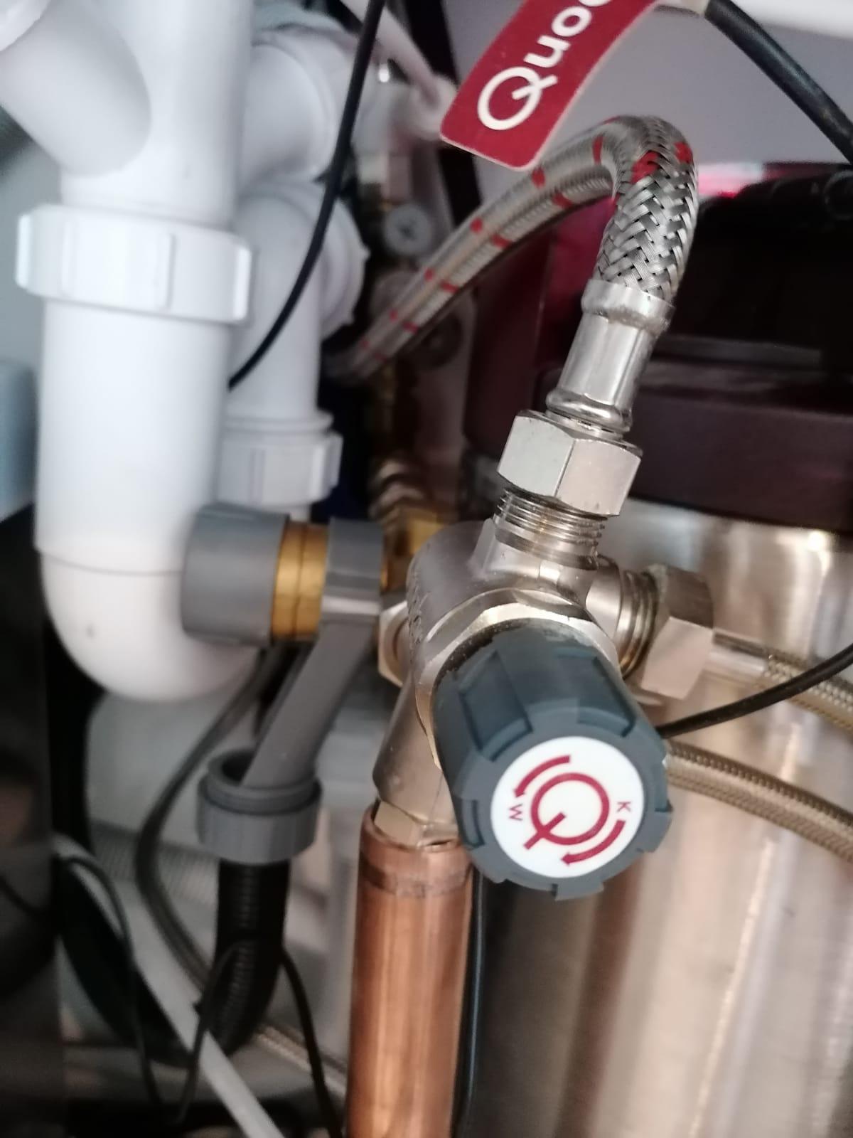

Russell griffiths Posted December 15, 2020 Posted December 15, 2020 Zoom out on the pic that looks like it’s jammed in to hold it in place not a water supply.
PeterW Posted December 15, 2020 Posted December 15, 2020 Too much thread showing on that top hose I think - wonder if that’s the cause of the leak and will run down toward the copper.
markc Posted December 15, 2020 Posted December 15, 2020 4 minutes ago, Russell griffiths said: Zoom out on the pic that looks like it’s jammed in to hold it in place not a water supply. Got to agree, the nut is probably a bung - could be leaking if its loose. Either way, the installation does look shabby.
canalsiderenovation Posted December 16, 2020 Author Posted December 16, 2020 (edited) Not sure on what the cause of the leak is/was. Went last night to find now the pull out hose won't work on the Quooker tap because everything is jammed in and something was wedged. Our builder just queried the set up on the pic with the plumber who muttered something about it supporting pipework as it's too heavy. He is currently having a tantrum over our large sink in the utility (the one you recommended @PeterWbecause 'its Chinese') and the Grohe pull out tap because it's not a normal one. The flipper panel he has fitted on the shower isn't right but he has 'lost the instructions' so can't put it right and I'm sure this isn't correct.. I feel like sacking him off, getting my dad to fit the utility tap and taking everything Quooker related out and watching YouTube to sort it myself. I've sent him instructions and diagrams and it's still not sorted. Edited December 16, 2020 by canalsiderenovation

canalsiderenovation Posted December 16, 2020 Author Posted December 16, 2020 12 minutes ago, ProDave said: What have others with the same Qooker tap done to support this valve then? No idea but it wasn't like this on display and this is the picture from the installation and Quooker and Cube with how it should be....
dangti6 Posted December 16, 2020 Posted December 16, 2020 Looking at images on Google and the diagram you showed - the inlet combination valve is often joined to a copper pipe. May be your photo angle, but does yours tee off with a flexi, hence no stability and it requiring propping? Also found reference to the valves leaking: https://quooker.ae/most-frequent-questions/the-inlet-combination-pressure-release-valve-is-releasing-water May not be your issue, but worth a mention. 1
canalsiderenovation Posted December 16, 2020 Author Posted December 16, 2020 28 minutes ago, dangti6 said: Looking at images on Google and the diagram you showed - the inlet combination valve is often joined to a copper pipe. May be your photo angle, but does yours tee off with a flexi, hence no stability and it requiring propping? I'll ask the plumber. There was a little dig at us when I tried to discuss the tap "I've only ever fitted new ones" (because our kitchen and tap was ex display). I mean what difference this makes I've no idea....

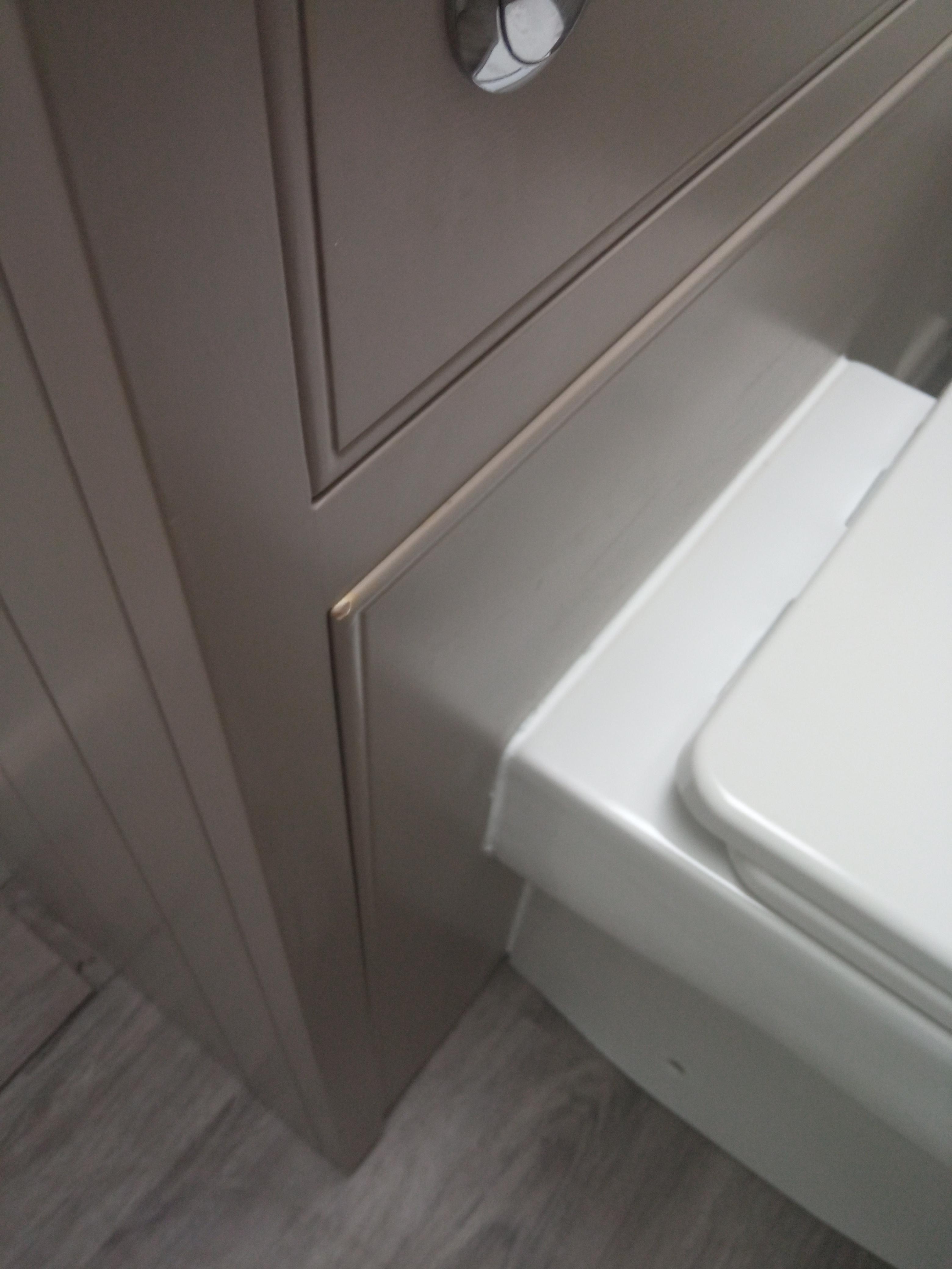

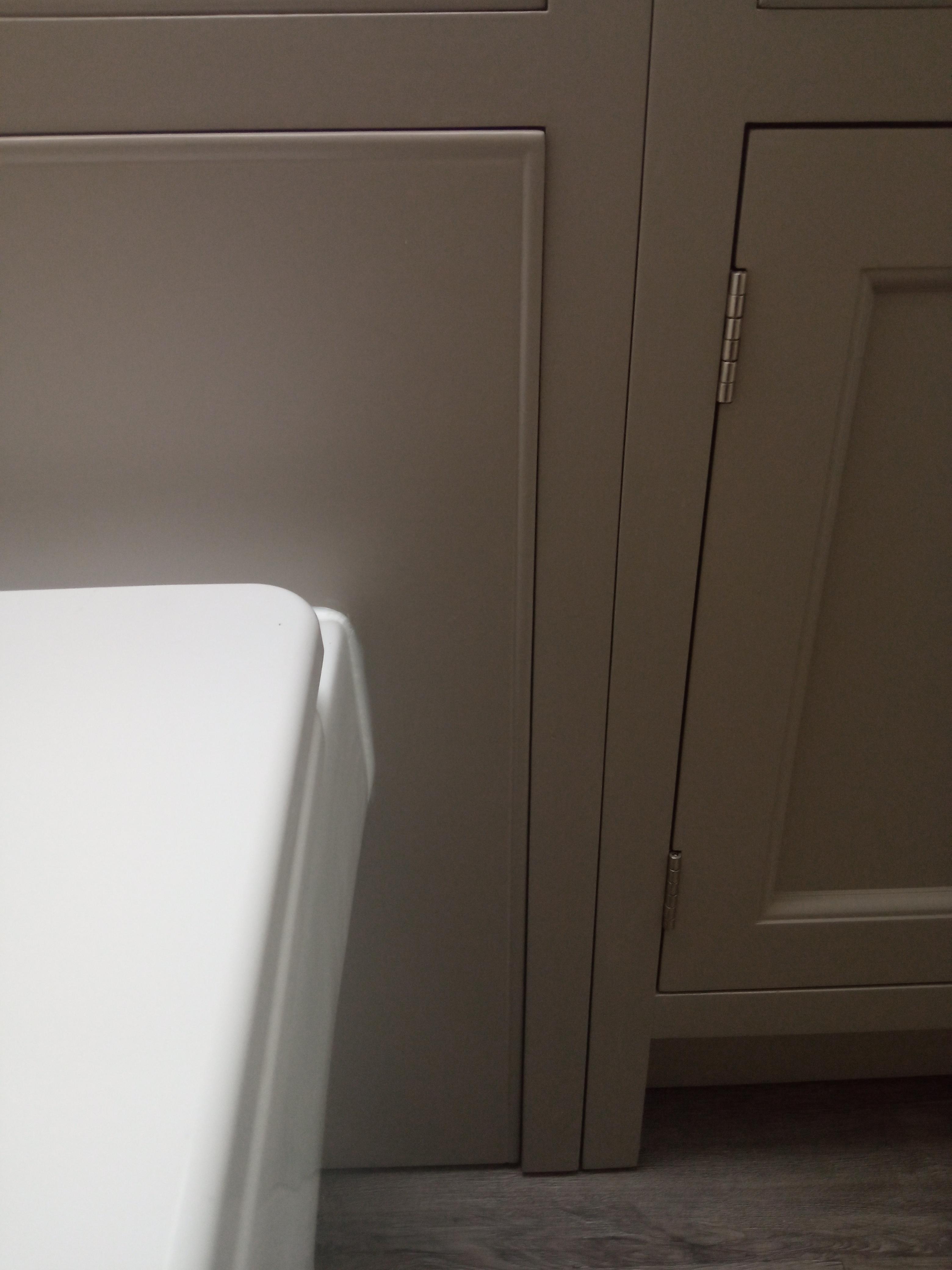

canalsiderenovation Posted December 17, 2020 Author Posted December 17, 2020 I'm just so angry today, amongst the things the plumber did actually do yesterday he was sealing toilet in ensuite yesterday and was the only person in the ensuite, no one else is in this section of the house so we know it's him. He managed to chip our Roper Rhodes cabinet (conveniently forgot to mention) and look at that panel, edge is sticking out and bottom is pushed in. Am I being dramatic? He's not showed up today either. It seems everything he has touched he has either not been able to do, bodged it, not done it properly or damaged it. If he's complained we have bought replacement items but I'm seriously at the end of my tether with him.
joe90 Posted December 17, 2020 Posted December 17, 2020 9 minutes ago, canalsiderenovation said: I'm just so angry today, 11 minutes ago, canalsiderenovation said: He managed to chip our Roper Rhodes cabinet (conveniently forgot to mention) breath deeply, count to ten! 10 minutes ago, canalsiderenovation said: Am I being dramatic? NO, you need to point it out to him that it is not right (like the tap!), give him the chance to put it right and if he cannot, you will get it done BY A PROFESSIONAL and send him the bill. Don’t pay him till you are satisfied by everything.
ProDave Posted December 17, 2020 Posted December 17, 2020 The "issue" he found is toilets are not precision engineered, and in this case the back is not exactly 90 degrees to the bottom. He needed to get the cabinet panel correct and seal the varying width gap. No doubt he will blame the imperfect toilet. 1
Mr Punter Posted December 17, 2020 Posted December 17, 2020 I think he could have left the toilet with the varying gap and asked you to confirm what you wanted, rather than mastic in the panel pissed. Quick call / picture and it is decision made instead of bodge.
canalsiderenovation Posted December 17, 2020 Author Posted December 17, 2020 1 hour ago, ProDave said: The "issue" he found is toilets are not precision engineered, and in this case the back is not exactly 90 degrees to the bottom. He needed to get the cabinet panel correct and seal the varying width gap. No doubt he will blame the imperfect toilet. He's back tomorrow he just rung me now and I've gone through a list. What bugs me is I know the chip wasn't there on Tuesday night as I was on my hands and knees next to it cleaning the loo and by Wednesday tea time it was chipped and he was the only tradesman in there. I told him I'm not happy. @ProDave is there something in particular I need to ask him to do in relation to the toilet/cabinet?
