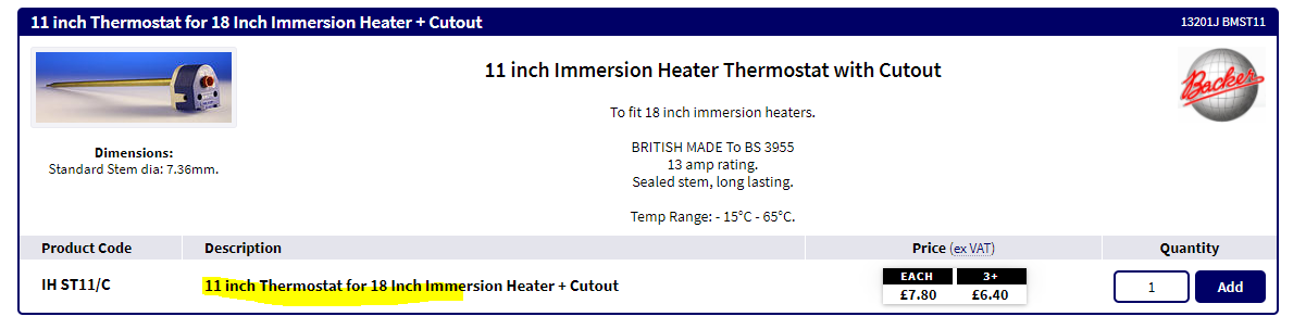

Posted
51 minutes ago, joe90 said:
for only £7 is it worth arsing around? ?‍♂️
I'll get the Backer one this morning and see if it actually limits the temp but I suspect with limited water, it will also overshoot.
Just note that the Tesla 225 in the heater is 11" long.
So best replace like for like and get this one even though it's for a 88" immersion?

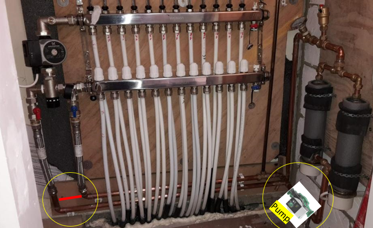

Posted
On 06/12/2020 at 18:16, Triassic said:
I’m confused, why you would need two circ pumps so close together?
I now have 2 indeed. One pumps the water around the loops (via manifold) and then the other pumps water around the Willis circuit:
I didn't add any inhibitor to the system, but flushed the whole system (clearing any of the previous inhib) and then re-filled with soft water. Willis heaters don't appear to be hissing any more so hopefully no scale up (since soft water) and the extra pump helps push the water around. Both are set to around 40oC in order to get sufficient temp into the floor. Have it running usually for around 2hrs in the morning and 2hrs later afternoon. Pretty mild temps outside at the moment so will have to wait until the New Year to see whether I need to get an ASHP instead.
