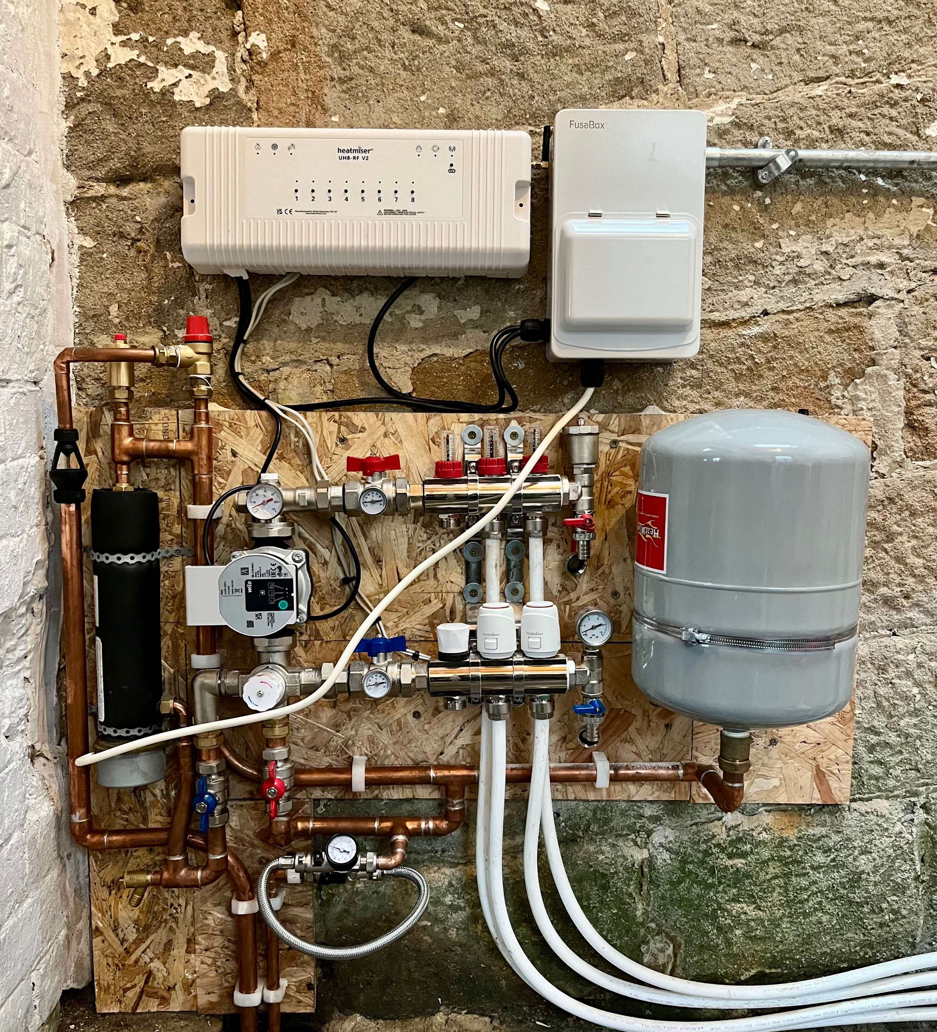

Just had UFH installed in outbuilding (will be studio / workshop eventually / and temp accomm while building), using Willis heater. Two rooms approx 20sqm total.
Seem to have the same issue as @oranjeboom did – Willis is 'kettling' when switched on, which is how I've found this thread.
Before I get the plumber back.. could someone more knowledgeable than I check our arrangement and advise?
Assuming we need a second pump for the heaters as first mentioned by @Nickfromwales ?
Any help / thoughts appreciated.
Posted
Trouble with mixers is they mix, so quite a lot of return water goes around the loops again, so inlet water flow rate can be low. So low flow rates a 3kW heater, it's possibly boiling the water.

Is this staying as the long term solution?
If so, time to add the second pump and a 25L volumiser, and max out on efficient operation / longevity.

Posted (edited)
Or, get a cheap as chips ASHP and put good money after good.
Can you install the house ASHP there and export heat to the new build later on, via an underground pre-insulated umbilical, when you do the house?
The one ASHP can then heat both spaces / buildings.
Thanks for this.
Initially was thinking / hoping this could be a temporary solution as is.. but overlooked the need for second pump and volumiser.
Building the house 2026, starting groundworks in Feb. It's about 25 metres or so across a largely paved old walled garden from this outbuilding to the house (2 bedroom single storey, near passivhaus timber frame).
Maybe cheap ASHP is the answer for the outbuidings as you suggest.
