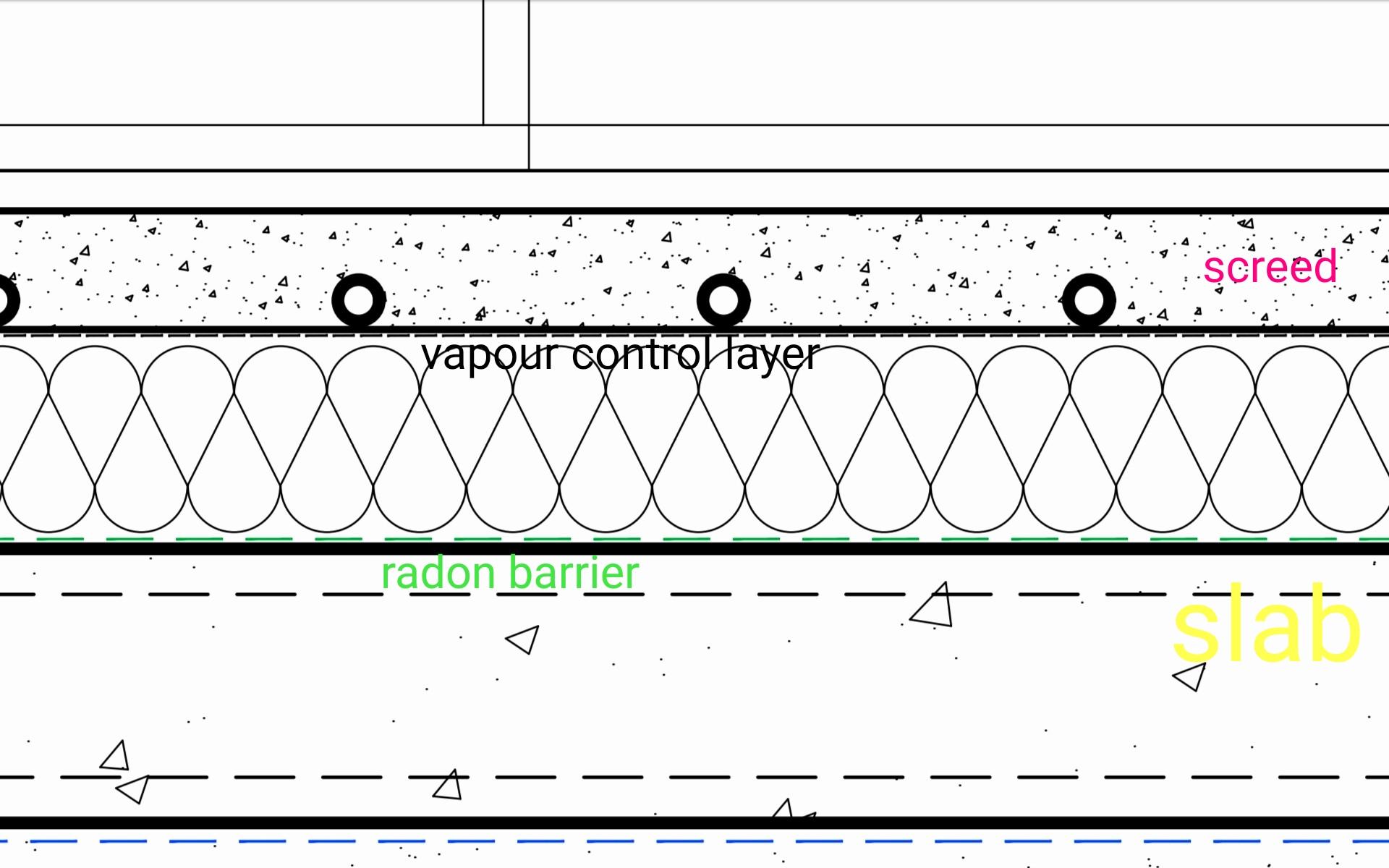

  1. Any thoughts on my floor make up We have a raft foundation with DPM below, as we are in a radon area we need a radon barrier above the slab and below the insulation. We're planning on taping the insulation joints to form the vapour control layer, this means we can't pin the underfloor pipes directly to the insulation without compromising the VCL The architect has specified a wire mesh over the insulation to fix the pipe to which sounds a dreadful idea to me 🤣 We already have several hundred clips to pin the pipes to the insulation and this would be my preferred method So my question would be does the radon barrier double as a VCL? If not can anyone suggest a solution

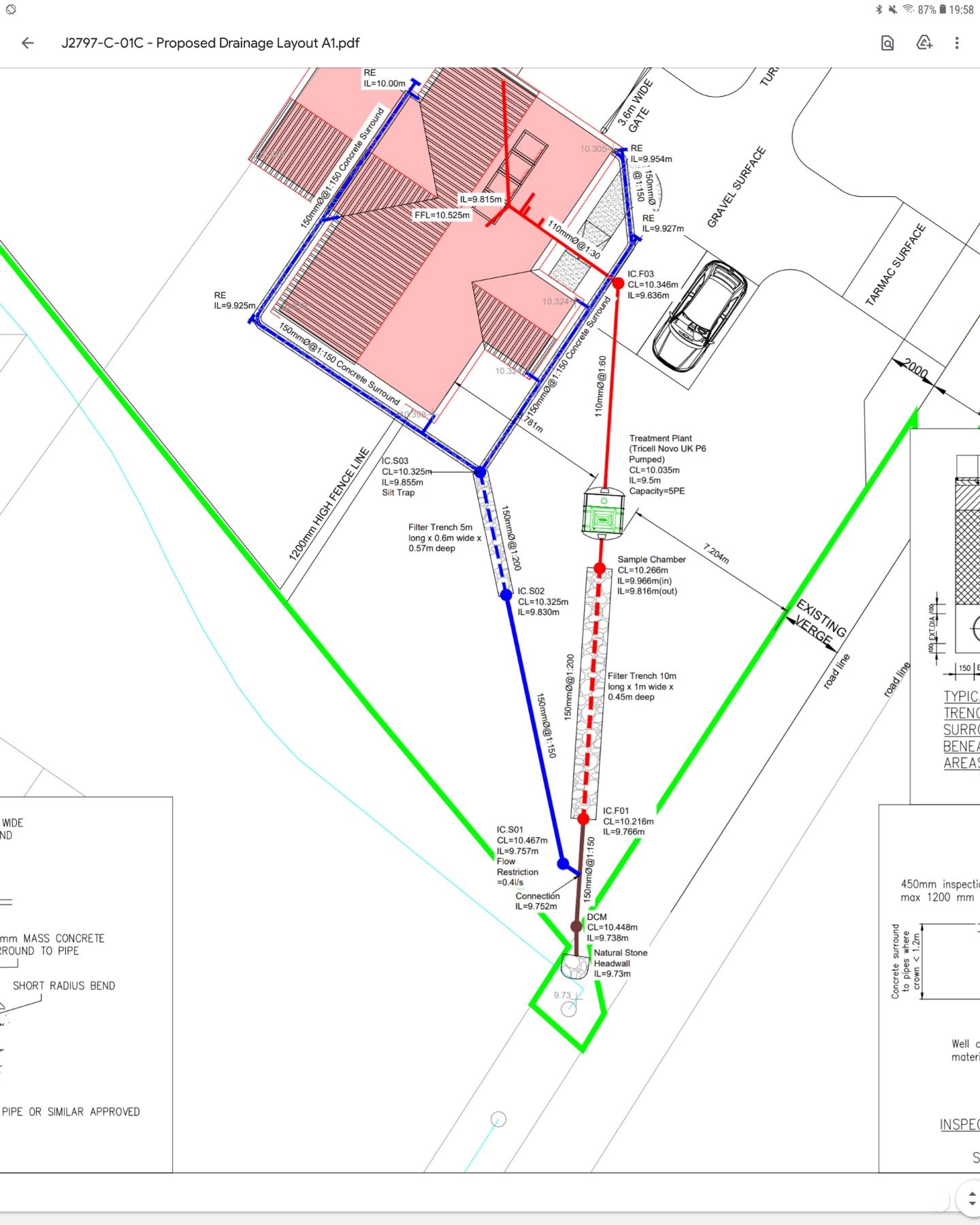

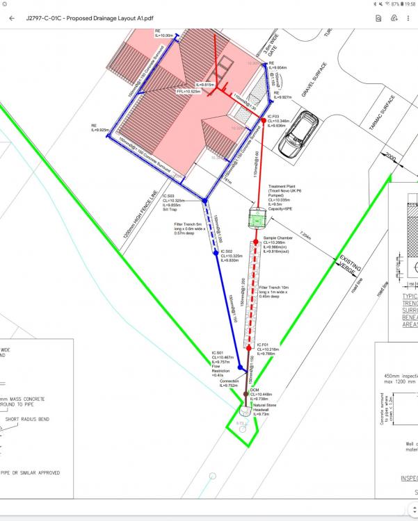

  9. Drainage layout was designed by our engineers along with the foundations. I've found a company that will supply a 0.4l/s restrictor which is essentially a silt trap with a cap on the exit pipe with an appropriately sized hole in it and then a filter fitted to it. I'm pretty sure I could make the same myself but don't know if building inspector would ok it. Scotland based if that makes a diffrrence
  10. The total roof cover is 136m² The system has been designed with 150mm pipe rather than 110 to include a 10 m filter trench as well
  11. Our SW drainage requires a 0.4l/s flow restriction before the outfall. Now to my mind this is as simple as a capped pipe exiting a silt trap chamber with an appropriately sized hole drilled in it to give the required flow. Do we think this would be suitable or do I need to spend a few hundred pounds on a ready made product?
