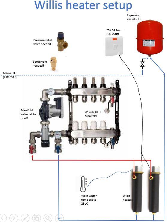

Right, so following on from my blog entry here where I discuss using Willis heaters to heat up my UFH (https://forum.buildhub.org.uk/blogs/entry/680-temporary-heat-source-for-ufh-willis-heaters/ ) I'd initially tested them earlier in the year when I'd set them up and then only in the past 4wks really started to use them for some evening heat in the house and they did their job pretty well (not turned on all the loops yet as there are some rooms that aren't completed yet (north colder part of house). So only switched them on manually for say 2-3 hours each day.
swEoMaAZvYZuQDM9kLfnjgWH6dbbo7p4yuIWpqRAOTFYnP0S64FeNBLcy2PWm67hiUO64VAlAcJnn8EHH2C828paKKeLaJatdY2fYVWeITjb8eESXpHi0JBqN-cvOO5kThvTBdpv4H_-OzINSJ-cf4Fpcvp2RGnNJoCxN5Ely988FSQAQQrDFxD0QmclnUsOgUa_RDT-e6Jjkurzu8pinptQ8B_fSKcCbX-8G7TejBu0GSdrrJpVpgi0L-p67h8Rvl6UCzTnKiMA7Da8N6jndNXevcDHFNZgmo48HLuh4vu1lF5MAc1vwVbiF8tmxte_QgG3ox12FEWD7jFx43uj-lTJ-pm3vsW4oKy27gwbmyhcOPQonhQscuW4_F0MRegzsNaFS4dnAPsMoiznuWRD3wL0_WfYMMxYdrm6mxgZaqOl77w6-ZnOX1R0l5h-l8WRa9pVu-J3Arwo2f7CPhwE-DaBlBNnf_aMIWvlGqcsxQFkmumBrRo22KxYdYBV-PRgHWDs8sTXmExUy23xH1m7fzejcdkj42itxF4ESW41rzpLUT39b2nZxGQAy0V8xxvCGVE8mYAmSpzU94ViH2ufTzItCHctg6BqcfWM2R-L61_O7oZzIM-tt6FcncQnjVEqS1Y3Vz9s7DM8s0EibwsARPeKYQe3gv1h_Of01w2fRjM8sX4tWPDvVfof9t6Oeew=w1158-h652-no?authuser=0
Yesterday one of the heaters started 'making noises' that he was not happy, so I switched that one off and left the other one to run. Then today the other one also decided it was not happy. Video below, with aforementioned Willis...'making noises'.
To me it sounds like a kettle that's trying to boil/simmer with not enough water. I'm suspecting it's scaled up already in this short time. There's no heat coming from the outlet pipes at all and the heaters themselves don't feel warm either. I still have pressure (1.5 bar) so I don't think I have a leak anywhere and no water in pipes. The manual bleed valves indicate there's water in the manifold at least.

Are you running the Willis heaters through a constantly recirculating loop with its own pump? Then the UFH should be Teed into that loop for flow and return to the manifold pump? A bit like a figure of 8 with the two pumps remaining hydraulically separate from each other. If so, the pump speed of the Willis circuit is too low.
Have you turned the 2 Willis heaters down on the internal stats? They should be set to no more than 45oC.
No, I'm using the manifold pump for both heaters:
Pump appears to work fine with this arrangement on slow speed and had no issues up until now. It's a distance of approx 1.6m between heaters and manifold.
They are both set to about 50oC. The thermometer on mixing valve never went much over 30oC
You cannot do that. You'll have to alter it to have a pump and a recirculating loop. The heaters are kettling and overheating.

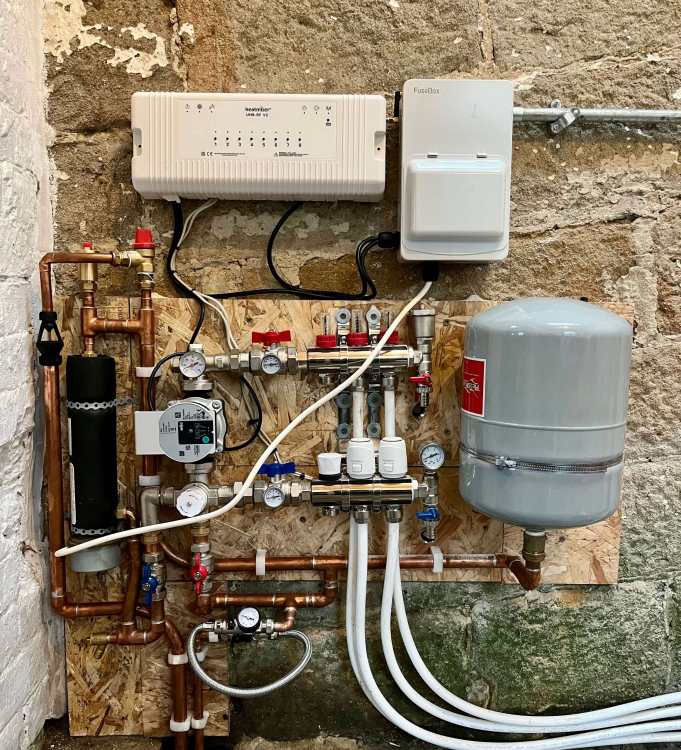

Pic of 'naked' setup without all the insulation:

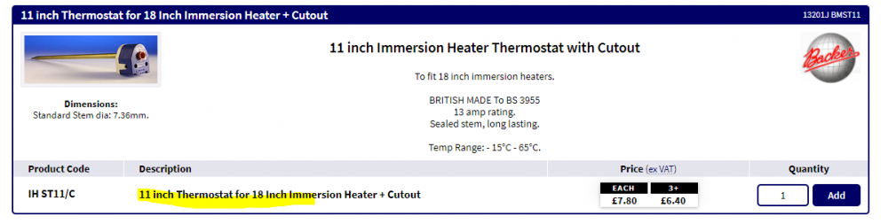

Seal the UFH off, drain the Willis heaters and drop the elements and see what they are like. Also try dropping a thermostat and just check the resistance and make sure it’s tripping in and out.
These things are brazed shut, sealed units. The only access for viewing is through the pipe entries.

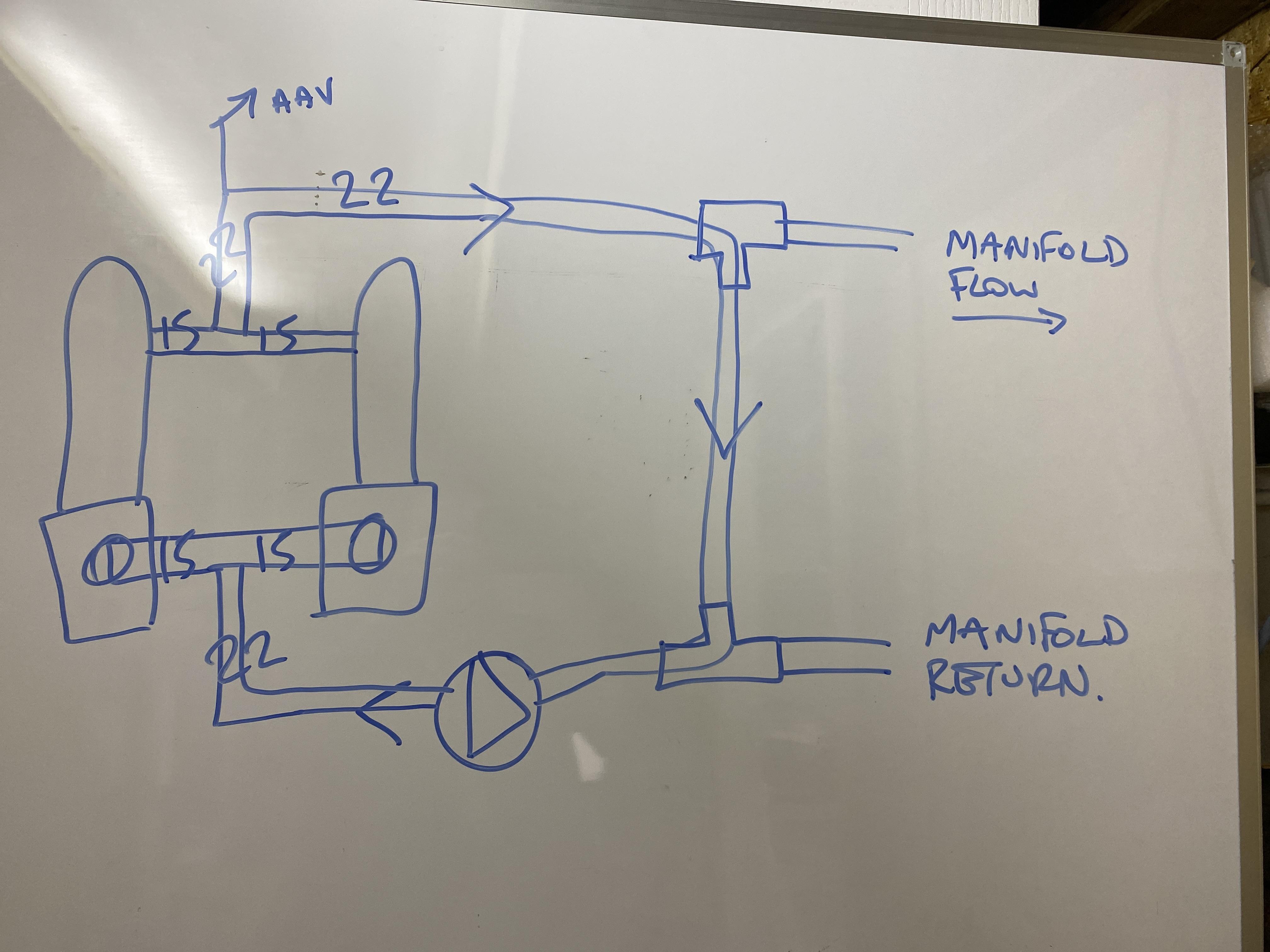

These are just kettling as the water flow rate through them is way too low / slow when the TMV nears the target / set flow temp. Needs a second pump as per my Rolf Harris drawing, and then you'll be fine.
2 hours ago, Nickfromwales said:
@Nickfromwales, for my sanity, could you indicate on here where the flow and return from the boiler or ashp would join into this please. And also where the ufh loops pump sits. Thanks
when I was a kid we didn't have an automatic pump switch on the coal boiler - when the water boiled in the pipes you'd think the house was about to fall down.  I think Nick is right.  I'm guessing a pump wired into the elec feed to one / both of the Willis heaters would be OK?

I've taken one heater out and yes, some scale on that. I'll try and insert a camera in there to have a good inspection and then get some vinegar in there to soak for a while.
