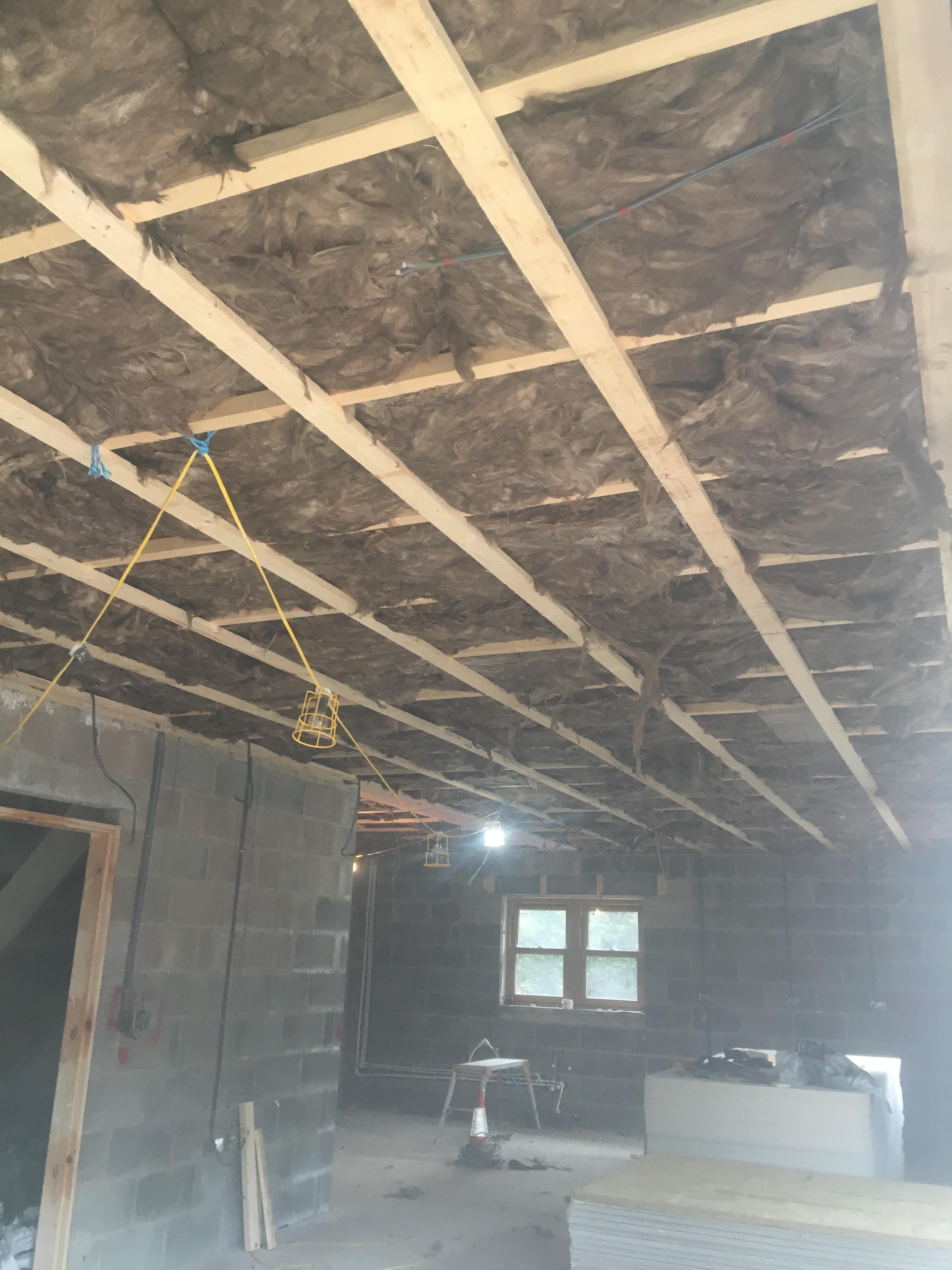

tanneja Posted September 24, 2020 Share Posted September 24, 2020 Hi all, relates a bit to a topic posted recently on here but a bit of a different ask. New joists been out in between ground and first floor. The ceiling / floor joists are timber joists with chipboard above and will be plasterboard below. At the moment ceiling below not done. Chipboard has been screwed to the joists and the chipboard joins are glued. It is creaky in areas. I had hoped to have silent experience when walking around the 1st floor with the renovations (was previously old floorboards, it was like hopscotch at night to not wake the kids). I would think it it the chipboard, not the joists, but its difficult to say what interaction / material bending is responsible for the noise. Will it be fine when underlay and carpet go down, or am I best to remedy now? I have been warned by my builder that now getting an insulation backed board like ScreedBoard 28 will be expensive and for an unknown performance benefit. Is there a more cost effective solution? Upstairs is only around 50m2 but budget is very constrained. Link to comment Share on other sites More sharing options...

tanneja Posted February 24, 2021 Author Share Posted February 24, 2021 Brining this post back from the brink as we have not managed to solve the issue. We have nogginned everywhere. Used the multi thread (with part clear thread) screws everywhere. There is still loud creaking, and some subtle floor bouncing. I have attempted the person being upstairs as I have my ear right underneath, I can't tell if the noise is from the (glued) chipboard joins, or where the chipboard is glued to the joists, or the screws. The chipboard is just 18m standard stuff. I can't see any gaps between the chipboard and floor above to shim, but i guess it could be a mm in places and I wouldn't know. Pipework going through the joists doesn't seem to be rubbing. I guess it would be considerable work to take it all out and replace with 22 or 25 mm flooring. Plastered stud walls have already been built over it, and since the staircase is in, makes the transition of FFL upstairs a complicated detail. The downstairs ceiling still not boarded so have full access from underneath. Was thinking of grinding out the board joins, seeing if that is the issue. If that solved the creak, could then noggin underneath all joins and mechanically fix the boards to those, and fill the 3mm gaps with a silicone, then perhaps overboard with maybe 6mm board of some kind if we had any concerns that the underlay and carpet doesn't do enough to eliminate the gaps. It would reduce whatever rigidity we get from the interlocking. I don't want bounce in the floor, I don't have limitless budget either. Upstairs rooms that have been boarded are only around 25m2 so not a huge area. Any help greatly appreciated Link to comment Share on other sites More sharing options...

tanneja Posted February 24, 2021 Author Share Posted February 24, 2021 (edited) The floor viewed from underneath. I should say, I am as sure as I can be from when I get up close, that all noise is from the centre of the floor, not the hanger ends. Edited February 24, 2021 by tanneja removal of pic Link to comment Share on other sites More sharing options...
Onoff Posted February 24, 2021 Share Posted February 24, 2021 Who specified the drilling of the joists for all those pipes and wires? They're supposed to be within 0.25 - 0.4 of the span. https://www.voltimum.co.uk/articles/cutting-holes-and-notches-solid-timber Link to comment Share on other sites More sharing options...
tanneja Posted February 24, 2021 Author Share Posted February 24, 2021 Thanks @Onoff I will look into it and make revisions if needed Link to comment Share on other sites More sharing options...
Onoff Posted February 24, 2021 Share Posted February 24, 2021 1 minute ago, tanneja said: Thanks @Onoff I will look into it and make revisions if needed That'll be magic hole filler or new joists then! ? Link to comment Share on other sites More sharing options...
