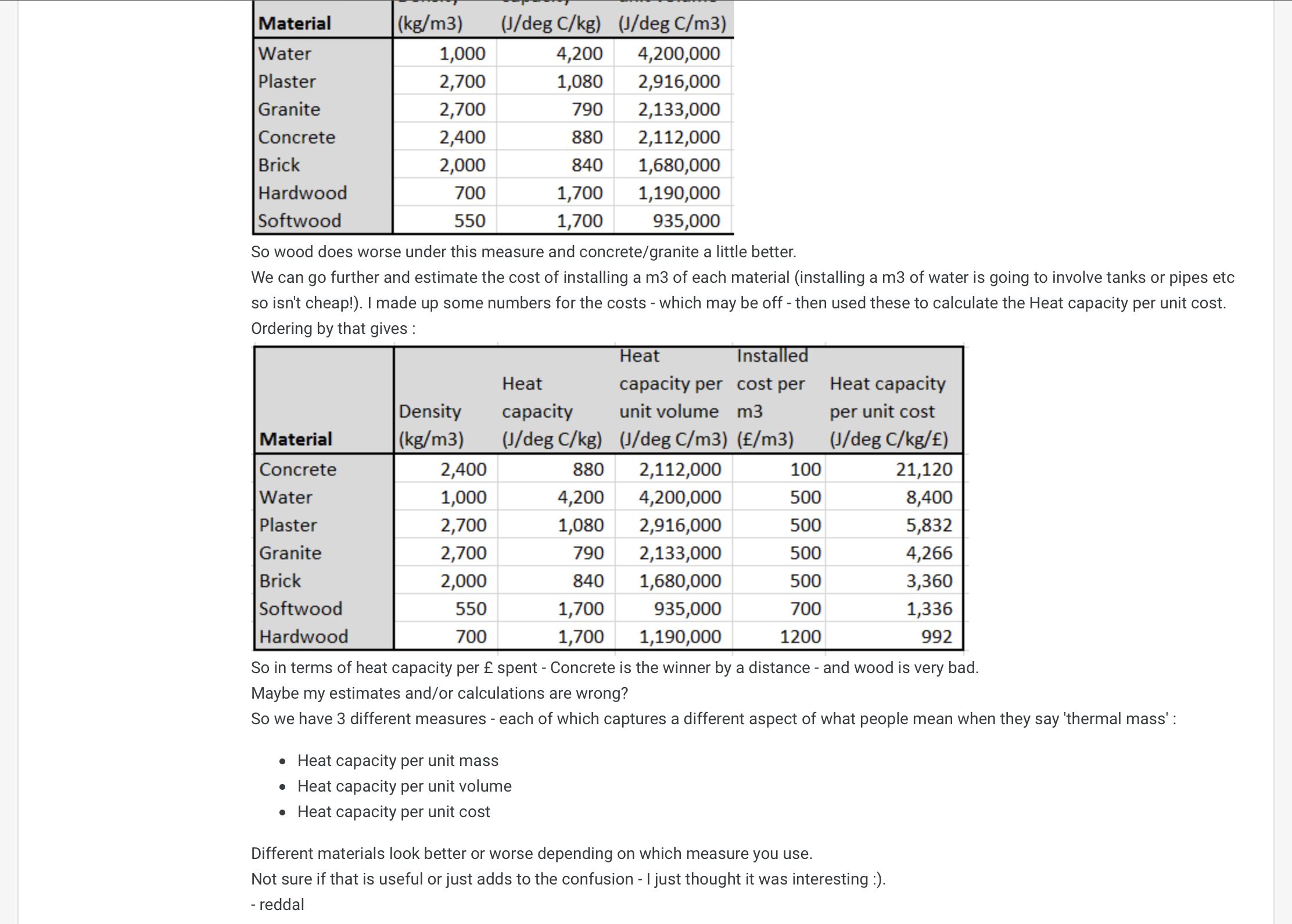

Hi Zac, I had a read, thank you. I don’t agree with Jeremy’s calculation based on Kg,
surely you must base your calculation on Volume.
top chart is Jeremy
second chart is justified correctly. Denser the material the better the conductivity and heat retention.
just my thoughts, common sense dictates that wood will store less energy compared to concrete/brick or steel.
