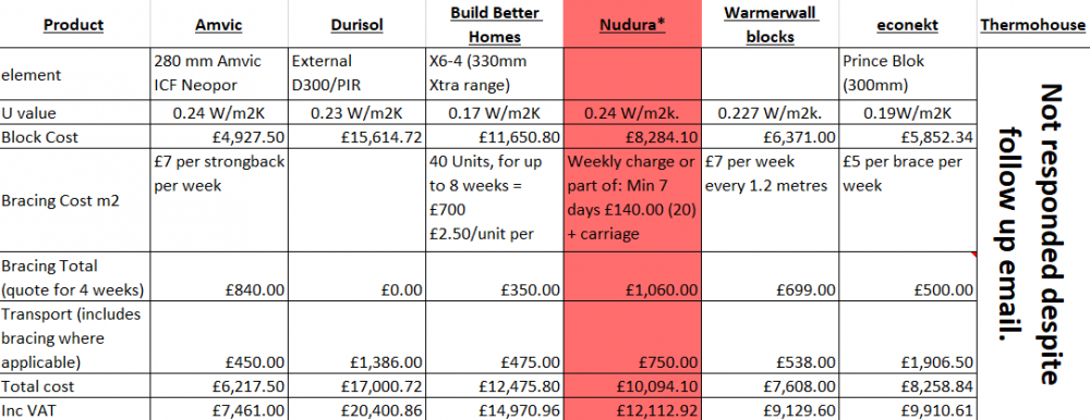

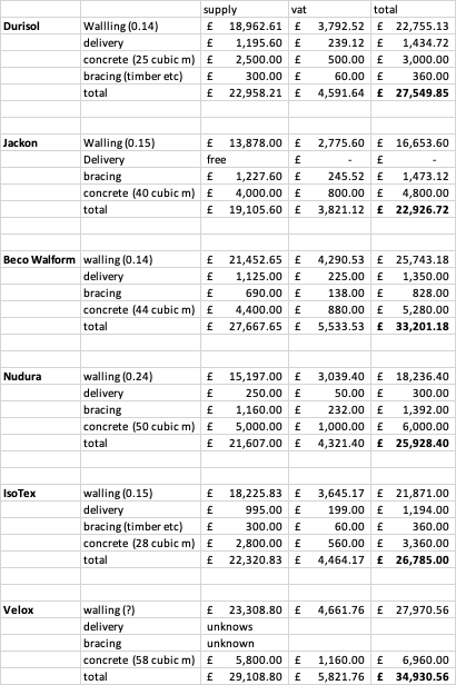

ZacP Posted September 17, 2020 Share Posted September 17, 2020 (edited) So all of the ICF quotes are in. I've tried to standardise them as much as possible, but some have interesting notes which I'll detail below. Putting this up for others who might find it useful in deciding their supplier or working out costs, but also for any feedback or thoughts from the more experienced (that's all of you!). Our build is approx 220sqm footprint and 260sqm of wall. Durisol includes a 22% discount that they put on without negotiation Beco Walform have quoted for the 375 but say the 313 would save around £8K (inc vat) and only increase the U value to 0.165 (though the published value is 0.18) so much better value Nudura say that a U value of 0.24 is plenty and anything more gets really expensive Velox includes the steel that goes inside the wall. I've included a price of concrete at £100+vat/cbm. This is a little on the high side, but it gives comparison. None of the quotes include rebar (if required [except Velox]) - would have to wait for SE calcs. Can anyone suggest an amount (in £ or quantity) that they used on their build? I know that we'll be able to reclaim the VAT on a new build but were costing things as a worst case scenario. Labor to construct I'm guessing at 9 days for 1+1+me: 2 days build, 1 day pour (lower ground). 3 days build 1 day pour (upper ground). 1 day build, 1 day pour (gables, finishing off etc). Hope that helps someone and thanks for your thoughts! Edited September 17, 2020 by ZacP 5 4 Link to comment Share on other sites More sharing options...
Alexphd1 Posted September 17, 2020 Share Posted September 17, 2020 Excellent thread for people considering icf. I didnt realise there was so big a difference in concrete quantity between different suppliers. Personally I am a big fan of nudara (only other icf I would have seriously considered was amvic) but I did feel nudara played the card that the extra u value was not worth it to make them more cost competitive in comparison to other suppliers as they where shipping the icf from the west coast of Canada which gave them a big disadvantage. We bite the bullet and added the extra insulation to nudara, I am happy with result. Will do homework on build 2 but hopefully be either nudara or amvic with 200mm extra EWI on the block (as @stones build in orkney). Link to comment Share on other sites More sharing options...
ZacP Posted September 17, 2020 Author Share Posted September 17, 2020 2 minutes ago, Alexphd1 said: Excellent thread for people considering icf. I didnt realise there was so big a difference in concrete quantity between different suppliers. Personally I am a big fan of nudara (only other icf I would have seriously considered was amvic) but I did feel nudara played the card that the extra u value was not worth it to make them more cost competitive in comparison to other suppliers as they where shipping the icf from the west coast of Canada which gave them a big disadvantage. We bite the bullet and added the extra insulation to nudara, I am happy with result. Will do homework on build 2 but hopefully be either nudara or amvic with 200mm extra EWI on the block (as @stones build in orkney). I didn't think about concrete either until I asked and realised there was quite a bit of variation. Guess it shows that the ICF with plastic/metal ties need more and the ones with internal and external panel connected by eps/woodcrete need less. Hadn't considered that was the reason fo the hesitation of providing a quote from Nudura for a lower u-Value. I guess a block that's almost twice as thick will need twice the shipping cost! Link to comment Share on other sites More sharing options...

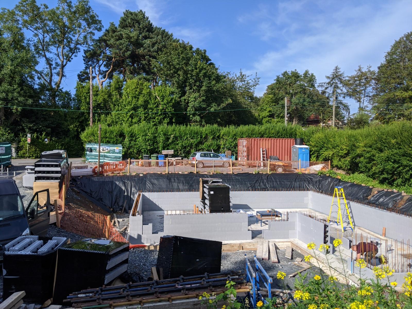

Conor Posted September 17, 2020 Share Posted September 17, 2020 (edited) Have you priced AMVIC? They came out cheapest - about 50% cheaper than NUDURA for reference once you factored in all the "extras". FYI we're in th emiddle of our basement assembly: Looking like 2 weeks from delivery of forms to concrete pour. Once you factor in the setting out of tracks etc (1 day alone), a full week for assembling blocks and doing rebar, and other 2-3 days bracing and setting up props and checks before the pour. That assumes you've no complicated or large openings. Builder started forms on our simple 100m2 basement on Monday, will be finished tomorrow lunch time, bracing the four openings in the afternoon and into next week assuming props arrive on Monday, with pour hopefully on Wednesday. Extra insulation will go on with the tanking the week after. Edited September 17, 2020 by Conor Link to comment Share on other sites More sharing options...

ZacP Posted September 17, 2020 Author Share Posted September 17, 2020 Thanks @willbish. What ICF did you use? I'm guessing that those like Jackon/Beco etc. that need rebar though the whole structure will cost more. Agreed on the u value, was a bit disappointed to think that Nudura might not have wanted to quote for a larger block size because of the transport costs. I could be wrong on that though. Link to comment Share on other sites More sharing options...
willbish Posted September 17, 2020 Share Posted September 17, 2020 I used Logix, think the block is called XRV6-8, the thickest block they do. As I understand for Nudura if you want to increase the U value they use a standard block with a larger concrete void, you then push EPS inserts in which reduces the concrete to a normal ~6 inch. Advantage of that is the plastic webs are close to outer face so good for fixings. Disadvantage is it's extra work pushing the inserts in. One self builder I visited mentioned it was a right pain and slowing him down a lot. Link to comment Share on other sites More sharing options...

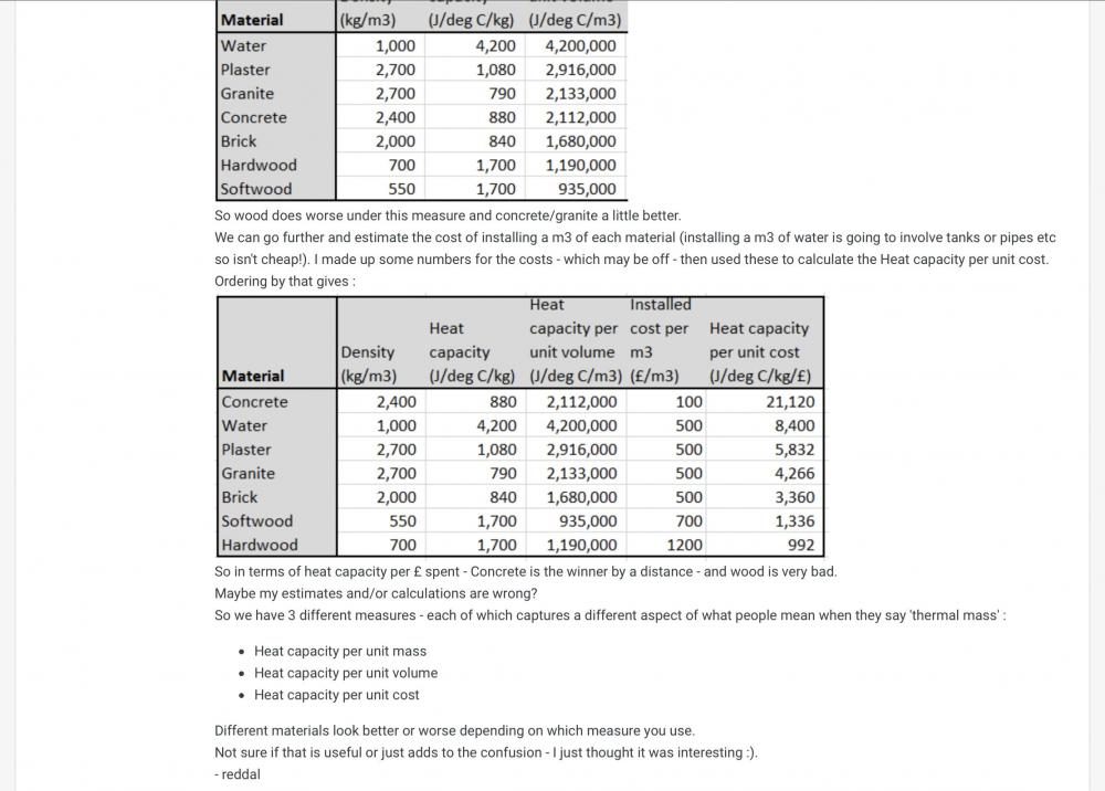

Conor Posted September 18, 2020 Share Posted September 18, 2020 14 minutes ago, ZacP said: @Conor interested to know why you put the PIR on the inside? Are you concerned with the thermal mass of the concrete bring outside the main thermal envelope? Doesn't really work like that - there's a very long thread with lots of formulae and arguments about this subject. The wall should be considered as a single thermal element, where the concrete is in the profile, doesn't really matter. It's an order of magnitude cheaper to put a 40mm sheet of PIR on the inside vs a 100mm sheet of EWI grade EPS on the outside. 2 Link to comment Share on other sites More sharing options...

Mako Posted September 29, 2020 Share Posted September 29, 2020 On 18/09/2020 at 13:04, Conor said: Doesn't really work like that - there's a very long thread with lots of formulae and arguments about this subject. The wall should be considered as a single thermal element, where the concrete is in the profile, doesn't really matter. It's an order of magnitude cheaper to put a 40mm sheet of PIR on the inside vs a 100mm sheet of EWI grade EPS on the outside. I was doing some research and been advised that in order to use the thermal mass properties of concrete you can’t really have any insulation material internally, ideally you need solid concrete face to get the best performance. If this was correct insulation applied internally would not help. would be interested to learn more, if there are other opinions out there. Link to comment Share on other sites More sharing options...
