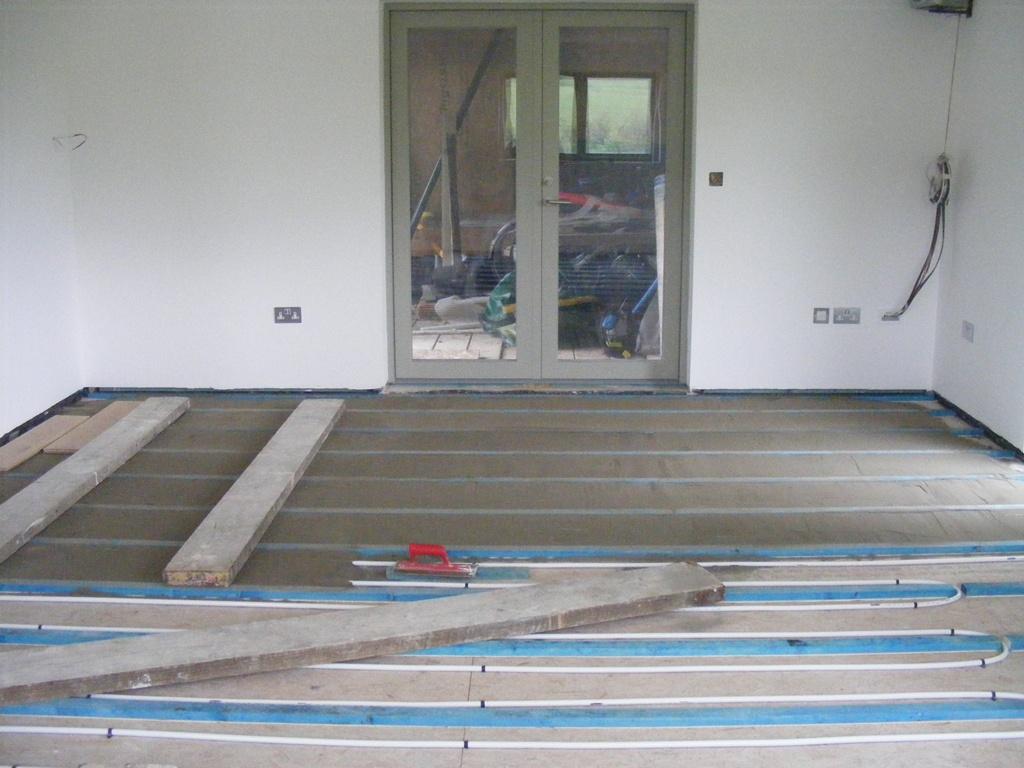

ProDave Posted September 9, 2020 Posted September 9, 2020 This is our UFH downstairs, but that is a suspended timber floor so no different to doing the same upstairs. that's OSB over the joists (just to support the biscuit mix) Battens following the joist lines. Buiscuit mix screed between the battens Then Oak engineered flooring went over the top. Insulation was between the joists. An alternative is to use aluminium spreader plates. 1
