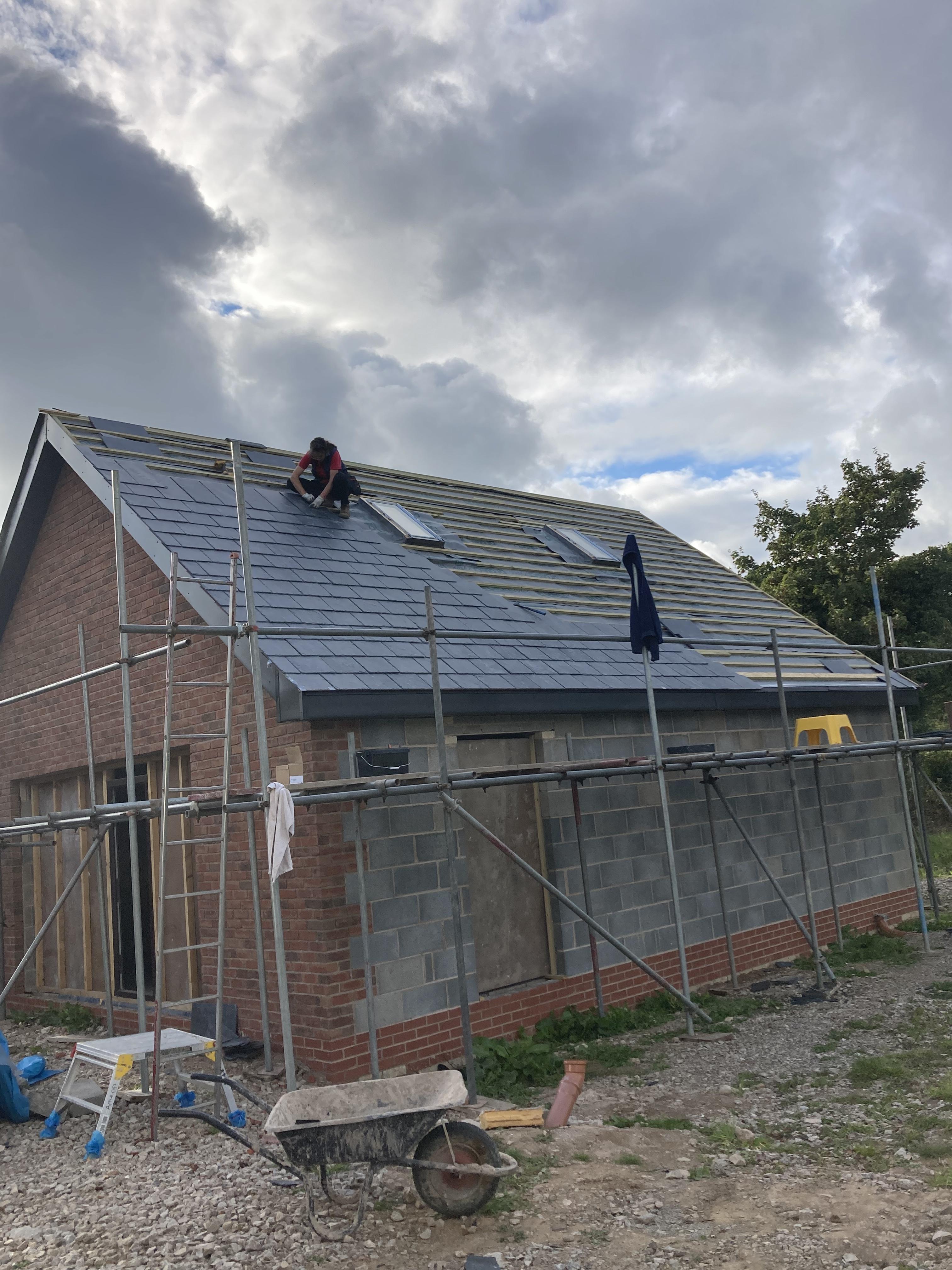

nod Posted September 8, 2020 Share Posted September 8, 2020 Is roofing Something most of us can’t tackle ourselves I had little experience in skating before myself and my wife slated our and the two double garages It took us about two weeks to do the house including the lead work and three day per garage We spent £150 on bumper hoist hire for a week I think there was around 300m2 The quotes we received had no baring to any kind of a day rate 12 -17 k both said allow 10% waste Rather than throw the bent slates off the roof I took nearly a 1000 back Saving about £1000 Something a roofer wouldn’t do 1 Link to comment Share on other sites More sharing options...

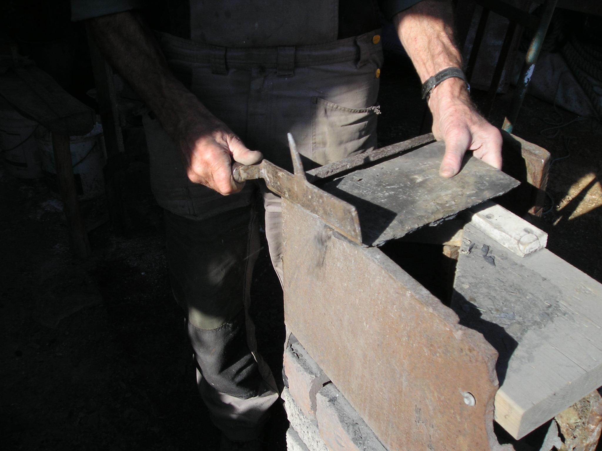

Cpd Posted September 8, 2020 Share Posted September 8, 2020 I did my own roof from scratch, got loads of old west coast slate for virtually nothing , me and my dad re cut all the edges with traditional slaters axes..... I then laid them in diminishing lengths to the top of the roof...... it took me months and months........ and months ? ..... it seemed fun at the time but All subsequent roofs on the property have been tin...... 2 Link to comment Share on other sites More sharing options...
nod Posted September 8, 2020 Share Posted September 8, 2020 My wife’s a theatre manager and frightened of heights But soon got into the slating 1 2 Link to comment Share on other sites More sharing options...
epsilonGreedy Posted September 23, 2020 Author Share Posted September 23, 2020 @nod what type of ridge tiles can I see in that photo? Everyone I speak to locally suggests I use angled slate ridge tiles with the pronounce lip but I do not like the aesthetic result from a distance. Link to comment Share on other sites More sharing options...

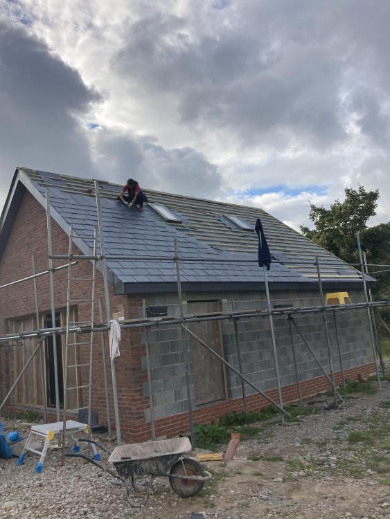

nod Posted March 3 Share Posted March 3 On 08/09/2020 at 17:29, nod said: My wife’s a theatre manager and frightened of heights But soon got into the slating Five years on my wife become a bit of an expert I broke my hand whilst battening out our workshop and was only able to cut and carry the slates So she was left to slate it herself 1 Link to comment Share on other sites More sharing options...
