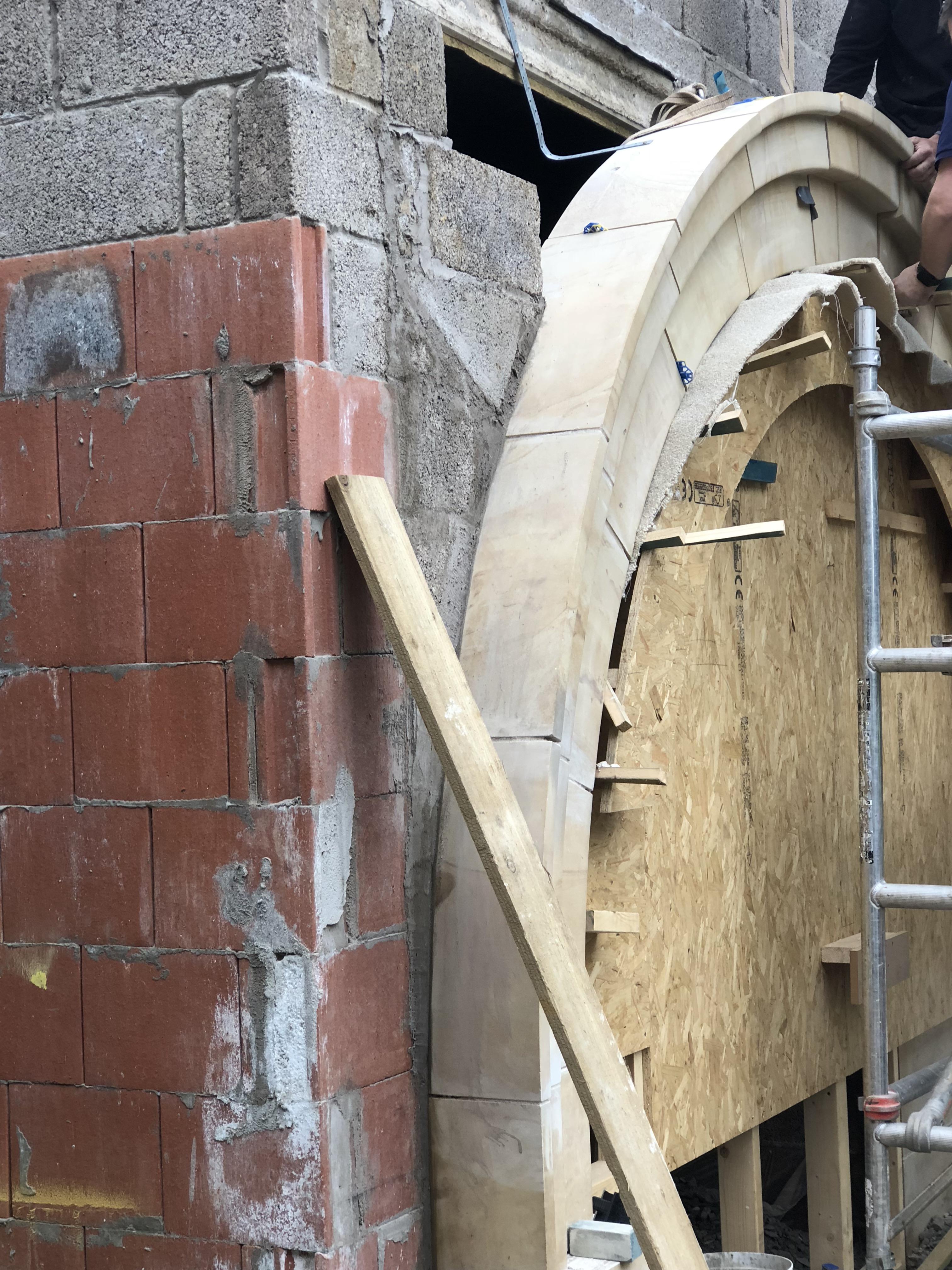

AliG Posted May 28, 2018 Author Share Posted May 28, 2018 (edited) Almost there, they are mainly doing landscaping and snagging. They seem to have left this pain in the neck job to the end. We went out today with one of the pieces of stone hanging from a forklift as they manoeuvred it into place. They had 4 men plus the forklift. I realised they will have to do just 2 blocks a day and let the mortar set. Of course they said it would take three days, but they started the week before last. The archway started off narrower in the first design sketches, but I asked for it wider. Our old house had a similar arch with narrower proportions. Edited May 28, 2018 by AliG Link to comment Share on other sites More sharing options...

Cpd Posted May 29, 2018 Share Posted May 29, 2018 As a stonemason I can fully appreciate this part of the works. I once built a stone road up to a lighthouse and each stone came in at about 700kg we were aiming for <3mm gaps and it all takes a long time. Looking great man. Link to comment Share on other sites More sharing options...
AliG Posted May 30, 2018 Author Share Posted May 30, 2018 Thanks @Cpd They did a dry fit of the last few pieces of the arch today. Link to comment Share on other sites More sharing options...
Mr Punter Posted May 30, 2018 Share Posted May 30, 2018 Is that a mix of Poratherm type and concrete blocks and if so why? Link to comment Share on other sites More sharing options...
AliG Posted May 30, 2018 Author Share Posted May 30, 2018 (edited) The house is basically built entirely from Porotherm. But they have occasionally used concrete blocks where the strength is useful. They are tying the sandstone blocks into the blockwork and it is a lot easier to attach things to concrete blocks than Porotherm. As it is in a porch it doesn't make matter in terms of insulation. All the blocks that you can see are fully outside walls. That area was also built after the main house. As an aside, I ultimately think that the Porotherm may have been a waste of time and money. Although it is better insulated than concrete blocks, the difference is quite marginal and the builders find blocks easier to work with. If I was building again I would either try to use ICF which is what I originally wanted to use or full fill blockwork cavity. I have not fully looked into the full fill cavity option which I didn't explore as I didn't think that they would allow it is Scotland, now I am not so sure. I reckon full full cavity is likely to have a lot less issue with gaps and air getting into the insulation than the Celotex that we have used. Another house has been built at the opposite end of the road at the same time as mine. It is timber frame with a blockwork skin. It has an enormous number of perpend vents in the walls. I am certainly glad that I don't have them. Edited May 30, 2018 by AliG Link to comment Share on other sites More sharing options...

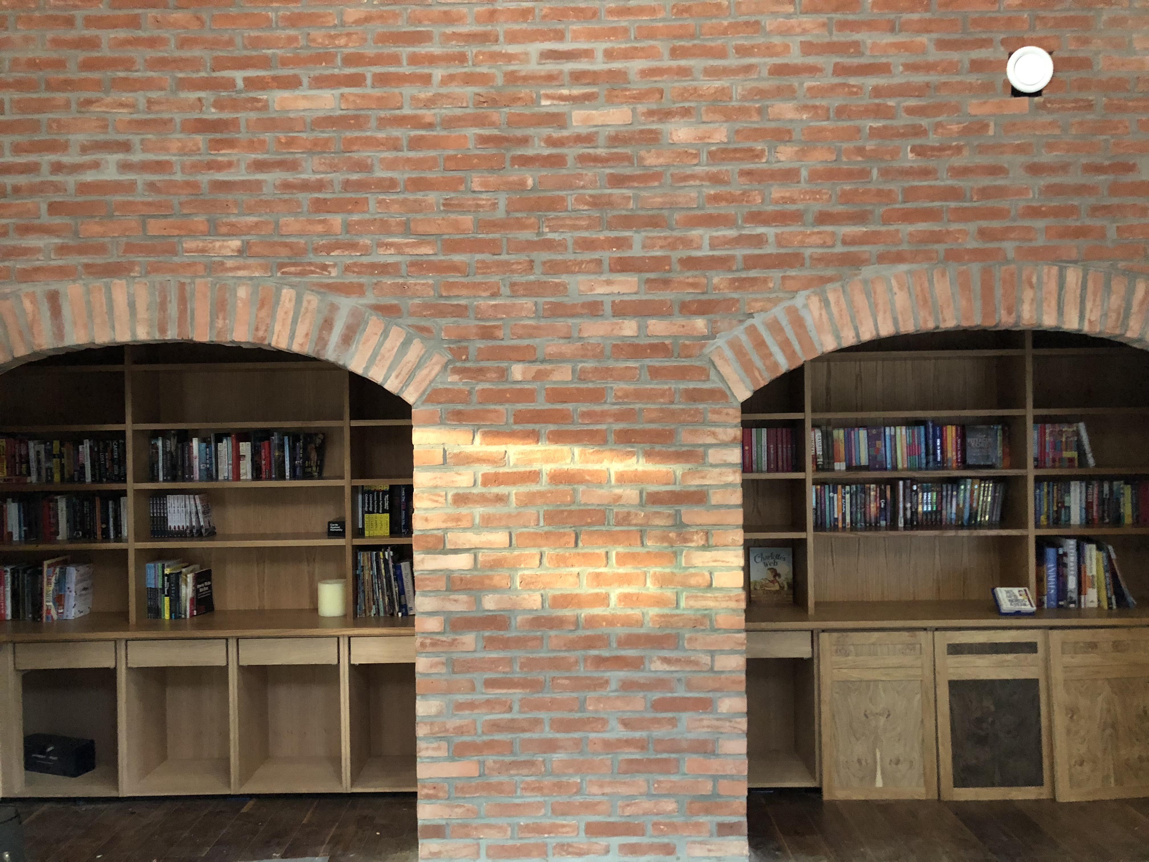

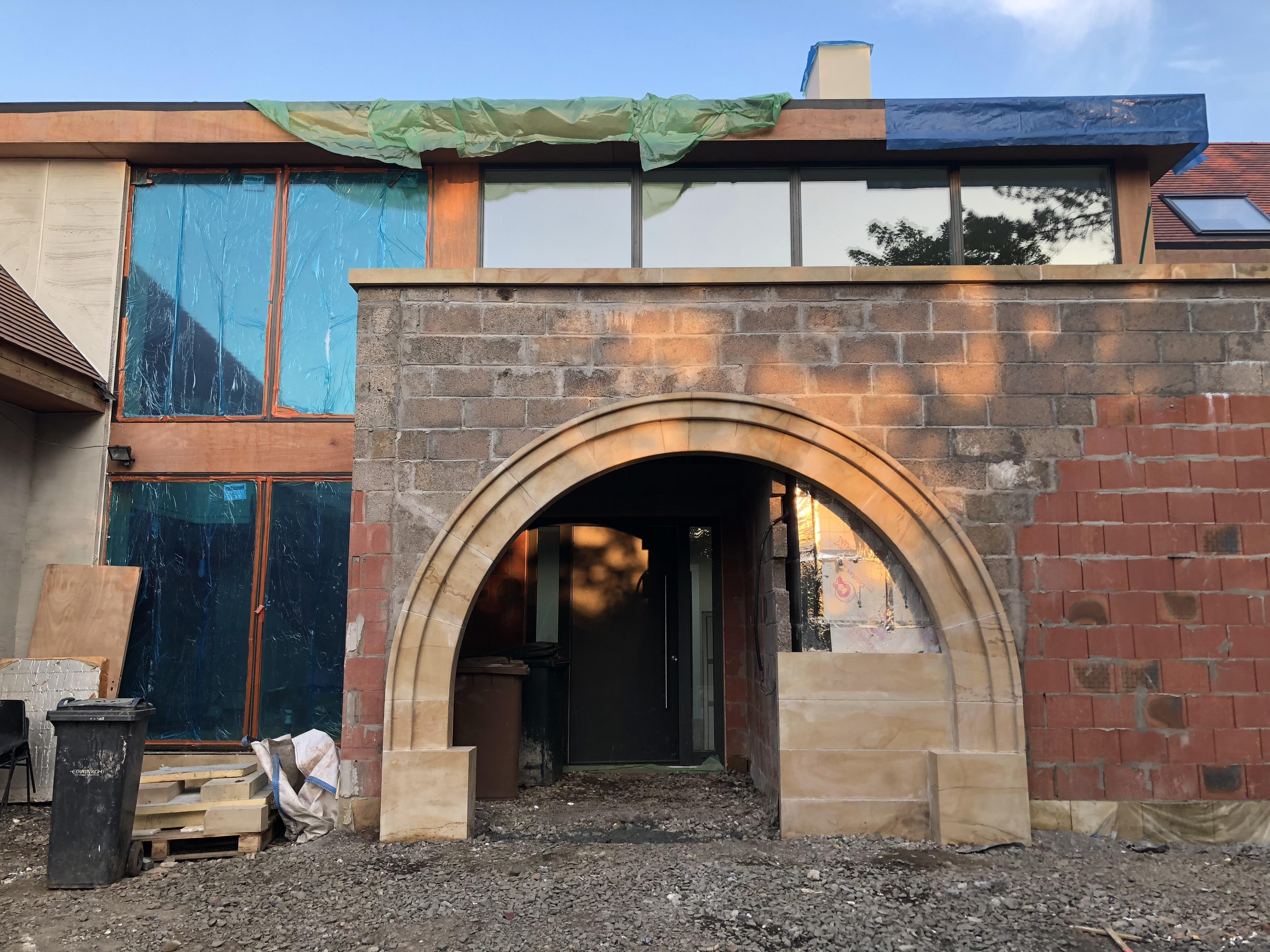

AliG Posted June 9, 2018 Author Share Posted June 9, 2018 The archway is finished so we can use the front door again. They do need to finish the front face. We can now finish the render off. Our fitted bookcases are in, we have to choose one of those three door finishes. 5 Link to comment Share on other sites More sharing options...
Onoff Posted June 9, 2018 Share Posted June 9, 2018 (edited) Be a pity to render that brickwork over the bookcases! Edited June 9, 2018 by Onoff 1 Link to comment Share on other sites More sharing options...
AliG Posted June 9, 2018 Author Share Posted June 9, 2018 Those brick slips are attached direct to the Protherm, so we have a very solid feeling fake brick wall. They went a bit overboard with the pointing so it needs to be cleaned off. Link to comment Share on other sites More sharing options...

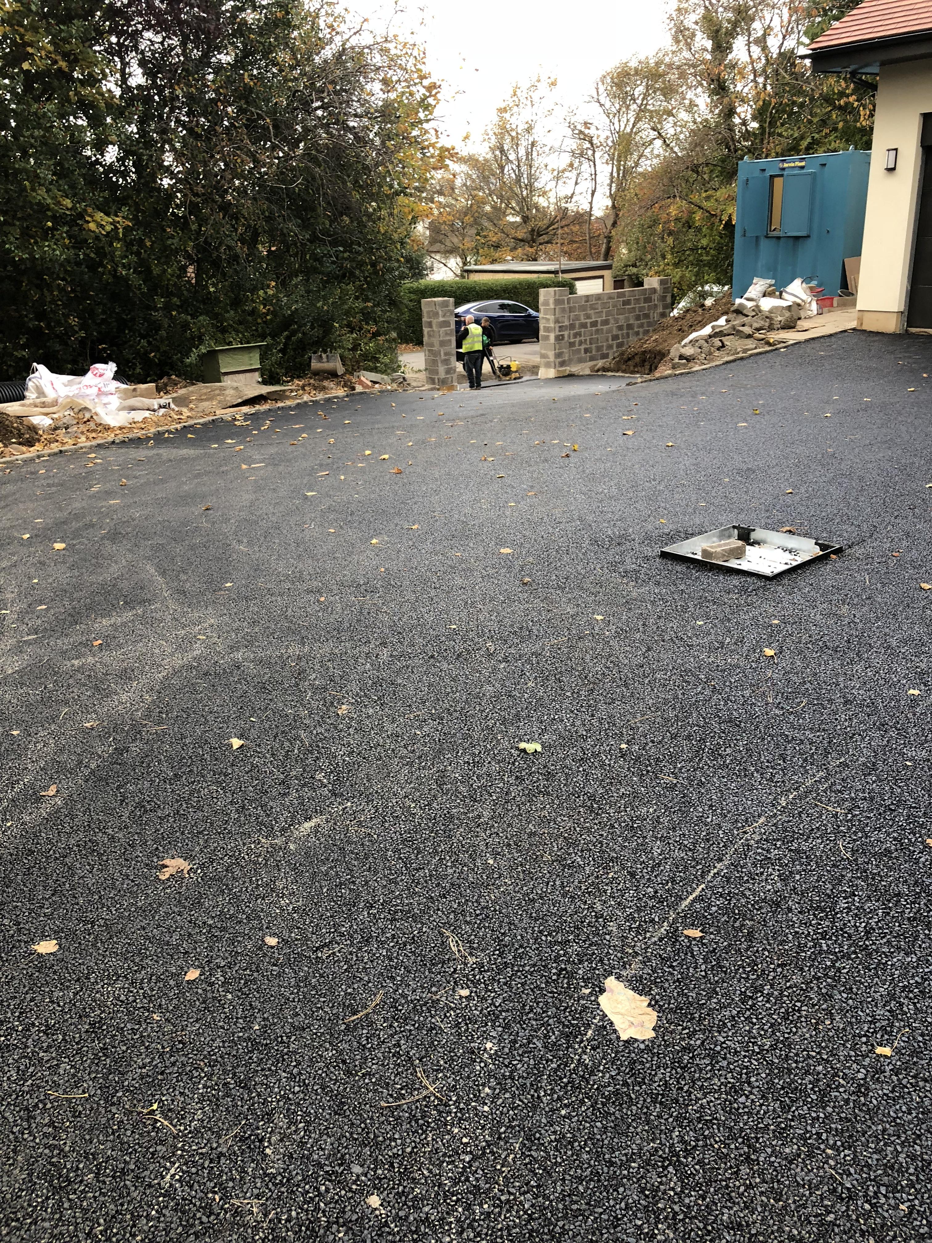

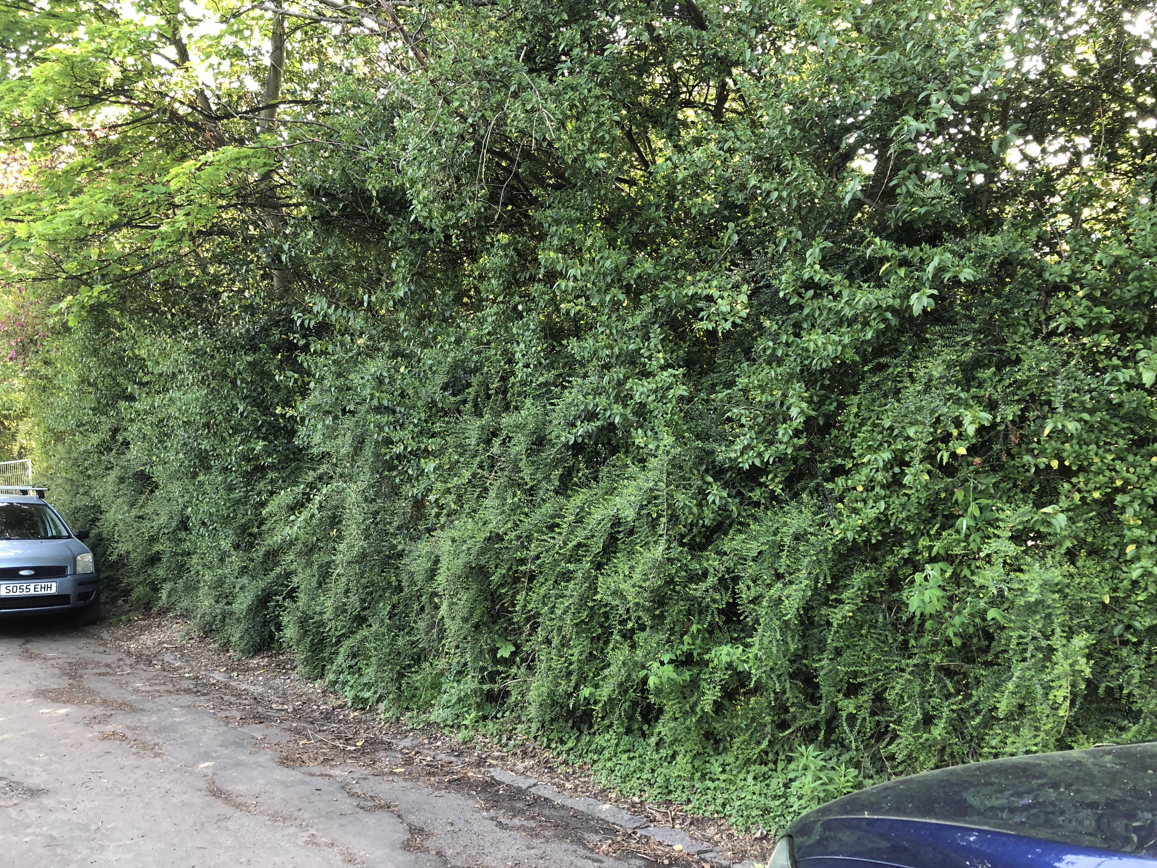

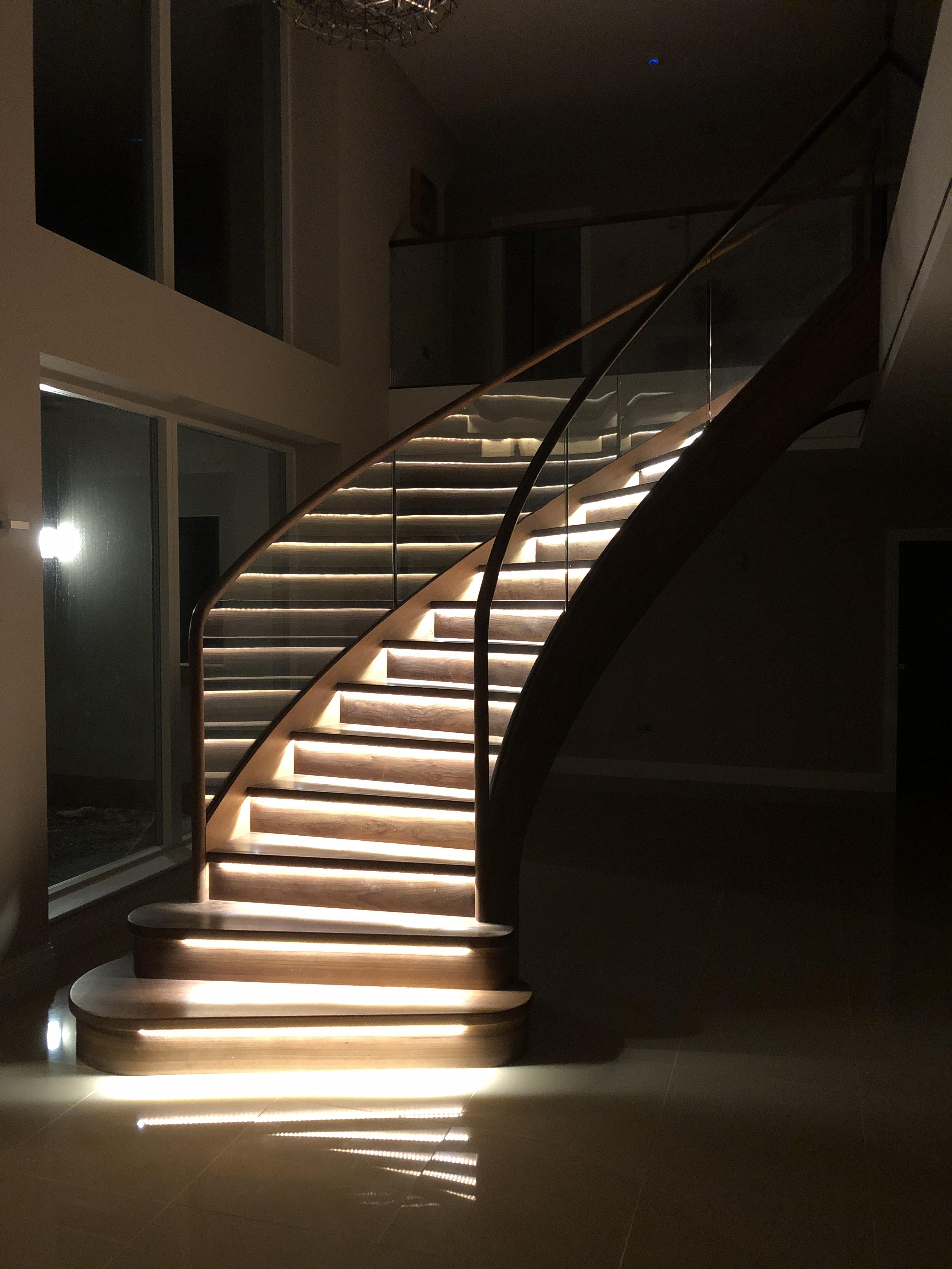

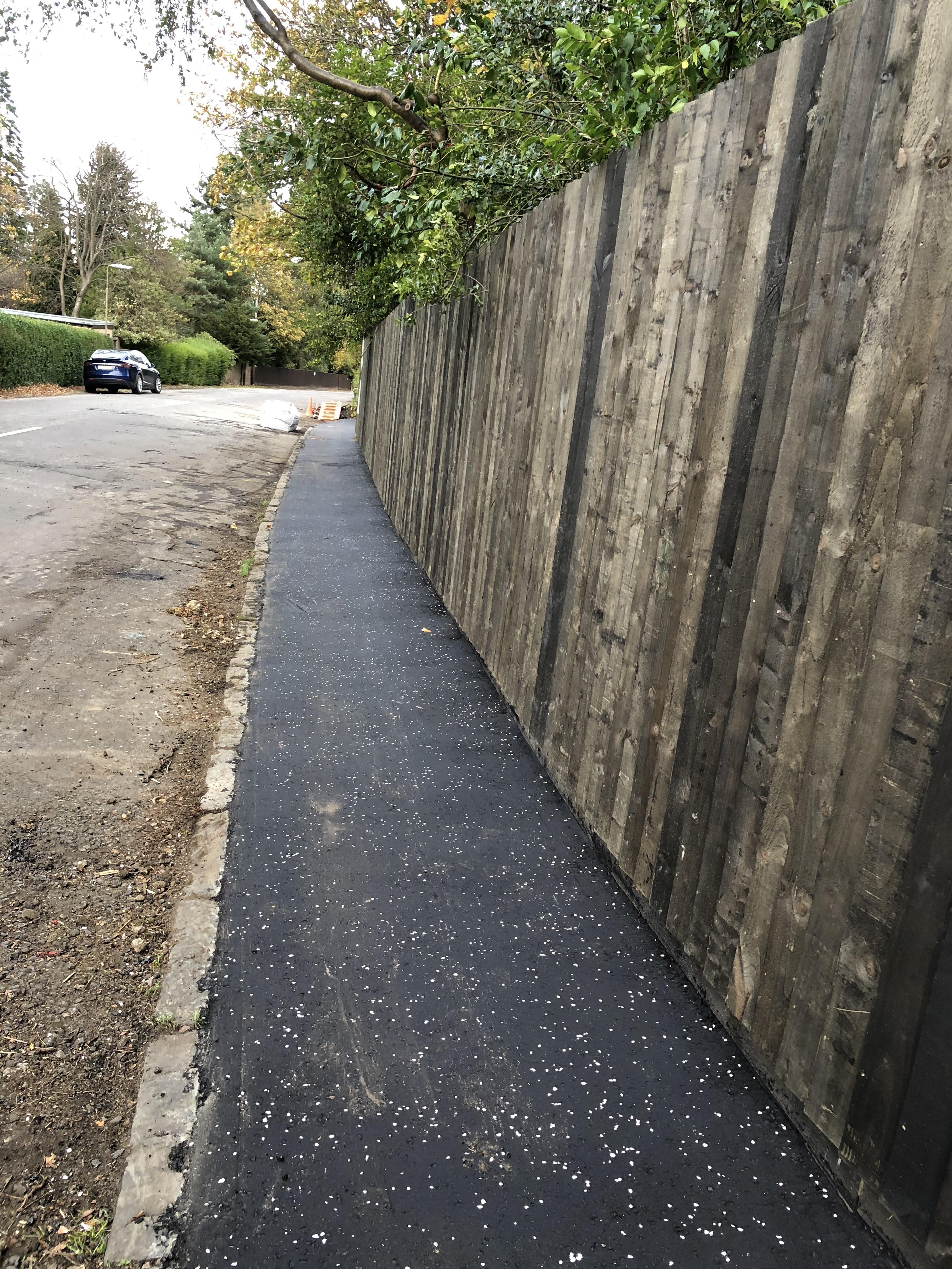

AliG Posted October 25, 2018 Author Share Posted October 25, 2018 (edited) I had hoped we would be finished by now and I would do a photoshoot of the house, but it is dragging along. We are mainly doing landscaping and snagging. We finally have a driveway, the resin bound top still has to go on. They seem very intent on us taking a specific colour and we are suspicious that is just what they have readily available so have refused to install it until we see more samples. I hated the untidy bush along the road in front of the house, I thought it really let the place down, so I applied to build a new fence and then we tarmaced the pavement. Hopefully the neighbours are enjoying their nice new pavement. The lights are connected up on the stairs and I think they just look fantastic. Driveway, gates are also going in. Pavement and hedge before we tidied it up New pavement and fence Stairs Edited October 25, 2018 by AliG 7 Link to comment Share on other sites More sharing options...
lizzie Posted October 25, 2018 Share Posted October 25, 2018 Love the stairs! 1 Link to comment Share on other sites More sharing options...
newhome Posted October 25, 2018 Share Posted October 25, 2018 Stairs are stunning! 1 Link to comment Share on other sites More sharing options...
Simplysimon Posted October 25, 2018 Share Posted October 25, 2018 could see Fred and Ginger coming down those! Link to comment Share on other sites More sharing options...
AliG Posted October 25, 2018 Author Share Posted October 25, 2018 I'd probably be more Stan and Ollie! 1 Link to comment Share on other sites More sharing options...
vivienz Posted October 27, 2018 Share Posted October 27, 2018 Gorgeous! Link to comment Share on other sites More sharing options...
Mr Punter Posted October 27, 2018 Share Posted October 27, 2018 Tarmac.. yawn Fence.. zzz Hedge... whatever Stairs... Just beautiful! Link to comment Share on other sites More sharing options...

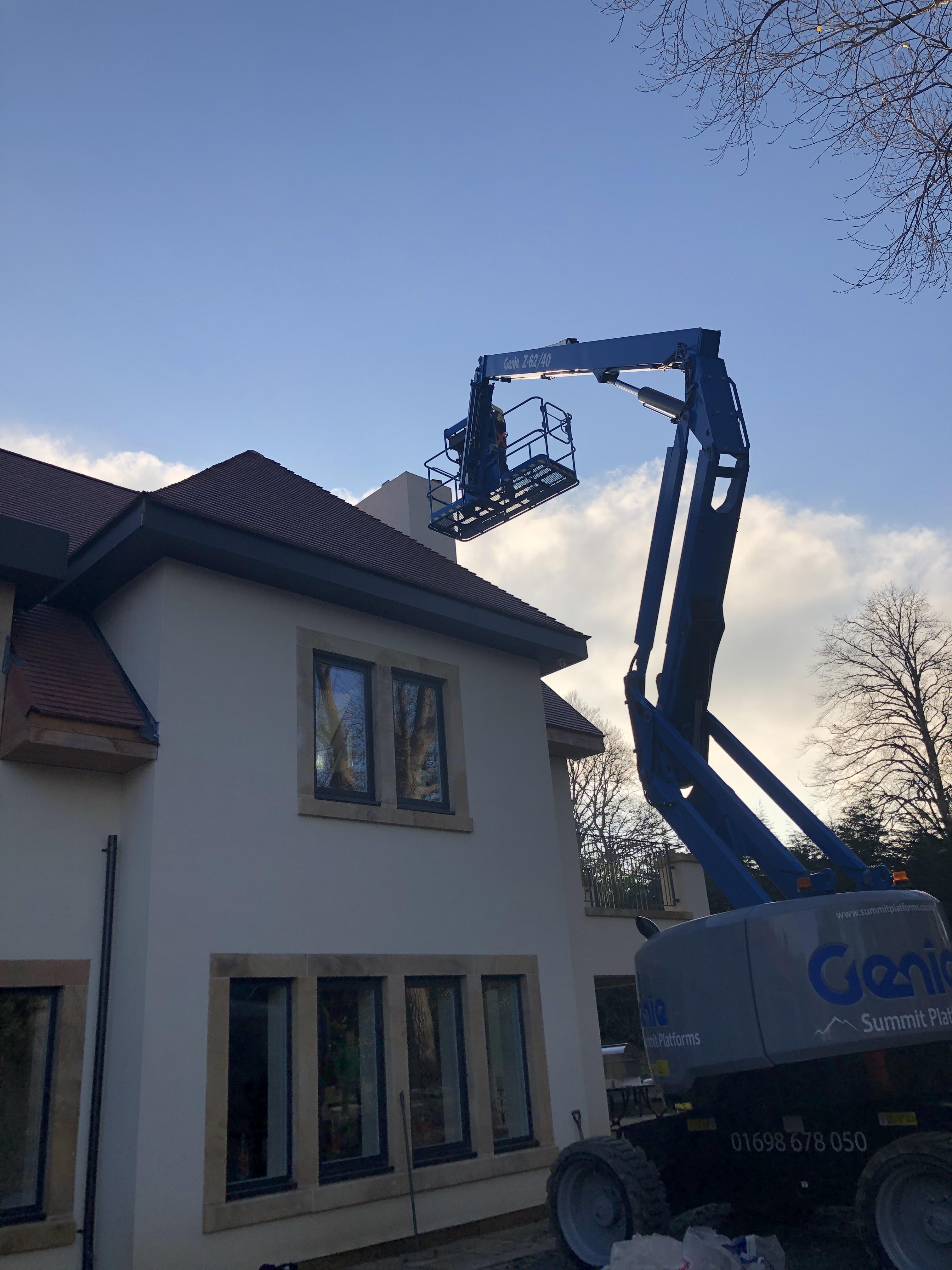

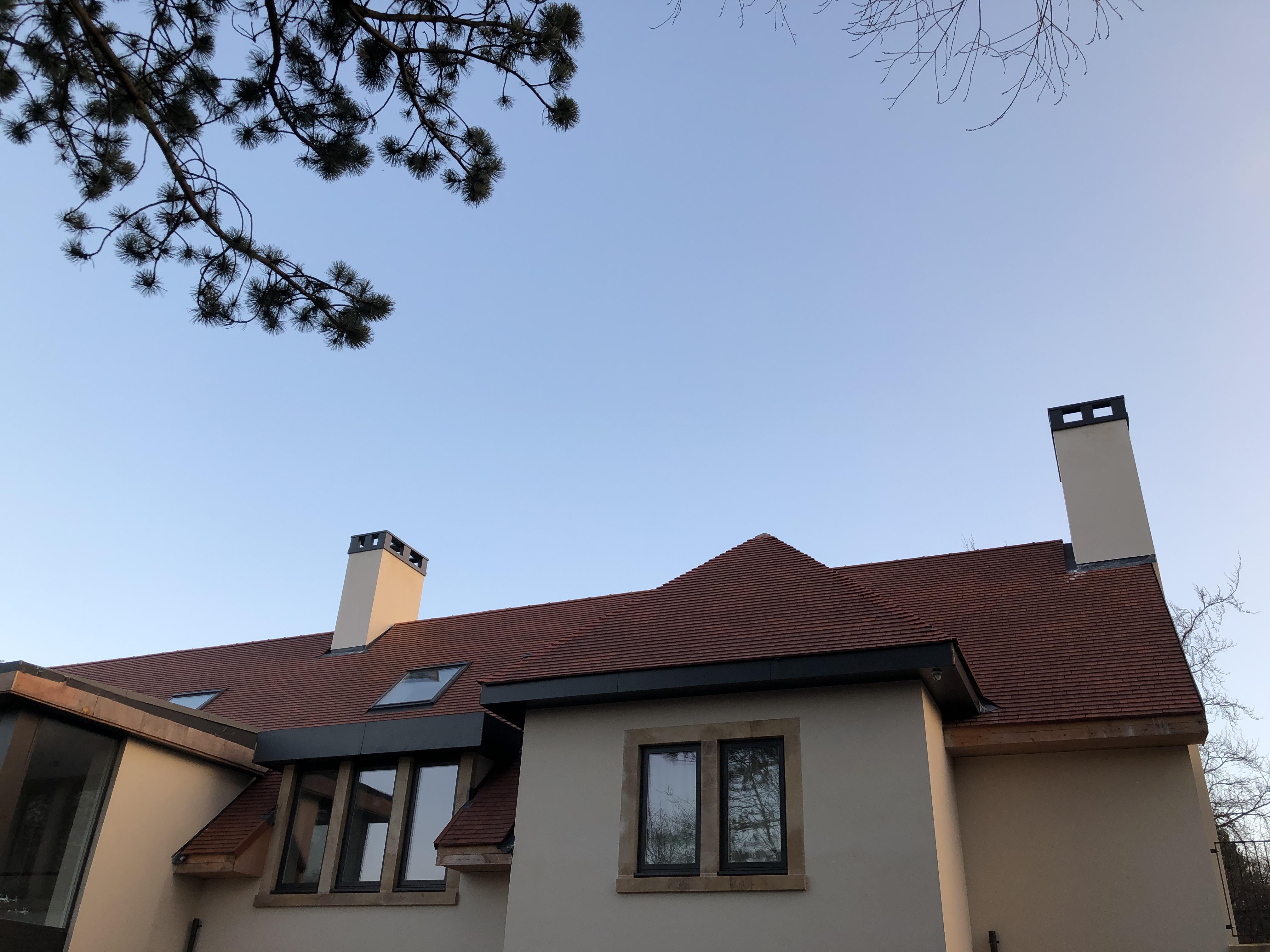

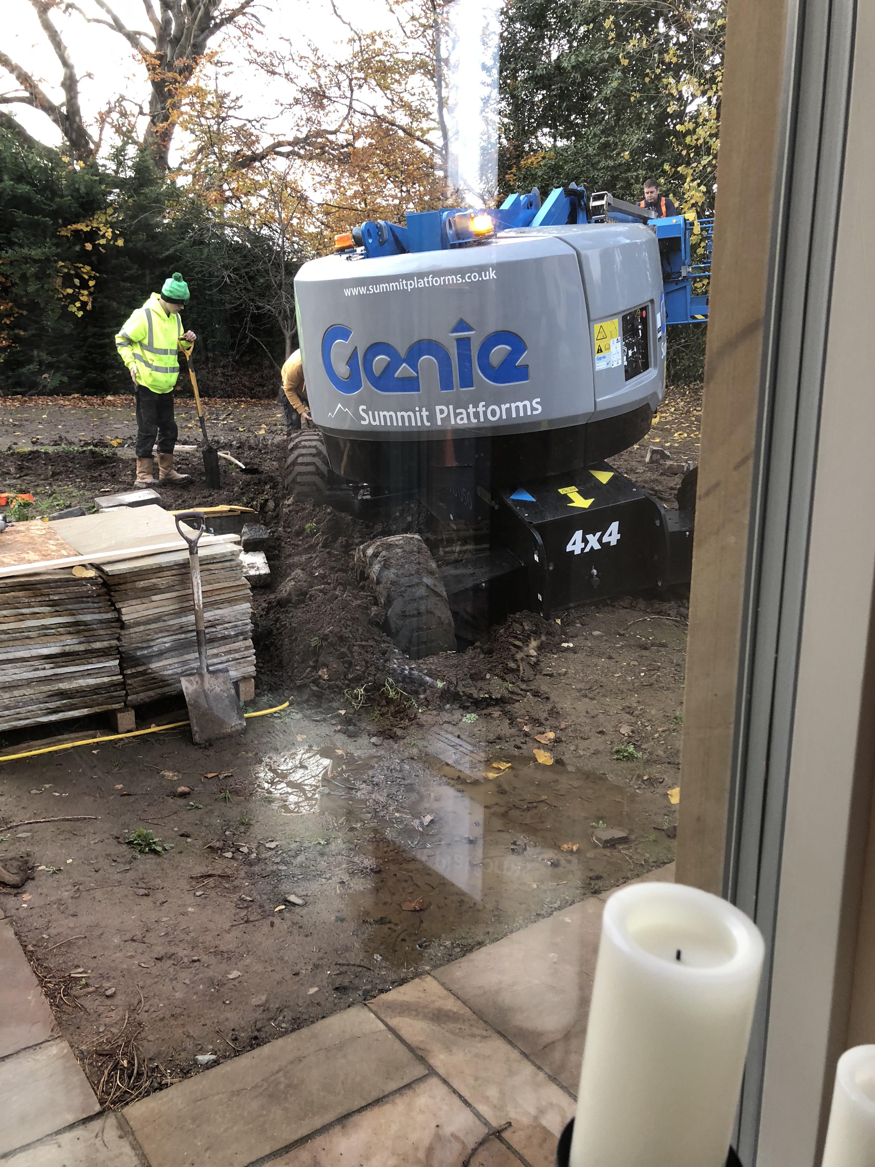

AliG Posted November 18, 2018 Author Share Posted November 18, 2018 (edited) Can’t believe that we still aren’t quite finished. Have to report on a recent comedy of errors. The builder decided he would use a cherry picker to put the tops on the chimneys so he could get all the scaffolding down. The chimneys are pretty high up at 13m and have large aluminium tops that match the windows and soffits/fascias. So in comes an enormous cherry picker. They manage to have it sink into the garden. So then they bring in artic to tow it out. The artic can’t turn around in the driveway and backing it out they hit the gate pillars that they had built less than a week earlier. Eventually they got up and put the tops on. Yesterday doing the second one they got stuck 13m in the air when the weight alarm went off on the cherry picker. I only knew because I looked out of the window and saw the joiner who had gone home earlier outside fiddling with the machine. Eventually we got them down once we figured out how to use the emergency battery power. Edited November 18, 2018 by AliG Link to comment Share on other sites More sharing options...
Onoff Posted November 18, 2018 Share Posted November 18, 2018 Lucky it didn't topple into the house. Nasty bloody things! Link to comment Share on other sites More sharing options...

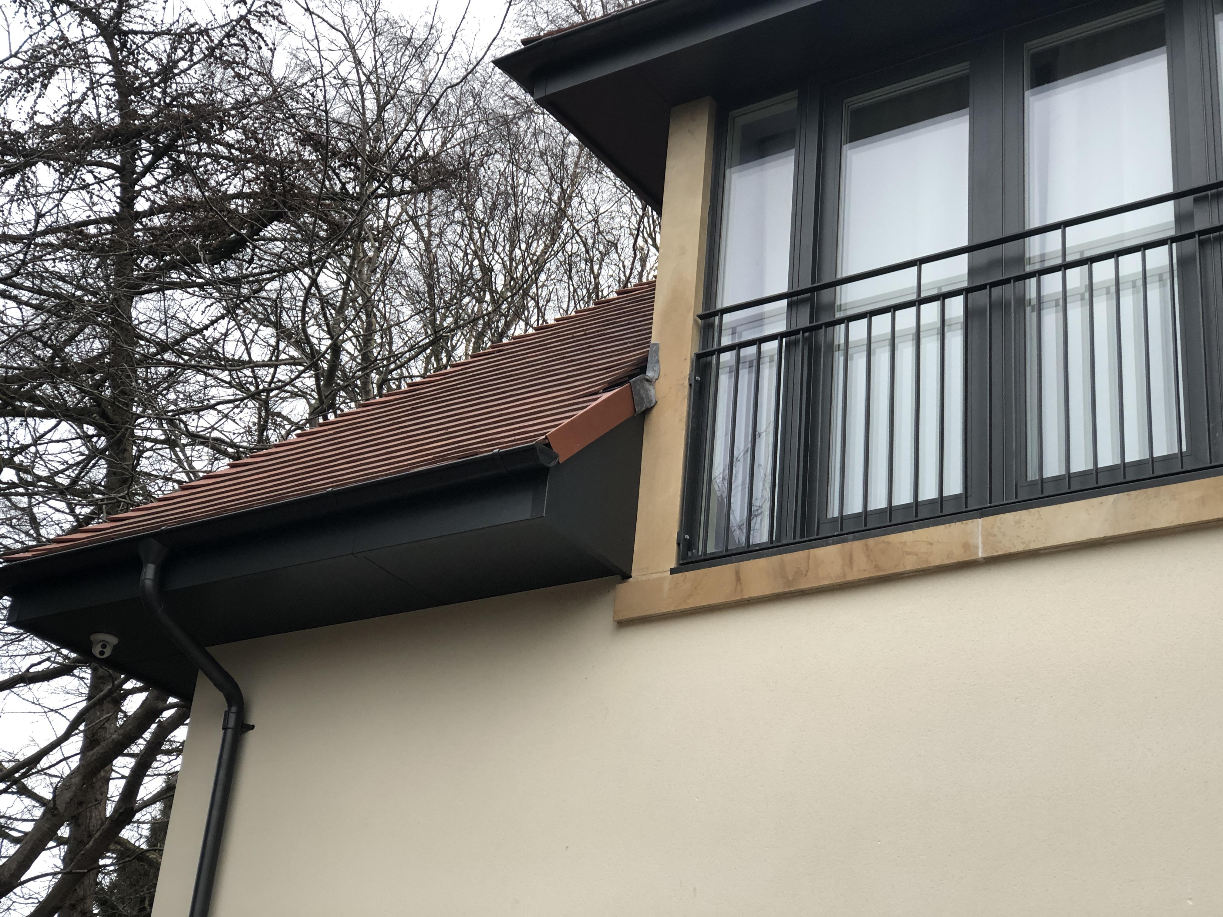

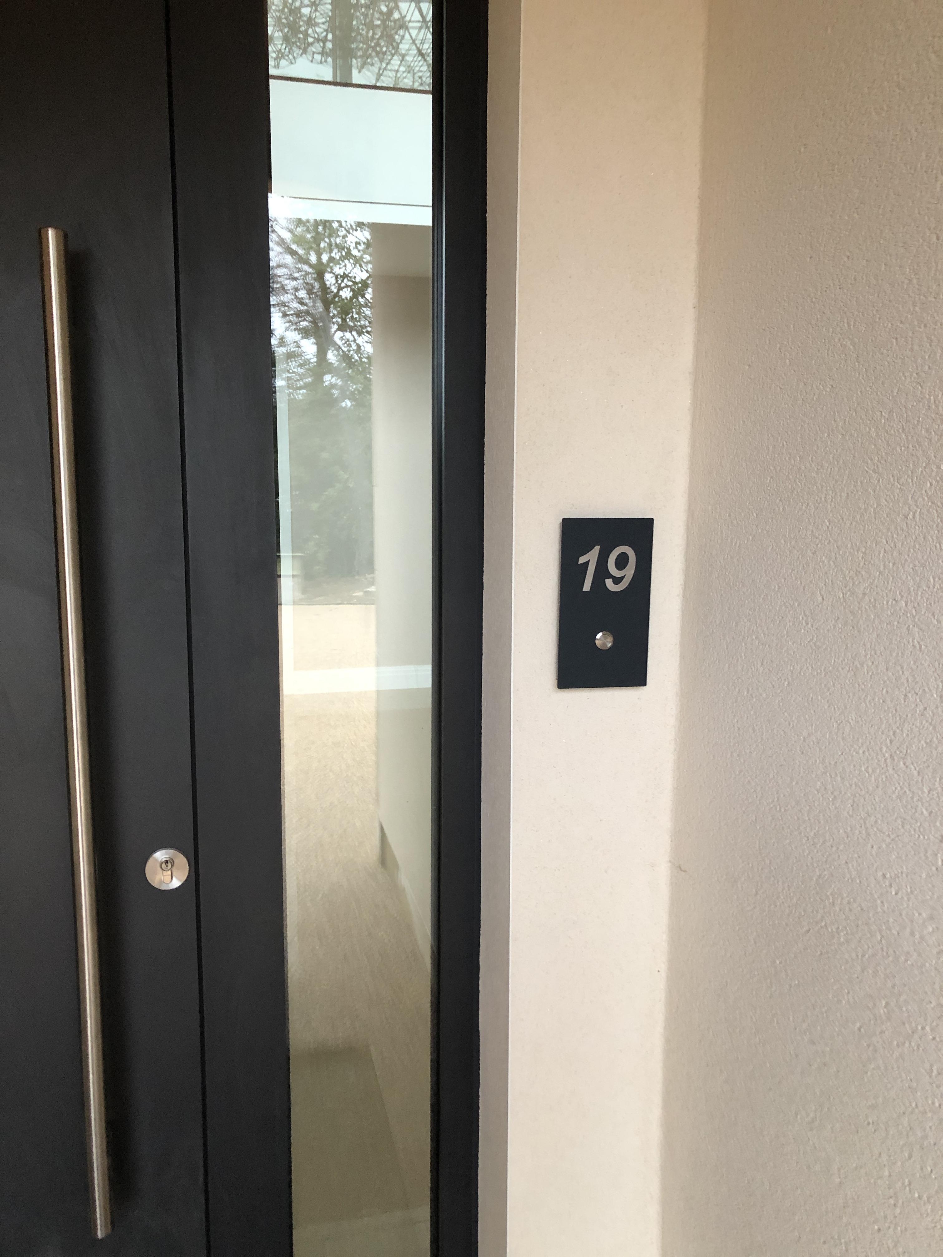

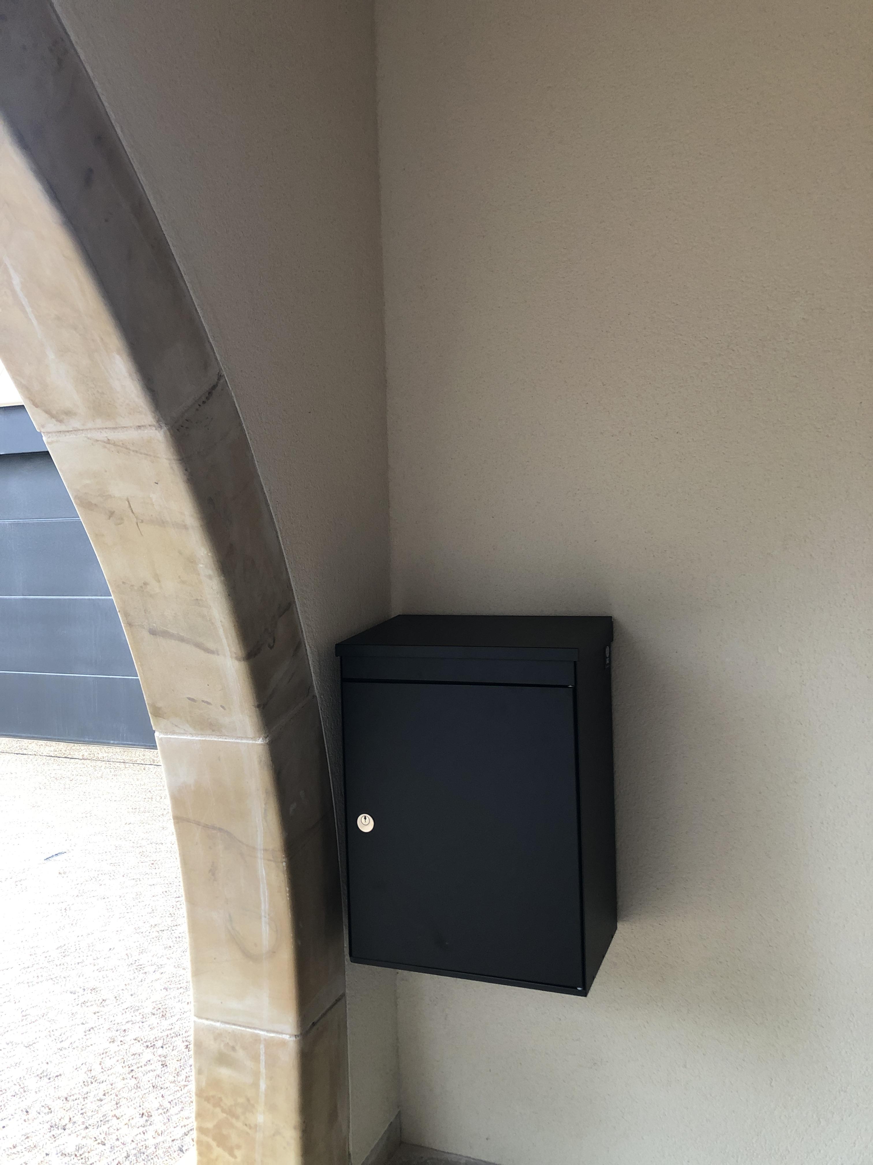

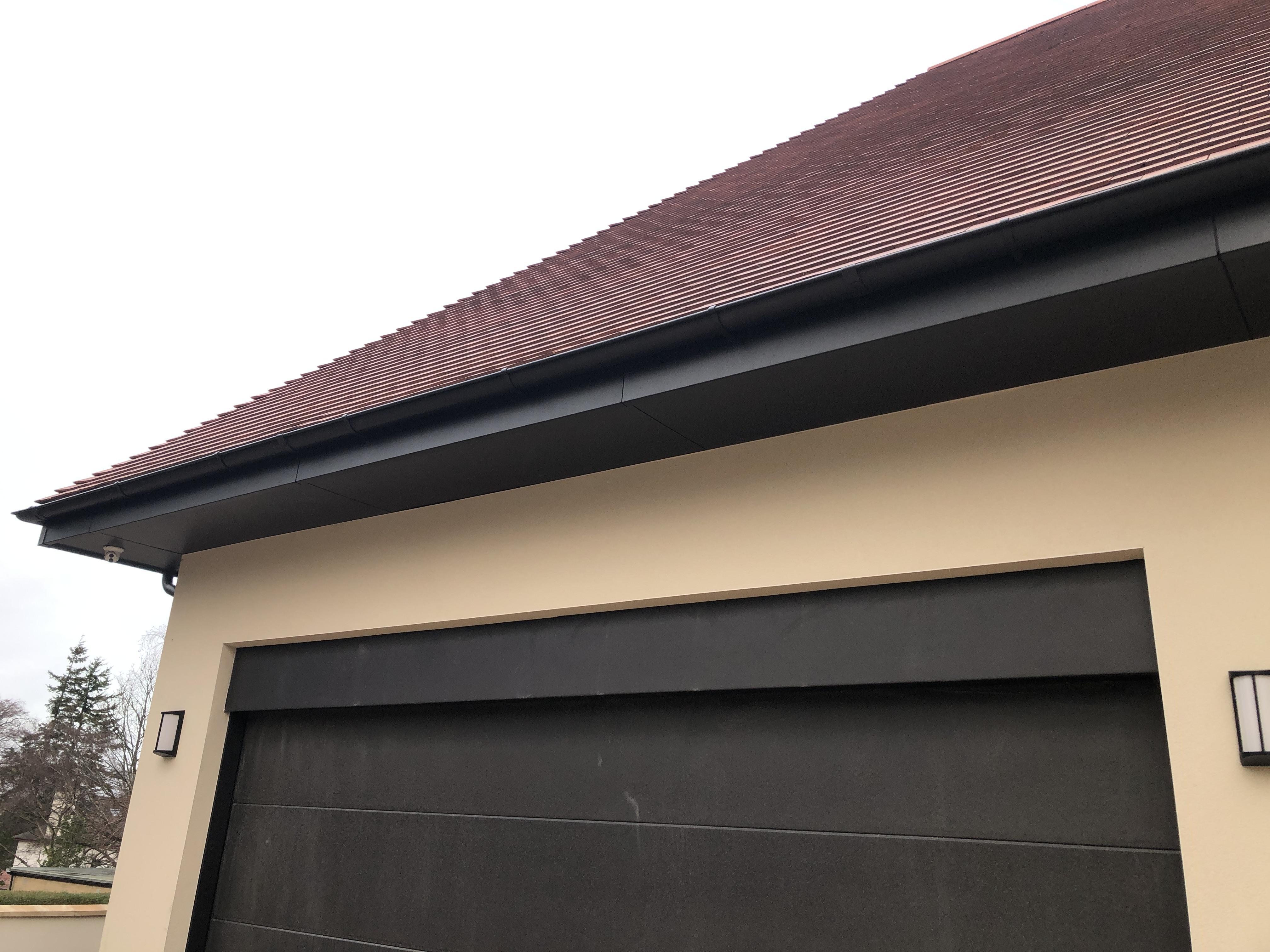

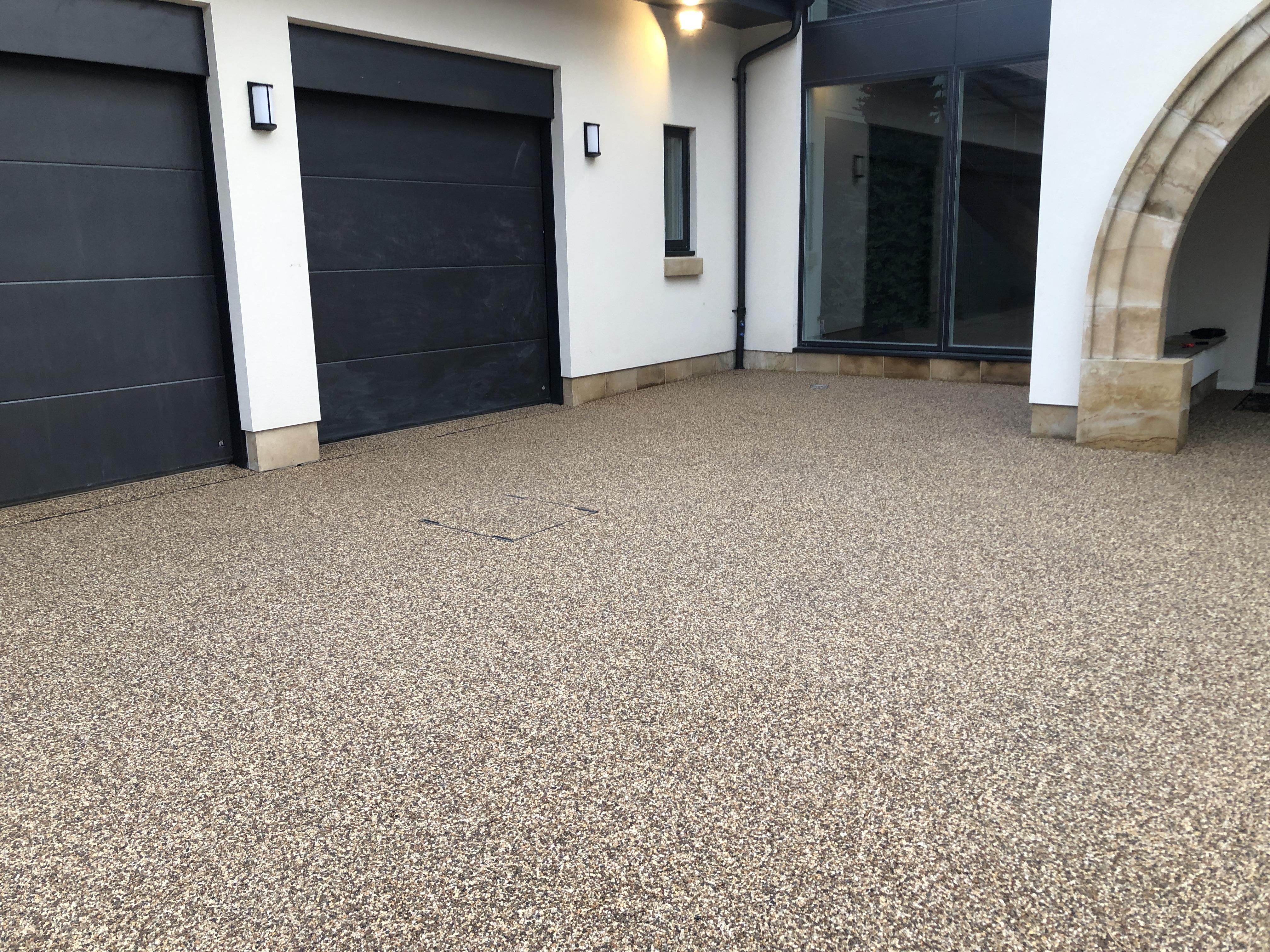

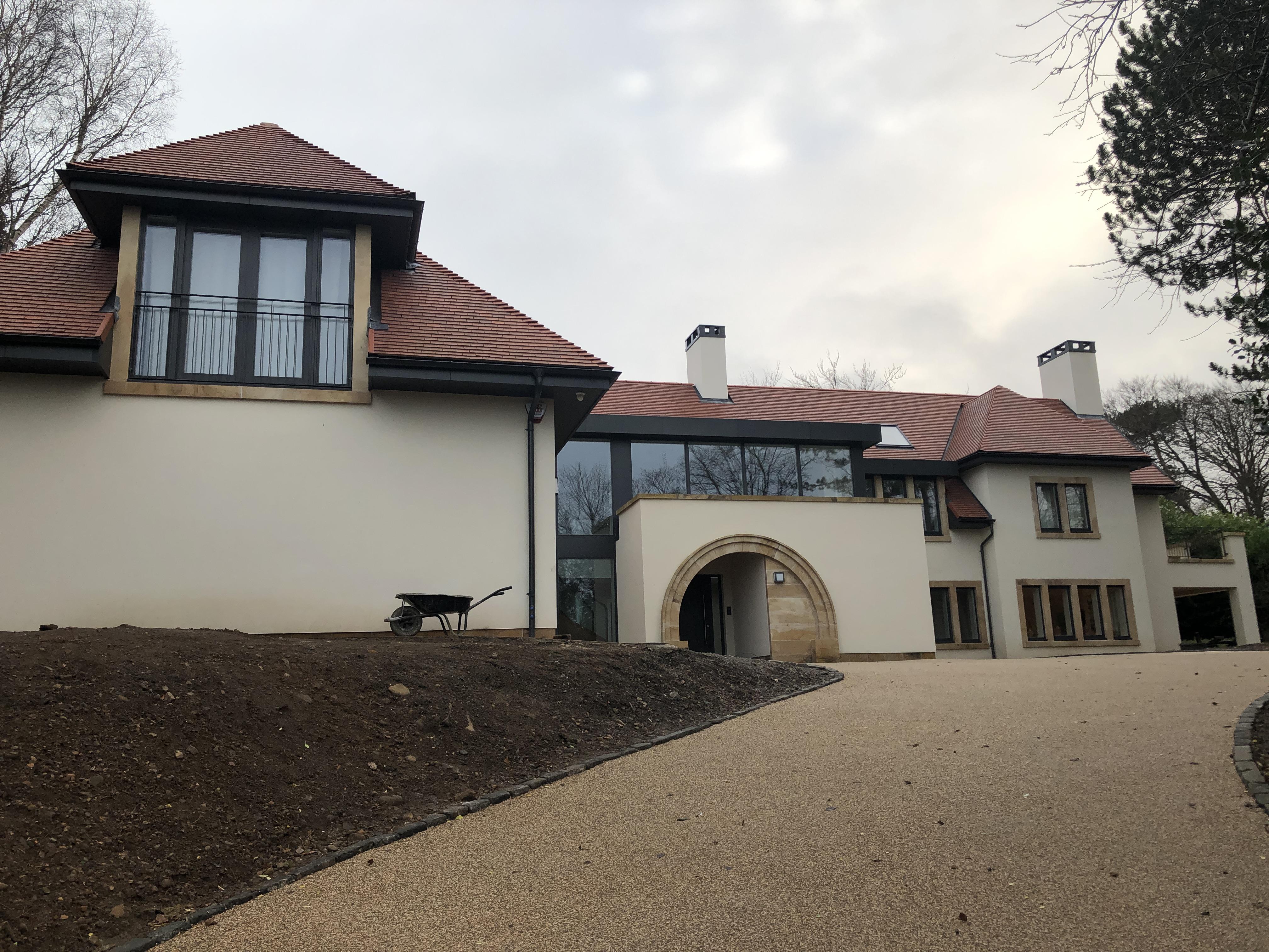

AliG Posted January 12, 2019 Author Share Posted January 12, 2019 (edited) The driveway has been laid and I think they have done a fantastic job. I have also finally got around to putting up a postbox and a doorbell. I got the doorbell from a company called Metzler Trade that sells on Amazon and its own website, a lovely quality item. It always disappoints me when people have little plastic doorbells. I forgot to include power for the bell so put a Grothe wireless bell behind it. All the gutters, soffits and fascias are finished. We also framed around the garage doors in matching aluminium. This is an area that is usually just painted wood and starts to blow after a while. The builder just has a smallish list of things to finish off. Finally we can get the walls and doors washed down, I didn't see any point before the drive was down. The landscapers want to start in a couple of weeks now also which is good. Edited January 12, 2019 by AliG 7 Link to comment Share on other sites More sharing options...
newhome Posted January 12, 2019 Share Posted January 12, 2019 Wow, that's all looking amazing! 1 Link to comment Share on other sites More sharing options...
Gone West Posted January 12, 2019 Share Posted January 12, 2019 (edited) Congratulations, very smart. Where did the post box come from? Edited January 12, 2019 by PeterStarck Link to comment Share on other sites More sharing options...
AliG Posted January 12, 2019 Author Share Posted January 12, 2019 Thanks. Cam from Postboxshop. Quite reasonably priced. Can take a parcel 200x330x200 so you don't need to answer the door for lots of smallish Amazon parcels. https://www.postboxshop.com 1 Link to comment Share on other sites More sharing options...
