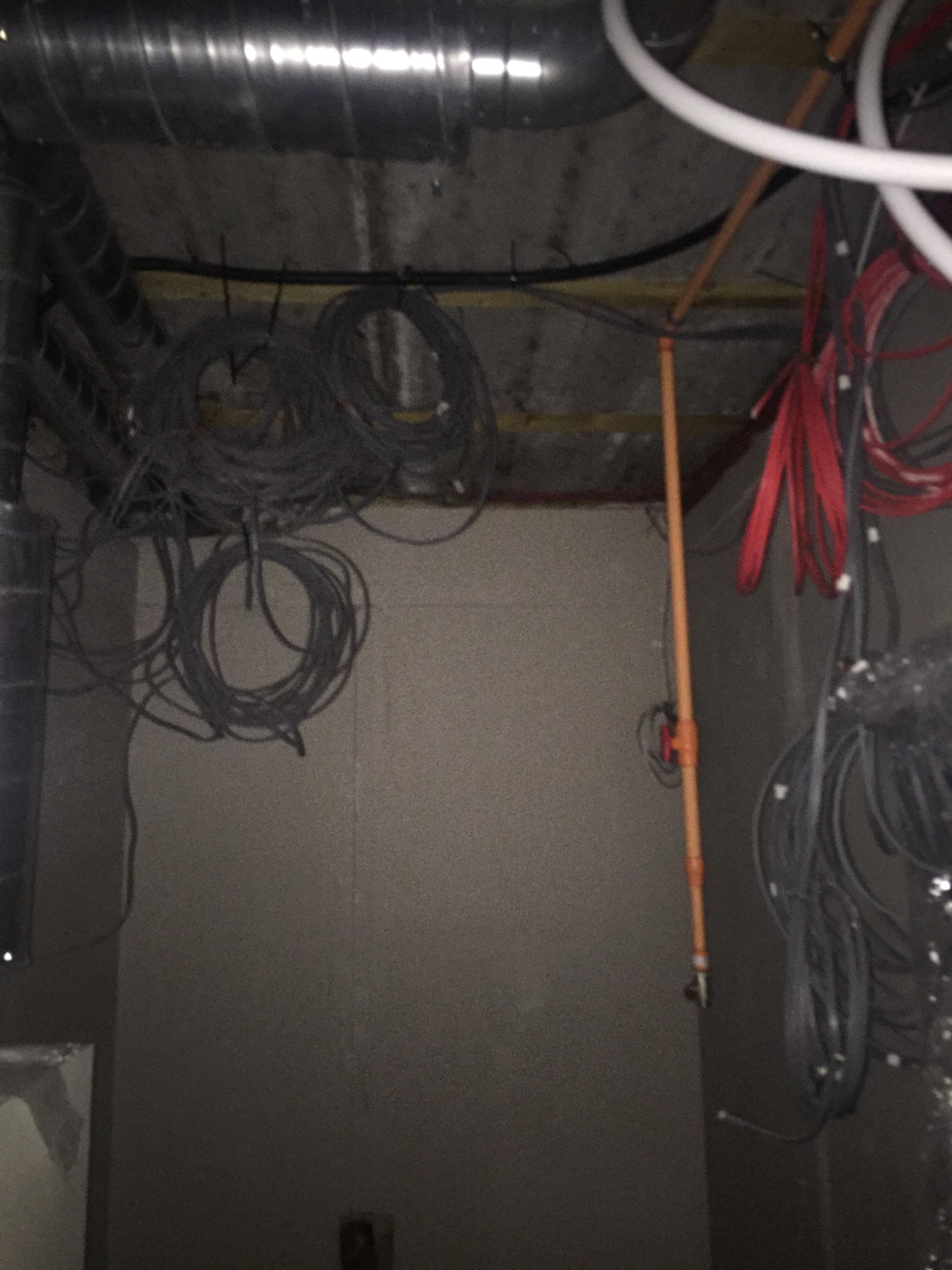

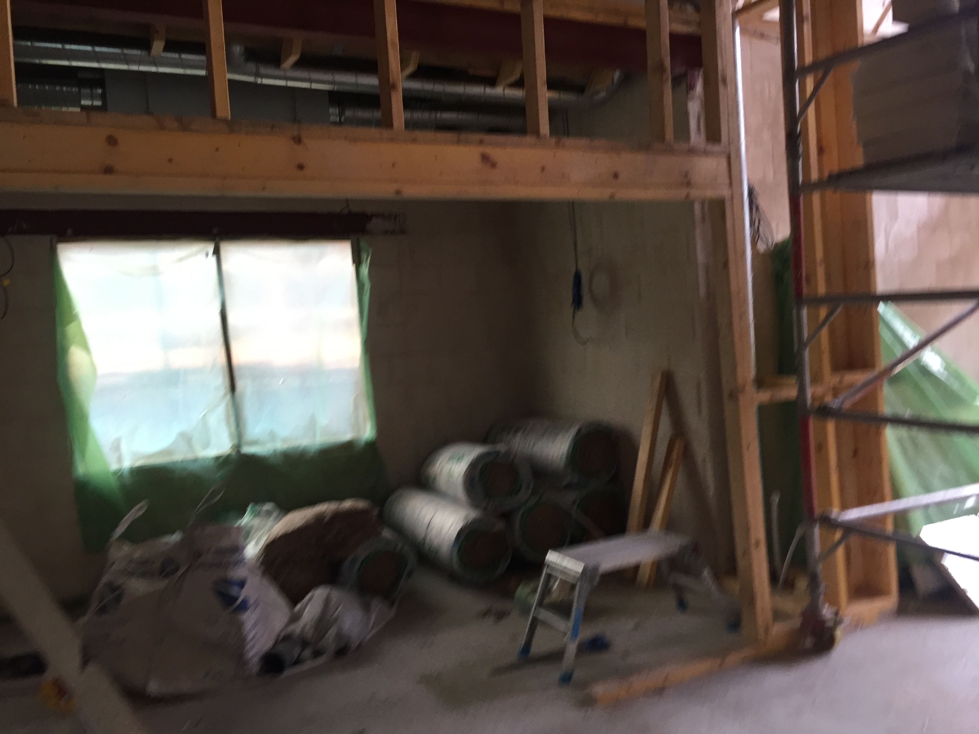

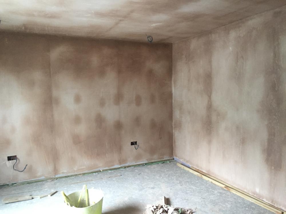

For me this has been the hardest few weeks as we get closer to finishing there seem to be more decisions for me to make. Also finishes and how things look become more important.
With the build dragging from an initial July finish, to end September and then end November, I decided that I had to make sure it was not going to slip anymore.
I think we are now good for mid November. My wife has a party organised for December 2nd which allowed lots of time from completion when it was arranged.
I managed to source paint for steel painting which was quoted at a ridiculous £150 a square metre when they knew it desperately needed done, I expect the final cost to be around a quarter of that.
I have just got an estimate for the internal doors. Lucky I did as the specials are 8-10 week lead times.
They have pretty much finished the electrical first fix and started on the plumbing.

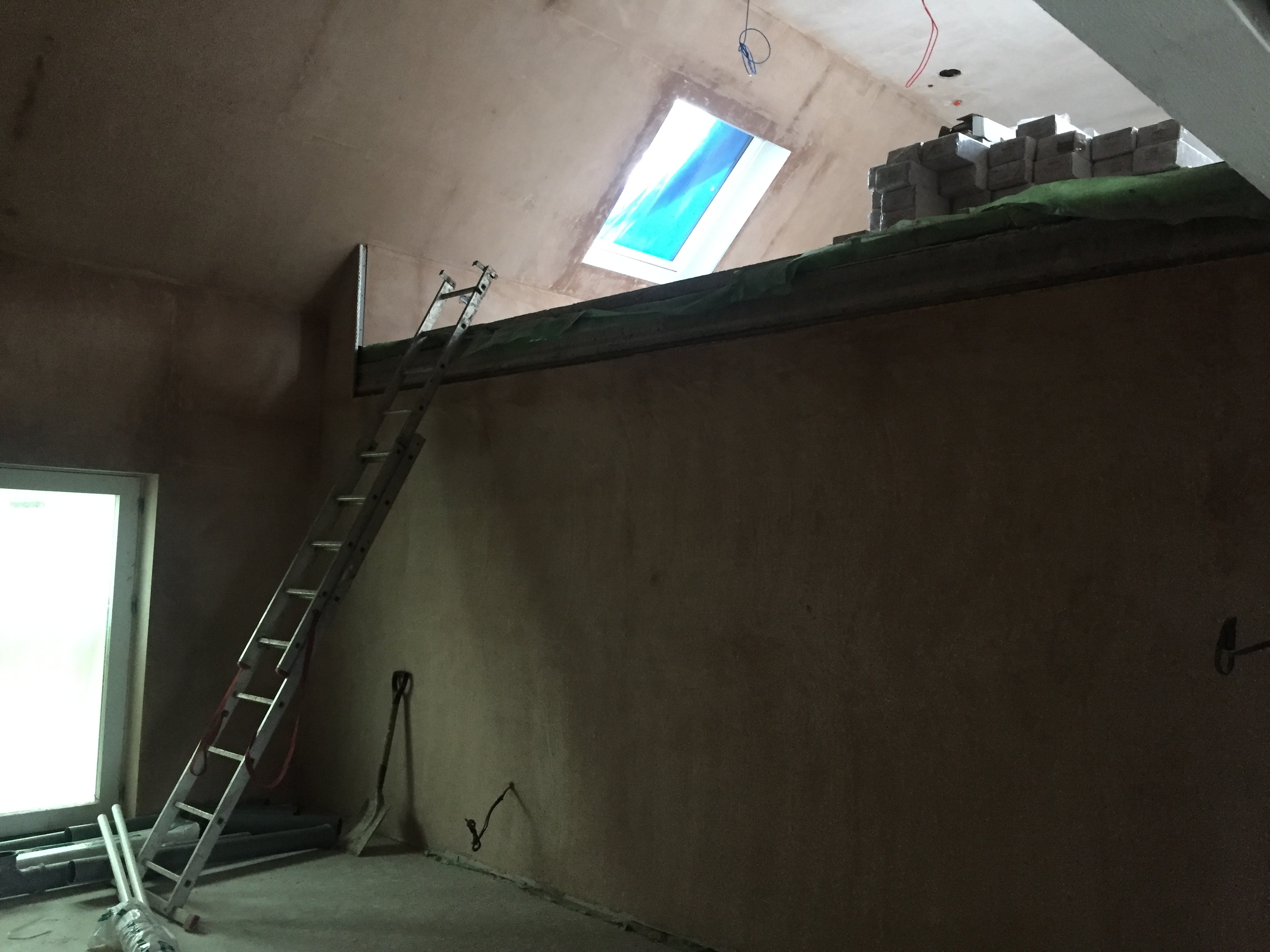

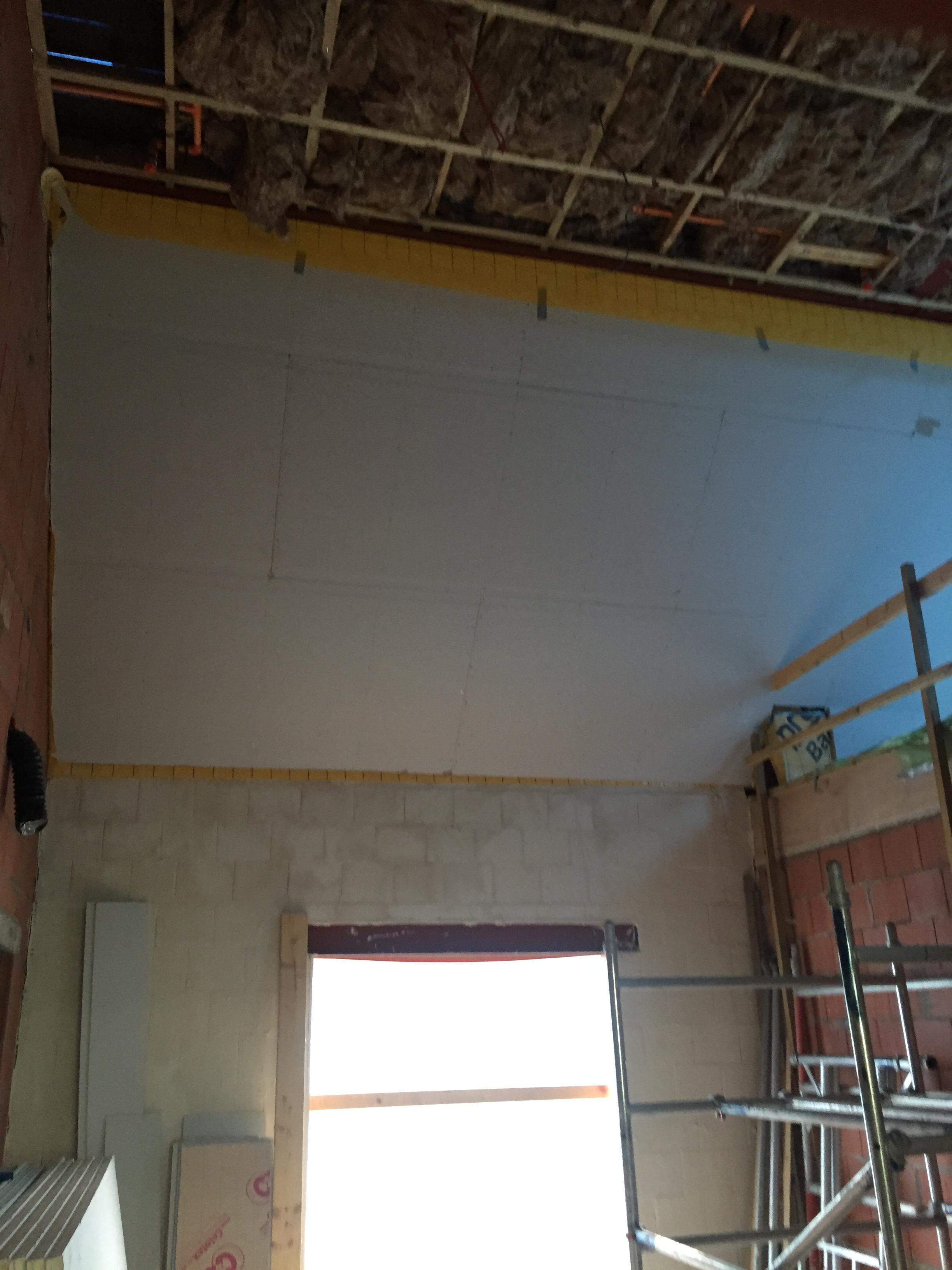

They have been framing out and plaster boarding upstairs. The plaster skimmed walls have lovely finish.

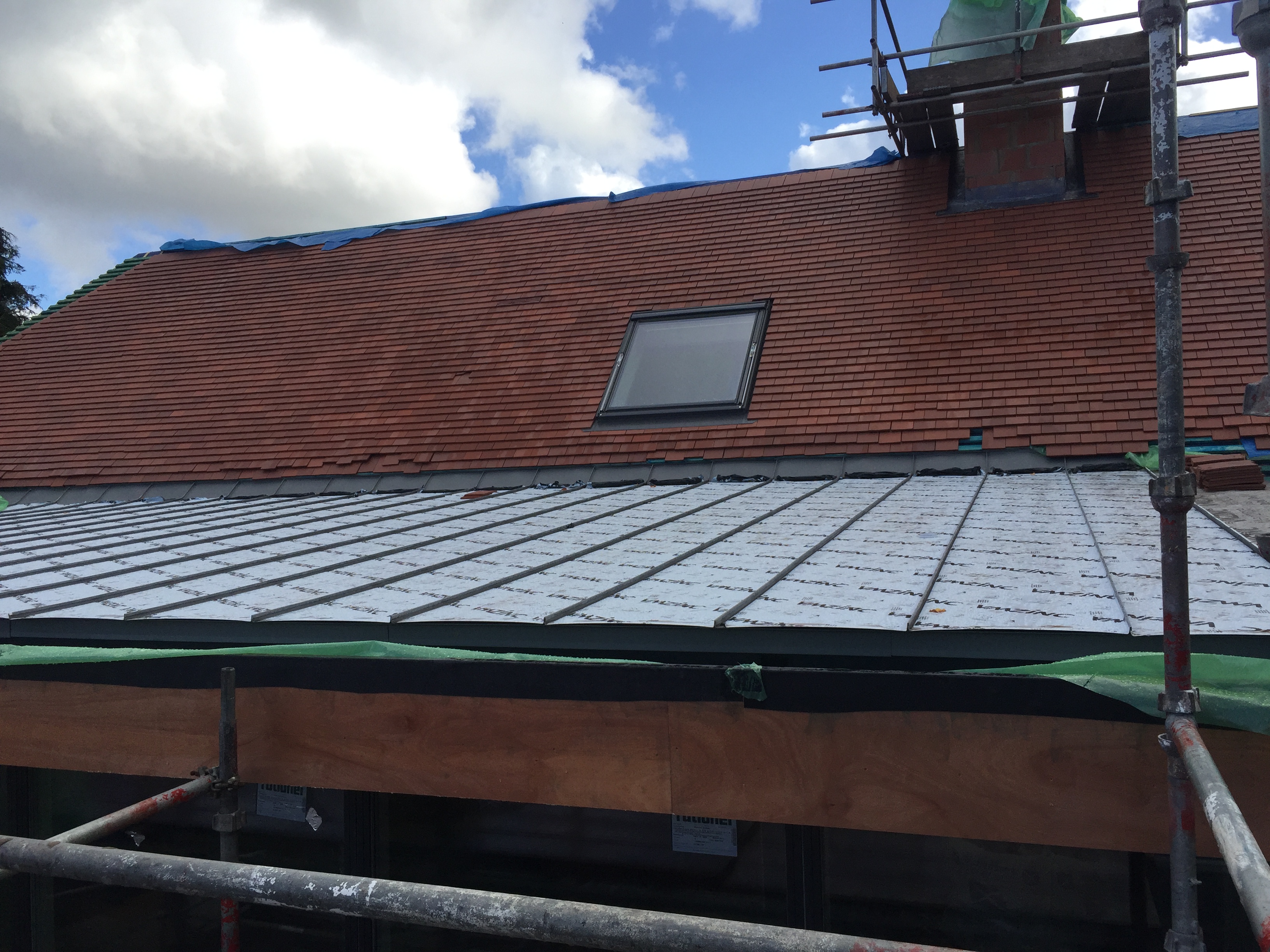

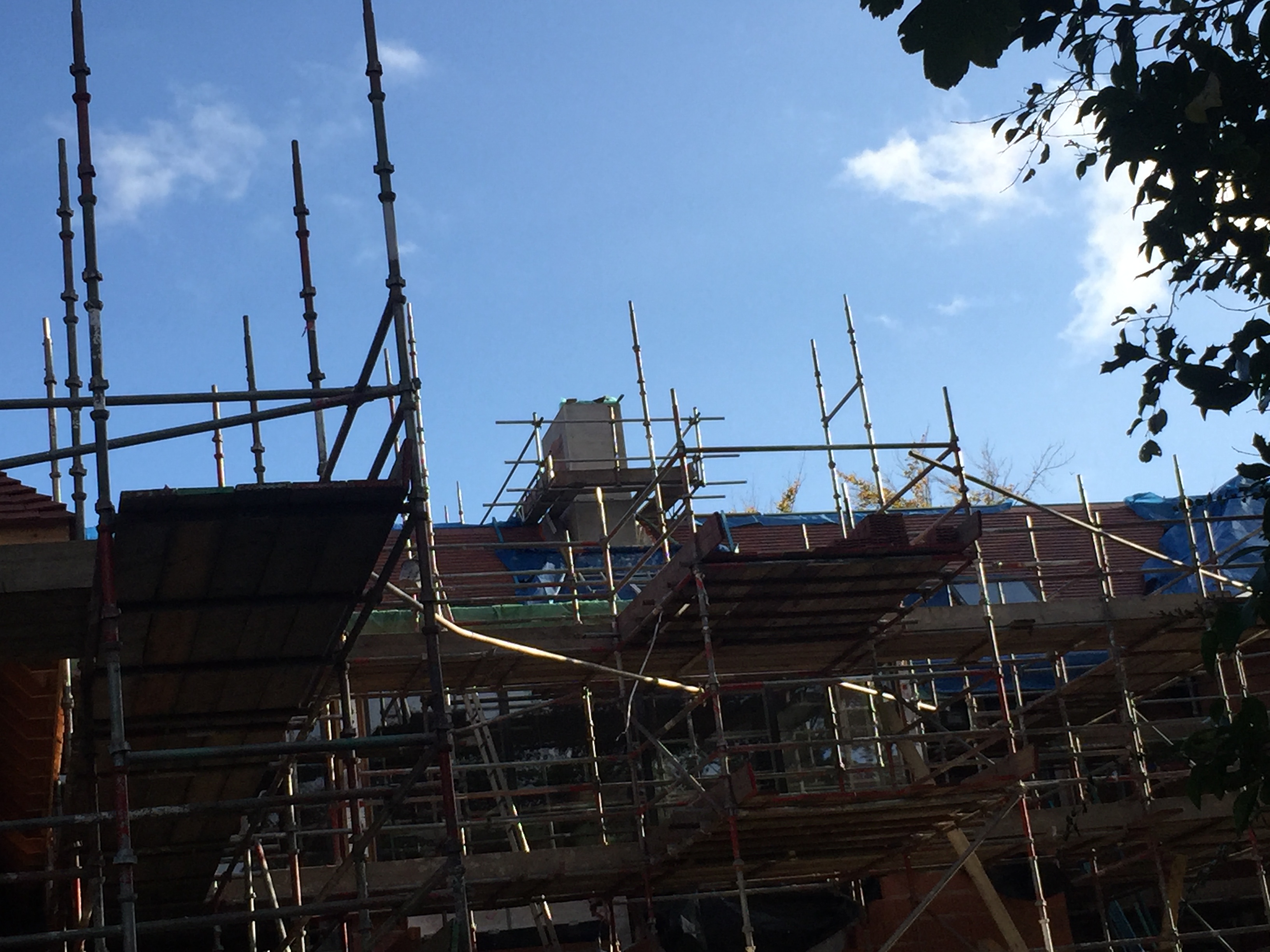

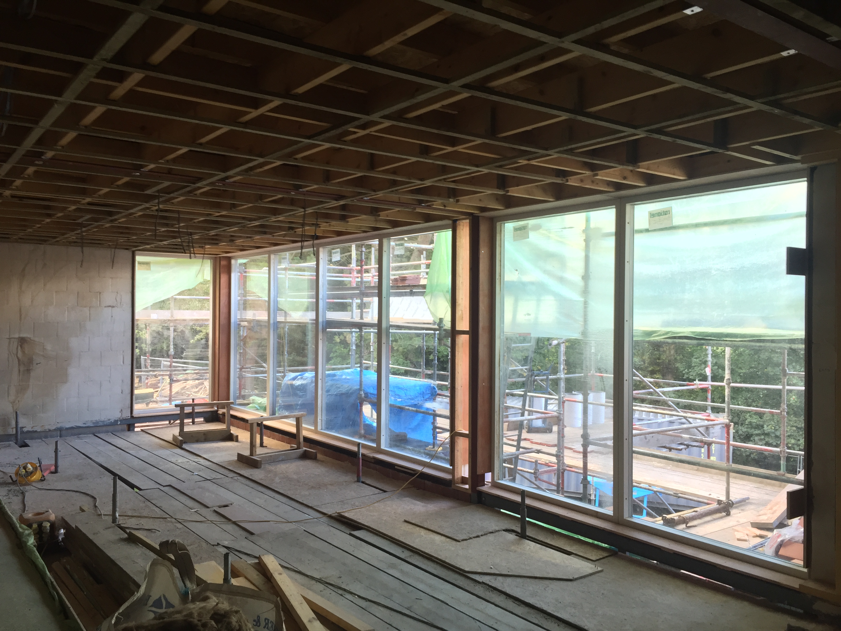

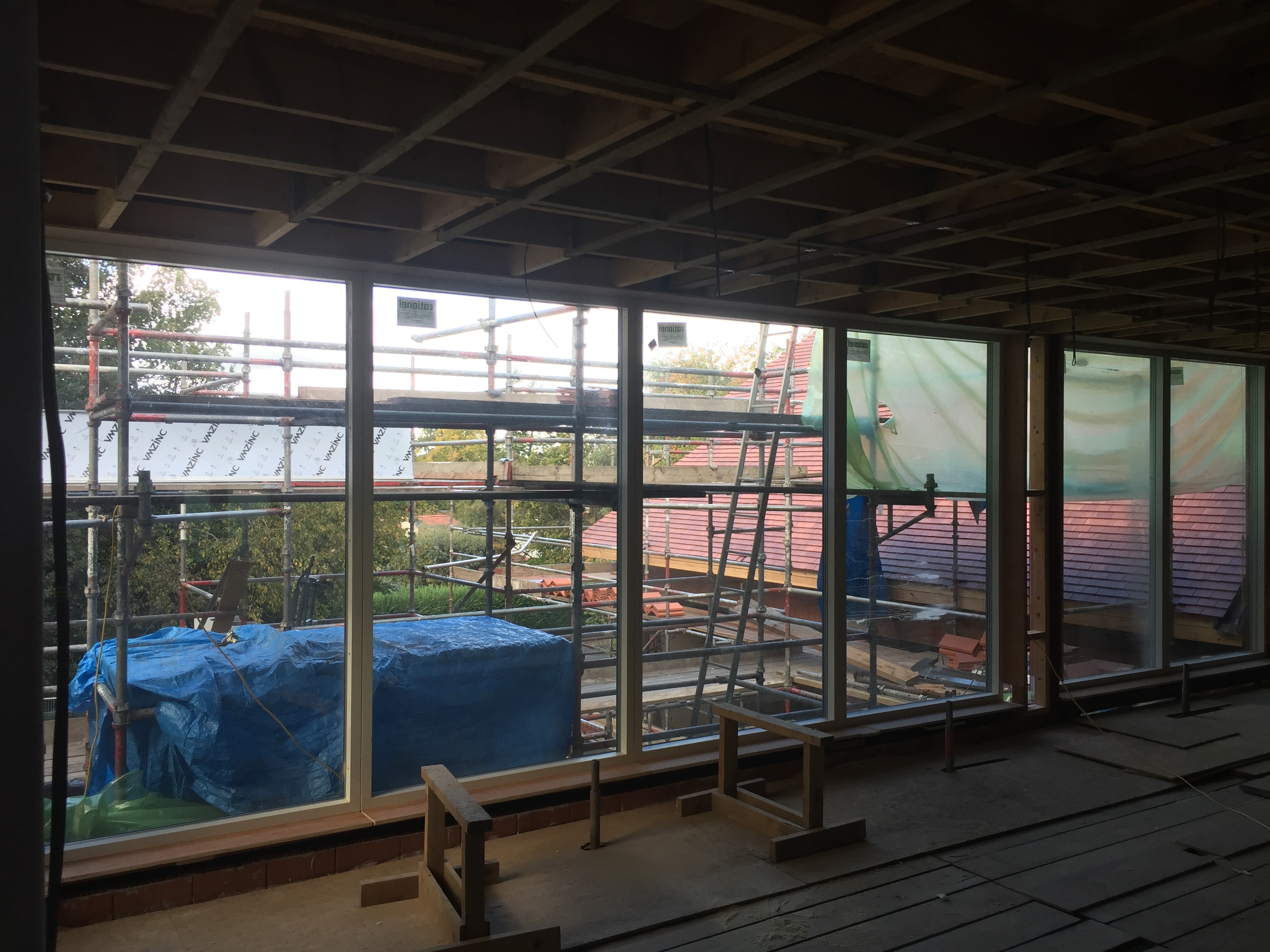

The windows are still not in due to the steel lintels not being painted and the roof in only around 25% tiled. The windows should be done in two to three weeks and the roof maybe a week later. Then the rendering can start outside and we can work on finishes inside.
I have just told my wife that she can finally choose paint colours.

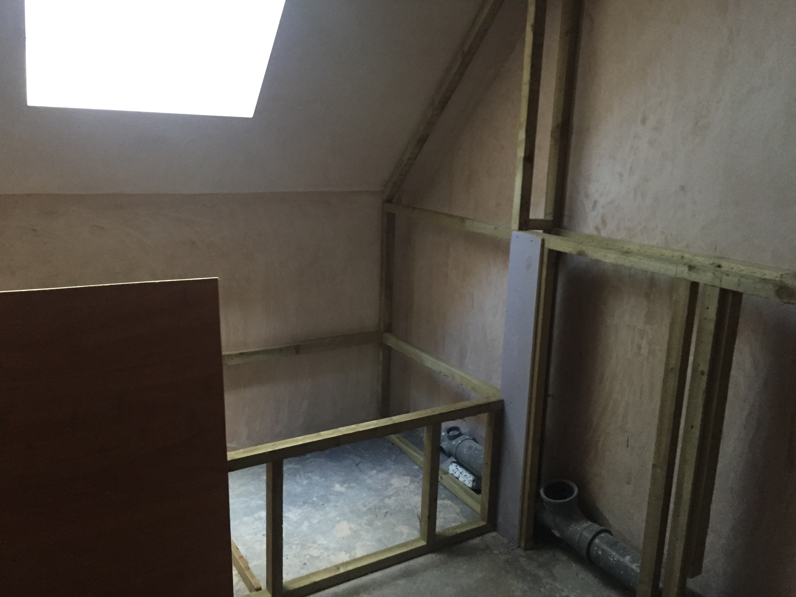

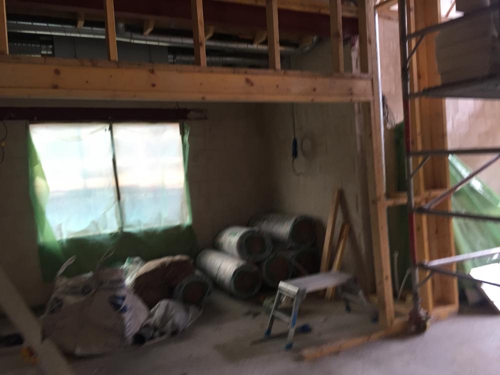

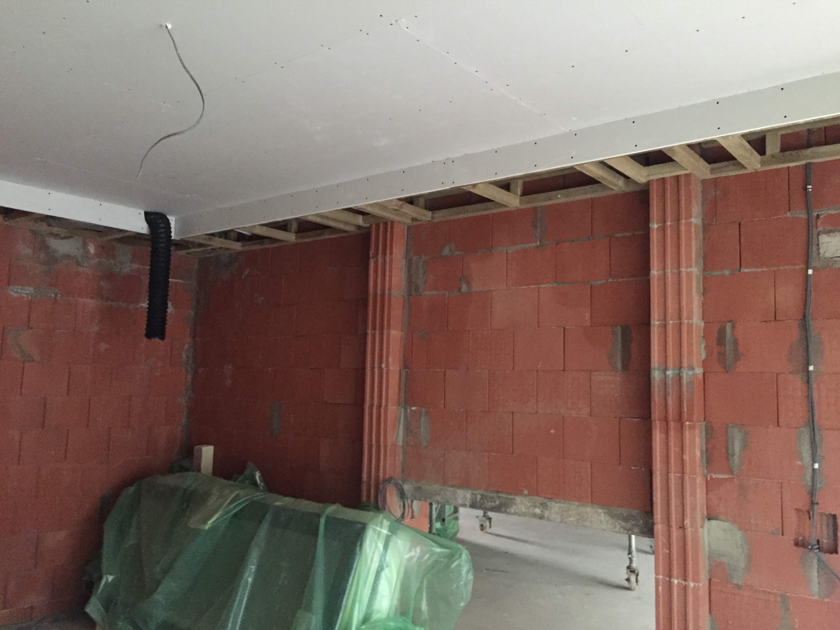

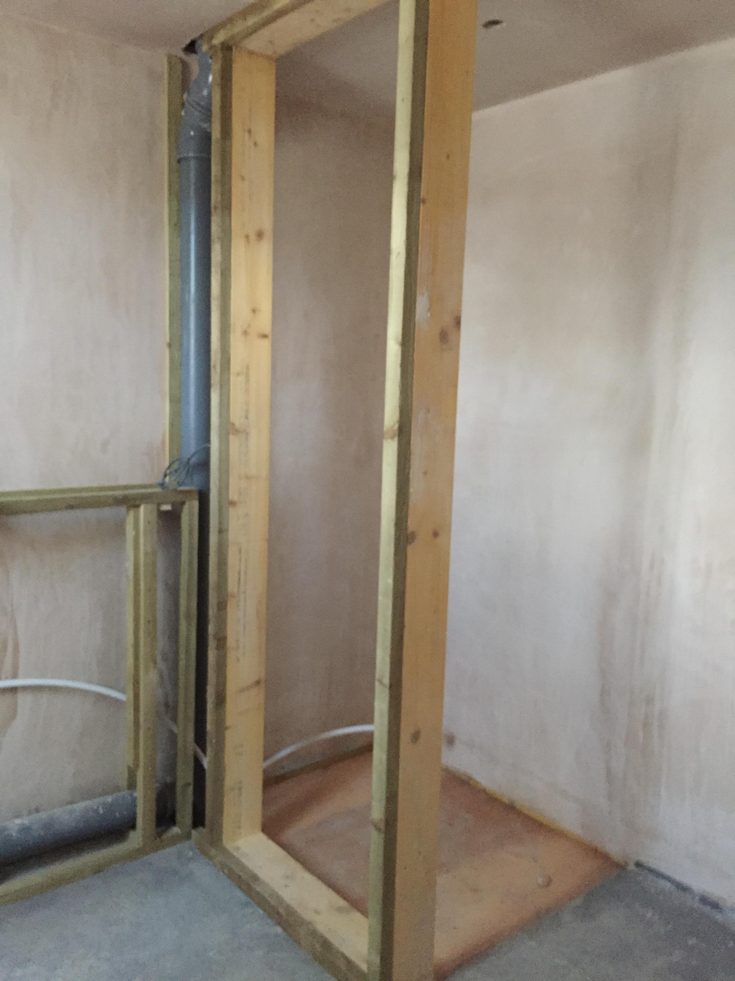

Framing for master en suite

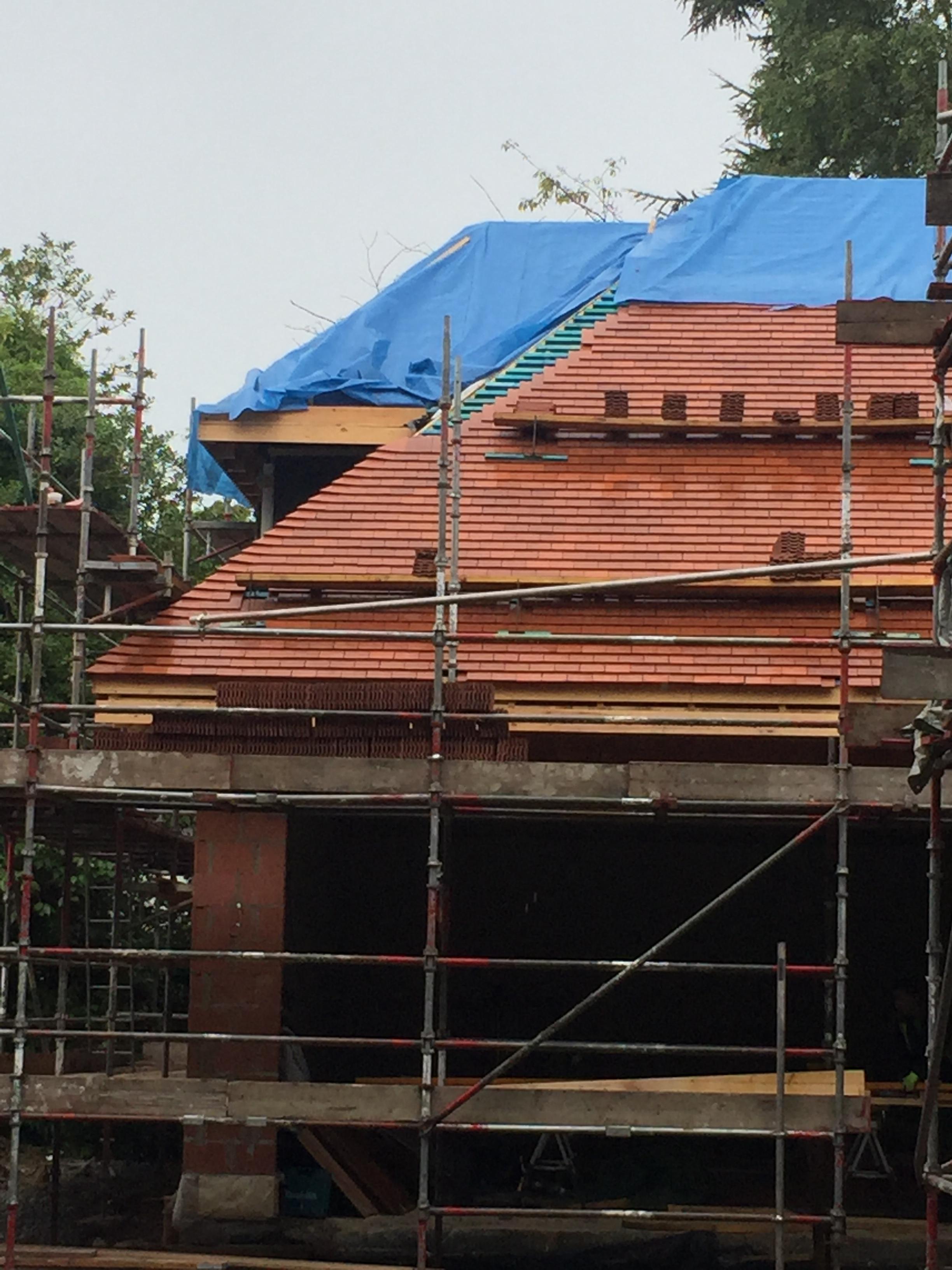

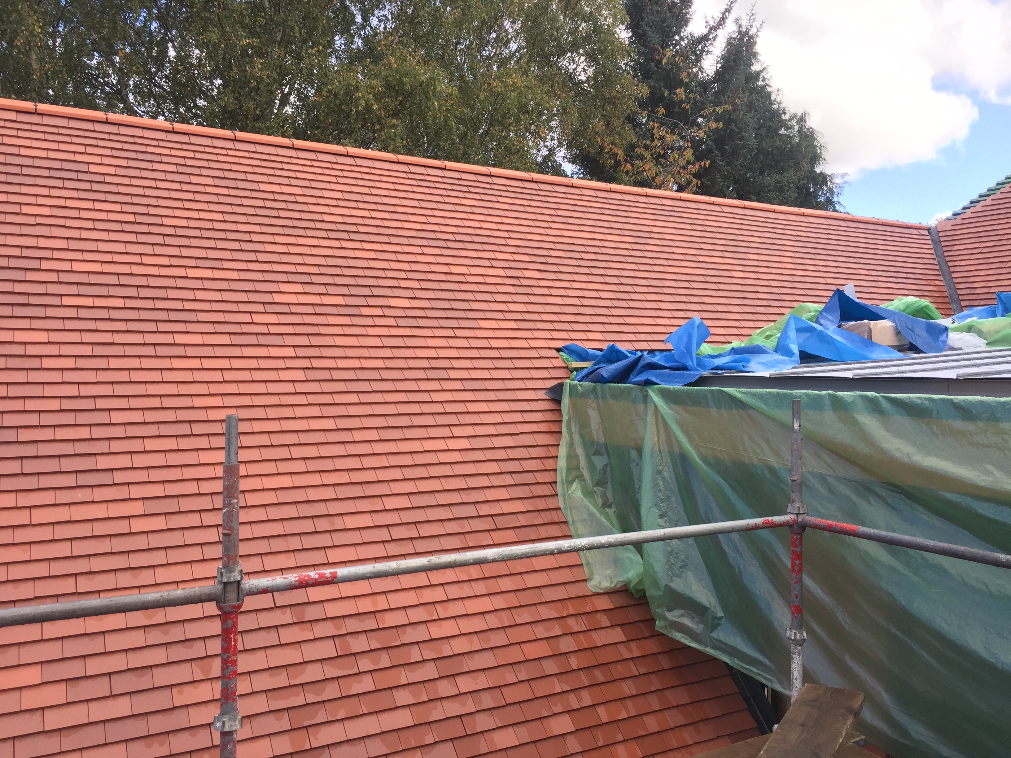

More roof tiles

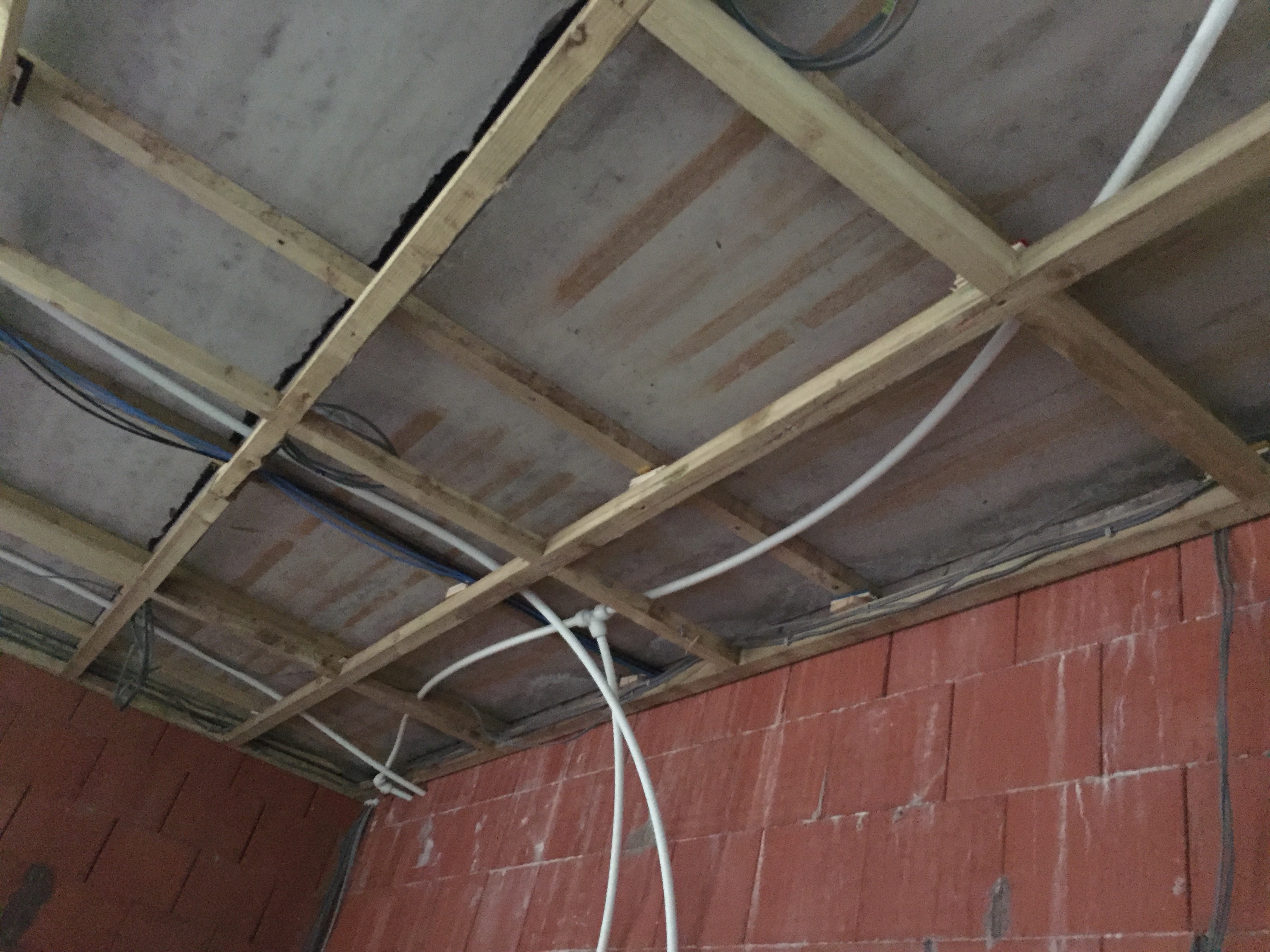

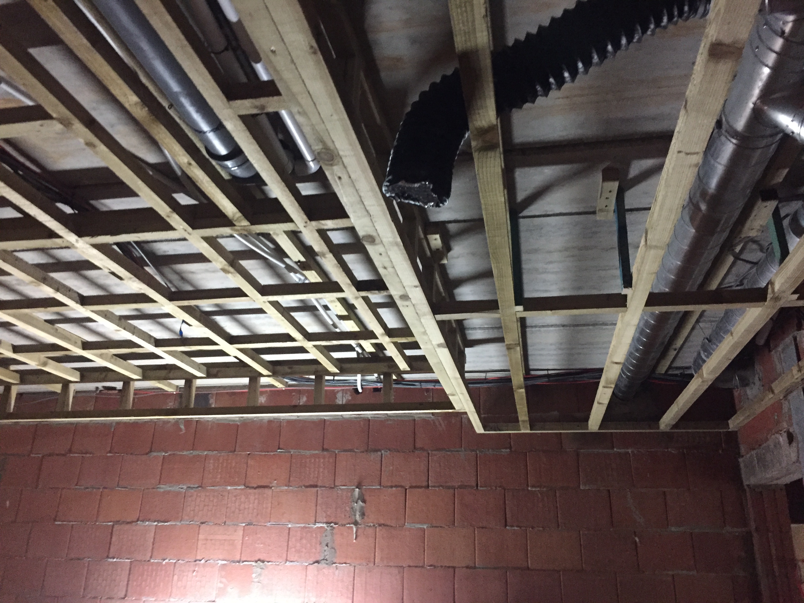

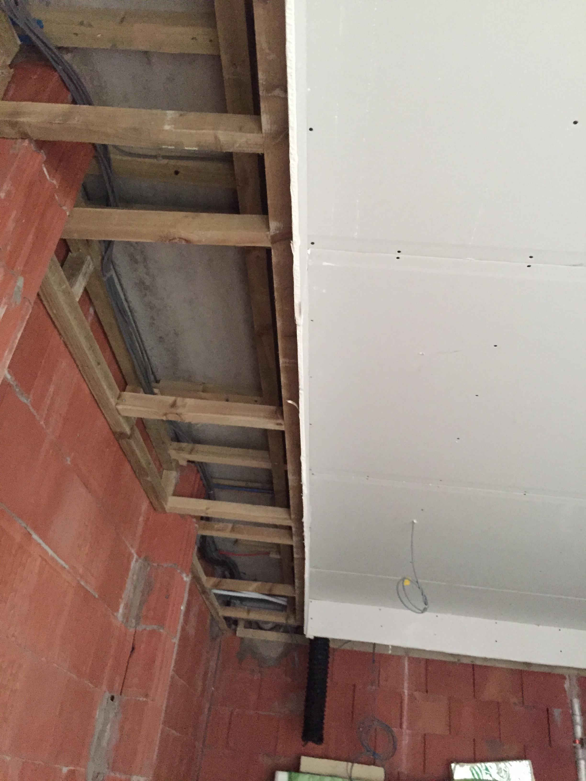

MVHR and other pipework

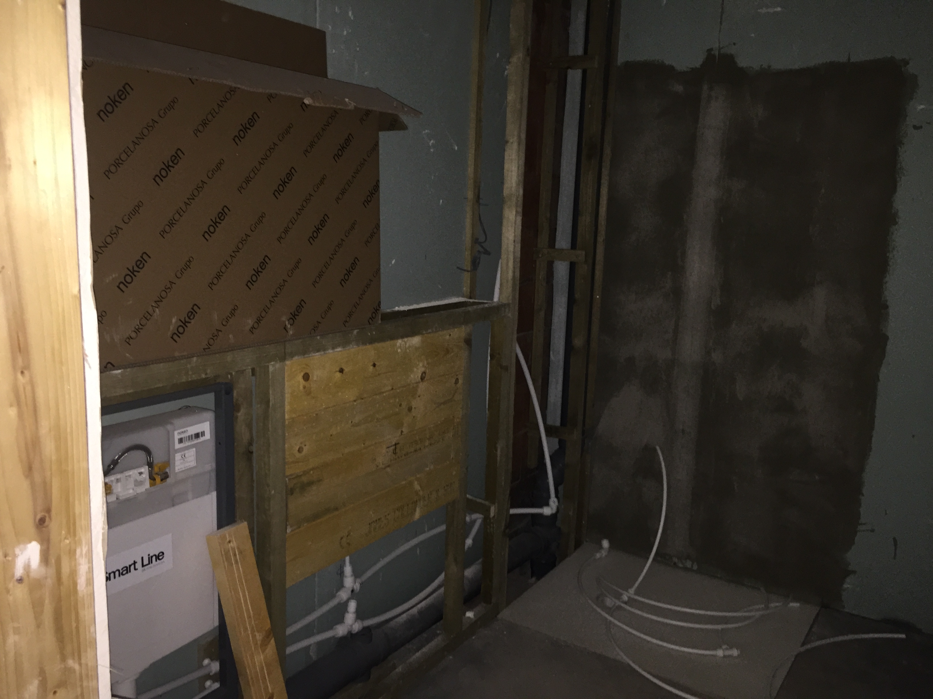

Hot and cold water loops going in. These will be fixed to the slab.
Sprinkler system in, can finish plaster boarding the ceiling now.

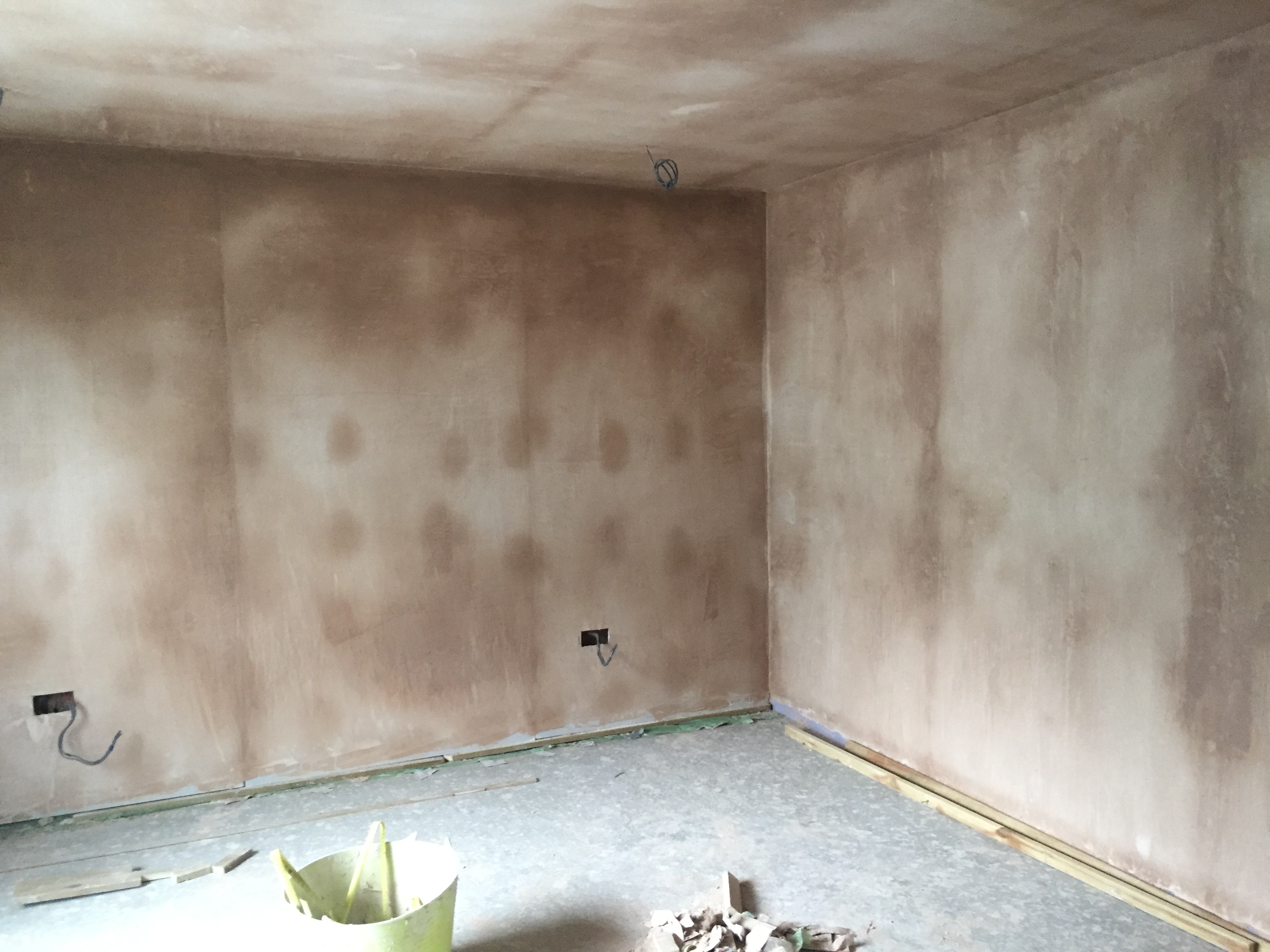

Plaster skimmed walls
More plaster

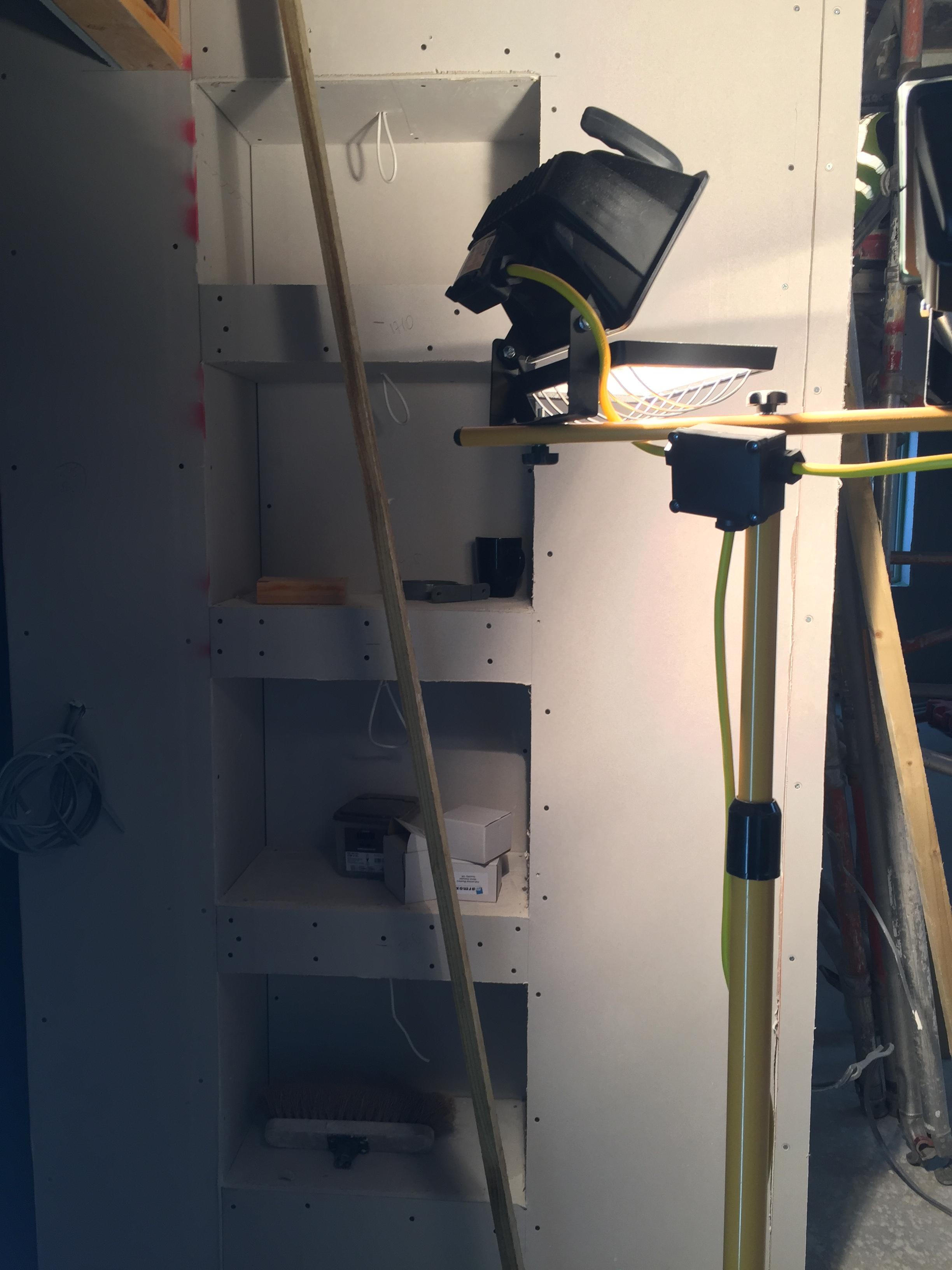

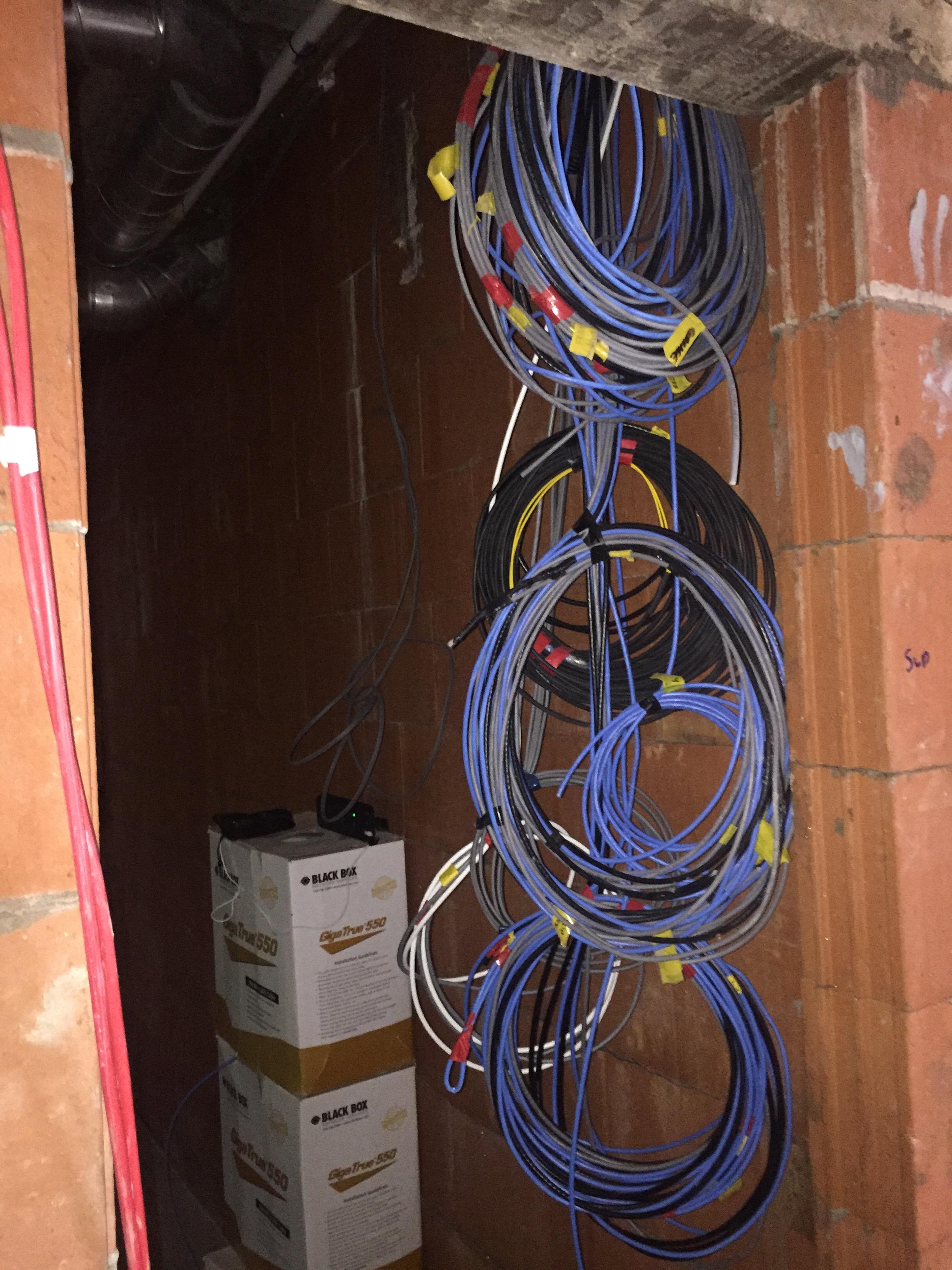

Cabling in AV cupboard
Plant room

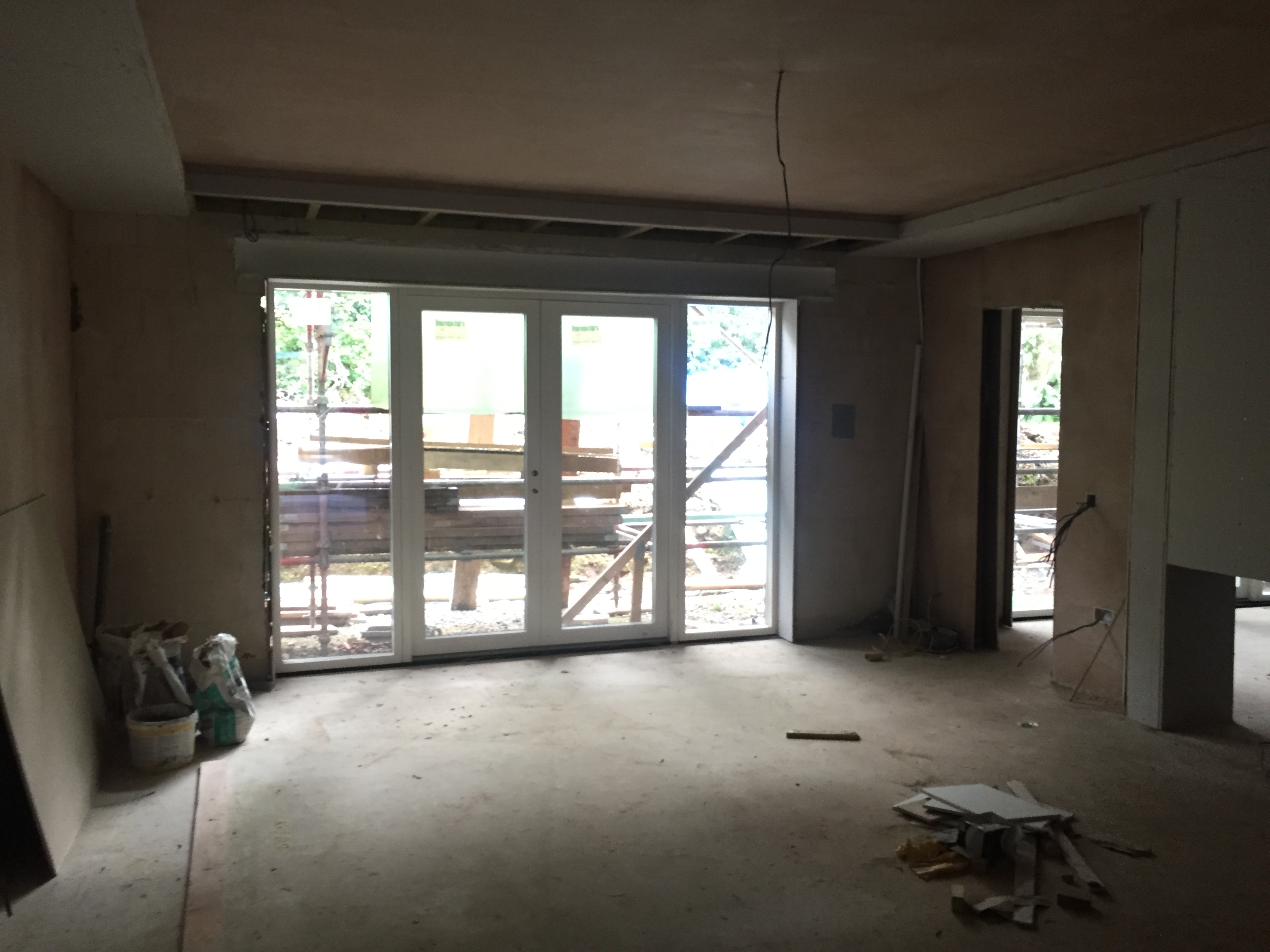

Posted (edited)
Lots of progress, we are aiming to be in on December the 8th.
The people who are buying our house have asked to be in sooner, I just don't see that being possible unless we move into a hotel or rent a place for a couple of weeks.
I think almost all the decisions on the house are made so my stress levels are falling.
Main stress now is getting completion certificates for an extension on our current house in time for the sale. The builder never got final completion and a couple of things need to be done.
The lounge is almost done, just the fire to go in.
Stonework has to go in around the widows, must make sure the builders put the insulation in first.

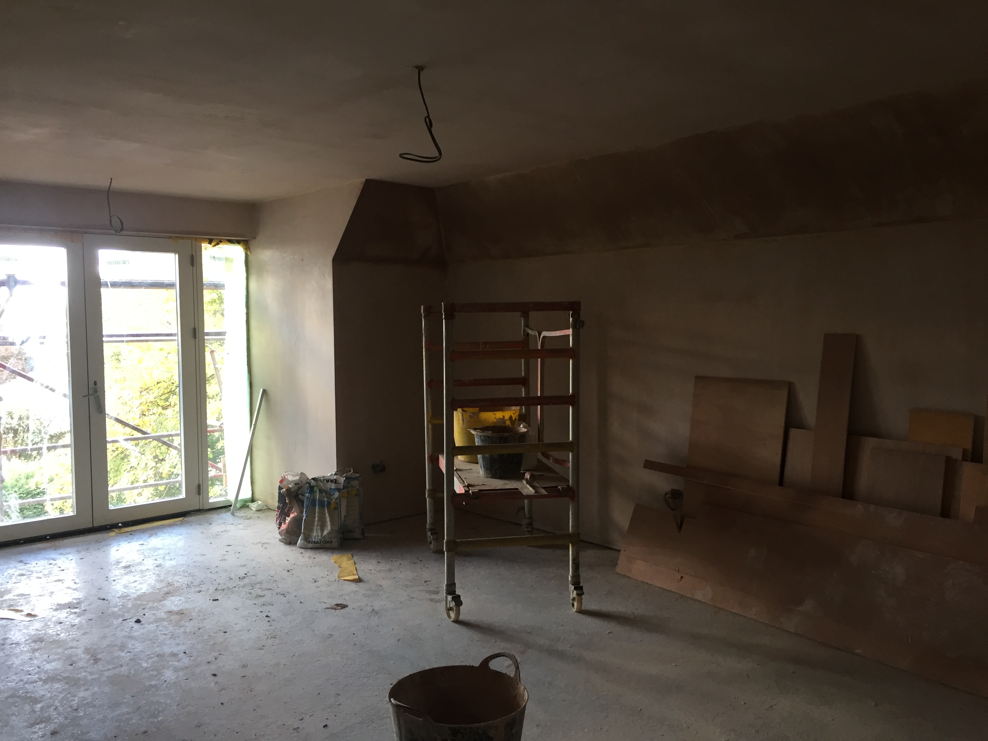

Some of the upstairs bedrooms are basically done and plastered.

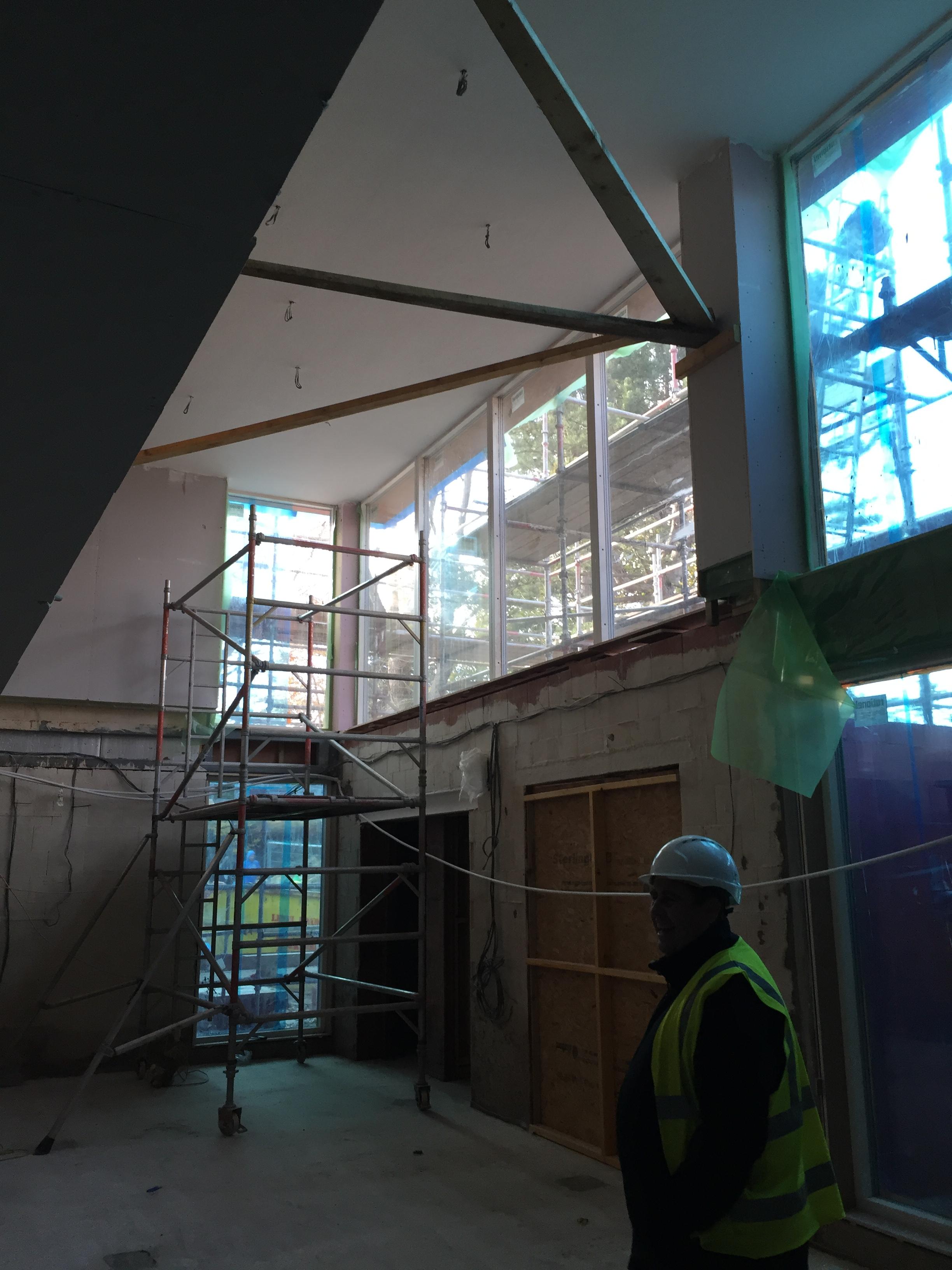

Loving the upstairs hall, it almost feels like you are standing outside.
First couple of bathrooms being fitted out.
Hall from the other side.

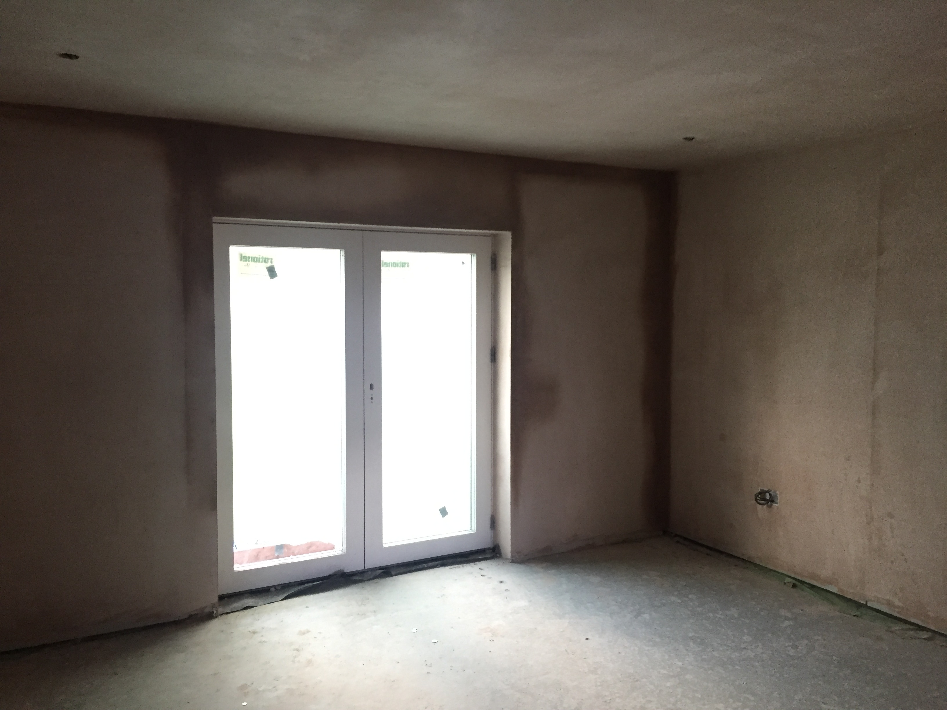

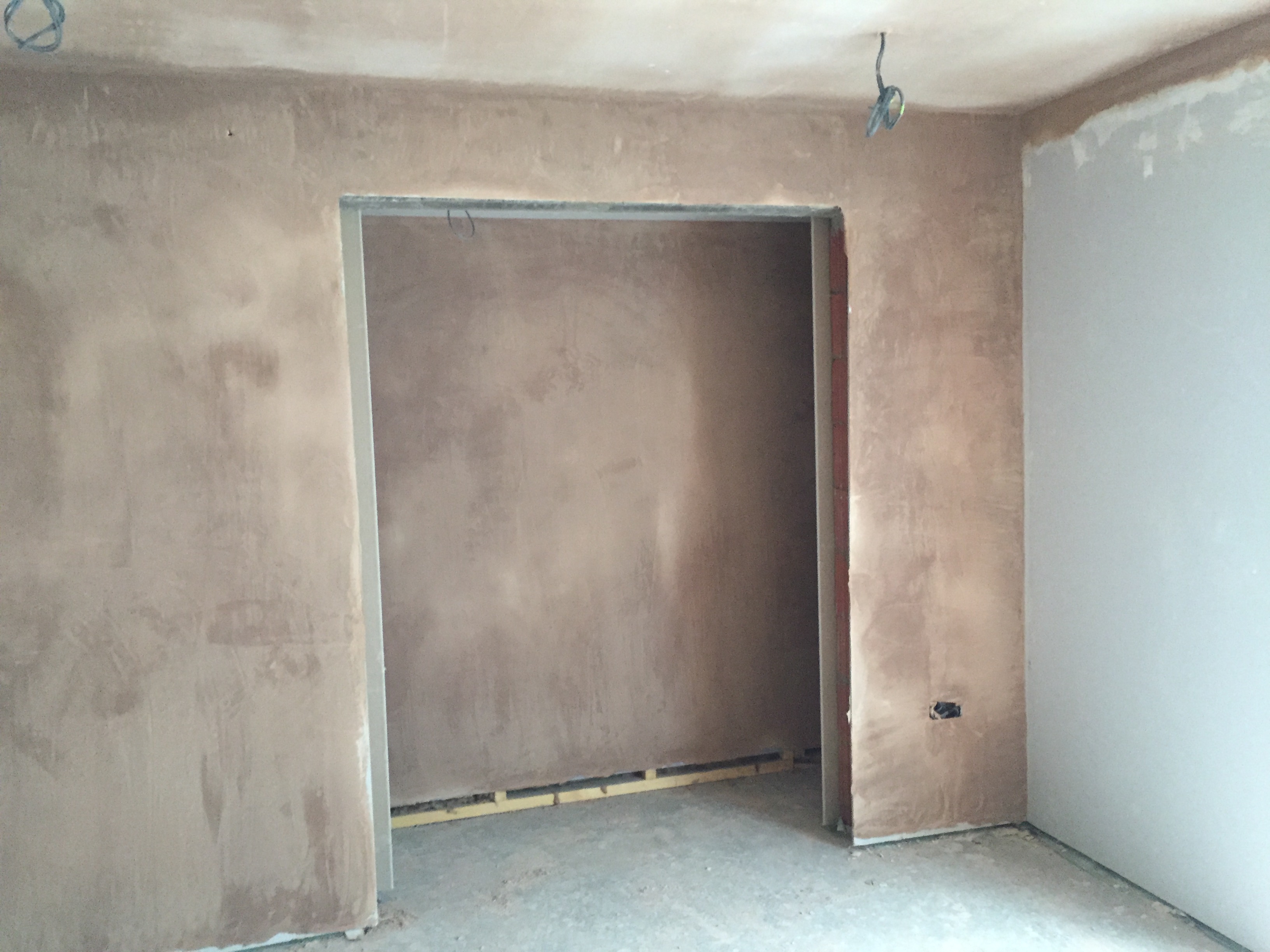

My daughter's bedroom has been plastered now.
Shower frame.
Rest of bathroom framing.
Zinc roof going on above the hall.
Edited by AliG

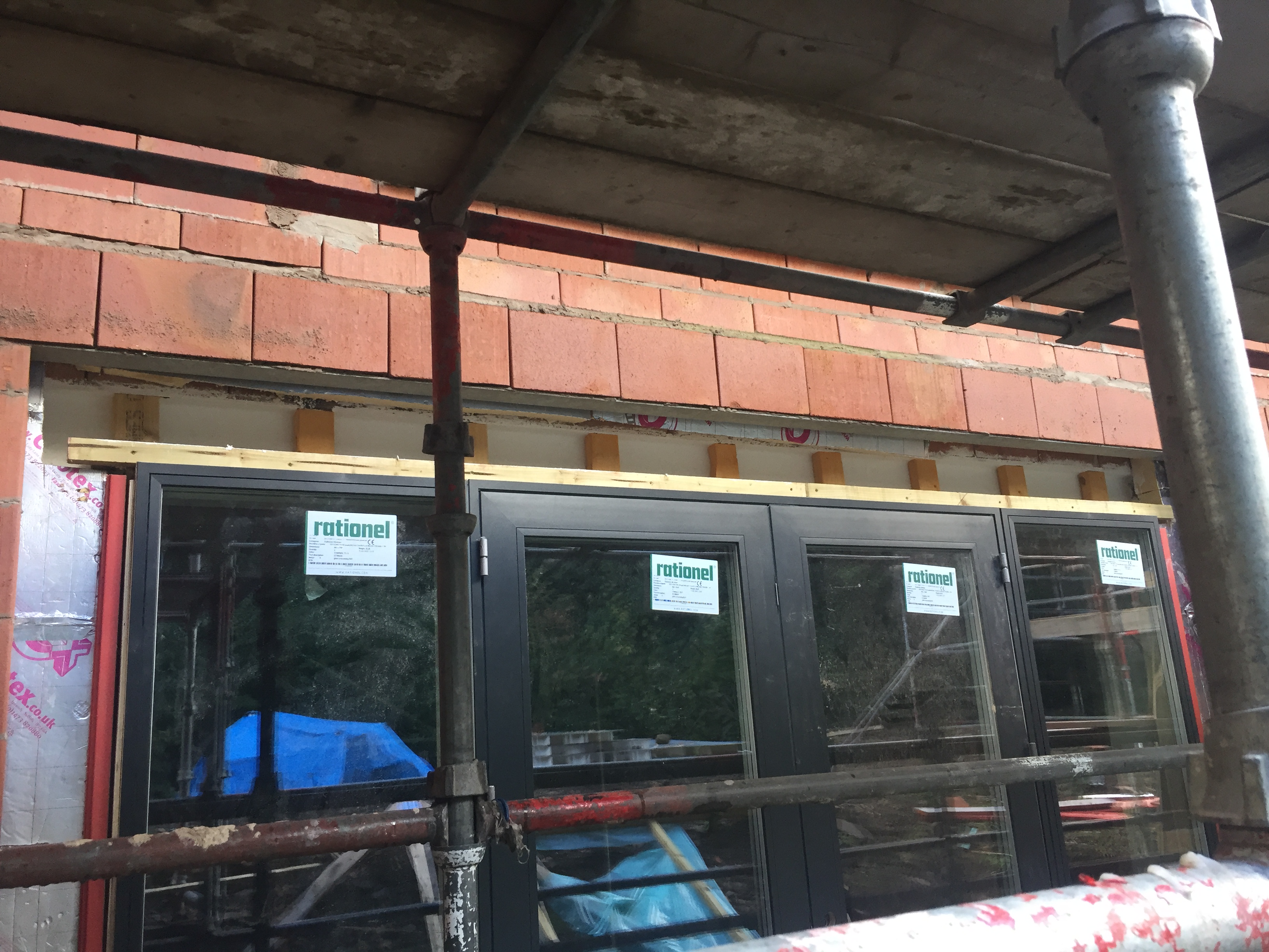

Finally getting some render on. With that and all the windows it will soon look like a finished house.
Of course now that all the windows are in and with Celotex insulation in the walls the phone signal has all but disappeared inside the house.

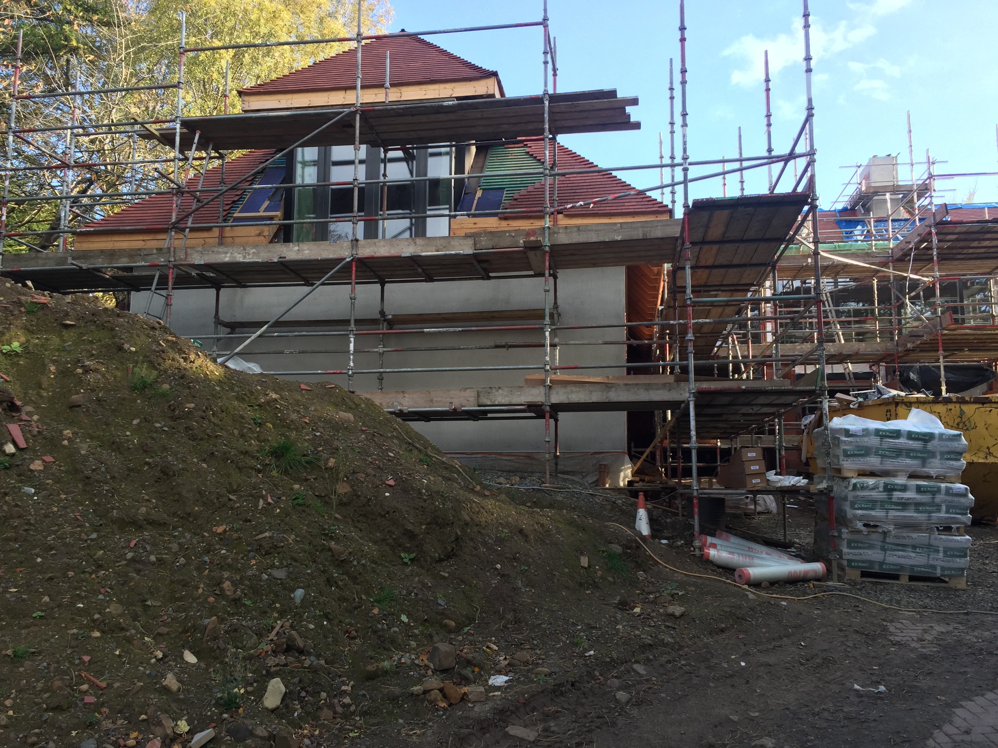

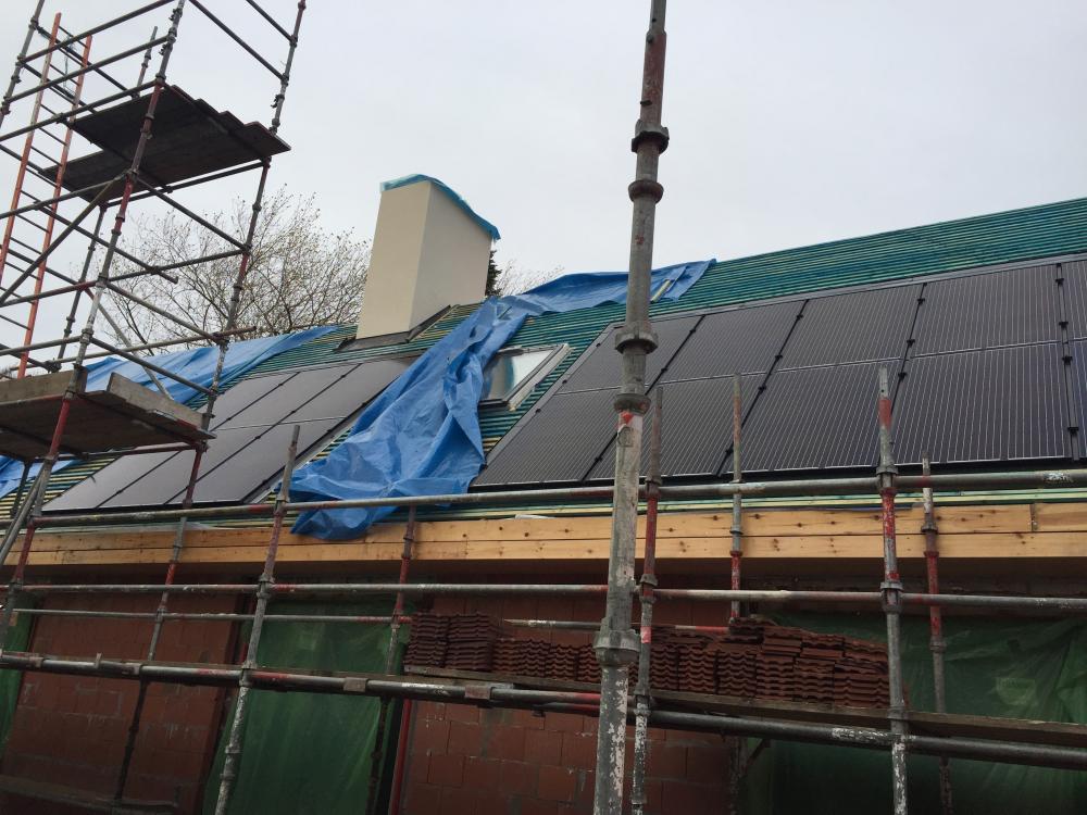

Posted (edited)
Ok, now that I have the completion certificates needed to sell my own house, we can get back to finishing the new one.
We are due to move in on the 8th, clearly we won't be 100% finished then, but it should be fine.
We will have a temporary stair and the decorators will still be working, but water electricity and gas will be connected up.

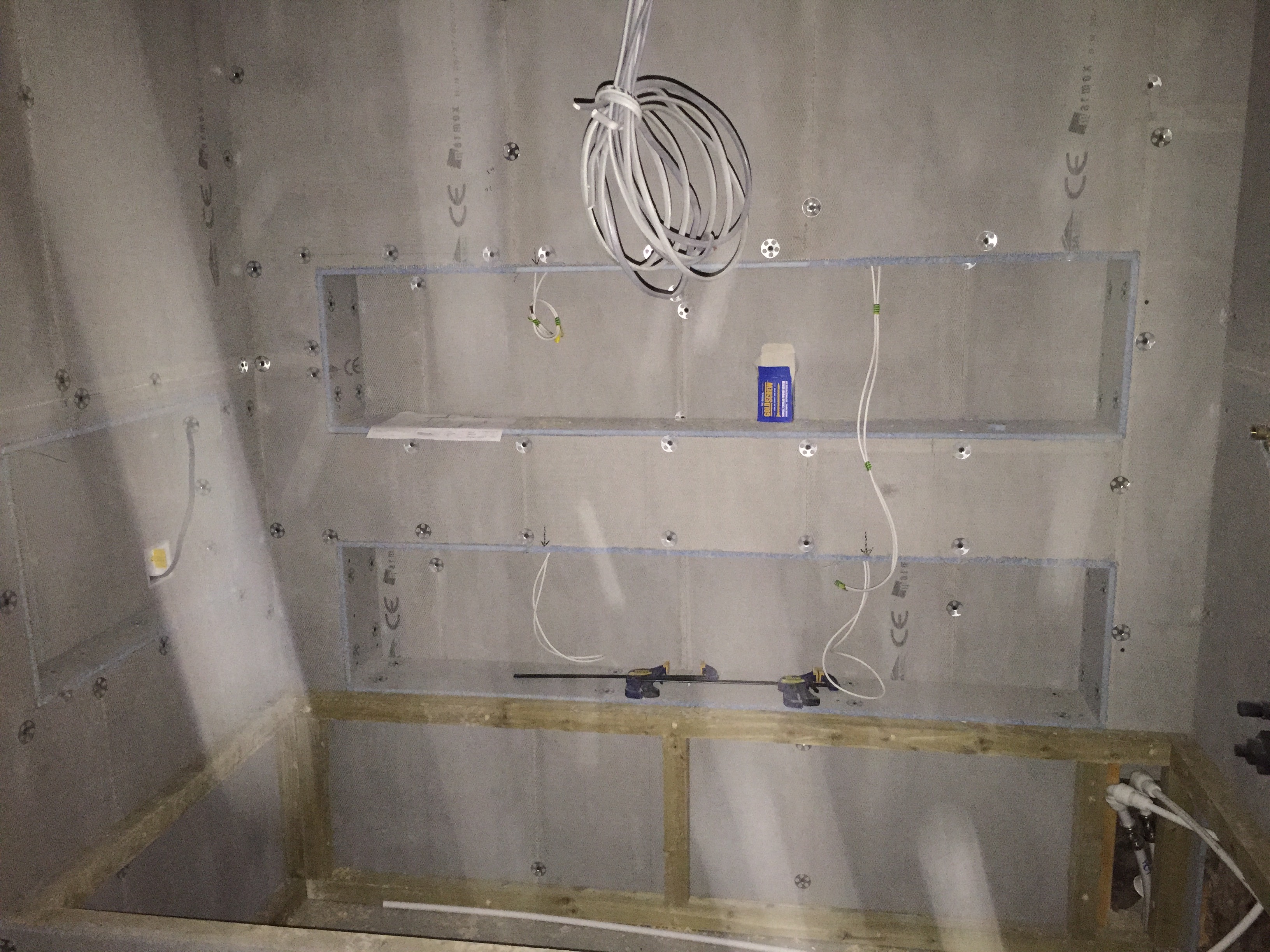

We have gone niche crazy in the master ensuite, bathroom TV is going in the end there.

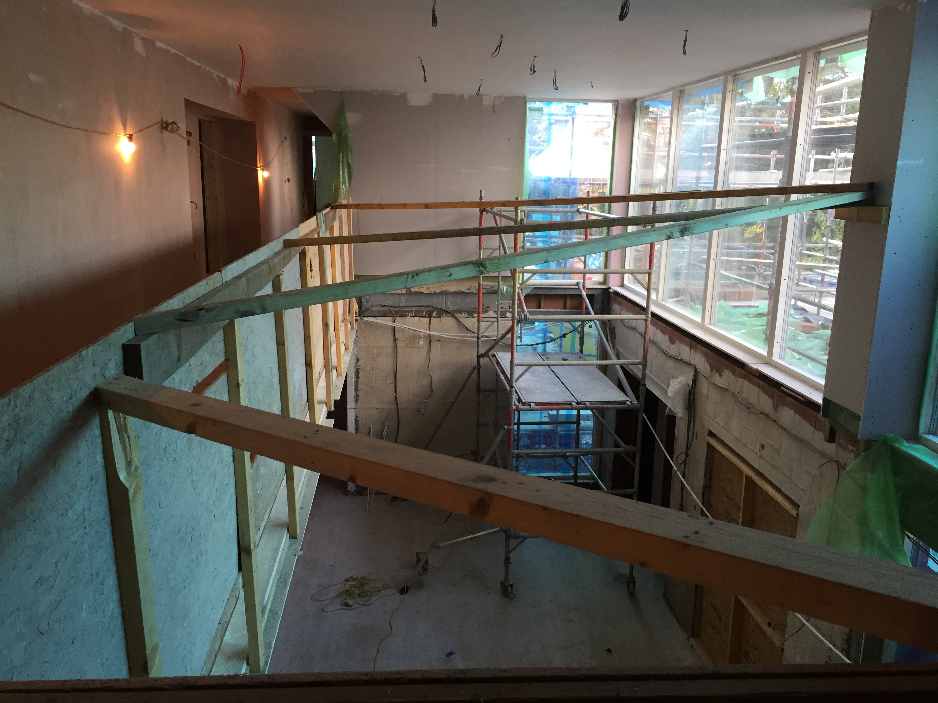

Scaffolding is finally down letting you see the full height of the hall.
Gamesroom and study all ready for painting. Second floor staircase should go in next week or the week after.
Hall from upstairs.

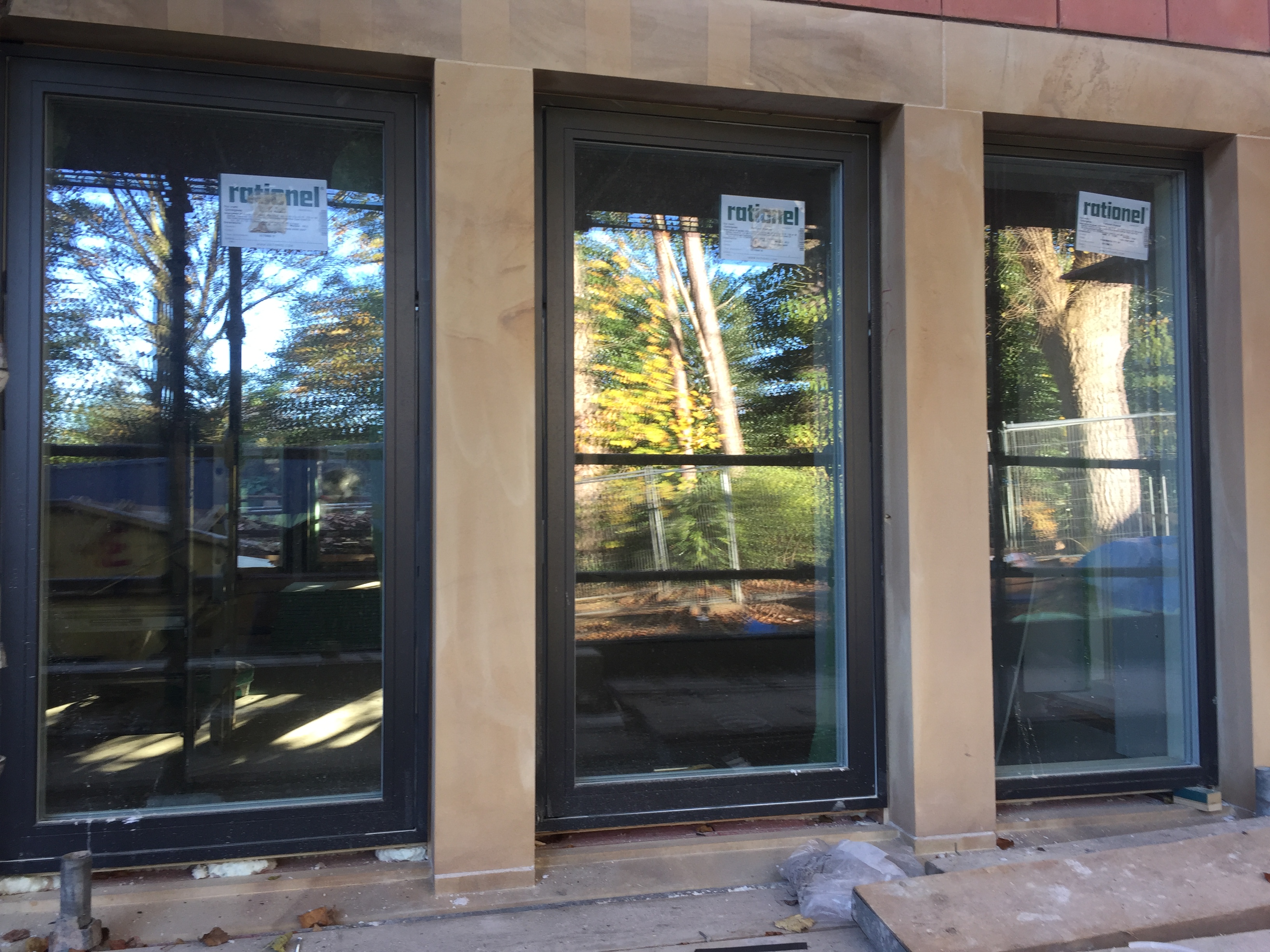

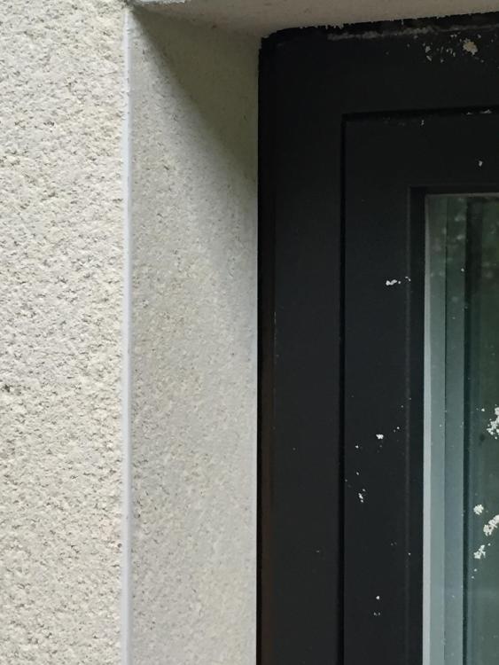

First finished window frame, I love the real stone, it just needs to be cleaned off. The renderers were applying the base coat today and the top coat will go on next week.
More niches, I was surprised that the builder didn't mind putting them all in.

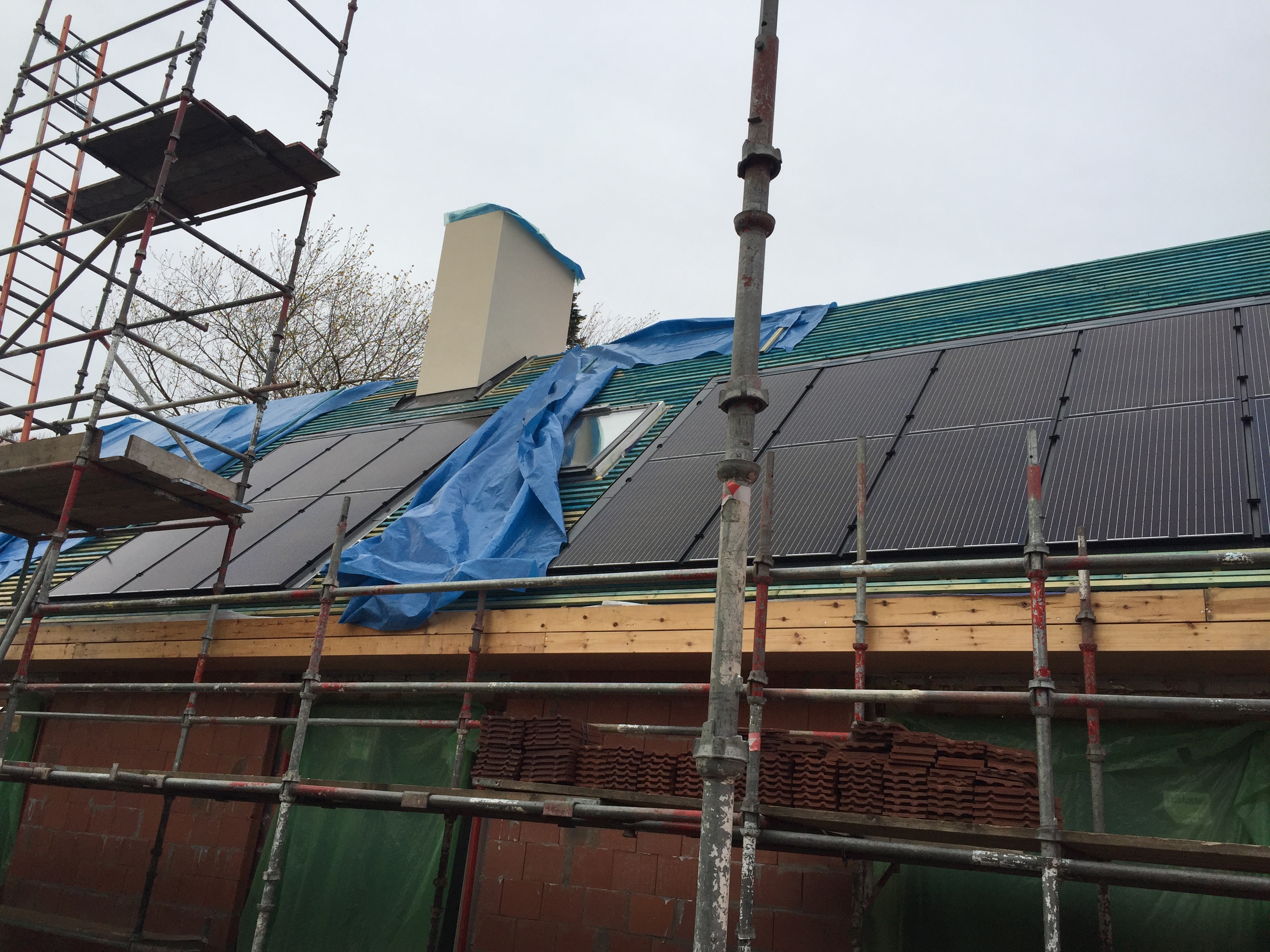

Solar panels on, this is the final area waiting to be tiled.

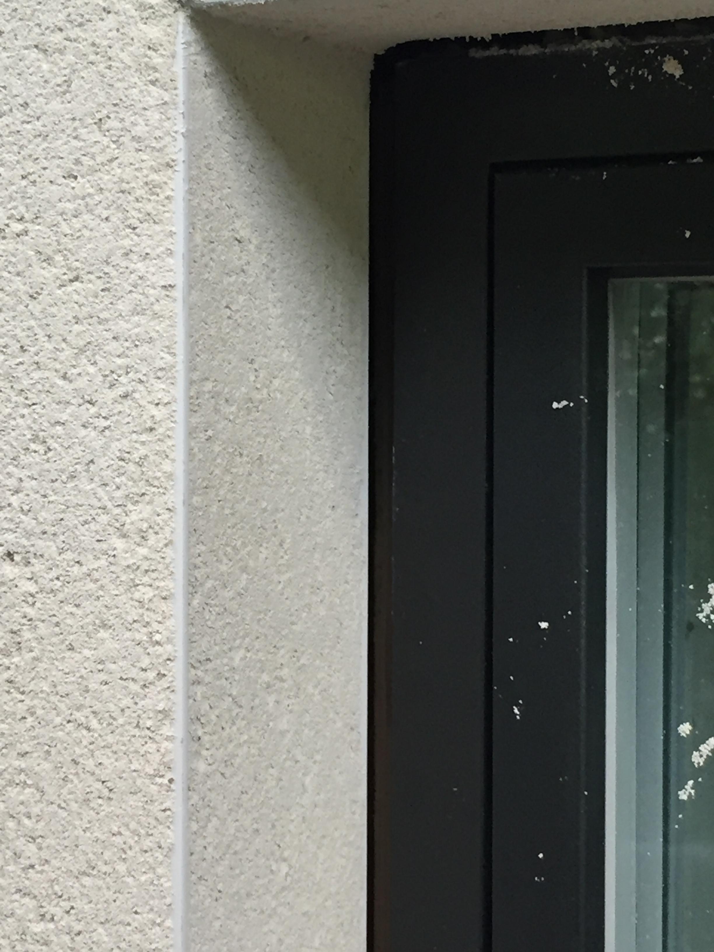

Detail around Rationel windows.

Posted
Love the house.
What is it with bloody tradesmen. Why are those windows not fully masked up.
I wouldnot consider working near them without full masking or an indemnity from any damage caused.
Sorry rant over.
Posted (edited)
Round the other side where they are working at the moment they have blue plastic stuck over the windows (you can see it in the hall picture) and they even had the handles covered on the balcony, I don't know why they didn't do this one.
The windows were sitting around on site for ages before being put in and need a good scrub anyway.
