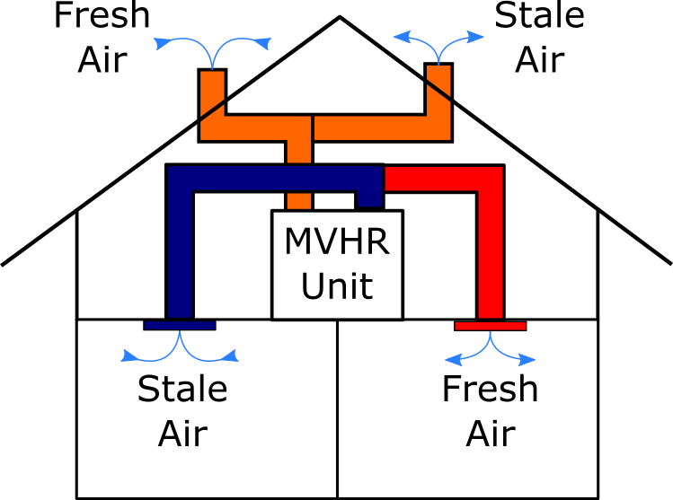

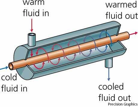

Onoff Posted January 31, 2021 Posted January 31, 2021 1 hour ago, zoothorn said: Christ im never gonna understand this Try again...replace the word fluid with "air". This diagram is very conceptual but valid. Cold air gets drawn in from the outside (on the left). Your warm, moist, stinky air gets drawn from inside the house where it heats up the pipe carrying the incoming cold air. It's warmth spent in heating the pipe up, it exits outside the house as cold, stinky air:
SteamyTea Posted January 31, 2021 Posted January 31, 2021 (edited) 31 minutes ago, Onoff said: replace the word fluid with "air" Air is a fluid. Don't anyone, ever mention that MVHR can be noisy at night. And it uses electricity, 24/7. [getting my tin hat on, then me coat] Edited January 31, 2021 by SteamyTea 1
Onoff Posted January 31, 2021 Posted January 31, 2021 4 minutes ago, SteamyTea said: Air is a fluid. Don't anyone, ever mention that MVHR can be noisy at night. And it uses electricity, 24/7. [getting my tin hat on, then me coat] So is cheese in a tube, bear in mind who I'm trying to explain it to! Be my guest in trying to get it across! ? 1 1

zoothorn Posted February 1, 2021 Author Posted February 1, 2021 13 hours ago, Onoff said: So is cheese in a tube, bear in mind who I'm trying to explain it to! Be my guest in trying to get it across! ? No that makes more sense, i get the gist after that diagram cheers. But if noisy at night.. & if it just runs 24/7 then im in a worse heap of sh* te. Looking at big window in this new bedroom, pools of water on the sill, same very bad condensation patches twds edges of panes too.. suggests PeterS idea of crap frames, seems to ring true as to cause. So if better frames, then i wouldnt see this condensation. Then mvhr wouldnt have been suggested. But just cos my frames are better surely doesnt mean my huff is any less.. so where me huff go? zh
Onoff Posted February 1, 2021 Posted February 1, 2021 15 minutes ago, zoothorn said: No that makes more sense, i get the gist after that diagram cheers. But if noisy at night.. & if it just runs 24/7 then im in a worse heap of sh* te. Looking at big window in this new bedroom, pools of water on the sill, same very bad condensation patches twds edges of panes too.. suggests PeterS idea of crap frames, seems to ring true as to cause. So if better frames, then i wouldnt see this condensation. Then mvhr wouldnt have been suggested. But just cos my frames are better surely doesnt mean my huff is any less.. so where me huff go? zh I wonder how well they sealed your frames i.e. the gap between the frame and wall or whether they just slapped them in with bloody great gaps and no spray foam or expanding tape in there. Sadly more common than not that they do this. What's the detail like outside the doors/window? Have they siliconed where the roughcast render meets the window frame?
