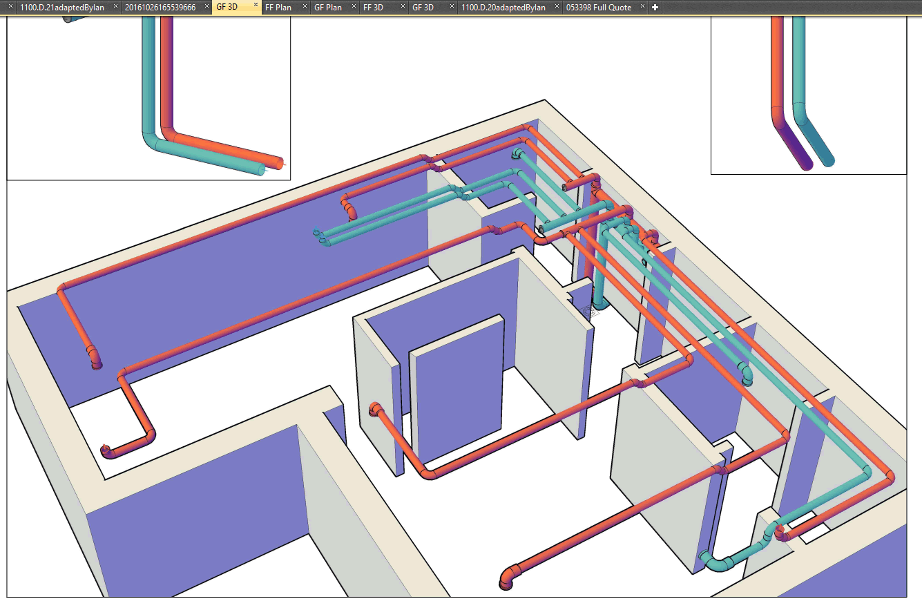

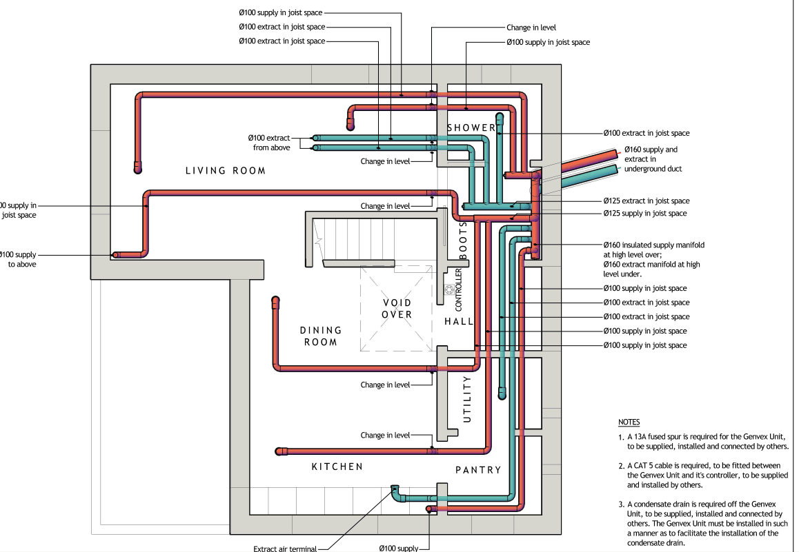

ToughButterCup Posted January 3, 2017 Share Posted January 3, 2017 The process of designing an MVHR system for our build has been very long one. All the way from 'MVHR whassat'? to buying a design. What was involved? Knowing that a passiv haus needs an MVHR system, and why Finding an architect who is sympathetic to passiv standard builds Reading about and visiting many passiv standard houses and one passiv haus conversion ( @VIPMan of this parish) Spending hours on the Internet reading posts, blogs, and taking advice Talking to several producers Working through PHPP and out the other end of it and buying a design We haven't bought the system yet. So before we do (or don't), I ask for your critical appraisal. Here are the facts. PHPP shows us needing 18.06 kWh per meter square per annum and a total requirement for 2090. kWh per annum This post , takes us into more detail than PHPP, and bits of it were helpfully explained by @Alphonsox. The bottom line is that I know how much heat (and power) I'll need, and where I'm going to lose it. I also know how much 'spare' heat capacity I have. I asked one company to design us the pipework, and specify the 'box'; Here's the plan: Supply is red, exhaust is blue That makes more sense if you look at it in isometric projection; Because of planning we had to squeeze the POSIs down to 202s. We have (effectively) no roof space. So supply and extract has to be effected through the under-floor space. To do that, we needed to double the pipe work (100s instead of 160s). That means that we are more likely to have a better 'mix' because we now have twice as many inlets and outlets than the original design which used the bigger diameter pipes. We have decided to have electricity as our underfloor heating system. Downstairs and the upstairs in the shower room only. The balance of the heat required is to be supplied by MVHR and insolation. Cooling (and pre-heat) is to be supplied by the MVHR. And that means a GENVEX Premium system with a micro heat pump (for pre and post heating and cooling). PHPP reports that we have a 10% likelihood of overheating. For all of that plus the installation and insulation of all the piping and commissioning £11K There's a big bit of me which thinks that the installation of the pipes is DIY (MVHR piping has first call on the between the floors space). So reduce that price by £2500. No hot water to be piped anywhere in the house. No hot water tank. Each sink (and bath) has a local water heater (SunAmp for the bath) No standing losses. Easy DIY. Thoughts? Ian Link to comment Share on other sites More sharing options...
Bitpipe Posted January 3, 2017 Share Posted January 3, 2017 (edited) Looks well thought out and by considering it now before frame design is locked then you stand half a chance of sticking to the plan. So you will have no fouls or DHW/cold feed competing for space? If that's correct then you're simplifying life a lot. DIY is definitely doable if you have the time and are not blocking other trades from working. Plenty of previous posts on the different strategies and pitfalls - have some help and resist the temptation to trim duct pipe too soon (if the flex type) as we played with it quite a bit to get everything as flat as possible. Also trim your plenums prior to plastering. Make sure you allow for the increased diameter of your insulated MVHR pipes to and from your unit - this can add an additional 50mm to the raw pipe diameter, definitely caught us out. You'll also need to manage the condensation from the unit - in this cold weather there will be surprising amount. We also had a design (from BPC) but it did not survive contact with the enemy (the already installed frame) and by sheer luck and some pencil chewing I got all the necessary duct where it needed to go - at the cost of over ordering on the rigid stuff (still have 5 x 2m lengths of 180mm radial in garage) to give us some flexibility in where to put the distribution boxes. In fairness, BPC did warn us that this was the likely scenario! Haven't comissioned it properly yet - just turned it on when we moved in really (actually a week or so after and the change in air quality was noticeable). Am planning to hire the air flow monitor thingy and do a proper job of balancing sometime soon. That said, it does seem to be working fine - our unit is quite large (but then so is the house) - a Sentinel Kinetic Plus, no active heating or cooling. We had a full house of 11 + cat + dog over xmas, lots of showers, cooking etc and no obvious issues. Think on how you'll be activating boost. We had our sparky put a PIR in each bathroom and also hook the boost circuit to the light switch, so entry will put the MVHR in boost - (these both also activate our secondary pump for the DHW). Need to add a current detector to get the oven hood to do similar as our hood is not compatible with the dedicated switch in the MVHR. It does have an in-built humidity sensor so this is all belt & braces. Edited January 3, 2017 by Bitpipe Link to comment Share on other sites More sharing options...

reddal Posted January 3, 2017 Share Posted January 3, 2017 Hi, A few points : Is the ducting insulated? I think that is important if you want the MVHR to do cooling. Worry about potential noise from both the unit and the outlets - we initially had a lot of grief with this. Make sure you test this in any 'sensitive' areas like bedrooms - even what seems like a quiet hiss in a building site is a super annoying loud noise in the dead of night 6 months later when trying to sleep. Work out how you will clean out the ducts - which is necessary eventually - maybe immediately if you run the system for testing whilst building work is still going on. - reddal Link to comment Share on other sites More sharing options...
joe90 Posted January 3, 2017 Share Posted January 3, 2017 Noise is one of my worries and when I visited Jeremy he explained that he had his flow resisters/adjustment in the manifold rather that at the plenum ( he used semi rigid) but I think somewhere on here it was suggested that flow adjustment was better done at the terminal . Link to comment Share on other sites More sharing options...

ToughButterCup Posted January 3, 2017 Author Share Posted January 3, 2017 4 hours ago, Bitpipe said: [...] So you will have no fouls or DHW/cold feed competing for space? If that's correct then you're simplifying life a lot. [...]. Also trim your plenums prior to plastering. [...] Make sure you allow for the increased diameter of your insulated MVHR pipes to and from your unit - this can add an additional 50mm to the raw pipe diameter, definitely caught us out. You'll also need to manage the condensation from the unit - in this cold weather there will be surprising amount. [...] Am planning to hire the air flow monitor thingy and do a proper job of balancing sometime soon. [...] Think on how you'll be activating boost. We had our sparky put a PIR in each bathroom and also hook the boost circuit to the light switch, so entry will put the MVHR in boost [...] Need to add a current detector to get the oven hood to do similar as our hood is not compatible with the dedicated switch in the MVHR. It does have an in-built humidity sensor so this is all belt & braces. Hugh, (@Bitpipe) thanks for all that. Fouls, hadn't thought of it because I'm still in the individual sub-systems loop: Your nudge is especially welcome because it's long past time for me to start stitching the whole thing together in my head Condensation: sorted (direct to foul) Balancing: I'll DIY or get an expert @VIPMan ( he doesn't know it yet) Just on with the sparky's spreadsheet and diagram, so especially welcome to be reminded - lots of threads elsewhere making that point. 4 hours ago, NSS said: I assume the ducting is Lindab spiral tube. This is what we used and did the install DIY without any issues. @NSS, I'll double check, thanks! 3 hours ago, reddal said: Is the ducting insulated? I think that is important if you want the MVHR to do cooling. Worry about potential noise from both the unit and the outlets - [...] Work out how you will clean out the ducts - [...]- @reddal Ducting: Yes, it is; a good deal of thought has gone into that aspect The Unit is in our Piggery so no fear of noise, from that. But ducts are ducts, in fact ducts will be ducts; and they are annoying things, so we'll be watching the internal smoothness and also how to clean the damn things. I'd clean forgotten about that. What do you use? A massive loofa ? Baggywrinkle? The cat? Keep newts in there and get them to munch any dirt? Link to comment Share on other sites More sharing options...

TerryE Posted January 5, 2017 Share Posted January 5, 2017 Yes, the heat exchanger cools the out-going air and this can drop it below dew point causing humidity to condense out. The drain takes this away. On another point by reddal above, I would question why you would need the pipework to be lagged (other than the main external inlet and outlet runs from the unit itself. All of your internal pipework is within the warm environment, and as you are effectively operating the whole house as a single zone, it largely doesn't matter where you add or remove heat within the internal space, IMO. 1 Link to comment Share on other sites More sharing options...
ProDave Posted January 5, 2017 Share Posted January 5, 2017 Terry It's not necessarily the case that all mvhr pipework is "within the warm environment" I have recently wired a new house, where the mvhr unit, and a lot of the distribution. pipework is up in the cold, ventilated loft space. Without lagging that would be a condensation nightmare (it might still be so) If I could give just ONE recommendation on modern house design, it would be DO NOT have an old fashioned, ventilated cold roof space where you rely on insulation at ceiling level. Even if you are not doing "room in roof" it is SO much better to have a warm roof design where the insulation is at eaves level. SO much easier to detail to get an air tight house etc etc. This new house I just wired, the builder was so smug about how well insulated and sealed (he thought) the house is, but i still noticed if you remove a light switch on a windy day, you could feel the cold air coming out of the hole, no doubt leaking somehow from that cold loft space into the service void behind the plasterboard. 3 Link to comment Share on other sites More sharing options...
