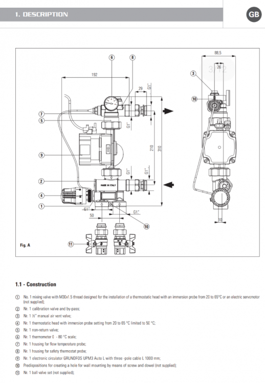

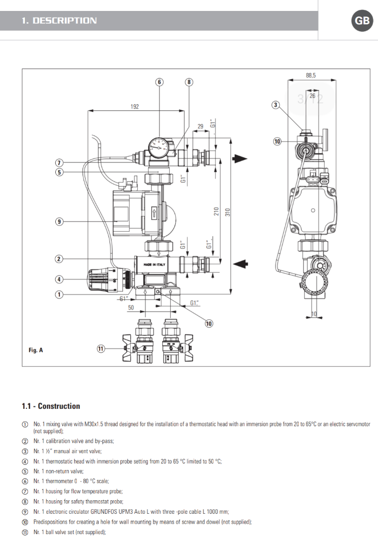

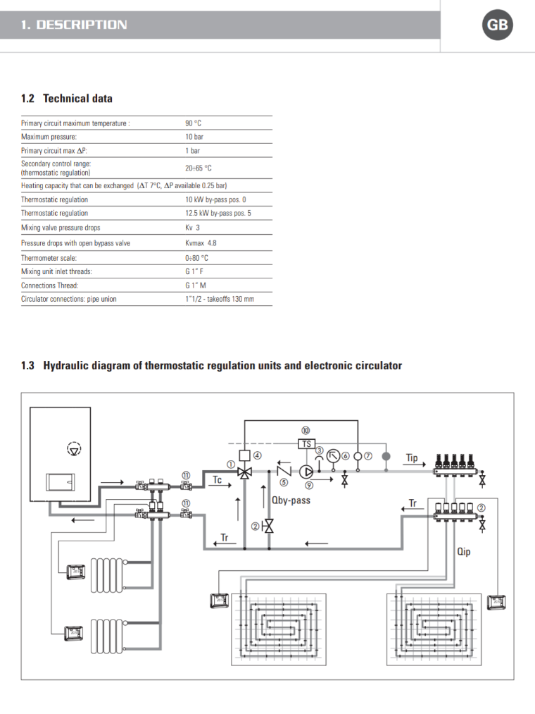

JFDIY Posted July 16, 2020 Share Posted July 16, 2020 @Nickfromwales How does the emmeti TM3-R pump set compare to the IVAR? It's a bit late as it's just gone in to my place, but interested on your thoughts, the TMV with capillary is graduated from 20-60c so I'm hoping that's a positive. Link to comment Share on other sites More sharing options...
Nickfromwales Posted July 17, 2020 Share Posted July 17, 2020 (edited) 14 hours ago, JFDIY said: @Nickfromwales How does the emmeti TM3-R pump set compare to the IVAR? It's a bit late as it's just gone in to my place, but interested on your thoughts, the TMV with capillary is graduated from 20-60c so I'm hoping that's a positive. 6 and two 3's by the look of it, just the IVAR has an in built bypass whereas the Emmeti doesn't appear to have one. Components include: Grundfos Secondary Underfloor pump Remote sensor holder Upper body Lower body Manifold 1″ connection fittings Thermometer Primary by-pass valve Secondary by-pass valve Thermostatic head SKU: PUT-IV-UNIMIX.IV Categories: Home Page, UFH Pump Control Pack - Underfloor Heating Pump Mixer Kit Related products Edited July 17, 2020 by Nickfromwales 1 Link to comment Share on other sites More sharing options...
JFDIY Posted July 17, 2020 Share Posted July 17, 2020 Thanks Nick, I've just checked, it does have a bypass, so I guess that's good. Item 2 and seems to be adjustable. Not sure the difference the setting would make, there are 5 settings 1 Link to comment Share on other sites More sharing options...
