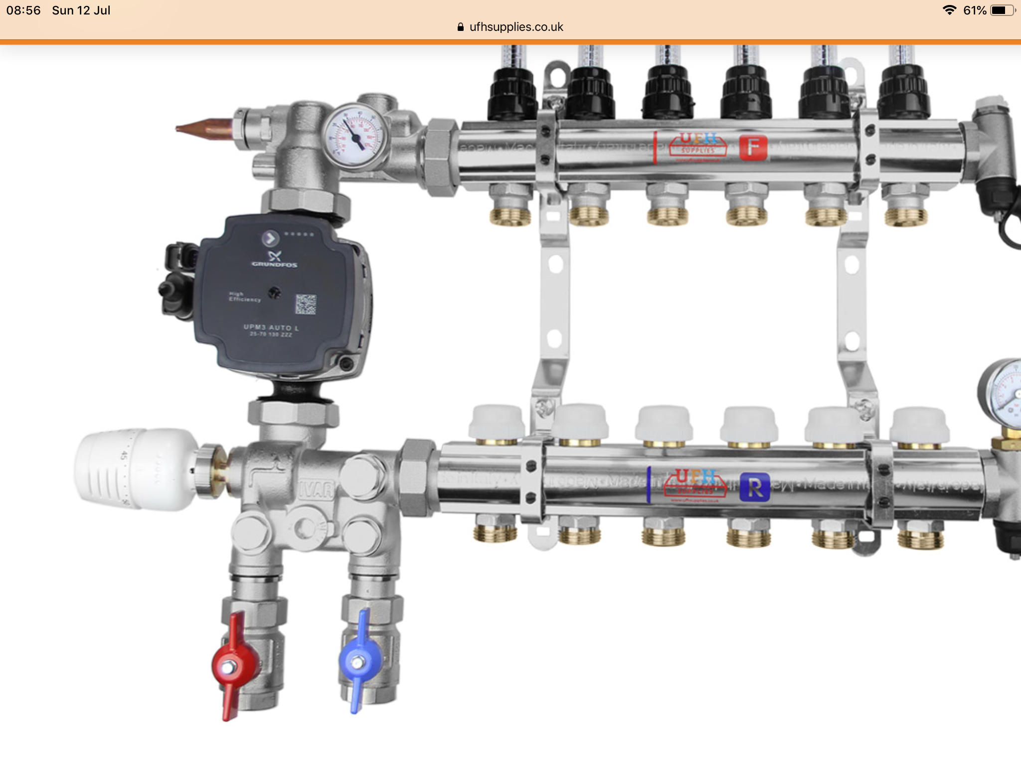

Ufh manifold, blending valve with ASHP.
So all my bits turned up for my ufh, but I’m confused with the manifold layout, I was told if I’m fitting an ASHP I don’t need a blending valve, is this right.
Who has a blending valve and who doesn’t.
Confused as usual.

    Every UFH manifold needs a pump and a TMV. TMV’s  cannot be pumped through, they have to be ‘sucked’ on, ergo a pump needs to be downstream of a TMV in a heating setup.  TMV caps the max temp the fl

DHW doesn’t need a TMV on the input to the coil but does need it from the output from the storage whether its UVC or SunAmp or TS. UFH should always have a TMV as you want to blend the floor temp to a maximum temperature to prevent overheating - trusting the ASHP to do that, and also only having the ASHP pump to circulate water in the system is a really bad idea.
TMV caps the max temp the floor will ever see, I’m sure there’s a reg there but moot unless you intend to not fit one. You should not ( cannot ) rely on an external Ctrlr to guarantee that the slab / screws won’t see the max temp of the heat source, so if said Ctrlr failed, on an ASHP, you could get up to 55-60oC floor temp which will cook anything that’s not high-temp tolerant, plus it would be a health hazard ( if a toddler or elderly were to end up on it ) or if anyone walked onto it barefooted etc hence the reg.
UFH manifolds need the local pump to circulate water through the loops, and the ASHP circulation pump send the water to / from the manifold. Think of it like a figure 8, with the two circuits being connected but hydraulically separate eg both pumps can circulate at different flow rates without conflicting with one another.
The IVAR blending set also has an inbuilt bypass ( so the ASHP pump never sees a closed circuit ).

@Nickfromwales this is the one on the website from the people I got my manifold, is it the same as the one you listed.
It was originally on my quote but they took it off when they knew I was using ASHP.
If this is cool I will get it ordered.

Ask them the minimum temperature the valve will go to - I think it’s 42c from memory which isn’t low enough for ASHP and a decent insulation level.

@Russell griffiths You need the 20-60oC
@PeterW These drop down very low and are super-reliable too. A standard thermo-mechanical(?) TMV struggles at 30oC and starts whining and strangling the flow the second it runs out of cold return water to use for blending. I've been fitting these Ivar's on just about every project so can vouch for them doing what they say on the tin, and reliably, particularly on low-energy & 'passive' builds.

With these blending valves, if the temperature of the hot is lower than the temp set (e.g. blending valve set at 30 degrees, hot feed at 25 degrees) will they just let the hot through unrestricted and not mix in any cold?
Yup.
The valve is actuated by the TRV style head and that gets its reference via a capillary wire that is connected to a thermo-probe ( which is inserted into a pocket to detect the flow temp after the pump, eg after return water has been blended back in already ) and the TRV head will only open if the flow temp is less than the setting on the TRV head. The valve is normally fully open, so it promotes great full flow rates when the UFH starts up and asks for heat, and only starts to close as the temp set at the probe meets the temp set on the head.
There is no 'cold' to speak of, just the available return water and whatever temp that is.
I went with a similar but cheaper option that controls right down to (IIRC) 25c and has an integrated bypass and inlet restrictor ( there's a more basic one without, bit using the same thermohead  I think)
