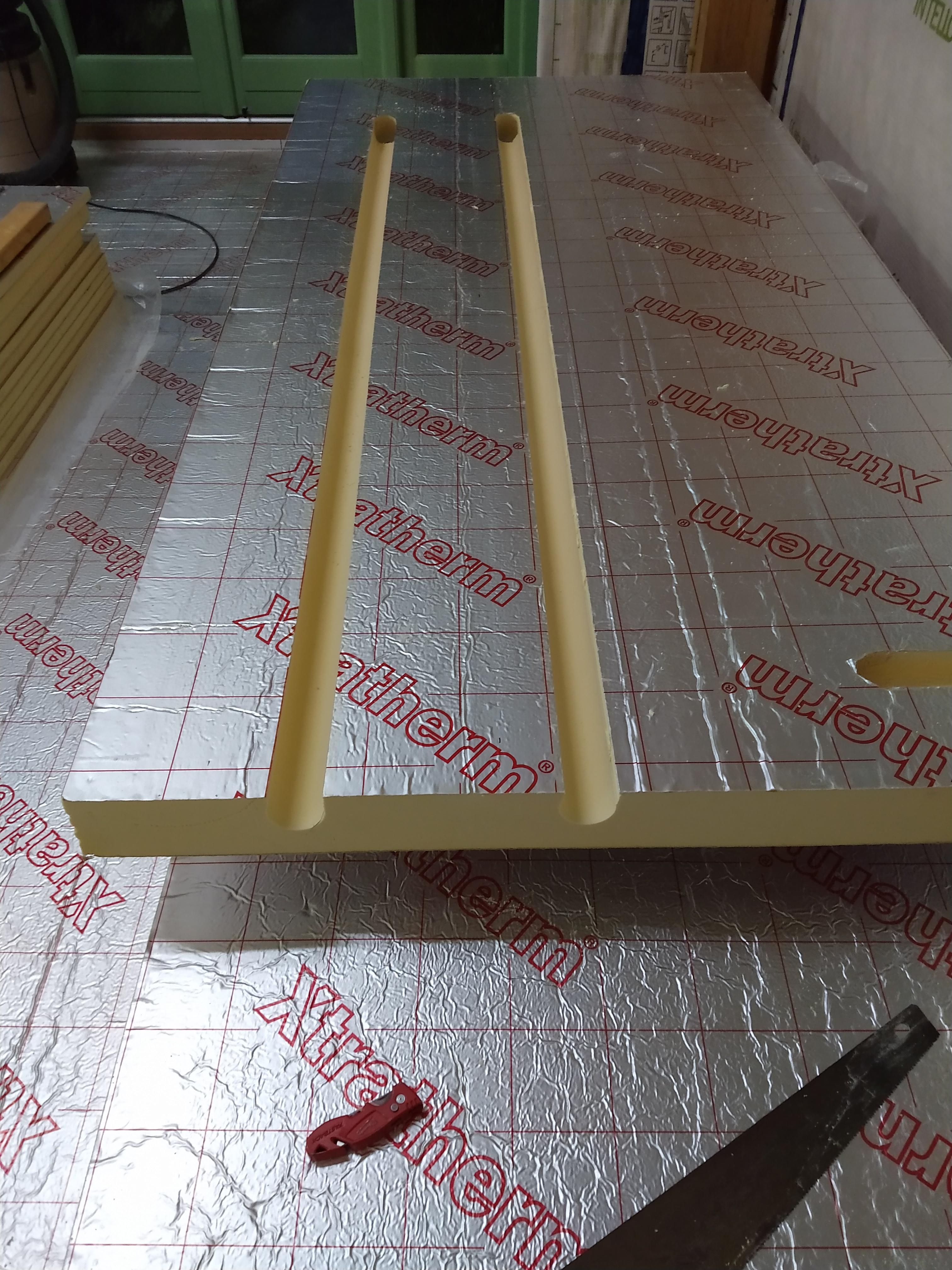

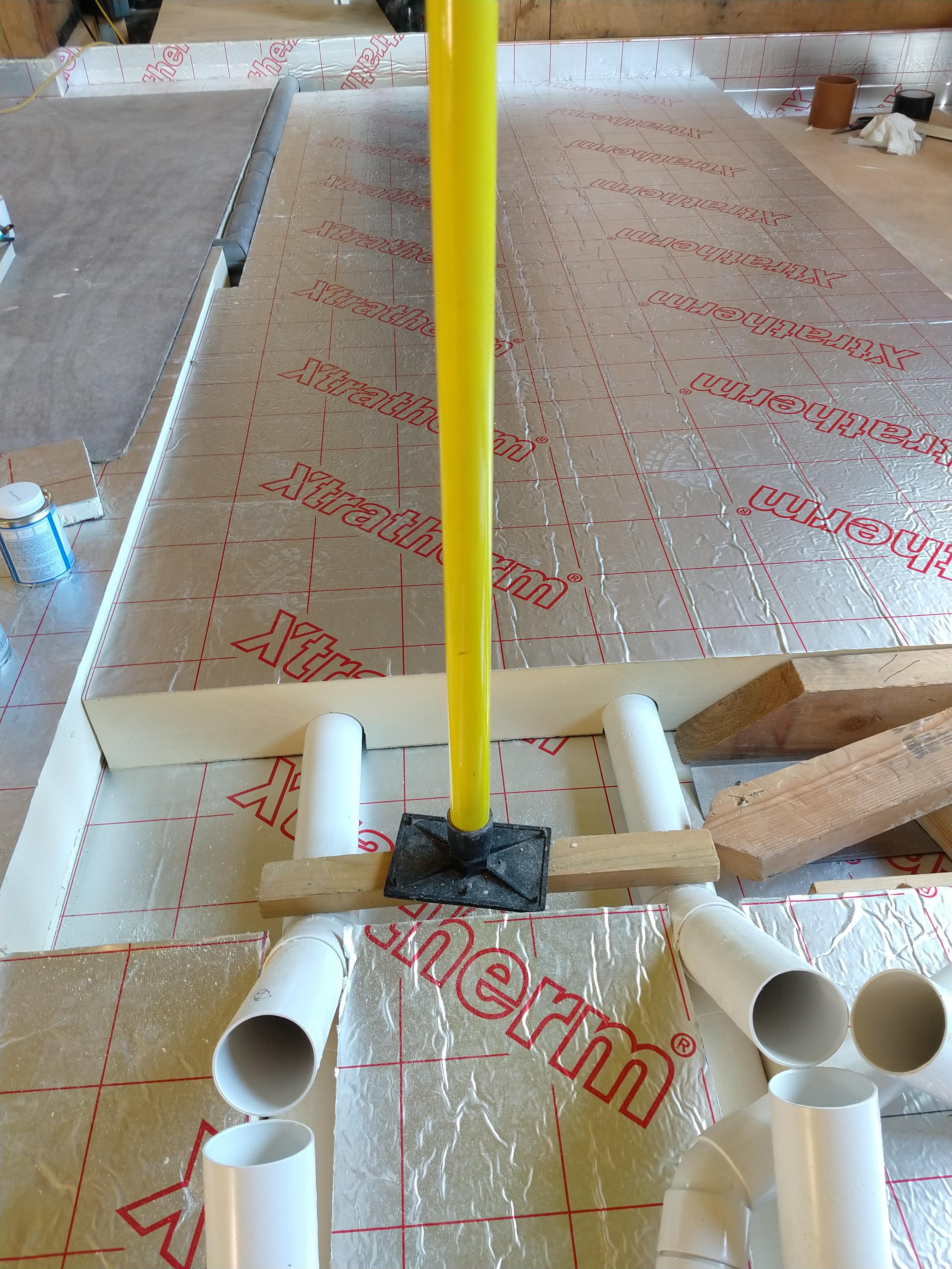

As the title suggests, I work in engineering and it's a bit of a curse sometimes.  I decided to run some 50mm solvent waste pipe as ducts to where our kitchen island will be, for passing services at a later date. These are in the thickness of the insulation under the screed.

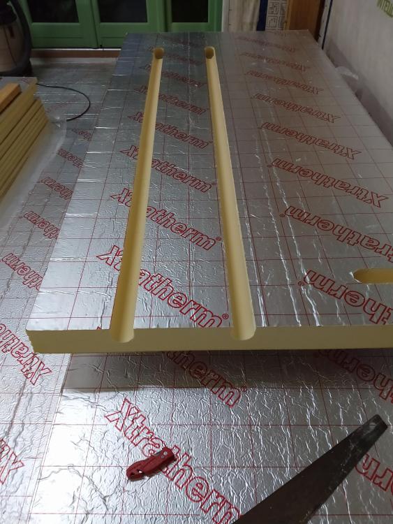

Anyone who's tried to cut channels in PIR will tell you how rubbish it ends up. I still wanted as best as I could, full support for the screed and no voids or big areas of expanding foam which I'd have needed if I stopped and started the boards either side of the pipe
Here's how it ended up.
Pretty pleased with that.

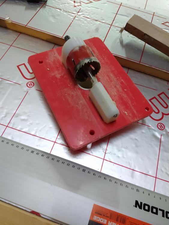

I rough cut the channels, then clamped a straight edge as a guide fence.

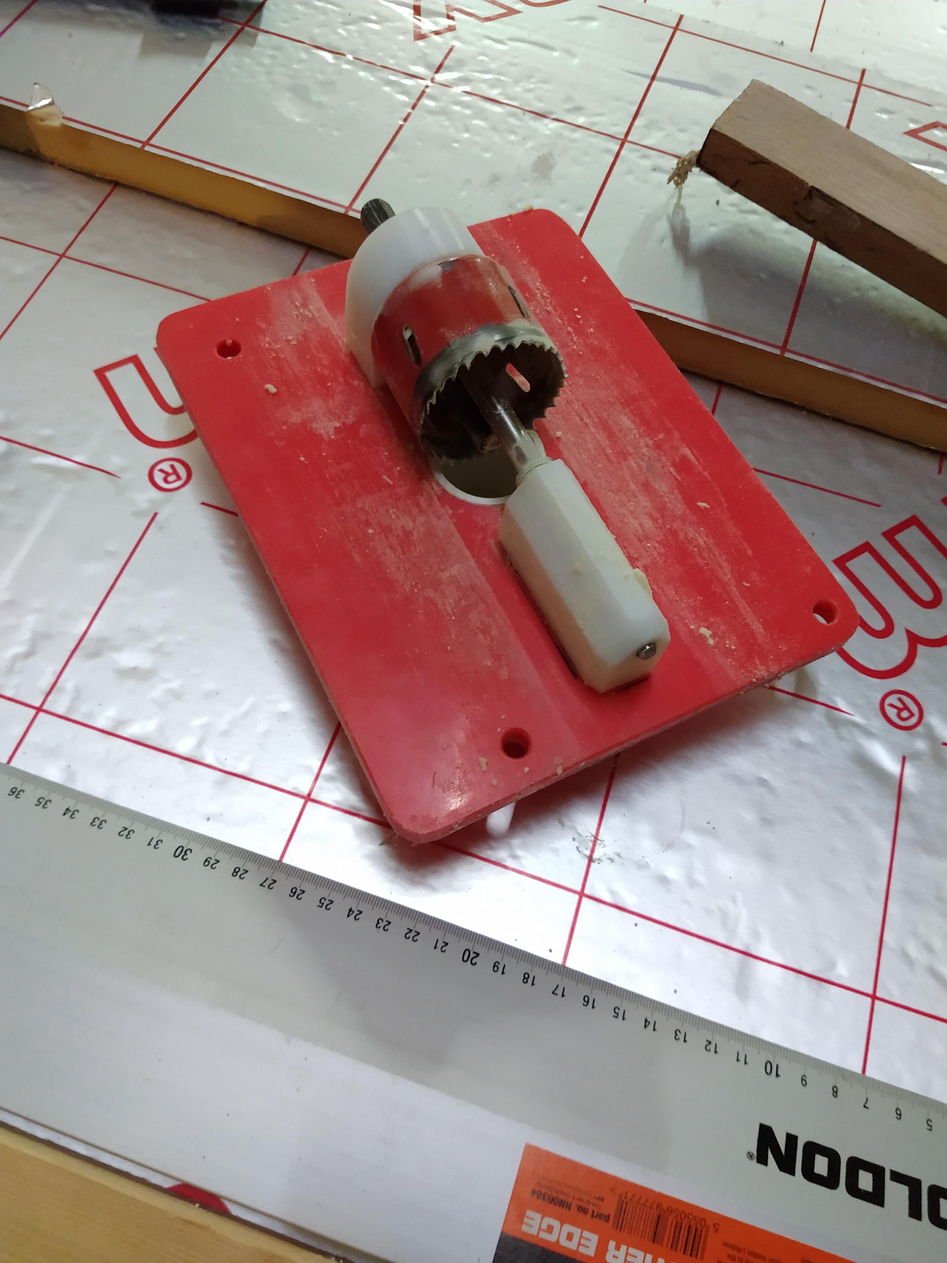

Then run the home made hole saw sledge down it using a long 1/4” extension and universal joint as a driveshaft as the drill wouldn't pass down the slot.

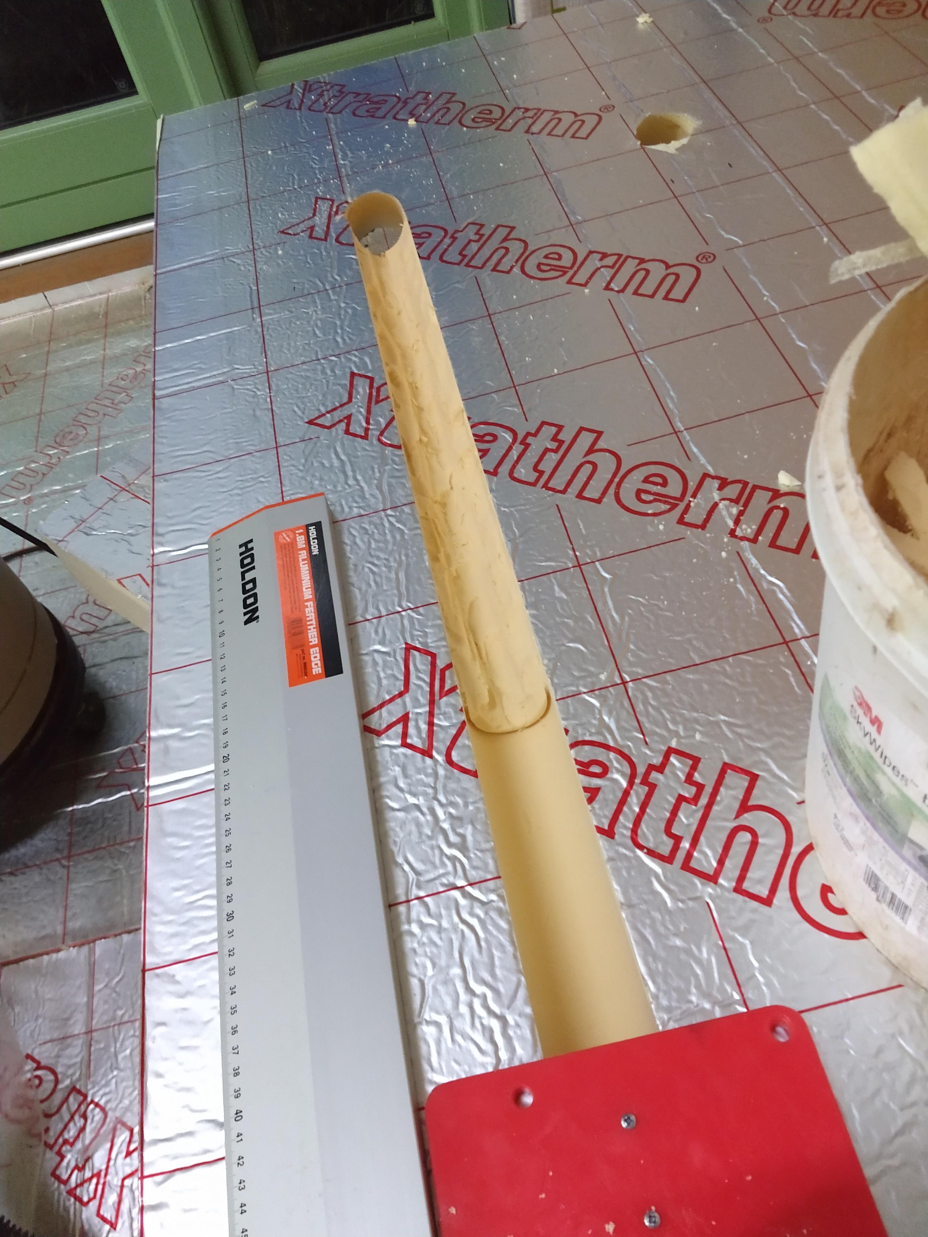

Note also the dust port for vacuum extraction which was essential to stop it all clogging up. Also found running the holesaw backwards made it grab less  which is a trick I'll use again when holsawing PIR
Time to build tool was probably 3hrs and the tidy up operation was 5mins per slot.

I must admit I just veed the pir, foamed it, cut flush and foil taped over.
Respect.
A thing of true beauty!
Must bother you the writing's the opposite way on different boards!
If you happen to have one of those soldering irons that heat up "instantly" you, can replace the  bit with a length of piano wire formed into a loop with shoulders. Run that down the PIR for nice neat u channels.
